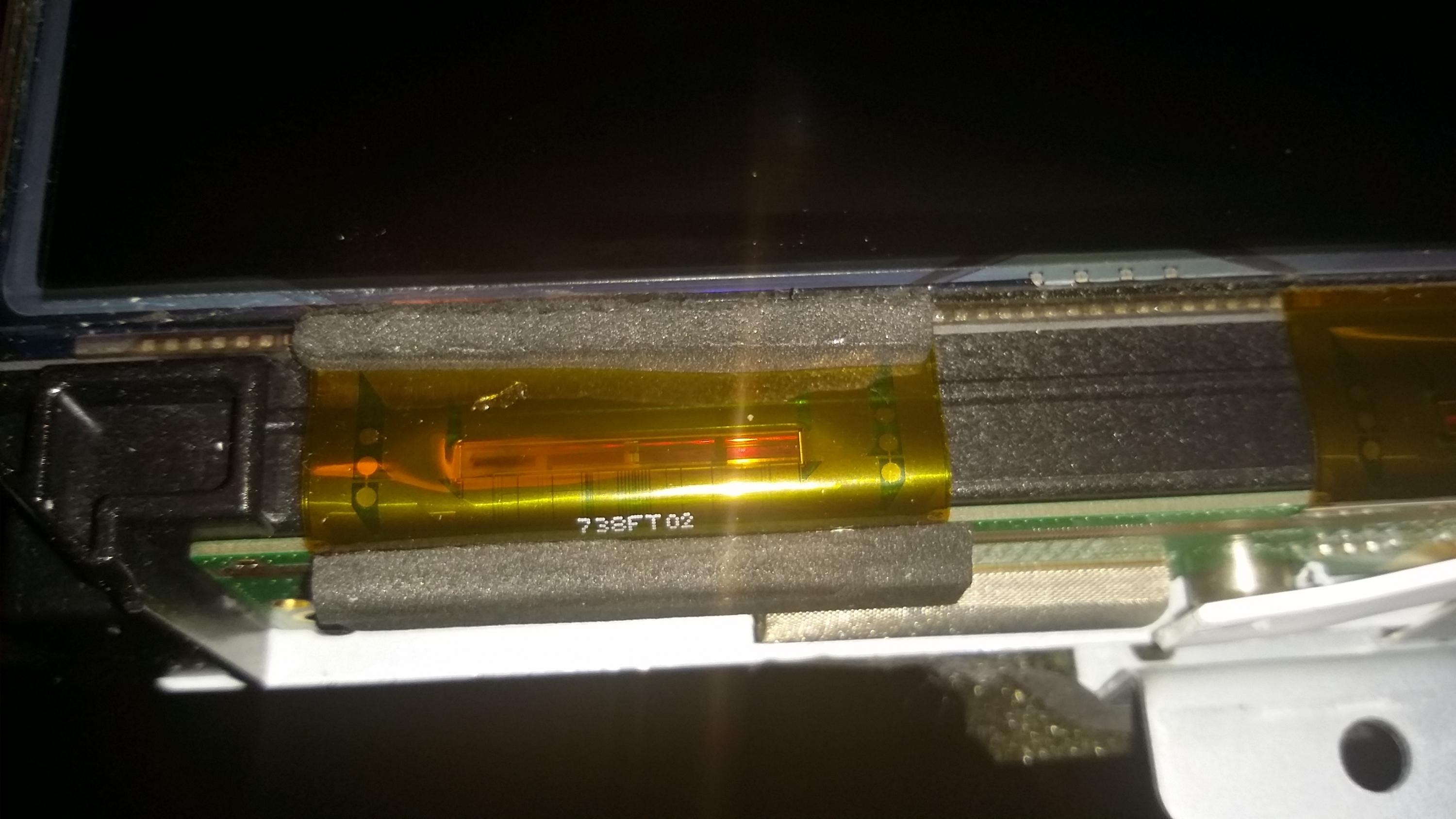

    Those pictures are kind of at the wrong angle giving a false impression... but the white piece of plastic was put there by me (also at the four other "fingers") to prevent them from touching the edge boards during testing. Once the bezel is put back, it goes into the "slot" and prevents the "fingers" from coming close. However, the boards are actually quite loosing mounted and move. The pads shown in the picture are supposed to help prevent the boards from touching the bezel once it is in place BUT I put a few more smaller pads in various places to ensure that the boards never move towards the bezel. I hear you about screwing back the bezel into place. If I can't get the thing back together without ending up with the defect again, then it will be "parts recycled" as I don't need another set and was just trying to save it from the recycle bin.

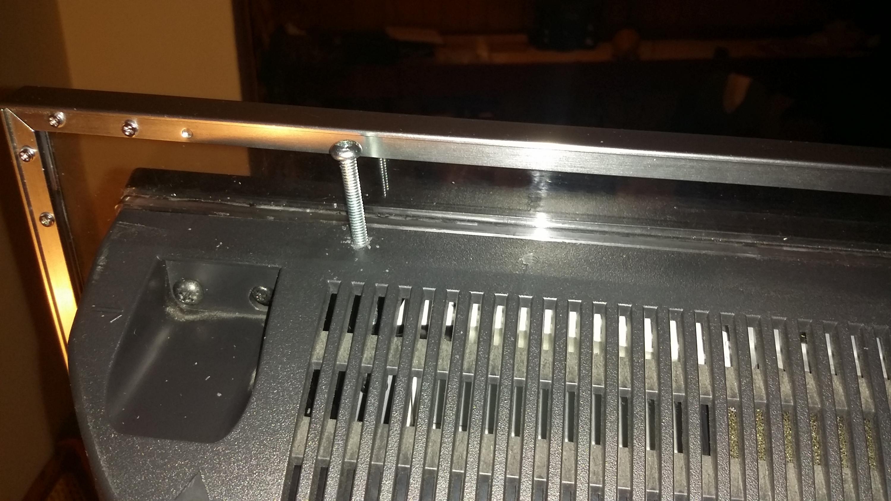

      I am going to try some further shimming on the external side of the frame to some structure points with some white plastic strips that I was using during the testing to see if it helps.

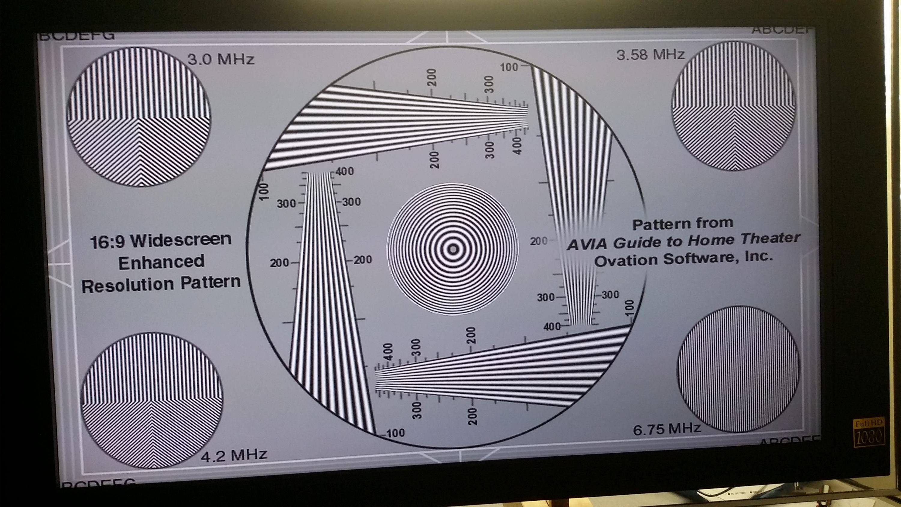

          Here is a picture of the same display that posted earlier. There is some uniformity / brightness issue across the screen as you move to the right where the problem was, but overall, certainly a useable result. Not sure for how long though.

            A large percentage of the time, the picture is stable / good but there are periods (no pattern) when the failure comes back. Touching the corner of the frame lightly appears to get it back in control. I find that strange that such small amounts "pressure" can impact the result. There is something more to the story that we may be missing about the failure.... maybe. I am thinking about possibly drilling / mounting a screw in the back panel that will protrude thru to the interior metal bezel and can be tighten to add some pressure at that point.

              where do you think the failure is on that bond where it joins the lcd panel or the panel pcb joint or the cof on the flex ive read threads where it has been different points on the tabs that fail on that particular set.

                I looked at both ends with my glasses on and didn't see any obvious issues like heating or gaps or such. My "pressure pad" is basically sitting just above the contact points of the edge board. That area was where I readily got a "corrected picture" by lightly touching the tab. I just find it hard to believe that the amount of "pressure" when it is fully assembled is very very slight to cause a change from "fault" to "good" is doing much.... maybe I don't understand all the physical forces in play.

                  looking a bit closer at the picture that I posted a bit back that shows most of the tab contact area on the edge board, I am now wondering about that screw (lower left side). I wonder if its got an issue related to providing grounding to that area of the board... maybe .

                    in budm,s link i shared pic 15 shows he put the pad over the chip on flex area hence i asked where yours seemed to of failed i know each set may fail differently though certainly a hard fault too try and fix so the set is watchable atleast.

                      The faulty area i think is almost always the same, it's not the glued part but is a very tight area where finish the pcb glued part and the ribbon lifts and begins the curve, in that area under the ribbon there's a 1mm about of tracks free from protective paint, i think that the moist and oxidation can be an answer on why it becomes interrupted, soon i'll try a new approach 'cause in the past i've failed due to uncomfortable work at my house with theese beast screens..

                          It's a matter of contact, already seen well and studied for hours, the broken track or tracks makes contact trhough a bridge made by the pcb gold plated pads, the distance is so tiny that with heat and dilatation a little blow / hit makes the parts to get nearer and make contact.

                            So, I was having "cold start up" issues such that most of the time after a long shut down, the tv would only start in the "failure mode display". I decided to tap in a #6 machine screw into the plastic back cover which goes down towards the metal bezel plating.
                            I can then simply tighten it to a degree to put pressure on the bezel plate which in turn transfers the force into the underlying pressure pad that I had put on the tab. In the picture you see two holes. I tried the one to the right, and was not able to get the desired result. It only caused a "flicker picture" with the dark area removed, so it was close. Anyways, I am now waiting on a "cold start moment" to see if I have actually done anything... :-)

                                    As Davi.p suggested, there seems to be some sensitivity when I tightened the side metal frame bezel screw associated with that corner. I will try leaving it a bit looser than the rest and hope. :-(

                                      I don't understand, the screw you put have worked or not? Is not the right type of screw, needed a wood type.. i'm quite doubtful of the thing that is the panel's glued part that is detaching.. if you press the pcb part the ribbon tend to go away from screen...

                                        The screw is a machine screw. It didn't totally fix the issue. I still had to do some "bezel twisting" to get the picture good again. I used a normal tap and tapped the thread of the plastic back so that the machine screw threads fine into the hole.
                                        As you and Freakaftr8 pointed out, it is a connection problem. If you press on the PCB part of the ribbon, the ribbon somewhat bends up which causes a change also at the panel part. This leads one to believe that the problem is at the pcb but after more testing, I found that the panel portion was more sensitive to a pressure change. No problem, as my picture shows, I now have pads at both the pcb and panel contact areas. I still found as I am starting to re-assemble, that it remain sensitive to pressure changes depending on how assembly screws are tightened. I have not found a good solution that will always allow the set to work without some form of "physical effort". :-(
