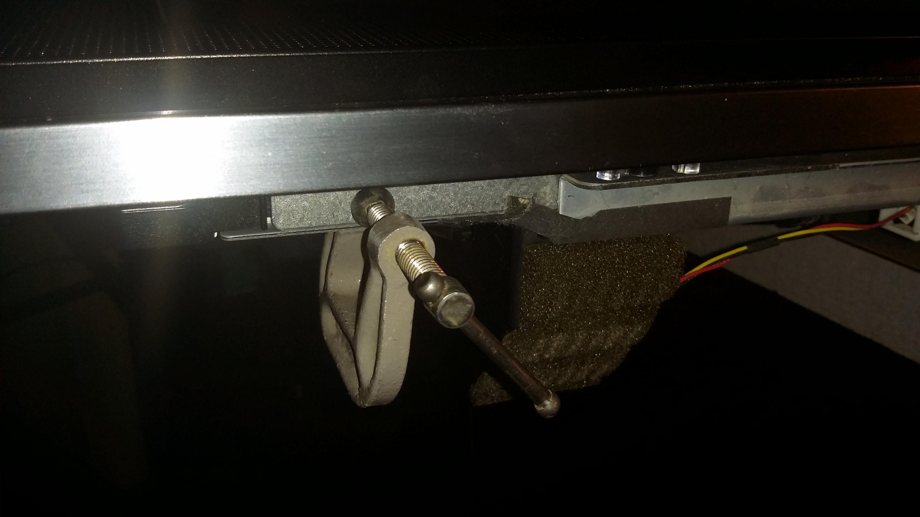

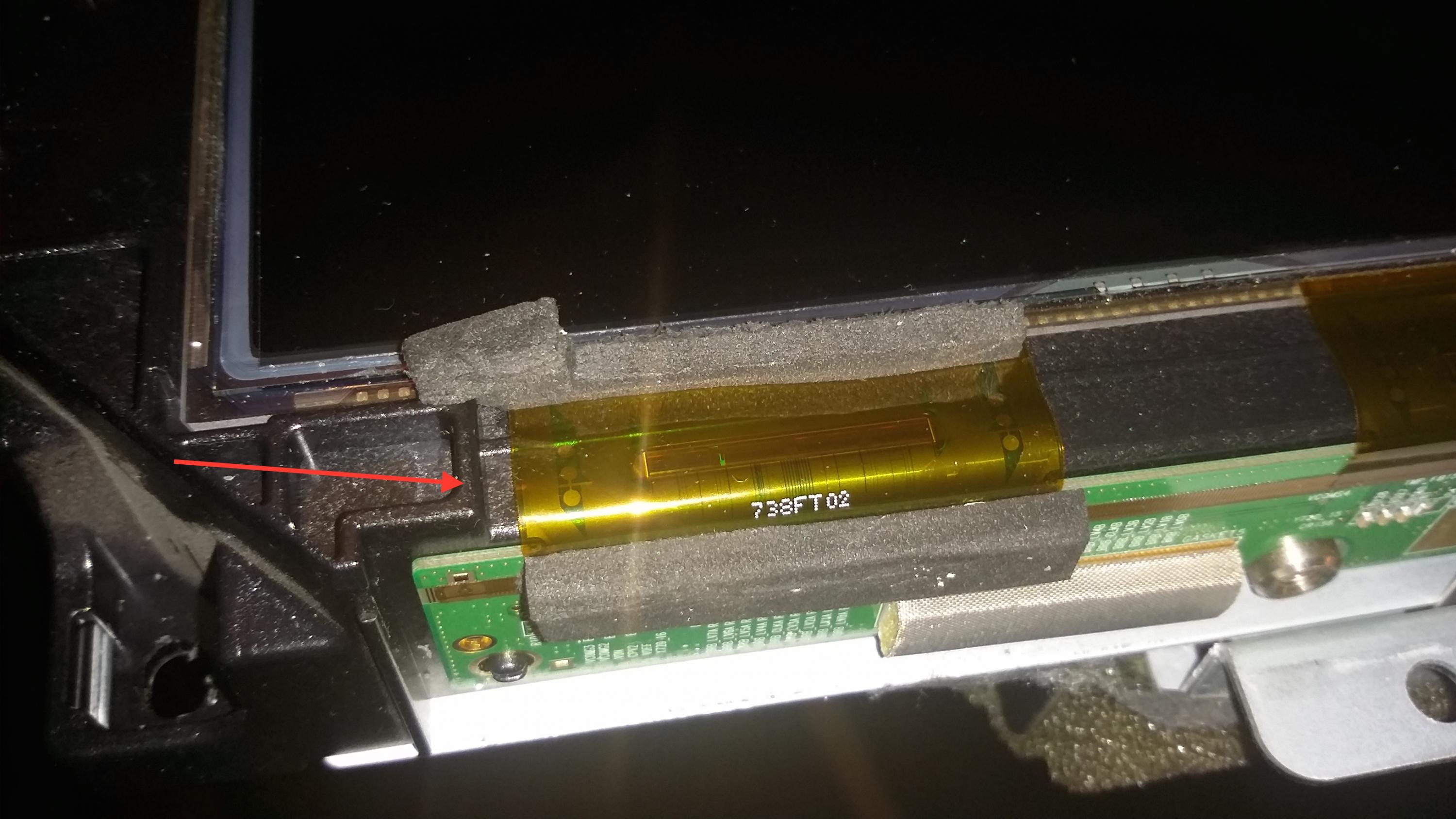

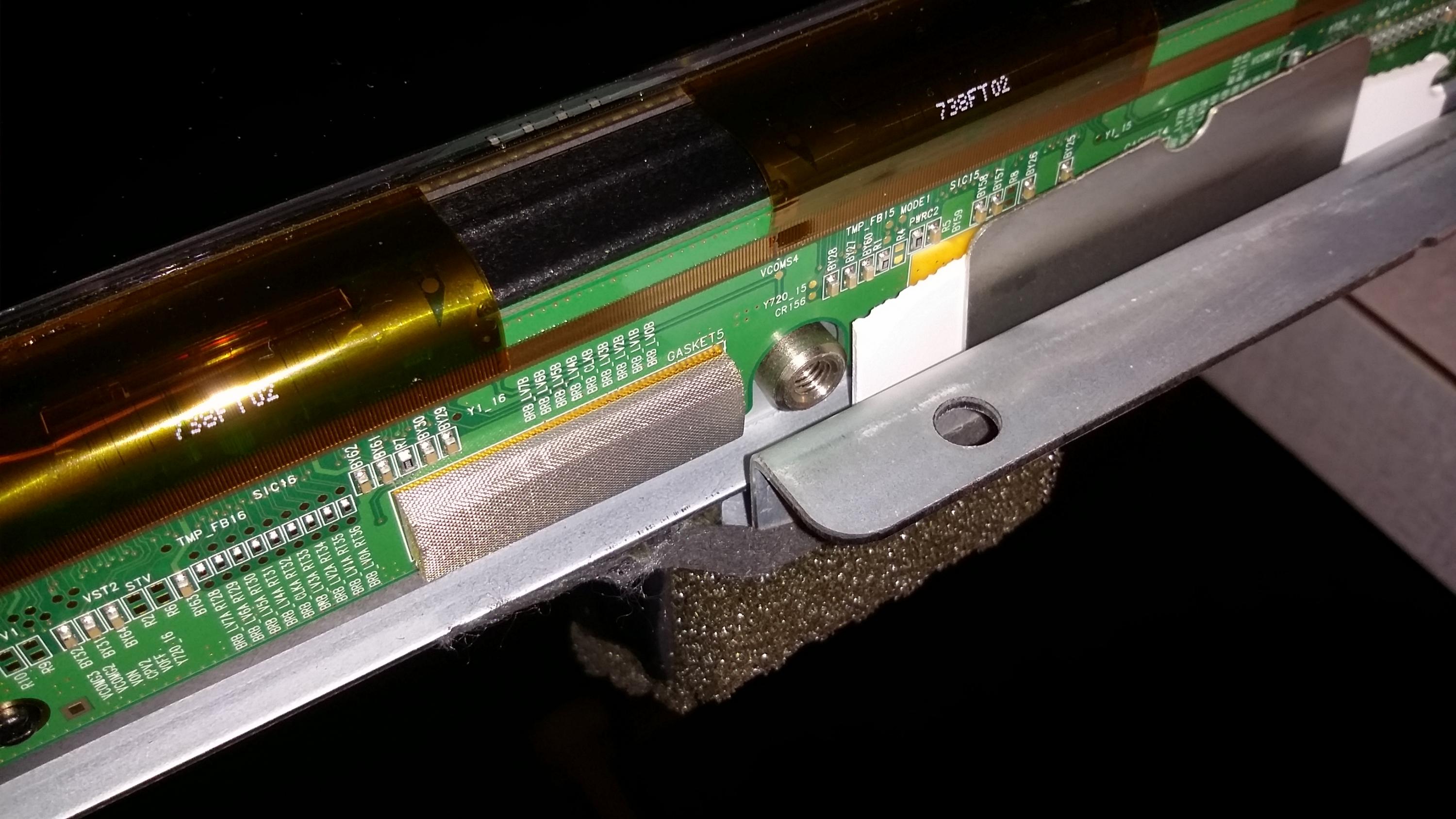

      Anyways, I took things apart once more. One to check to ensure that the edge board "ground" in and around the right side was being made consistently to the main body of the cabinet (just a simple resistance check). It was and there wasn't any change with pressuring that area.
      Next, I played with the tab area in question plus moved along the panel edge in both direction including up the side using a pencil with an eraser end. The only area that was impacted was indeed the left side of the tab in question. Looking closer and trying to figure out why changes in pressure on the frame were so unpredictable as to whether they would result in a display change from good to bad or bad to good, I realized that the plastic frame component in the corner of the panel has a raised edge (about 3/32th of inch) such that the maximum the metal bezel could squeeze down on the pressure padding was limited by this "interference" of plastic. See the arrow in the picture. Thus I raised the pressure pad material thickness by adding some addition padding just to that left side of the tab area. I put back the metal bezel (tighten down screws), and things look better. I need to wait for things to cool back down to see if it holds it desired effect. Fingers are crossed.... hopefully its not memory foam ... :-)
      • budwich
        • Jul 2015
        • 3097
        #43
        Re: Sony KDL46XBR4.... a new "learning journey"
        Put everything back together including the two extra screws that were "left over" from earlier attempts. It would appear that I might have succeeded in getting the thing to start up with a good display and stay that way. I will do a couple more "cold start test" just to be sure. I want to wall mount it so I am hoping it will be more "good times" than "bad times". I added weather stripping along the entire side of interest... its between the metal frame bezel and the overall plastic outer bezel.... just inside the leading edge towards the screen. I found during the earlier testing with the entire bezel mounted / in place that I could readily cause the picture to go bad / dark by pushing the side area. Hence the decision to try for some "isolation" padding.

          Tried some more "cold starts"... not as successful in that the picture sometimes is in "fault mode" (ie. dark side and horizontal lines) but the set seems to "fix" itself without any intervention or physical forces. It would appear that the connection point that is in trouble "burns thru" what ever the issue is and starts to run fine.
          My question is... is this going to get worse... will that point / area eventually "burn up" from the repeated "spark over action"?

            Are you able to determine which line/lines are interrupted by pressing the ribbon with a toothpick especially in the right near glued part? If the lines are for example 3 and are all consecutives there's the possibility that actually the center one is the only one broken, and if that doesnt enters the COF and goes to the vertical tabs passign through the glass tracks you can jump the broken track with a wire..

              could be tough to do but I understand what you are saying. Its certainly more on the first set of tracks closest to the left side of the bond. If you look at the last picture that I posted, it shows how the buildup pressure pad is pressing on that side. You can almost see that the pad is on an area that appears to a "large track" that doesn't go to the COF chip.... perhaps some form of ground line(s)... maybe.
              IF I look back at one of the early pictures that I posted, the lines labeled at that end have a "V1" label.... what ever that means.

                            BUT... I think the "masking of the flat cable at the tcon" method only works IF there are no side tabs / drivers. If those drivers are not removed and left unpowered, then they load down the opposite side drivers resulting in picture issues similar to what I have posted. Further, I suspect that if the set is run with this kind of condition, then the side drivers that are OK will quickly get in trouble as they are driving horizontal lines that have "unpowered drivers" connected on the opposite side.
                            Note: I am not asking about removing the bottom tabs of the panel, just the ones on the side that are not getting proper powering because the bottom tab bond has no integrity.

                                    the picture linked is with the tcon disconnected. You get that kind of display (instead of all white) when there are other issues on the disconnected side.
                                    As for the video, he has a problem with side tabs that are not operating correctly and as a result, it gives a picture as shown. He takes the panel apart and checks for voltages at the side tabs just as you suggested. In his case, no voltage at the right side, voltage at the left side. He then tries to make voltage for the right side (not shown in video, just text message). He then removes the side tabs on the right and the display is good again. This appears to be the same issue as sharps with side tabs.
                                    As for how long the panel will last with side tabs removed, don't know. So far on this forum, I have only come across 3-4 posts of people who have removed the side tabs and had the tv fail shortly there after. Right now, I have found nobody that gives an idea of a long term success using pressure on the tab bond area so I am not sure there is a good answer either way. The tv is not useable in its current form as the display fault can show up at any time. :-(
                                    Thanks for your comments though as I wouldn't have search further trying to find other possible options. You are certainly more experienced in these areas as I personally have only seen 3 TV's in need of repair in front of me. All have been a success in one form or another. This set will be my 4th effort at trying to save from the recycle bin.
