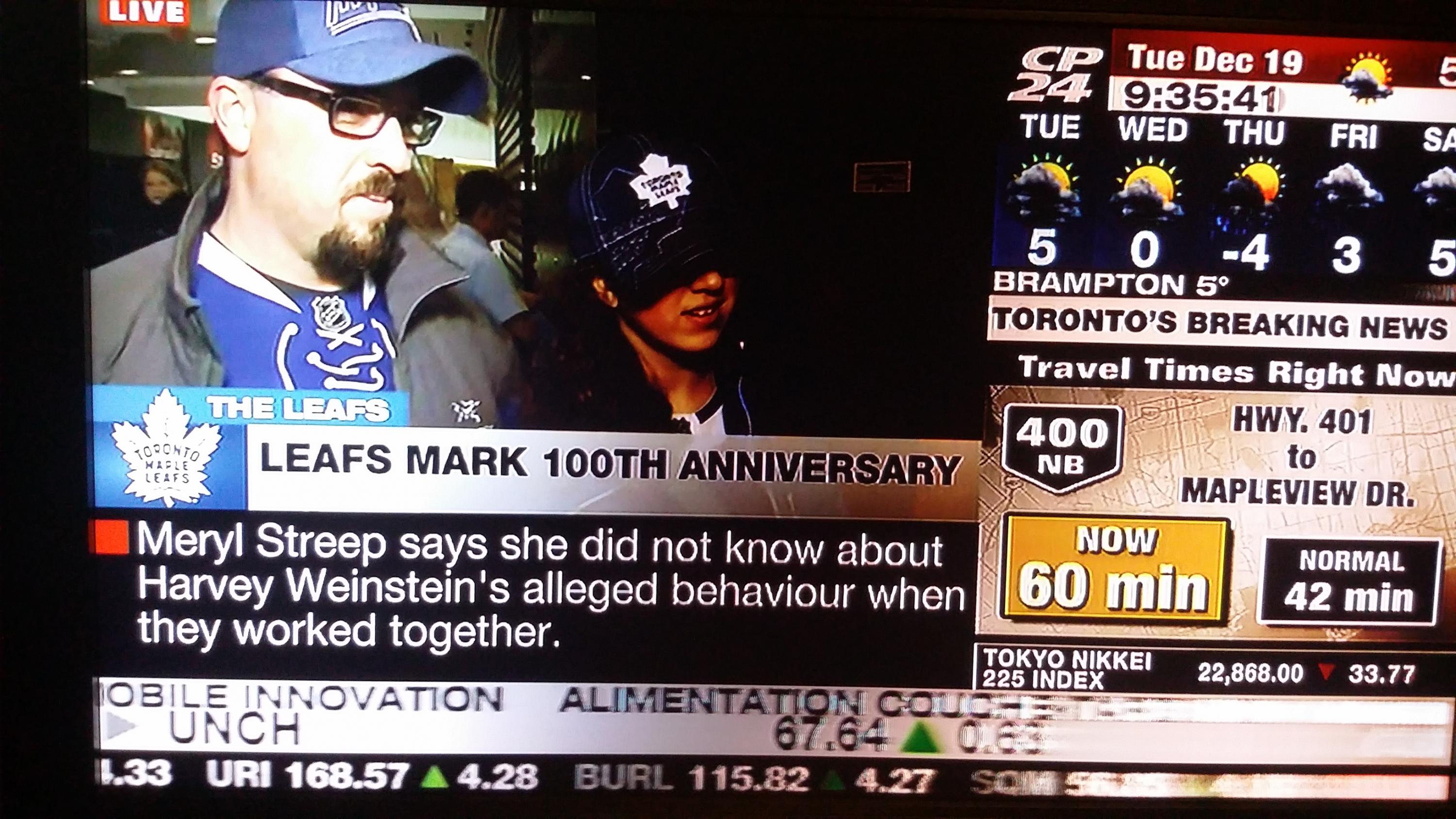

    I got the thing upright (had to make my own stand as it was wall mounted in use). The attached photo is a picture of the display with a news channel that has a scroll bar along the bottom. As you can see in the bottom right corner, the scroll is "slow to build" along with a dark section in the middle. It is likely that it is a panel issue but I was hoping to learn more about the sony design layout as it appears to be quite a bit different from the other makers. Even identifying the tcon isn't obvious by just looking for large flat ribbon interconnect cables. I have to still get better access to the back and take more stuff off to expose the cards / layout.... plus get a better source display to show things better.

      Driver tabs are located on the top of the panel. Take the frame bezel apart a push on the top right driver tab

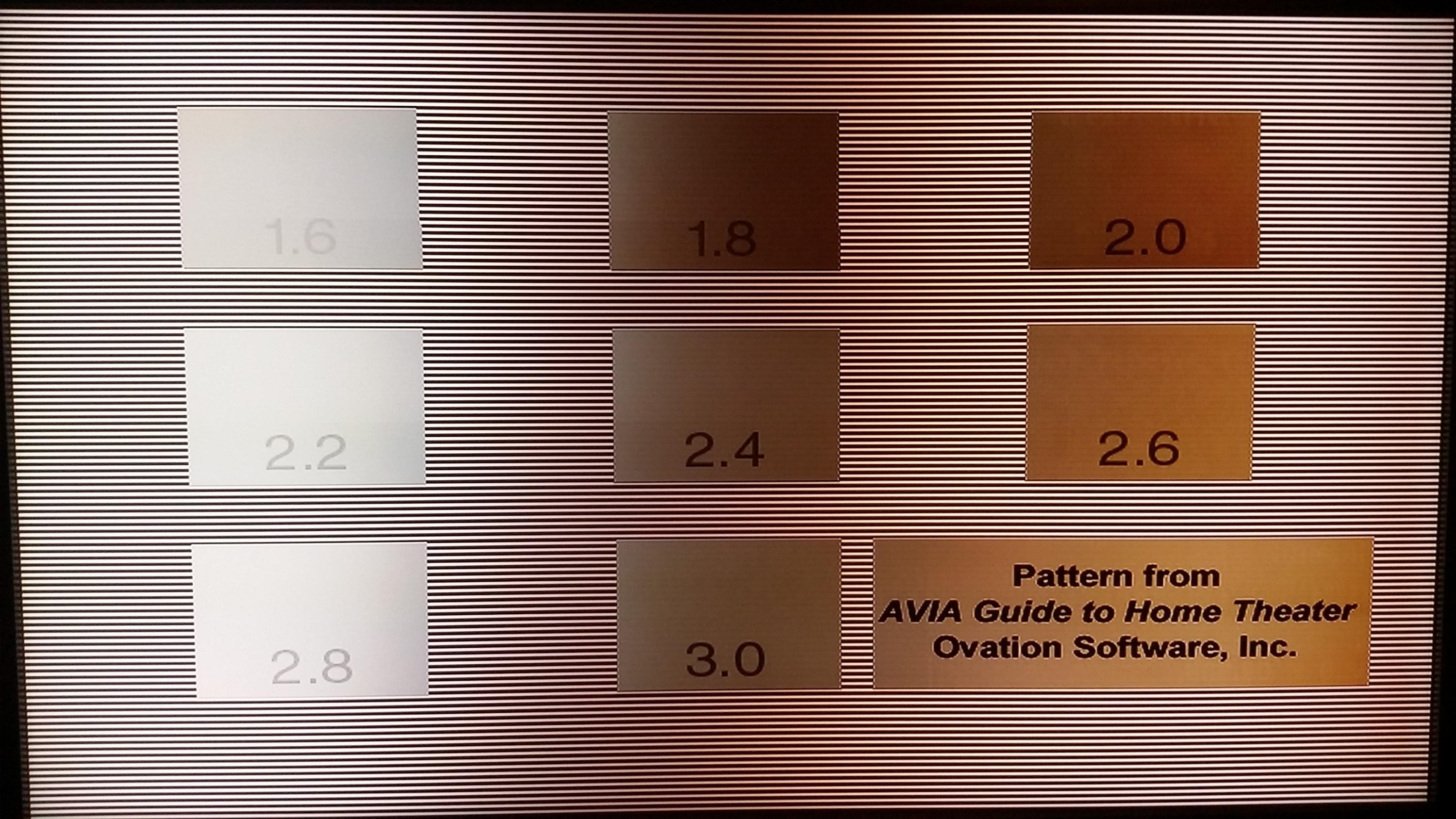

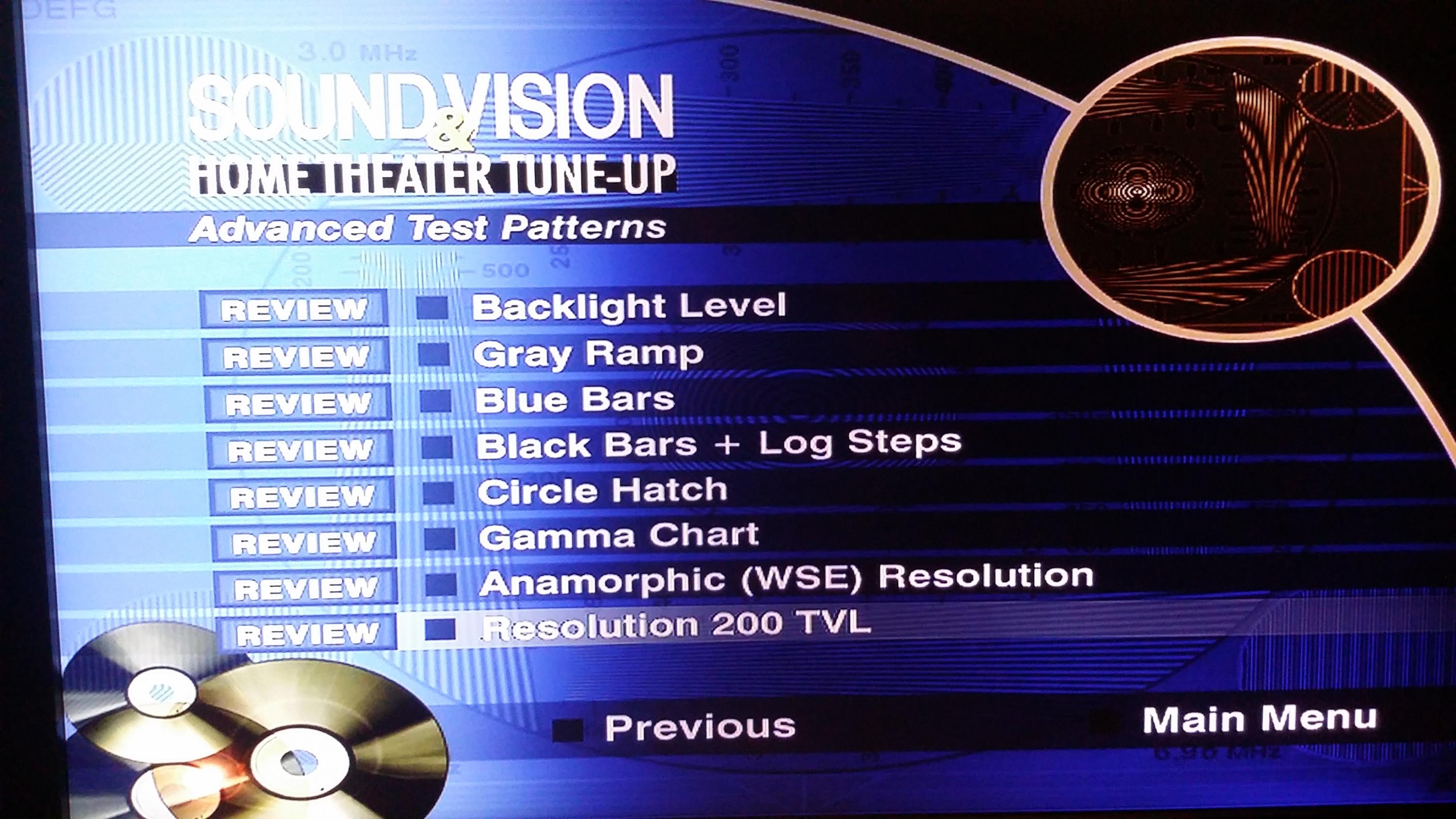

        Here is a couple more screen shots. One is for gamma setup (still). There is the center dark area but no obvious display issue in terms of horizontal or vertical "lining" associated with bad tabs / bonding. The other is a the title page (still) that again doesn't appear to show any "tab" lines but the dark area is obvious. Wondering if this might be more of capacitor issue at the edge boards... IF I can find them... :-)

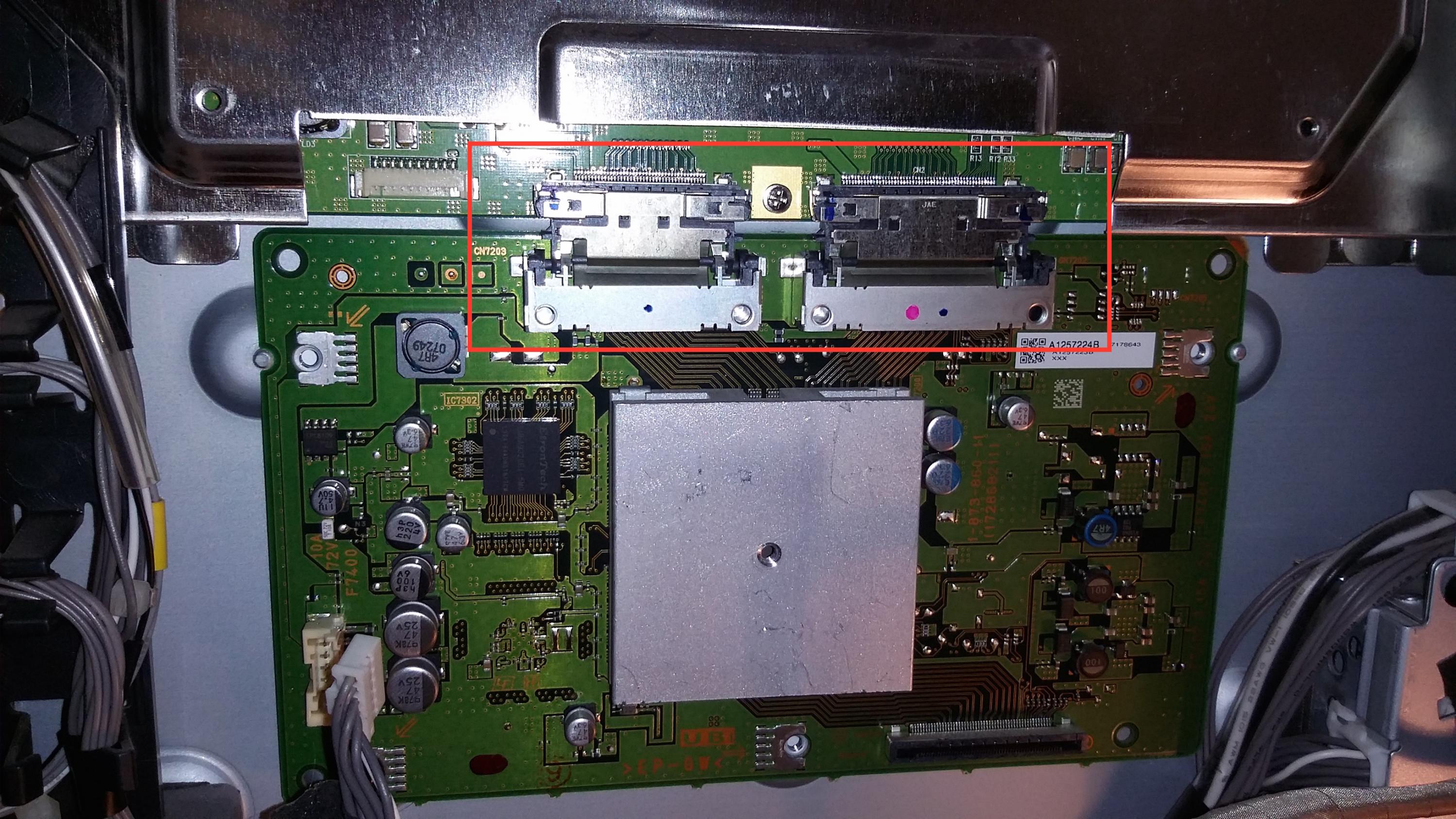

            So I started my journey... taking off some of the "cans" to get at boards. I can now see that the UB1 board forms the "start" of what I would think is some form of tcon function. The LVDS comes into it from the FB1 board. On the "other side" there are two "multi pin" flat "bridging connectors" much like tcon ribbon cables but just connector "plugs" that interconnect the UB1 to a GF1. It is significant effort to get the "can" off the GF1 as there is card holding plastic structure form holding other cards that is in the way. :-( so it will be a bit.
            My question would be: On some of the sharp models that don't have side tabs, people have tried the "cutoff tap" type "save" at some of the tcon ribbons in "strategic point". Is this type of save possible on a Sony design? Where might that "strategic point" be?
            As soon as I get more stuff off the back to give a better view, I will post a picture or two. Based on my view of the display, on the right hand side at even spaces (about 8-9 inches apart), there is a single horizontal line emulating from the right side... basically four lines which to me means it some common input line / driver "point" coming towards the side as opposed to a given driver for the side.... not know at this point how the side drivers are setup or even exist.
            what are the chances (if the "tap cutoff" technique was applicable) that the "strategic point" might actually be those bridge connectors? and maybe just maybe... what are the chances that they might just need cleaning... based on the display of the gamma scale which seems to show that the overall panel looks "OK" in terms of "detail"?

              Here is a picture of the UB1 board. Anyone know how to "disconnect" one or both of those "bridge connectors" highlighted? If its possible to disconnect one at a time, will this cause "disaster" to subtending boards or otherwise in this type of design?

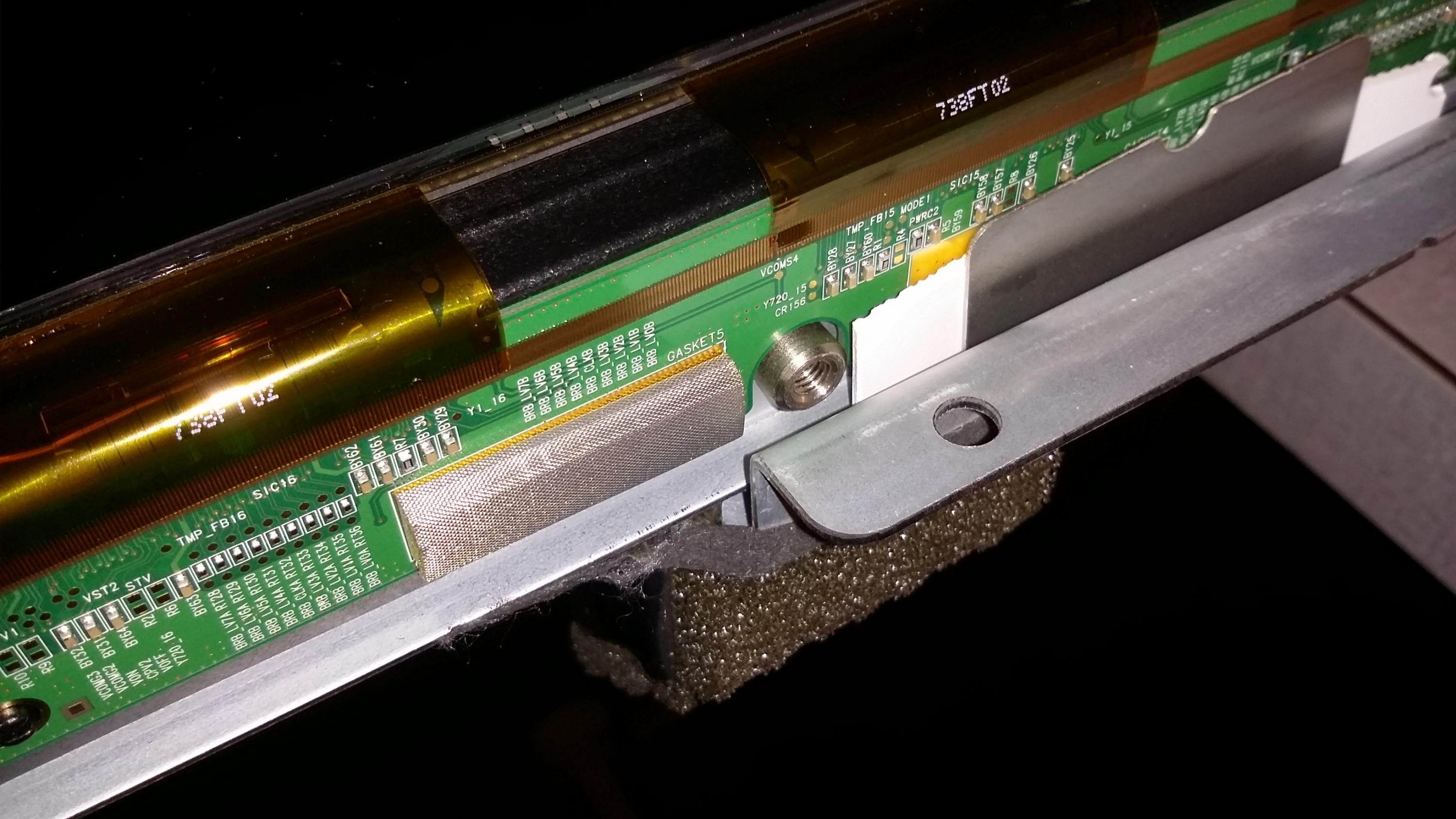

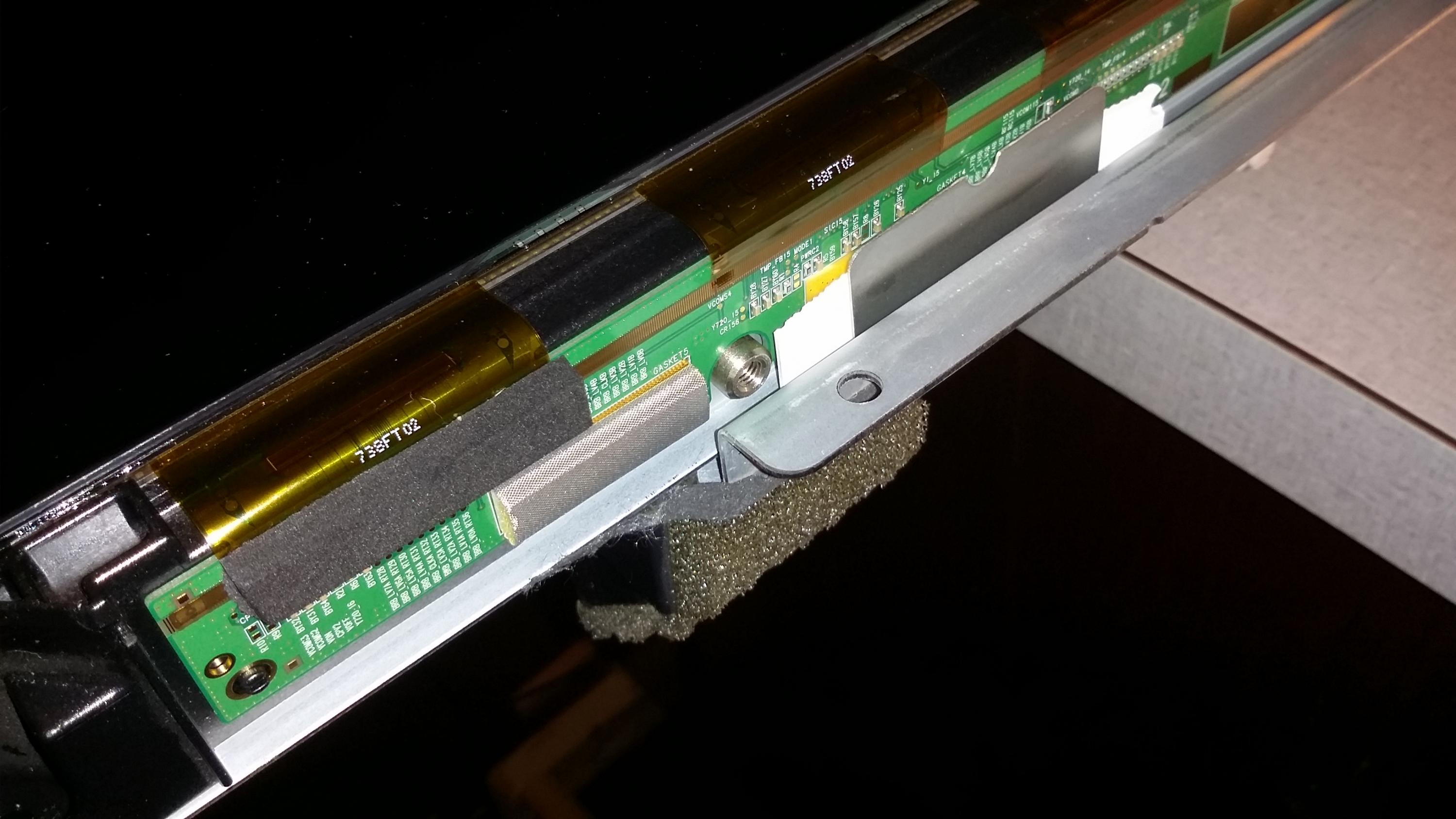

                          ok... basically it took a couple of "flips". Once with face down to remove the internal support arms so that I could take off the top back "stay".... there was a wide piece of aluminized tape running from the top back "can" to the top metal bezel. Once that was folded back, then put the support arms back on and flip the unit now on its back. Then remove the 10 screws around the bezel and lift off. One issue I see immediately is the way Sony has positioned the "soft standoff material" to keep the edge boards away from the metal bezel. Some is place exactly at the "interlock fingers" that hold the bezel "electrically" to the ground of the back plates / "cans". However, the ones on the end two "fingers" are outside of the area leaving the potential for the edge boards to touch the bezel. I think sony had a "secret warranty" on the 46in sets of this model back about 2010 and I wouldn't doubt that it was because of the lack of "padding" to prevent this problem which would have been "catastrophic" if the board did touch.
                          Anyways, putting pressure on the last right tab at the edge board side of the tab allows the display to work normally so that is the issue with one. Just need to find some material to put in there to serve this purpose as I don't really want to use my finger going forward... :-) Looking at the tab, it doesn't look any different from the others, hopefully the driver isn't the actual problem but could be since the pressure on the tab actually causes the tab to bend outward which would mean "away from the back side of the driver" which might then allow the driver to get connectivity on its edges. Not sure how long it will last but the avsforum link was old and not too many reports back of status of sets at this time.

                            Last dum question, what do they refer to / call the material / padding that manufacturer's use for isolation in and around the bezel? Its like a tape, spongy / covered foam with adhesive on one side and some sort of which looks like almost EMI type "conductive" feel to it on the other.

                                thanks. here is a picture of the pad that sony uses. It looks like foam with a covering so that stuff "slides" by it easily... when putting the bezel on. Note in the picture where it is and note I have put some plastic in the "interlock finger" for testing to keep the board away from the "finger". One "interior fingers" (two), sony put that padding on the board so there is "board", "pad", "bezel", then "finger" sandwich... no way for the board to touch. But at the two end "fingers", for some reason they moved the pads out to the edge as opposed to inside the "finger" area. Why not just add two more pads... sheesh, what manufacturer's will do to save some money / time.

                                        Hi, i'm unable to understand all your complex posts due to my english but i've noticed on the last 2 photos , right side, there's a very dangerous flat piece of metal near capacitors and on top of a plastic white piece, have you put it there ? It's really dangerous and it think is not original by Sony. If you have found a setup for the shim to keep the image good , i suggest you to not remount all because this has screwed me in a tv 'cause when tv moved to another room all mounted the defect became by new.
