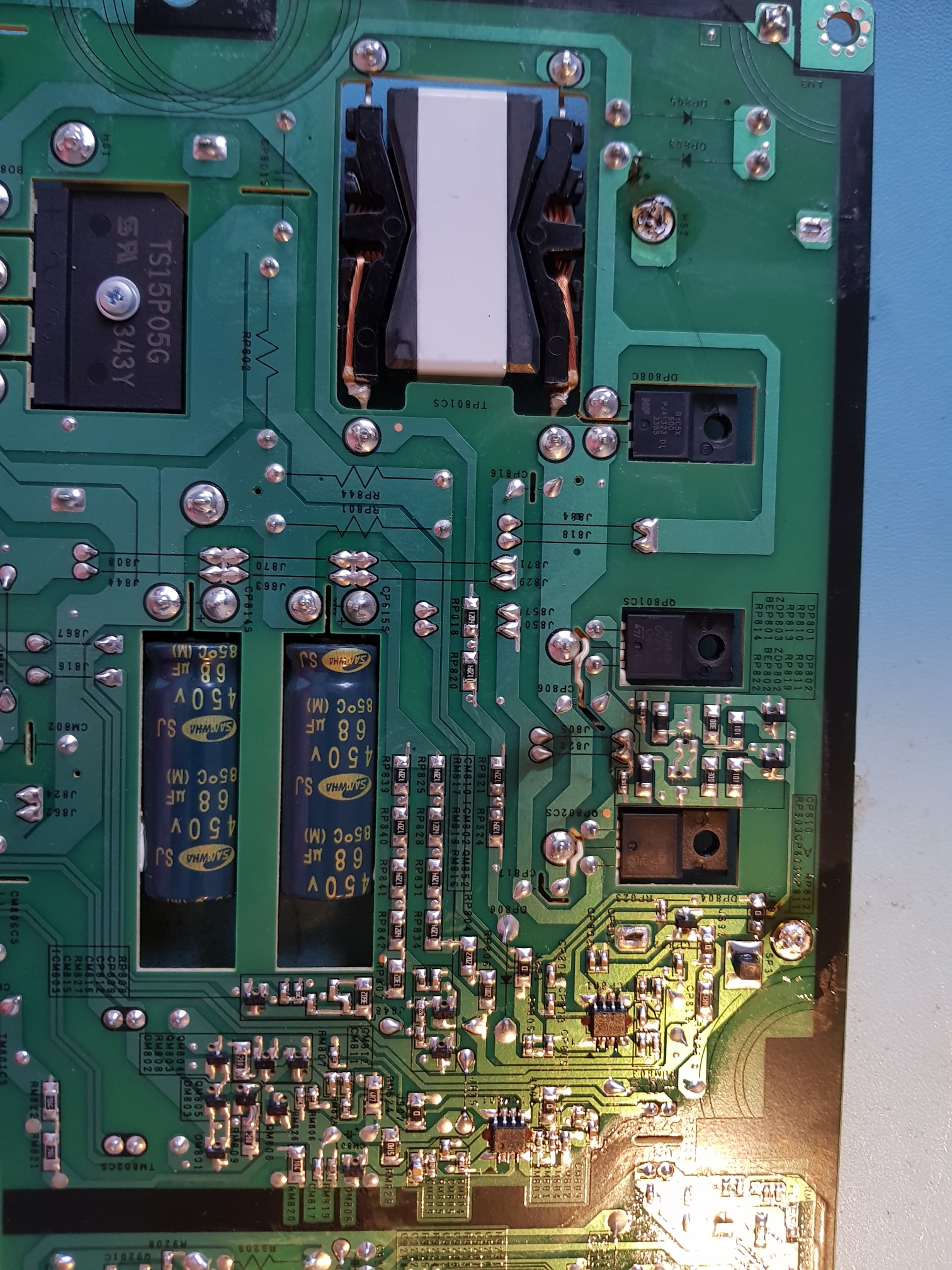

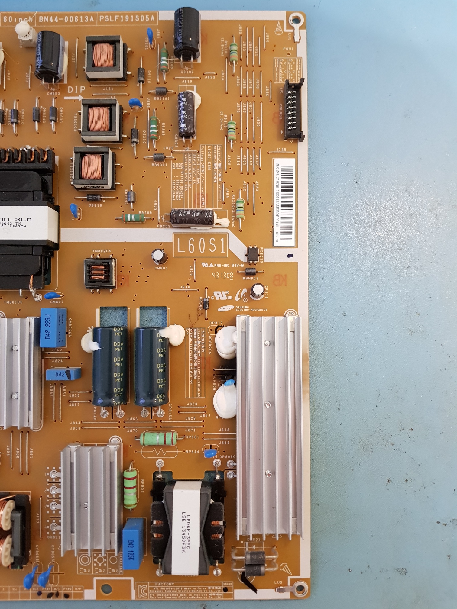

      Re: Samsung UE60F6300AKXXU....Dead
      Images as requested, can you point me in the direction of the bridge rectifiers please.
        Bridge rectifier is component BD8015.
        Using this picture as a reference...
        https://www.badcaps.net/forum/attach...7&d=1513671851
        ... start at the lower left corner, go right just past the center, and then go slightly up. You should see BD8015 board designator right there. It is that 4-pin component with the pins labeled "- ~ ~ +" from top to bottom.
        But really, this is not necessary to do right now. You have a burn mark on your board. Again using this picture as a reference...
        ... look at the heatsink (silver block of metal / radiator) on the right side of that picture: there is black sooth right where the white glue is and where you can see the board designators CP806 and QP802C5. If I had to guess, that's probably one of the APFC MOSFETs that has gone bad. So you will probably need to remove that heatsink in order to get to it.

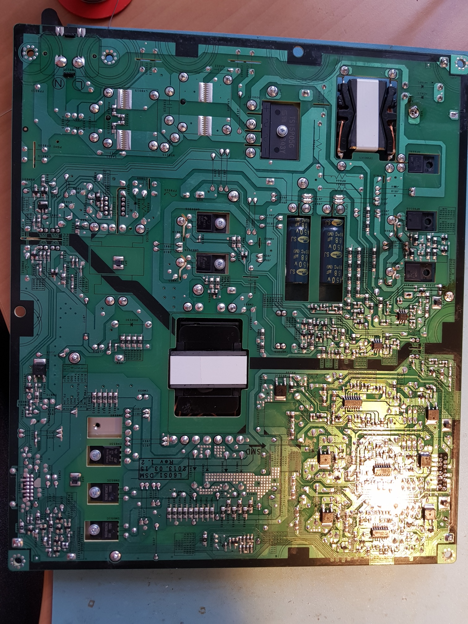

        Please post a picture of the underside (solder side) of the PSU, if possible.

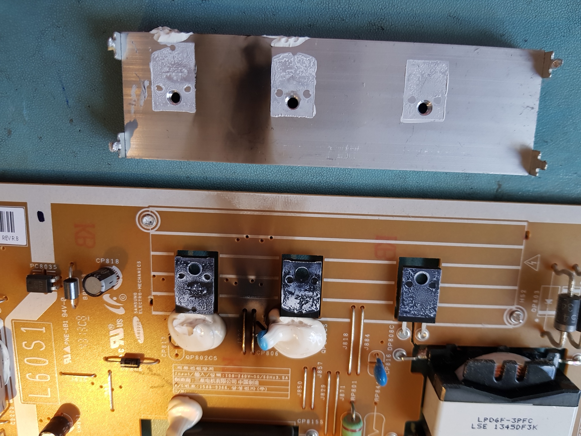

          Hi Guys, Sorry for delay. I have removed heatsink and the three MOSFET's do not seem to be blown, the blue cap near the middle one is slightly split and blacken, so is that the fault? or can a MOSFET blow but not actually blow up?
            yes those capacitors can fail like that can you read the printing on the side of it so you can order a new one
              You should check the FETs are not shorted using a meter but those capacitors can and do fail. Samsung sets are somewhat notorious for it, as well.
                Another failed snubber cap, go with 2KV replacement, the body is still intact so you should be able to read the capacitance value.
                  This looks like a resistor? as it says R 221K 1KV on it?
                  If so I need a 221k that is rated at 1KV? or do I need to look for something else?
                  Thank you
                    It's not a resistor.
                    221 = 220pF. (22 x 10^1)
                    K= tolerance code. In this case 10%
                    Use a 2kV (voltage rating) cap to reduce chance of future failure.
                    So you are looking for 220pF 2kV, tolerance 10% or better
                            Hi Guys,
                            Fitted the tiny blue cap as per Tom's attached link from ebay, fitted it and replaced the 5.0A fuse on PSU and the TV now powers up OK
                            I guess that means it is fixed? but will test it for a few hours.
                            Thank you everyone for you help.
