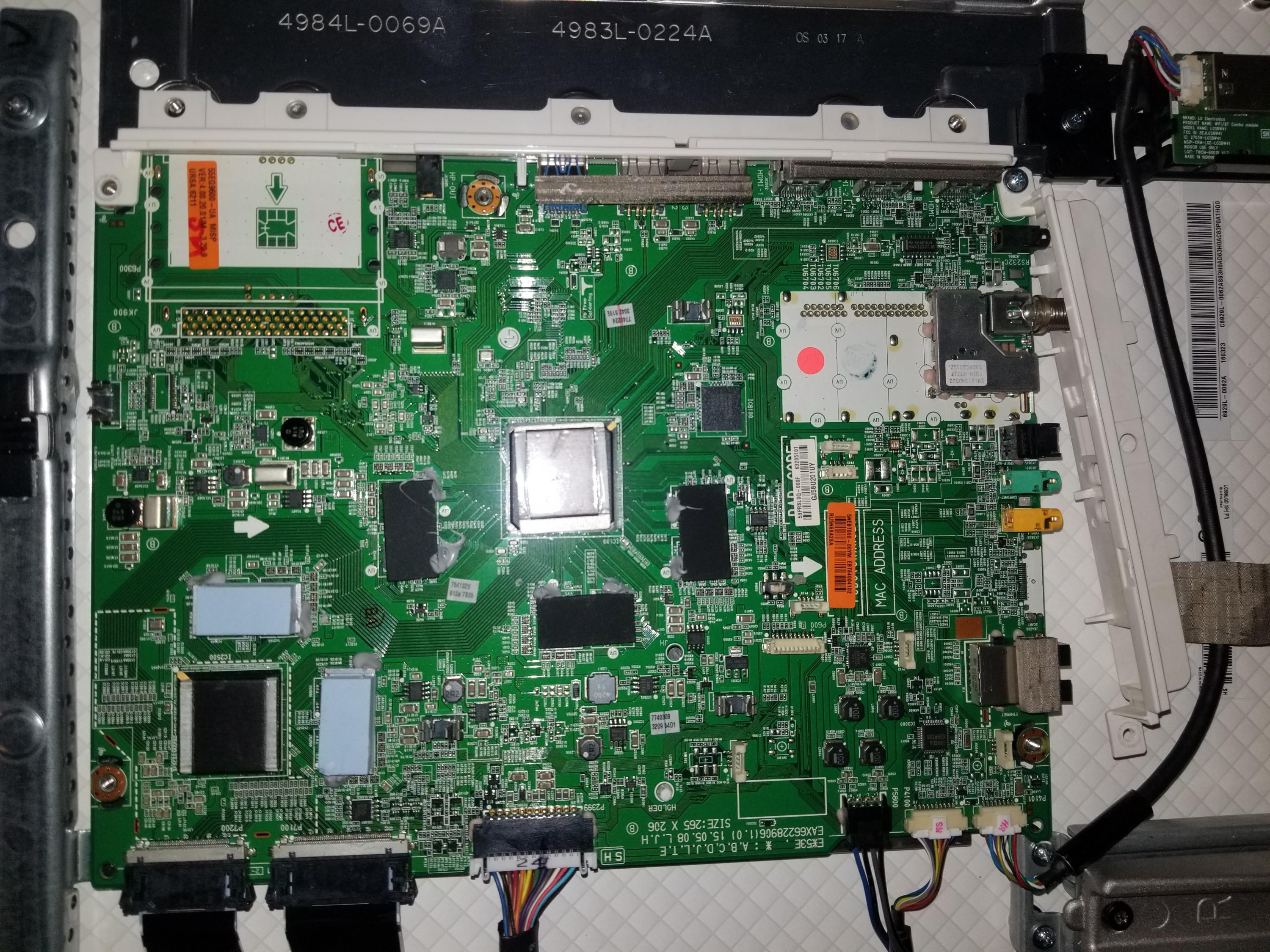

Just picked up a 55 inch LG 4k OLED for $50!

    Re: Just picked up a 55 inch LG 4k OLED for $50!
    I shloukd have noticed this before but the outer ribbon to that area in question on the panel has a solid burn through a trace on the ribbon. Obviously a short. I swapped cables from the opposite side to hear a subtle ticking sound from the tcon. Most likely the end COF is melted.
      What do you mean for short? 0v in diode mode? 0ohm?
        "Most likely the end COF is melted." Don't judge an object that you don't know, i guess you never dismounted a OLED panel, there can be more electronics on that than lcd panels, surely you have to remove that funny "carpet" around the thing.. (i mean that strange white texture )
          But on the tcon there's a product. date, is 2015 or 2012? Is there any SM?
            I will investigate further however I don't know how to pull off this back cover
              Ok. Believe it or not I scored a NOS panel from ebay!! Before I replace the panel I am going to check different capacitance readings between the 2 panels and see if I can straighten this 1 out 1st but somehow I managed to find one out of Utah for 300 bucks unbelievable!
                Got the panel. The readings on those 4 caps on the panel that were 80 ohms are 250 ohms on this panel. Same as other side. However I still have a mainboard issue.
                Nothing while pressing power button. Pressi g power on remote yields a flashing power LED. That's it
                Only 3.5v to mainboard. Nothing being sent out.
                Can manipulate panel on, power on, and 12v,24v on with resistors. New panel lights up.
                No 3.3 to VCC of eeprom. As a matter of fact, no 3.5 or 3.3 missing in a lot of areas.
                Nothing on voltage regulators, nothing getting even slightly warm, even after forcing ps_on
                  Btw I don't get test patterns with LVDS disconnected. Not sure but guess this tcon doesn't support that? Panel came with tcon.
                  Pretty sure on old panel/tcon it was attempting to initiate test patterns.
                    "New panel lights up" with which image?
                    "No 3.3 to VCC of eeprom" which eeprom? marking?
                    "no 3.5 or 3.3 missing in a lot of areas." ???? Are you forgeting a comma?
                    "Nothing on voltage regulators" Are you meaning only single chip linear or dc-dc switching p.supplies?
                      When I say new panel lights up it esentially primes where you can see the pixels illuminate with a very dark glow.
                        There is no VCC to any pens on any of the voltage regulators or Eeproms. Even when I force power supply on I get 12 V and 24 V all over the board but yet nothing going into any of the voltage regulators or eeprom. I have searched all areas of the board for fuses and inductors and they all test good so I'm starting to think that there is something else going on here
                          Is not very useful to test an inductor, i've never found or hear one defective, also testing dc-dc regulators seems not useful 'cause your problem is to start the tv, maybe the standby processor is embedded in the main cpu and uses an external flash spi to run the sw. Check if there's that flash and if is powered, usually it has a paint mark on it. Given that the standby led is lighted, the cpu is working but maybe it needs a special procedure to fault reset or has no good sw on the spi.

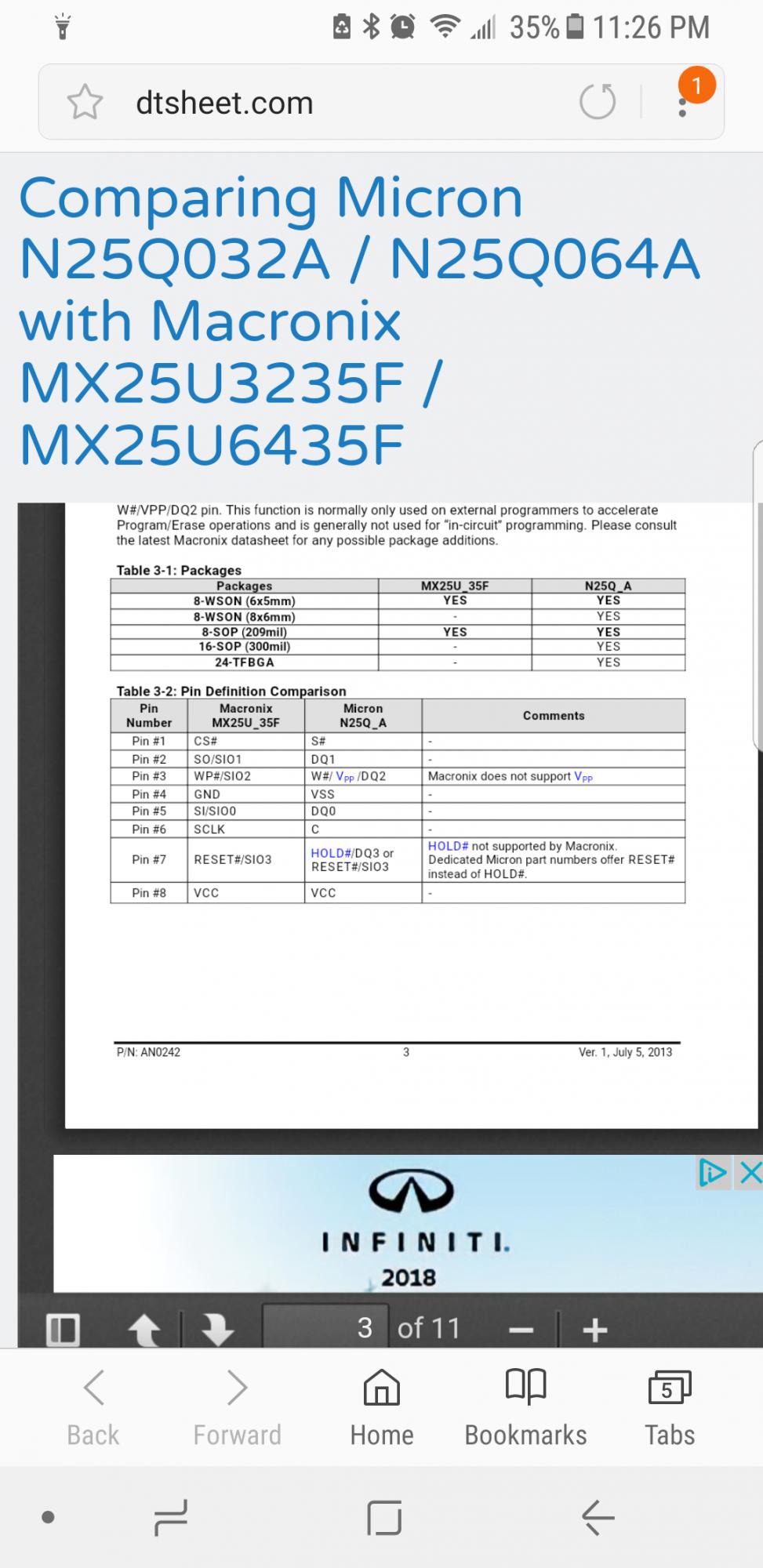

                            That's what I'm figuring it does use an external Flash eeprom. I believe there some reset procedure as the guy I bought it from said it will only turn on so many attemps with a bad panel until it goes into this procedure or mode.
                            Uses a Macronix M25Q032A. Already tried resetting by ground to reset pin 7. However there is no VCC to the eeprom so efforts are pointless.
                              "Uses a Macronix M25Q032A. Already tried resetting by ground to reset pin 7."
                              What is this reset?? Are you trying to erase the standby software? Why??
                              "I believe there some reset procedure as the guy I bought it from said it will only turn on so many attemps with a bad panel until it goes into this procedure or mode. "
                              Sorry i can't translate...
                              Anyway aren't you able to follow a bit the path of the 3,5v in input to where it stops?
                                Yes I followed it in to the main processor and the NV ram modules but nothing coming out to Eeprom
