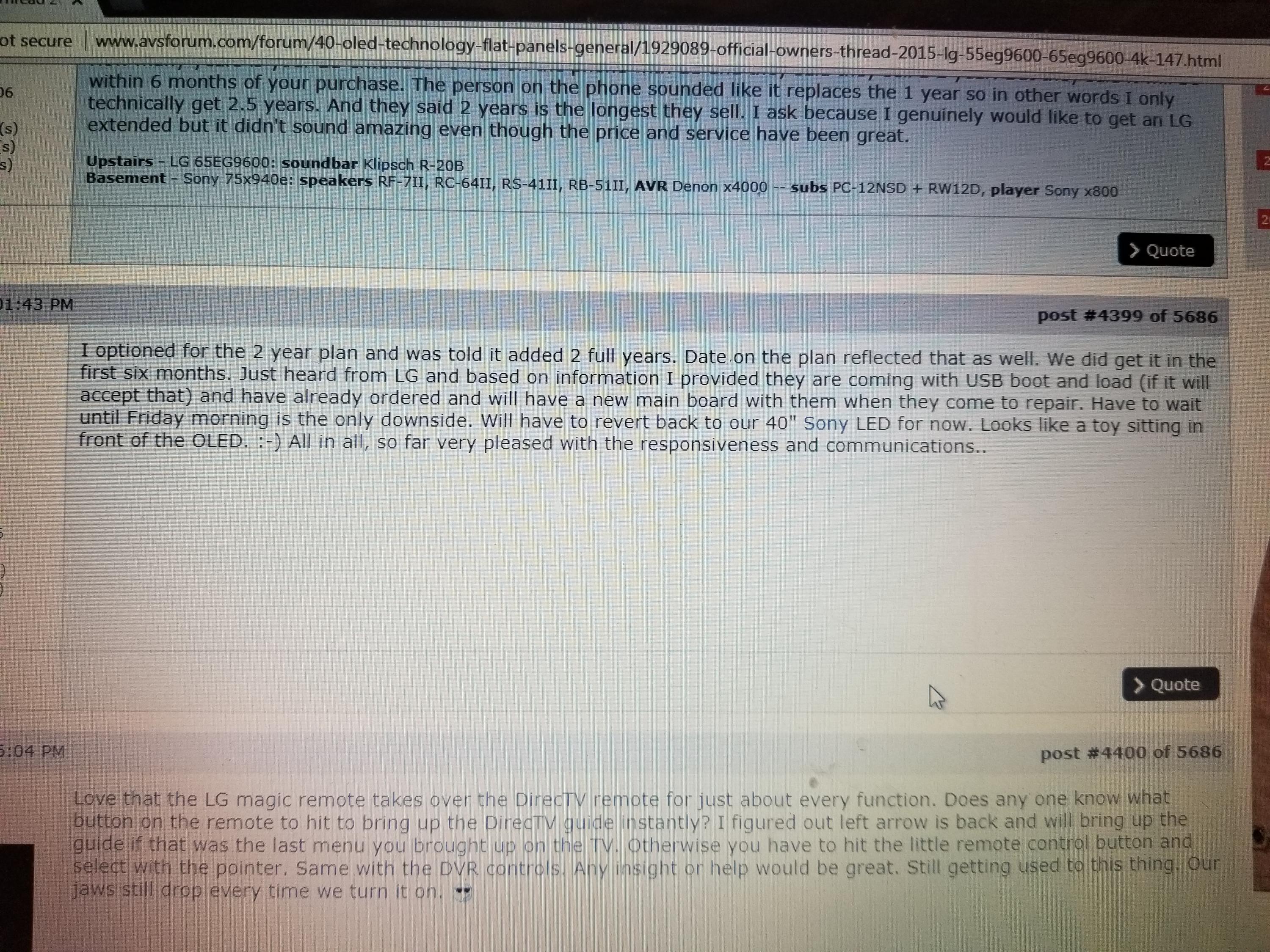

                                    Interesting read from someone else that had an issue with this set over on AVS.
                                    According to this guy apparently even replacing the main did not straighten the problem out even for a second when it had a failed panel.
                                    But I2C serial communications don't come up at all Even if the tcon board was reporting a problem with the panel the main board doesn't have any voltages to register this.
                                    Funny how the guy mention that LG is going to show up with a USB boot and load. And also two main boards and no even attempt to power up
