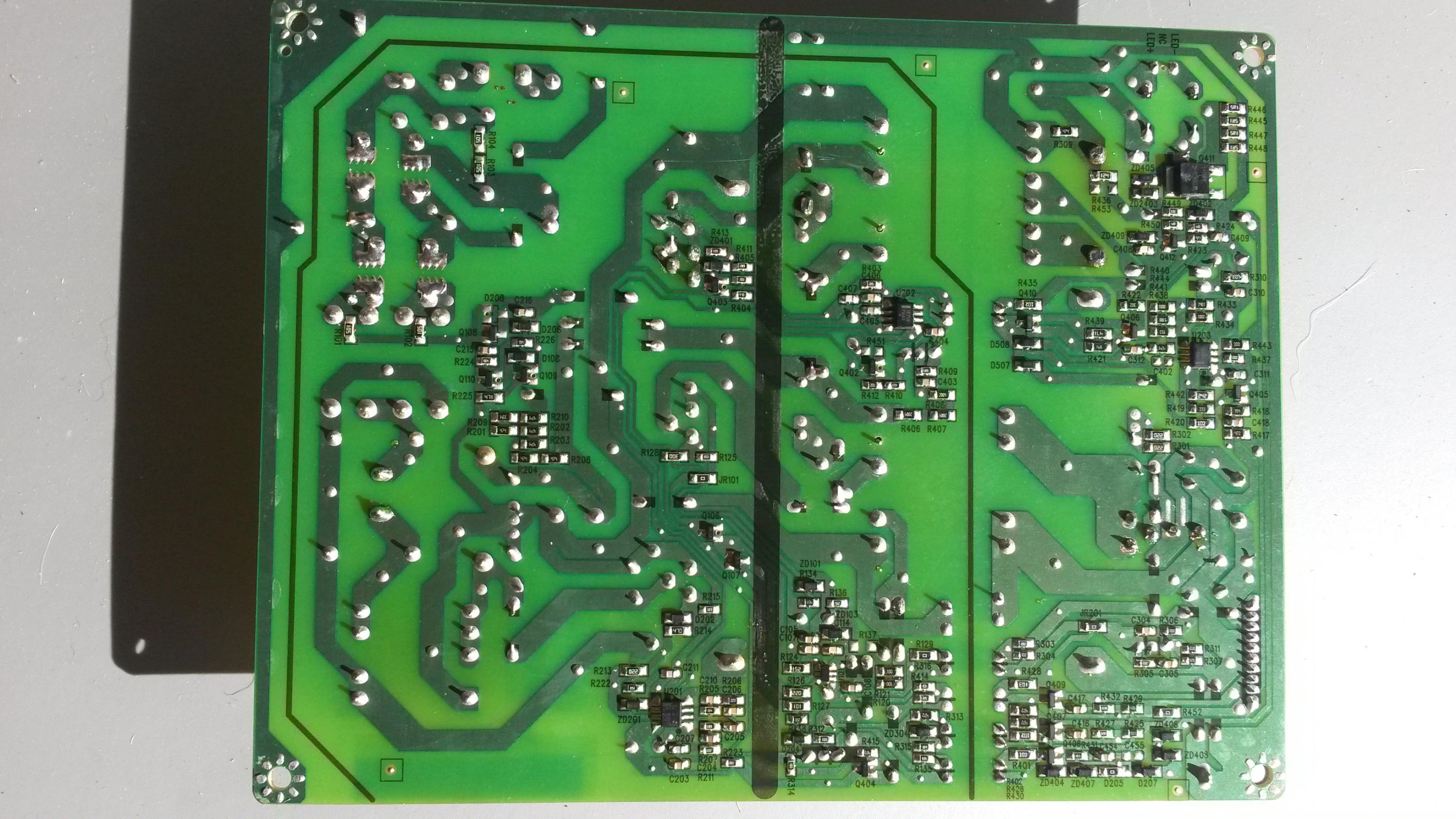

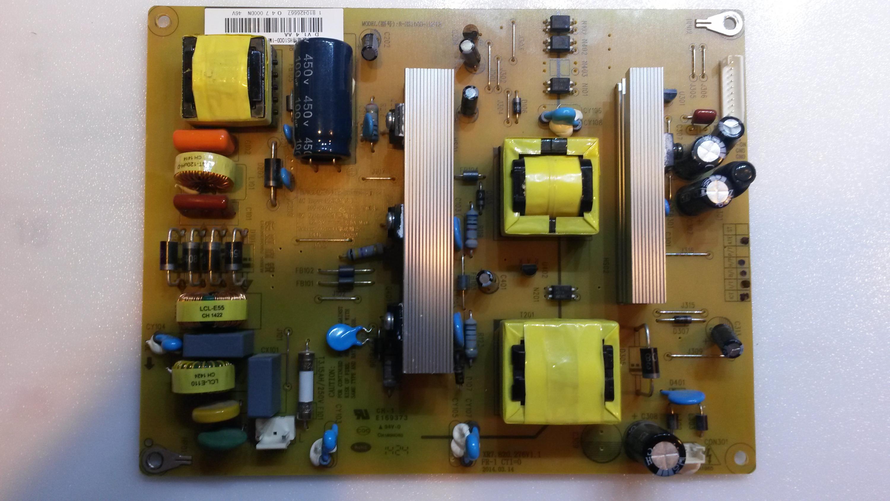

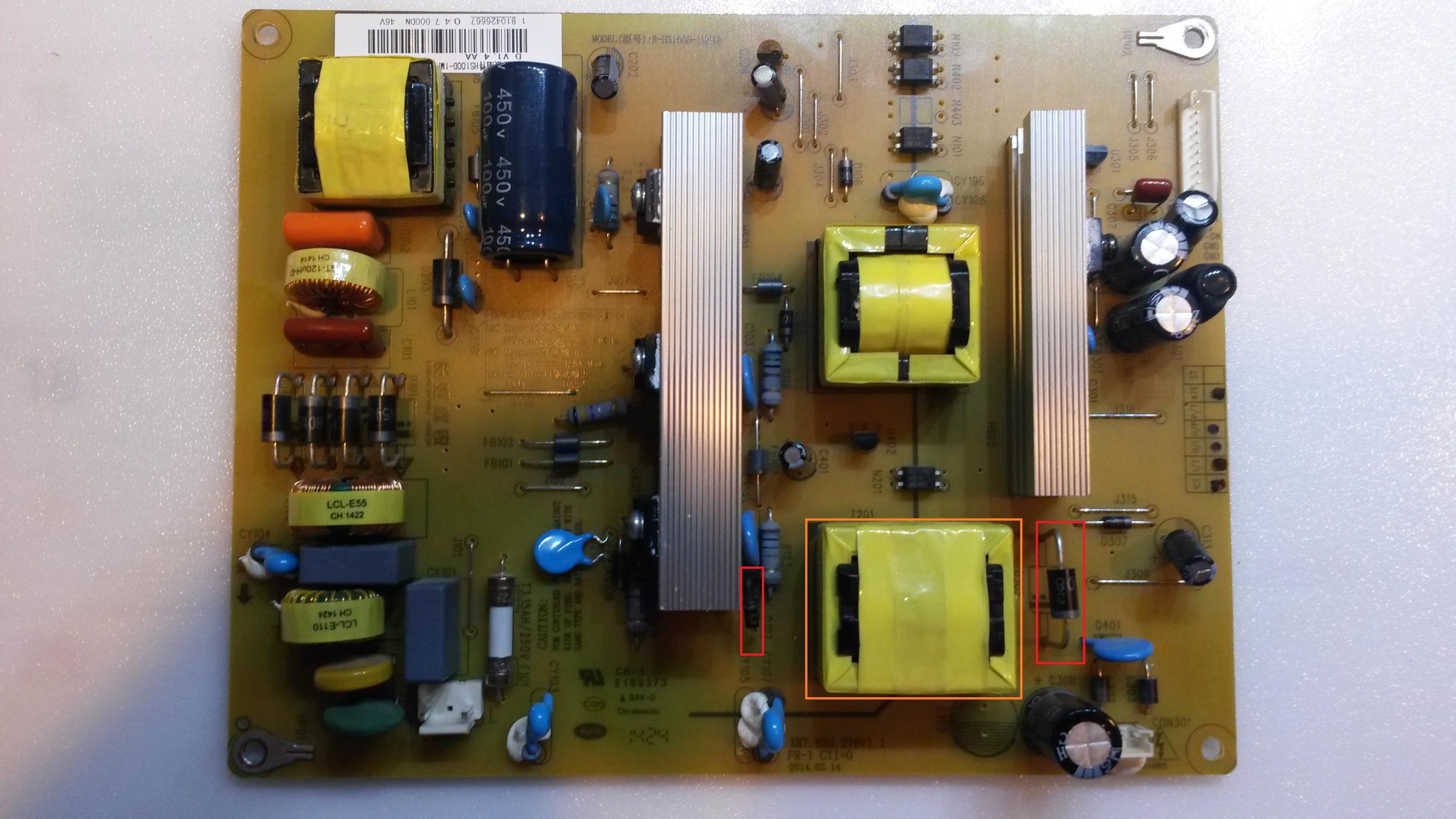

    Ok this started as a no power issue. I replaced diodes D107, and D305 that were blown. That solved the no power issue. Now when I power the tv on T201 is buzzing.
    Any suggestions as to what might be causing it to buzz?
    Re: Hitachi LE42H508
    The output of that section looks to go inside the panel where the backlights driver circuit board is, you need to look at that board, I cannot see really well in your pictures.
      Thanks budm. Which picture do you need clearer, I will get it for you?

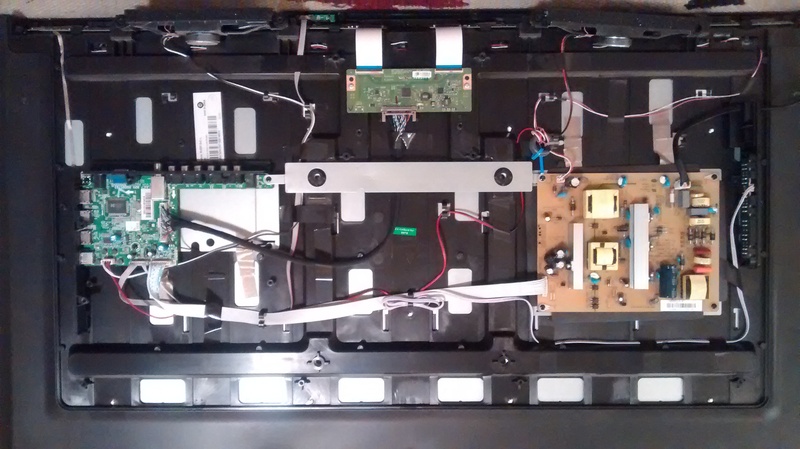

        Well I took the lcd off and looked, there is no other board inside the panel. Wire off the psu goes straight to the leds. I now have no backlights at all. The pins for CON301 were loose. I resoldered them, and no change. Even with the backlights not working, the transformer still buzzes. When I disconnect the wires for the leds, the buzzing stops.
        Could it be some bad leds causing this problem?

              I just look at you soldering works, very bad cold solder joints on the diode you replaced, you should also check the other diode you replaced also.
              The transformer legs can also use some re-soldering too but you need to use flux with it.
              Did you use flux and 40W Iron?
              Once you fix the soldering works, then you need to report the Voltage reading between chassis GND against white wire, then against red wire each time you turn on the TV.

                Ok, redid the solder joints on both diodes, and the transformer.
                I used a 65W, and flux.
                Voltage between red wire and chassis GND is 21.9vdc.
                Voltage between white wire and chassis GND is 9.6vdc.

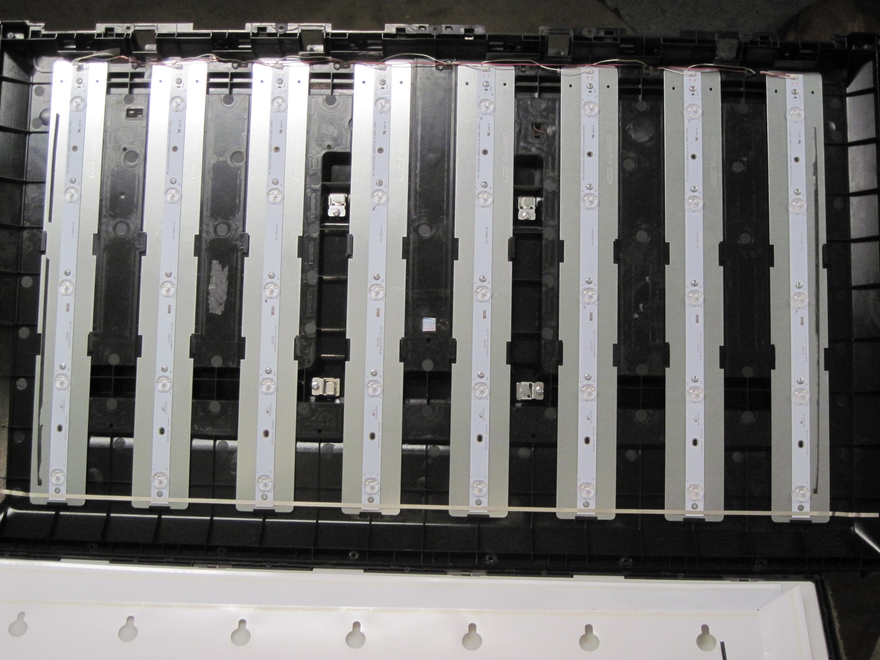

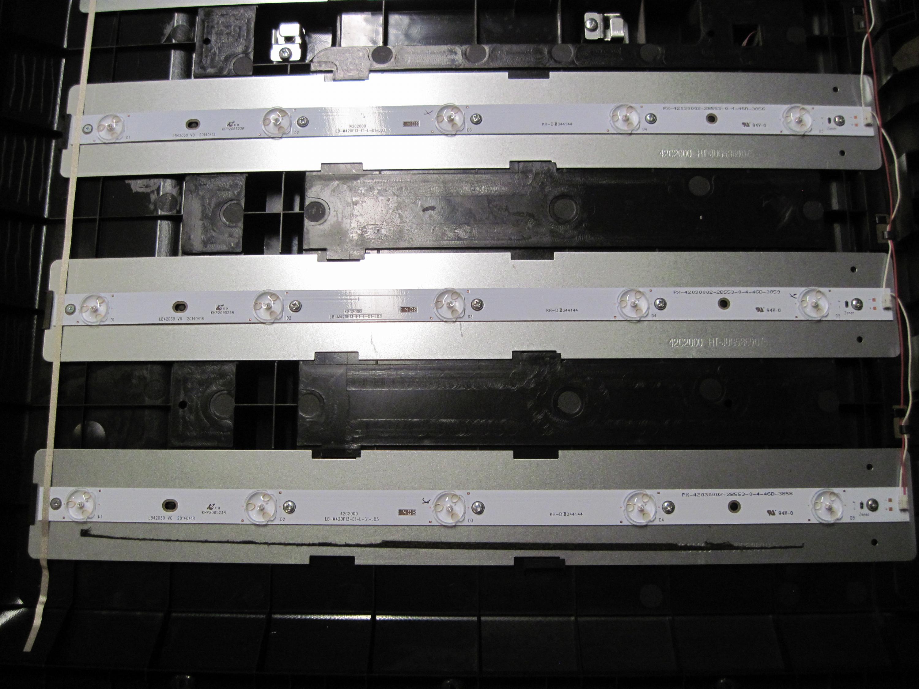

                              Please take good picture of the LED strip assembly and upload them for the record.
                              • Fisher77
                                • Feb 2016
                                • 229
                                Ok there is 40 LED's total.
                                There are 6 strings that have 1 blown LED each.
                                There is a Zener diode on each string, and they are all blown. I measured them in diode mode, is that the correct way to measure a Zener?
                                Question is what blew the Zener's?
                                Zeners have N2 on them, any idea what they are?
                                The LED's were working before I took the tv apart yesterday. I checked for anything shorted as I took it apart today, and did not find anything.
                                  OK, the ZENER is connected in parallel with each strip of LED strip for protection due to wrong power supply reverse polarity connection so the Zener will blow up, and it also clamp the Voltage down if the feeding Voltage has correct polarity but too high of the Voltage is applied to the strip.
                                  Most LED strip do not have that Zener diode.
                                  Did by any chance you try to power up the LED strip when you trying to test each LED strip?
                                  "The LED's were working before I took the tv apart yesterday." So how did you find out the LED's were working since the LED power supply was dead due to blown diode?
                                  • Fisher77
                                    • Feb 2016
                                    • 229
                                    I tested each led individually with diode mode on my multimeter. It lit them dimly, except for the blown ones of course.
                                    After I replaced the two blown diodes on the PSU yesterday, the tv powered on with the backlights, but the transformer was squealing. After I took it apart, and put it back together, the LED's never lit again. It's weird. I looked at all the wiring, nothing was shorted.
                                      So right now if you do the resistance between the two pins on each LED strip individually, how many of them are showing low resistance?
                                      • Fisher77
                                        • Feb 2016
                                        • 229
                                        I tested the resistance on each strip.
                                        4.7 ohms
                                        3.8 ohms
                                        37.5 ohms
                                        51.6 ohms
                                        235.1 ohms
                                        138.3 ohms
                                        13.9 ohms
                                        137.8 ohms
                                        I assume the 2 with less than 5 ohms are shorted?
