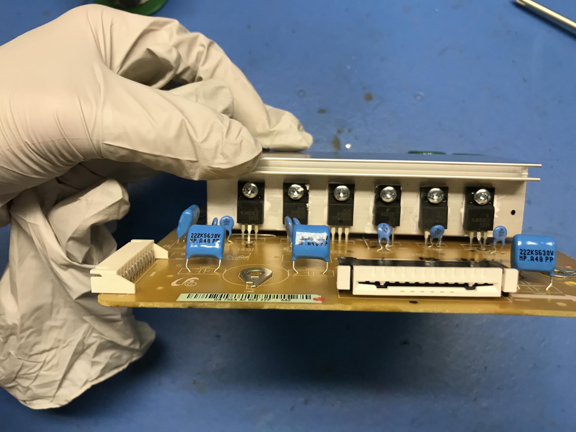

        I ended up taking the X and Y boards apart.
        The Y-sus has a dead short between all of the IGBT pins at locations Q5003, Q5007 and Q5008. (MPN markings say "RJP30E2" - 360V, 35A, N-Channel IGBT). I removed the heatsink and unsoldered the parts. They tested bad as it still showed a dead short between the parts. The board pads show an open loop, thus confirming it was these three parts.
        I did the same thing for the X-sus - i found a dead short on the two IGBTs labeled Q4007 and Q4001. (MPN markings say "RJH30E2" - 360V, 30A IGBT).
        I purchased replacement parts this evening from eBay - qty 5 each (with a few to spare) - $9 in parts.
        -Thomas

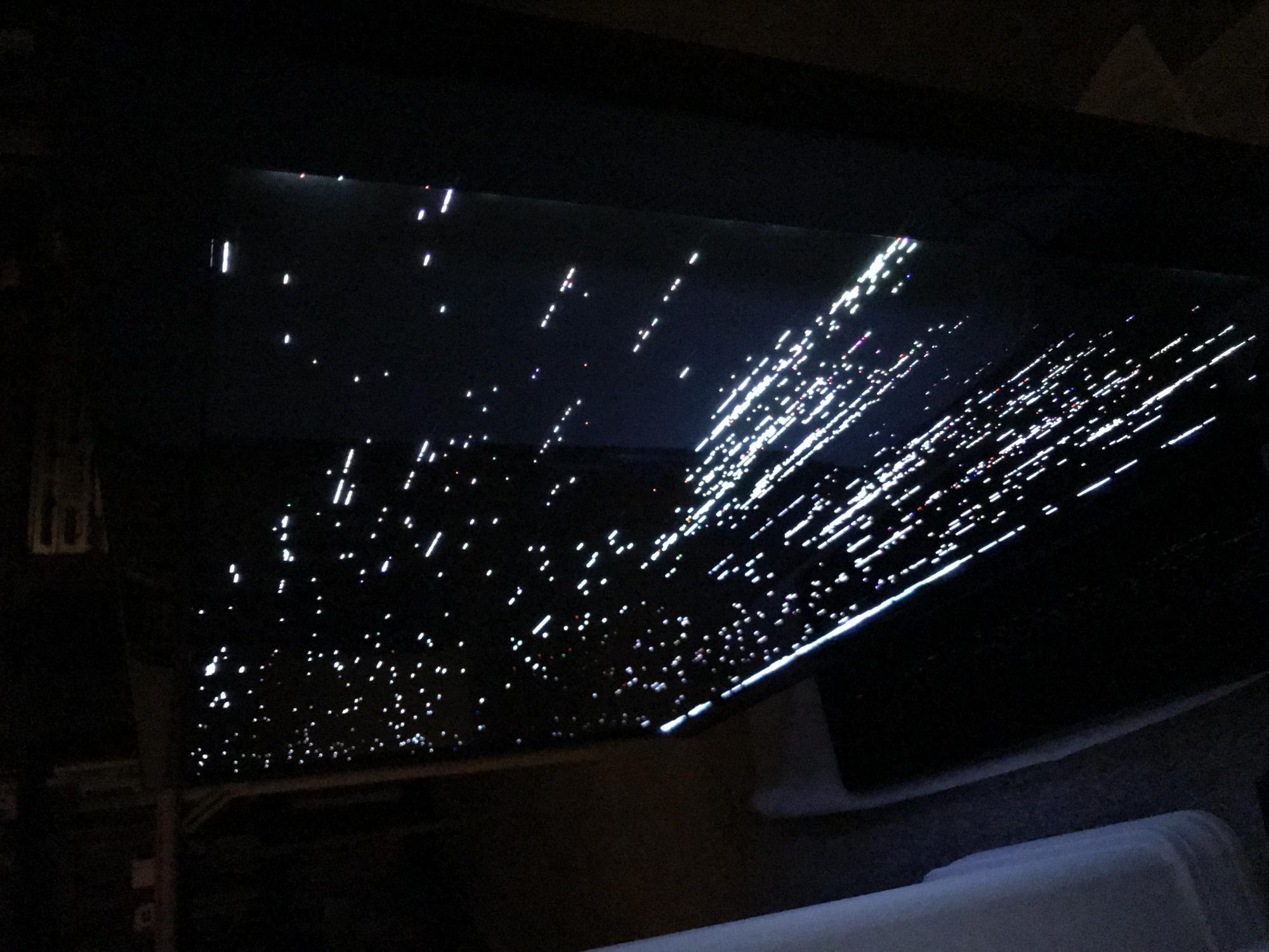

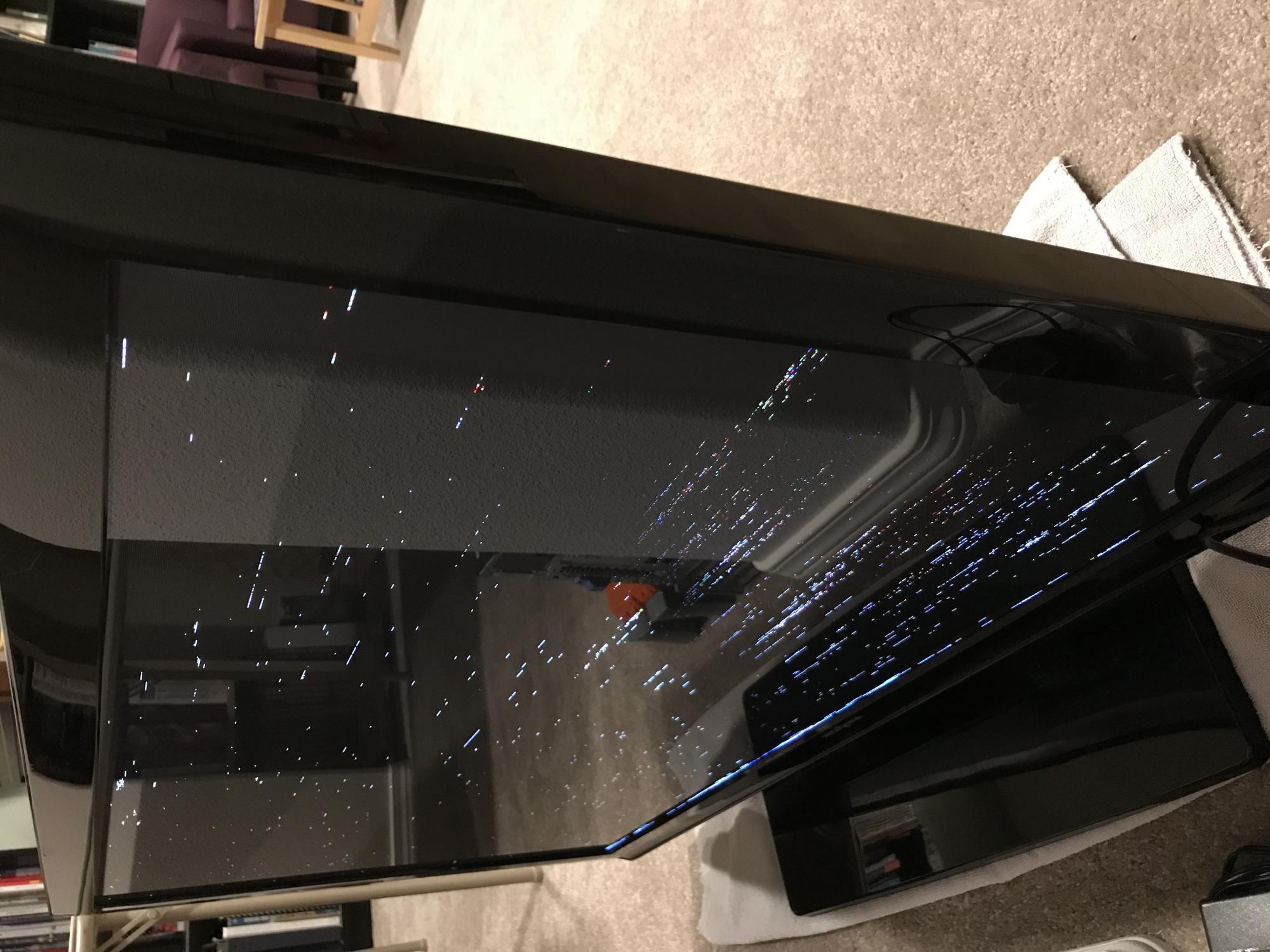

          Hi all -
          I received the replacement IGBTs today. I installed them and checked for shorts - none found.
          I installed the y board, and connected the power from the main power board. Vs and Va ramp up then shutdown since the other boards are not installed. I then plugged in the x board as well. The power boards are up - vs and va are stable (210v and 54v per the panel sticker).
          I turned it off and waited until the caps discharged then connected the y buffer board. I turned it back on and the power rails still appear to be good. I shut it off again, waited, then connected the ribbon cables from the PDP to the power boards. I made sure the LVDS cable was disconnected and forced the panel into the test mode by jumpering across Pins 3&4 on the T-CON.
          but instead of getting a happy test pattern, I get what is shown in the attached image. What is the likelihood this is a buffer board problem? Or is it the panel?
          -Thomas
