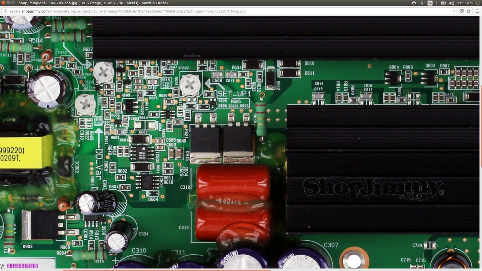

              Here's a shot of the area in question. Now I'm as good as colour blind so my wife tells me the resistor is vvgg and my daughter tells me it could be rrgg. Only one can be right, which do you think it is ?
              If it is rrgg then it's 2.2ohm instead of 7.7ohm. Would putting an 11ohm resistor in place of a 2.2 ohm one be sure to cause it to go open ?
              And the two parallel diodes to the left of the resistor test about 0.3v forward and open in reverse.

                Thats rrgg, 2.2 ohm. Could be the reason, also I thing those are high wattage. what wattage did you use? I think the original is a 2 watt
                  Re: LG 50PS30 Image Problem
                  Yeah, definitely red-red-gold-gold. 7.7 ohm (violet-violet-gold-gold) would be a very unusual value. It needs to be the right value. A big resistor like that is dissipating quite some power. An incorrect value will increase power dissipation by 5x.
                  What you can try doing is measuring the voltage across the resistor but you must use a good multimeter as a cheap one will pick up switching noises from the Y-sustain board. If you measure more than a volt or two, then there's a fault somewhere drawing much more current than it should.

                    Ya I freak I had replaced it with the same 2 w rated resistor, just a different value thanks to my wife seeing violet over red - thanks for clearing up the value.
                    I had a look around the board again and touched up the top-side joints on two mosfets in the vicinity that looked iffy. Then because I hadn't yet read the latest posts here I bodged in a 10 ohm 5 watt resistor ! Running good again but will recheck the value to make sure even that one is not increasing.
                    Is there a problem running a higher wattage resistor, I mean is it meant to act as a fuse should something go wrong ?
                    Also, does that resistor set the base range for the set_up trim pot, meaning if I can still dial in a good pic would it be ok to leave it ?
                    Will read the voltage across it, tom, later this afternoon.
                      #30
                      The resistor is probably important to set up some part of the set up circuit. An increased value is likely to cause excess power dissipation and the resistor will eventually fail as a result.

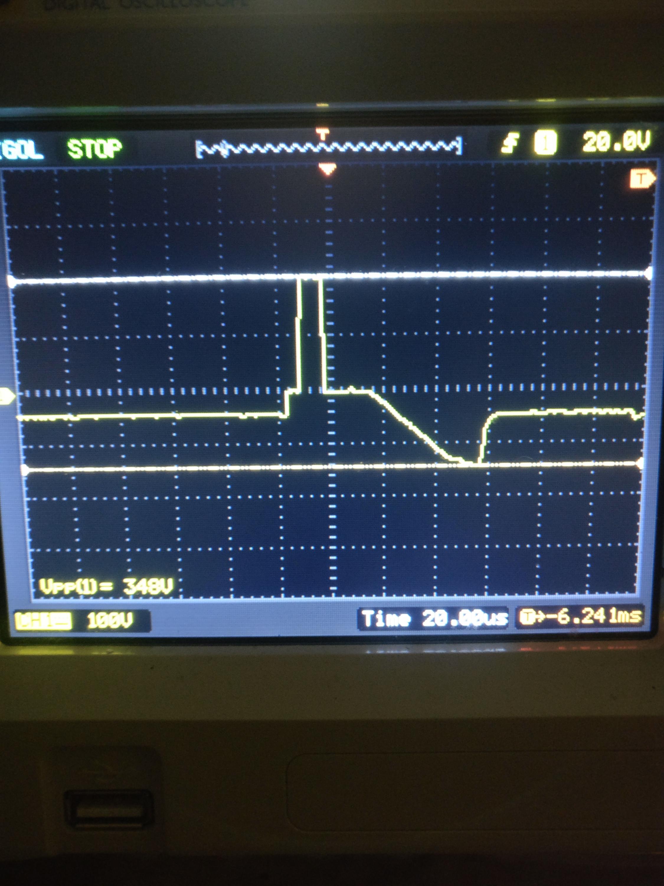

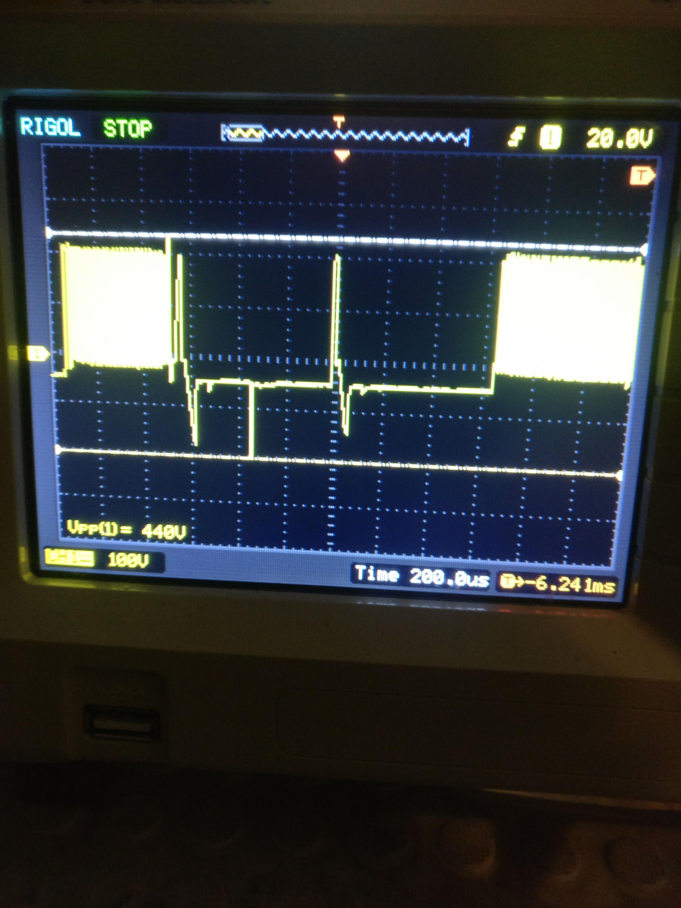

                                    The resistor value is holding steady and the picture is still looking good. Here are the scope images I just took using the same scope values. I don't see any changes. Am I not capturing the wave properly ?
                                      #38
                                      You probably want to capture the end of the sustain pulse here, as this is a reset pulse...the other one may be something different, different plasma panels have different drive primitives.

                                        Well the set has been zipped up again but there does seem to be a difference between the wave you indicate and the earlier one I posted before the repair. Not much in the way of resolution but they do look different. For future reference, which part of the wave is the set_up ?
                                          #40
                                          The ramp from 0V to Vs, or 0V to a higher voltage than Vs on older sets (often called Vset or Vsetup, around 300-400V) is the set-up ramp.
                                          Plasma TVs past 2008-2009 or so use reduced-voltage Vset, keeping it below or equal to Vs reduces the cost of the Y-sustain driver circuit.
