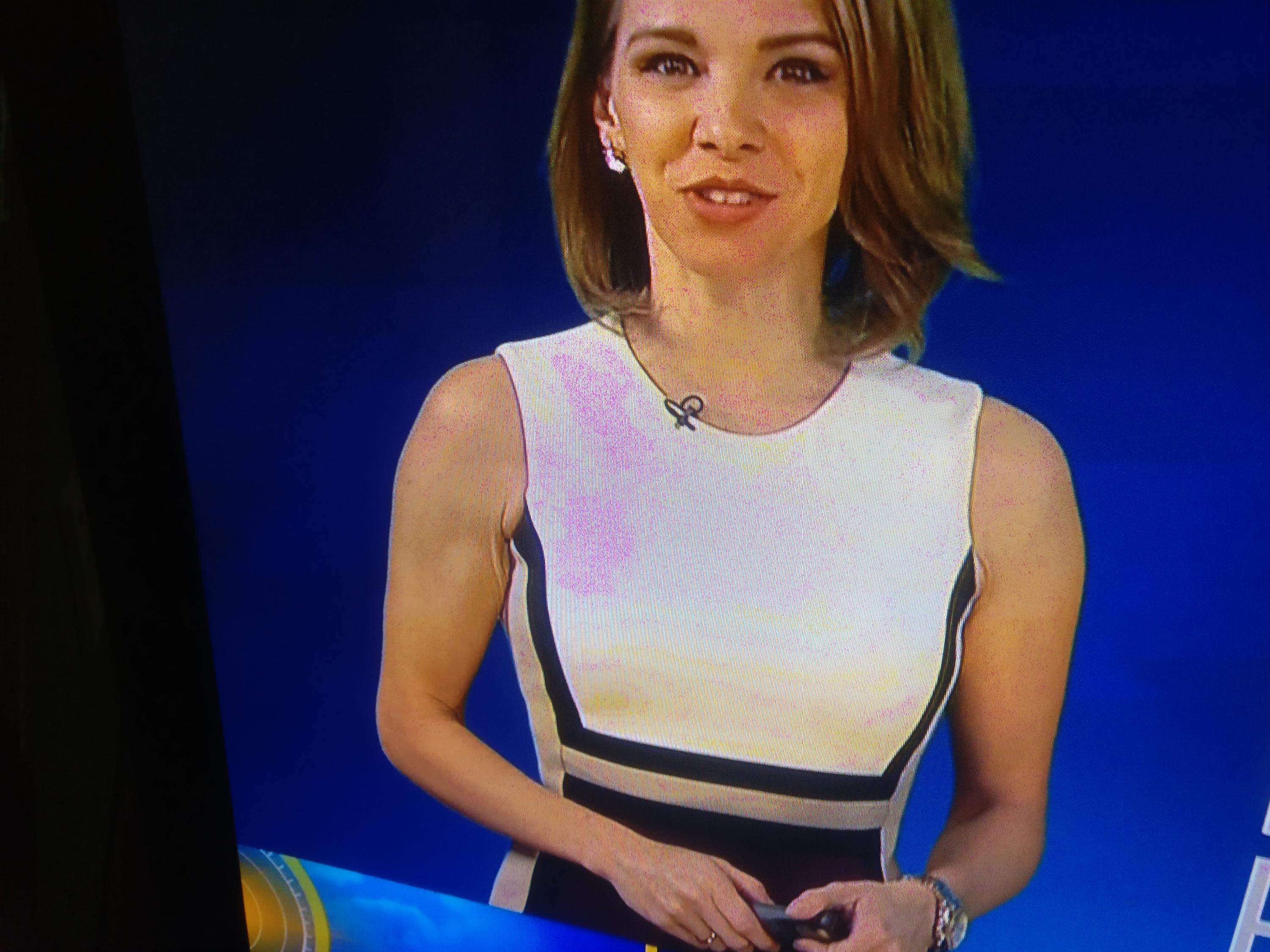

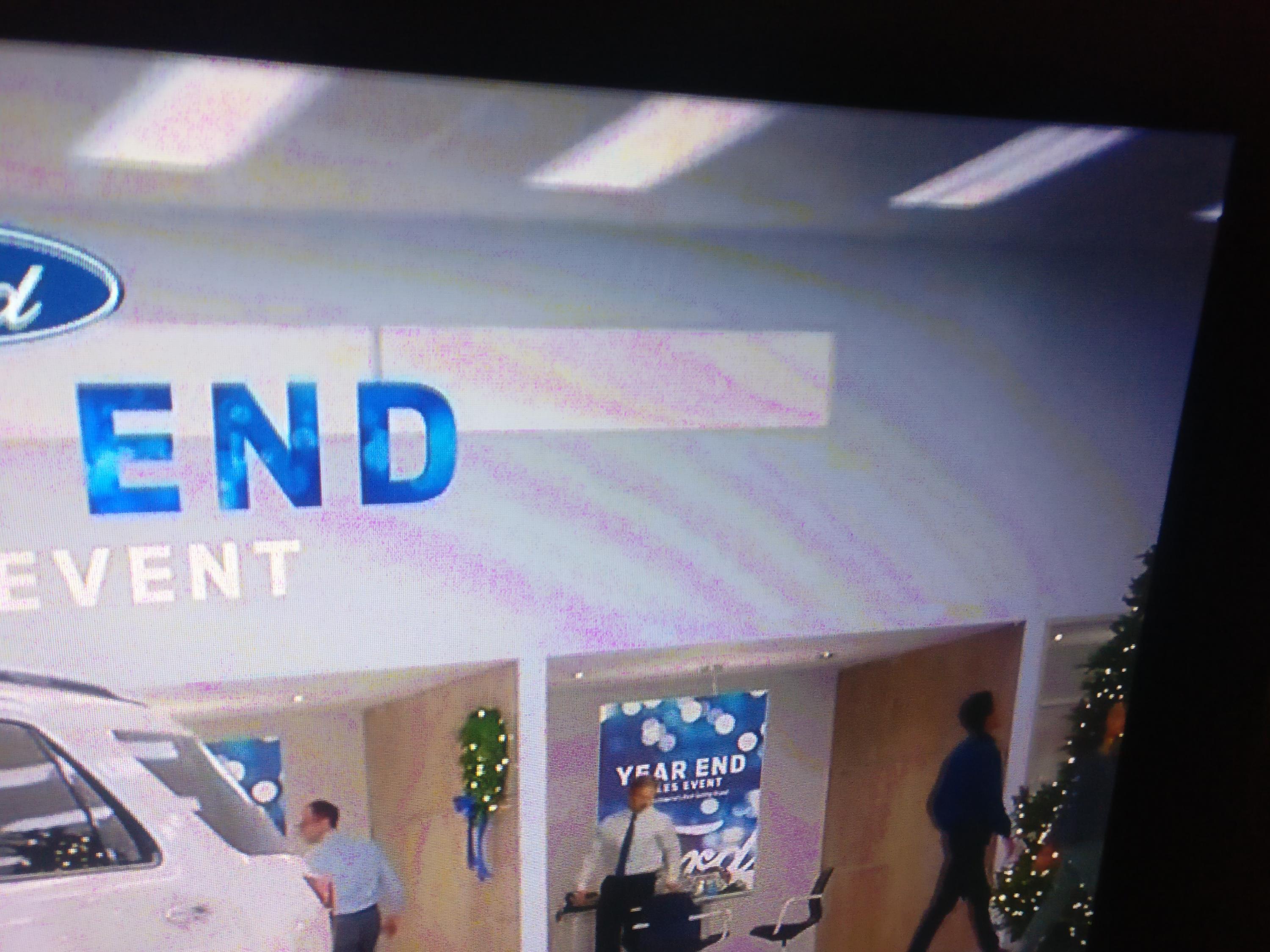

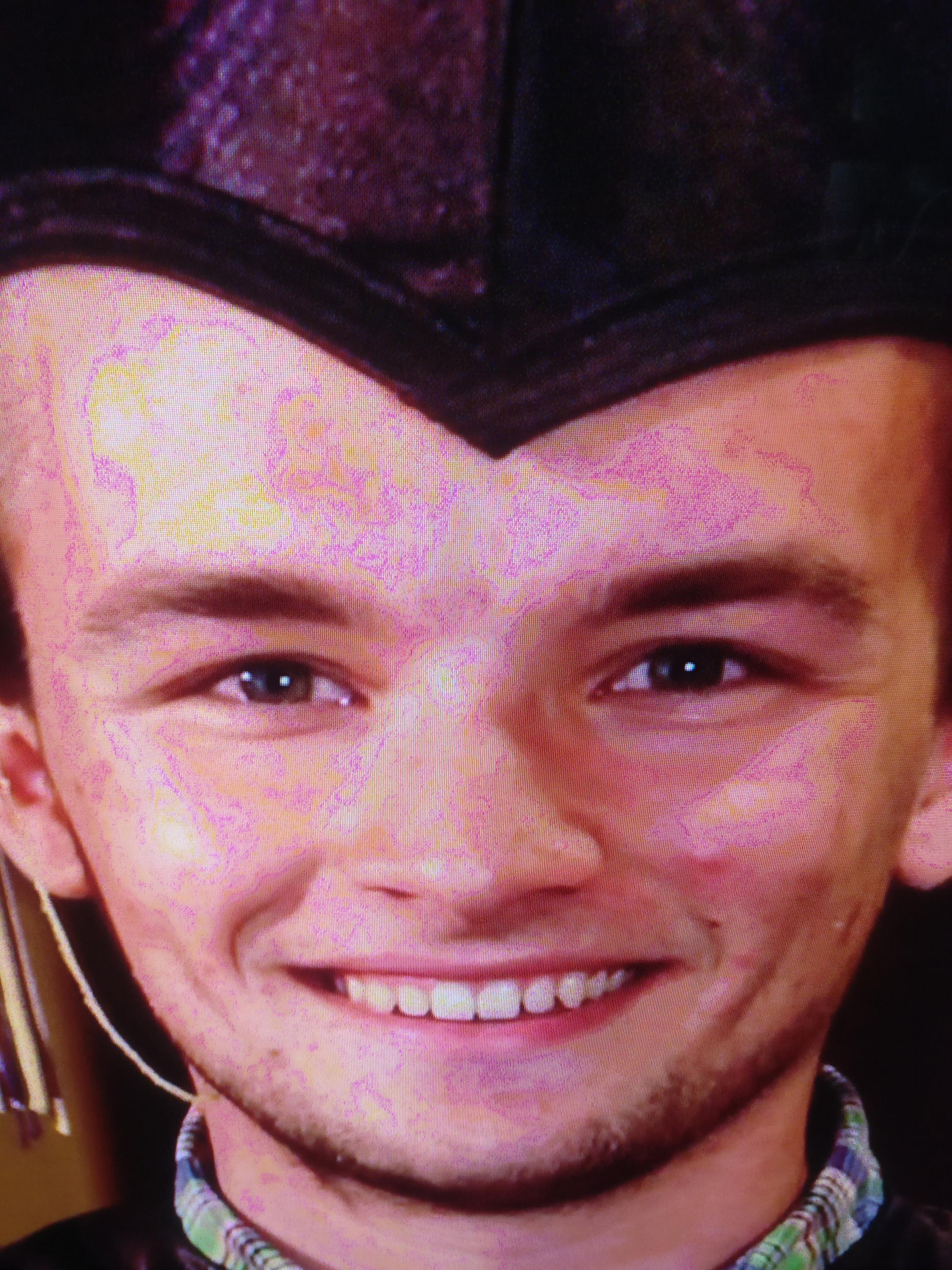

    All voltages are in spec however the image is not right. There is a rainbow defect visible and also a splotchy blackness that goes away quickly after cold start.
    I think this set is a sibling of the 50ps3000 which is known for cracked joints under the sus coils. I had both y and z sus's out and they look real clean and the joints look good.
    The internal test patterns also look much better than program material but I'm not convinced yet that it just isn't performing better in the patterns.

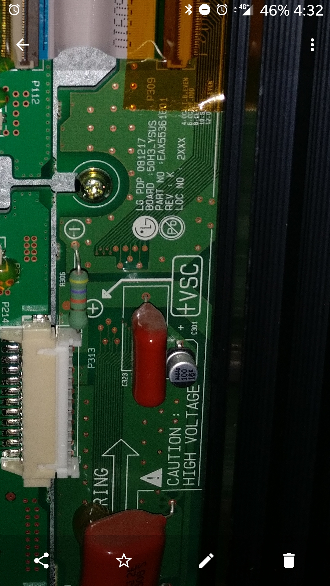

    I believe vscan test point is on lower buffer. Is that in spec too? Try heating y board up a bit with a hair dryer and see is problem persists. Looks like low VS or Vscan to me.

      Vsc as in pic ? In spec as defined by the panel, 140v.
      I think I may have boosted Vs but I'd doubt I went that high for fear of blowing something up lol but since it's possible I will revisit.

          Ok either a voltage dropped or problems within the Y board. Yes vscan + on that end of resistor with red lead of dmm Chassis ground with neg lead. What do you get?

            I measured across the resistor as indicated on the silkscreen. I get 140v, matching panel sticker.

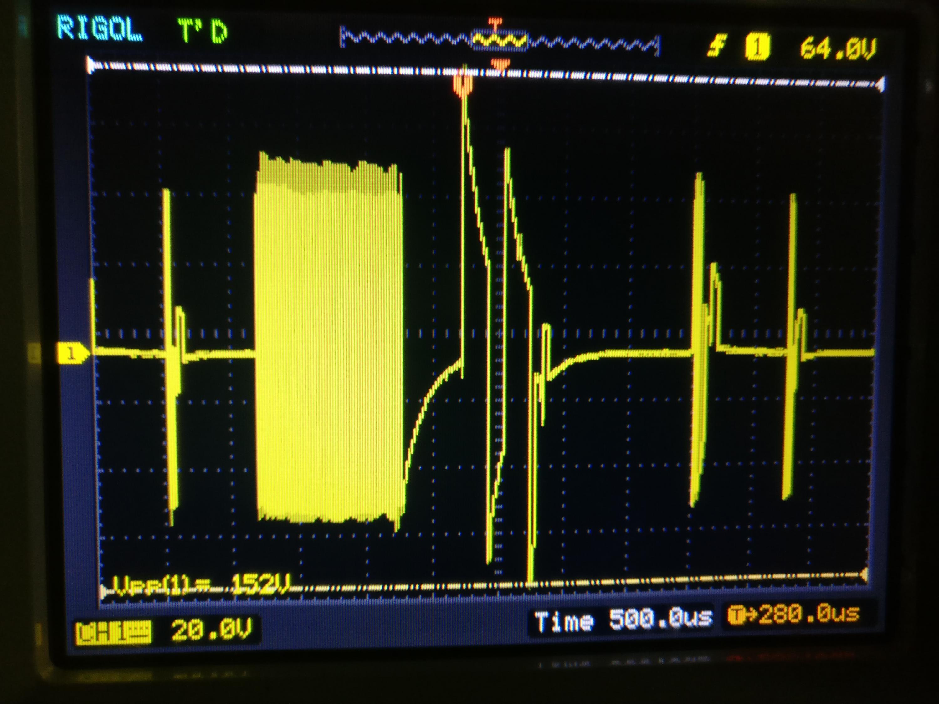

                        Re: LG 50PS30 Image Problem

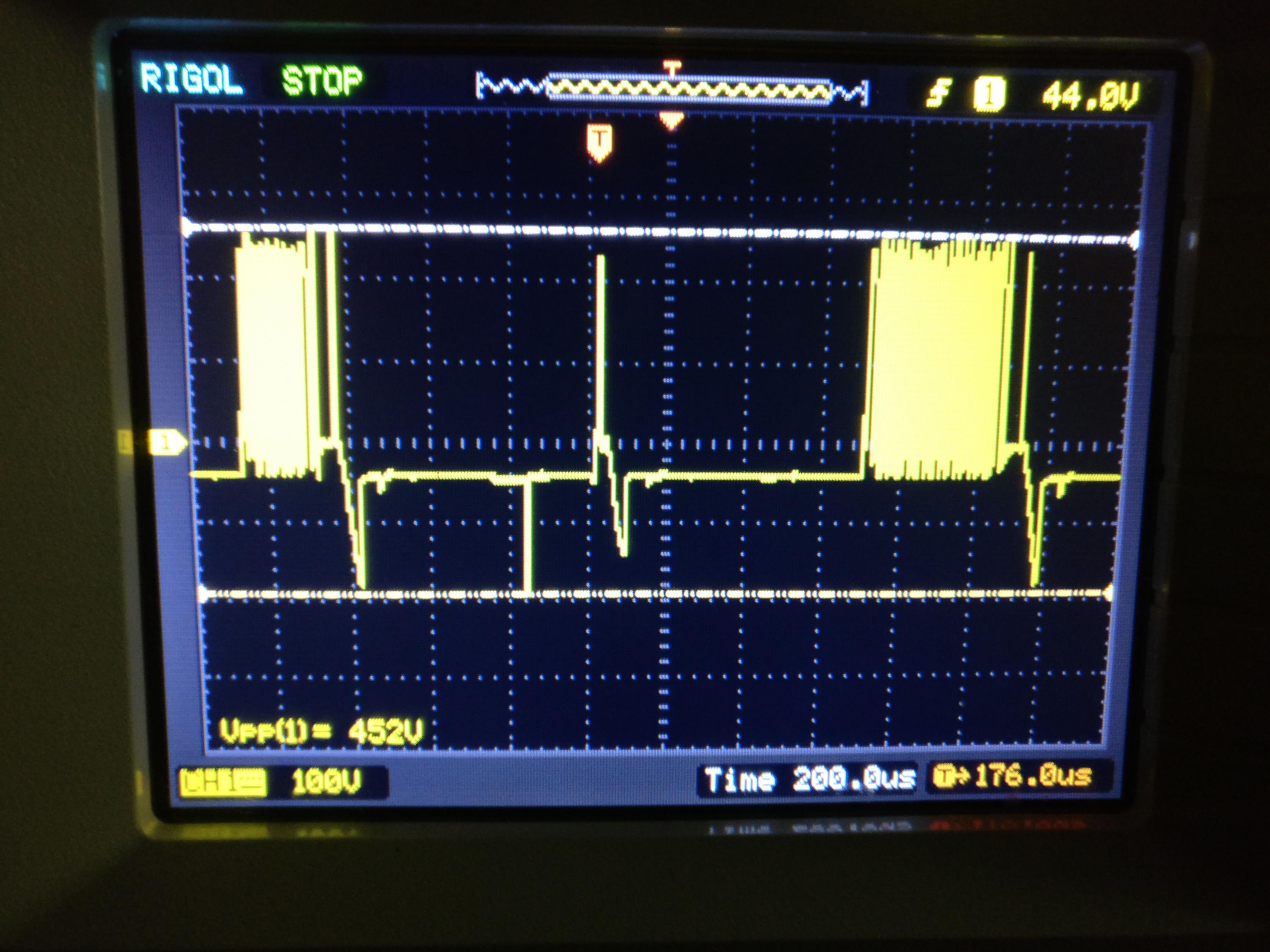

                        Here's a screenie of my zsus wave. I used the "Auto" function to zone in on the wave. I'm only seeing about 155v p/p but according to the sm I should be seeing about 100v more than that. Am I doing something wrong with the scope or have I found a problem ?

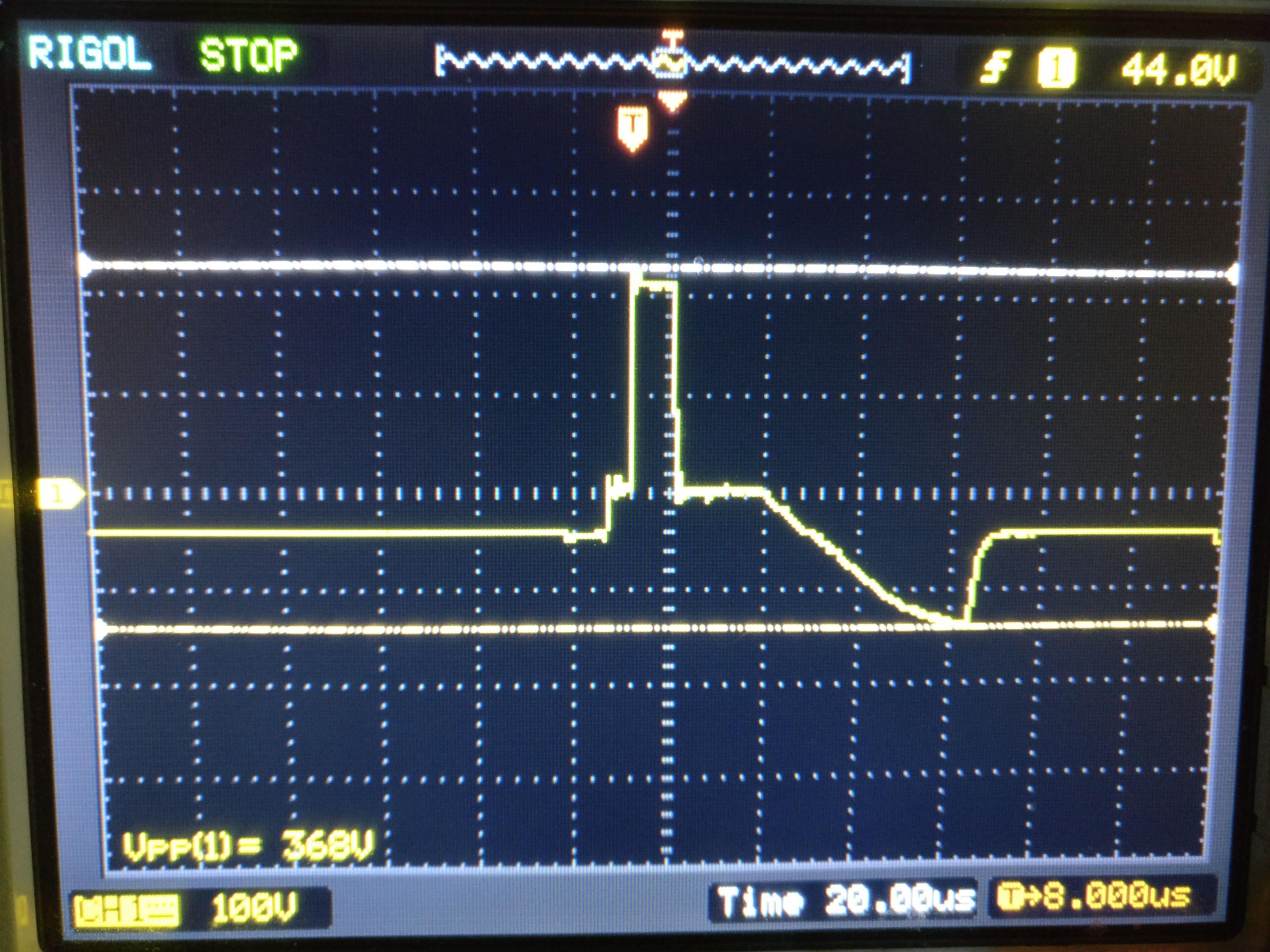

                          Here's a shot of the ysus. Does this look as it should ?
                                not always, set down can sometimes do nothing, depends how close the panel is to the limits, you'll probably notice some difference on fine gradients where more maldischarge is visible. or on lower Vs or combinations with set up that causes maldischarge.
                                Your Y and Z waveforms look normal, what's important for the Z is having the Z-bias voltage period (~100V) in between the sustain periods (200Vp-p). Which you seem to have. For the Y, you should have a nominal -190V base for the waveform, with ramps back to zero, and sustain portions from 0V to 200V. That being said, your set up period looks absent or too short, so there could be a fault there. Missing or rapid set up will cause overdiffusion, where pixels maldischarge all over the panel.
                                You need to rule out a control board issue by checking the test patterns are ok.
                                        BINGO.
                                        Had some time to look at this again and found an open 7.7ohm power resistor near the setup pot. Replaced it with a 10 ohm resistor (didn't have the same resistor so thought better to go bigger instead of smaller) and set has been working normally for the last few hours.
                                        Thanks for the help guys.
