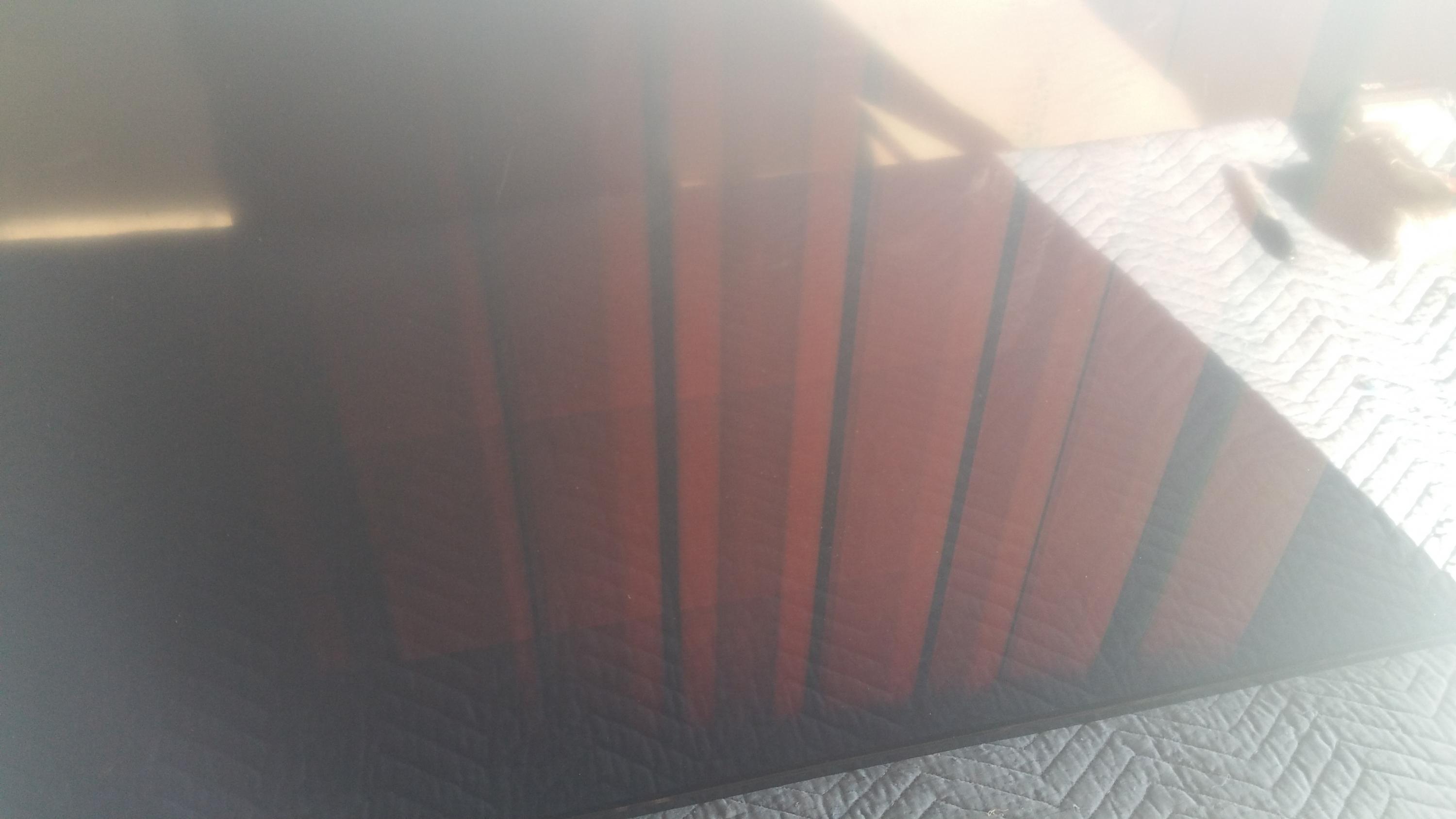

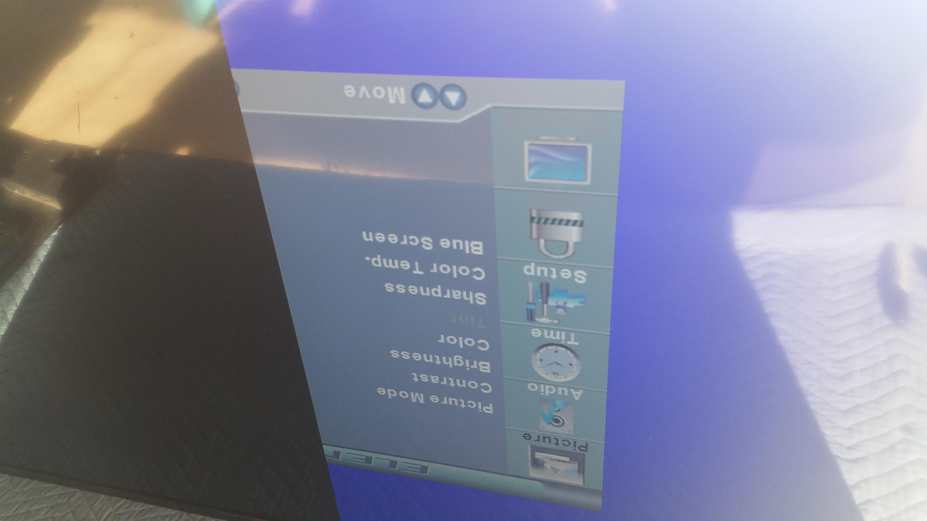

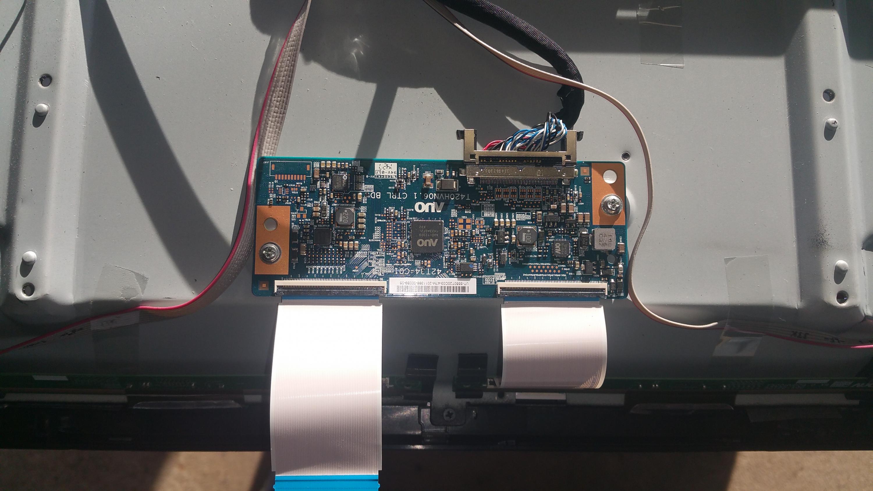

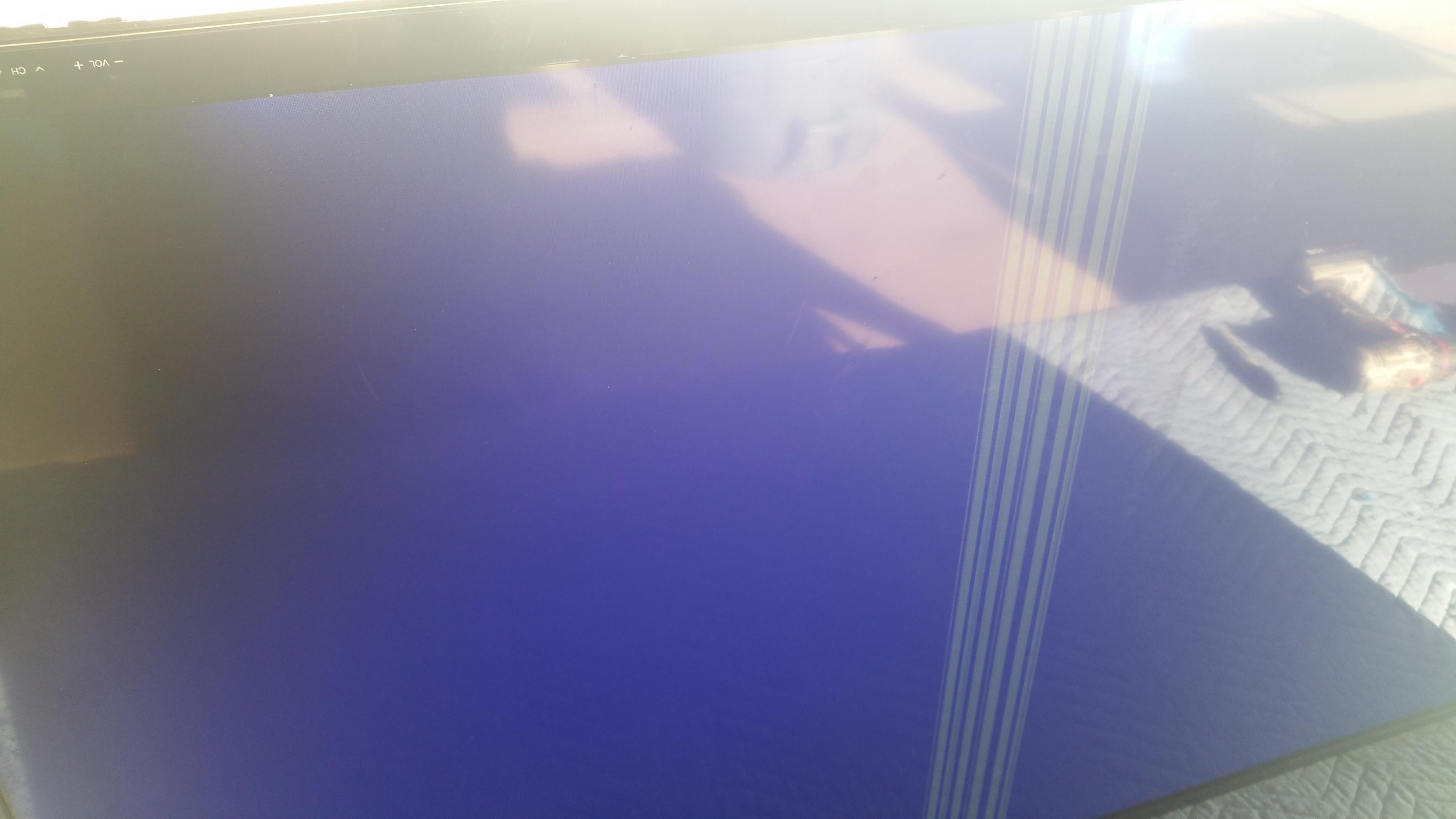

    Generally speaking, when I see the problems shown in the pics, I assume that it's a Panel issue that can't be fixed... Every once in a great while, simply reseating the TCON connections will fix the issue, but by and large it's a panel issue and hopeless..
    But sometimes, I get this situation where I disconnect one of the TCON connectors, I get a perfectly good screen on one side..
    Does this indicate that the panel may be good and it's a TCON problem??
