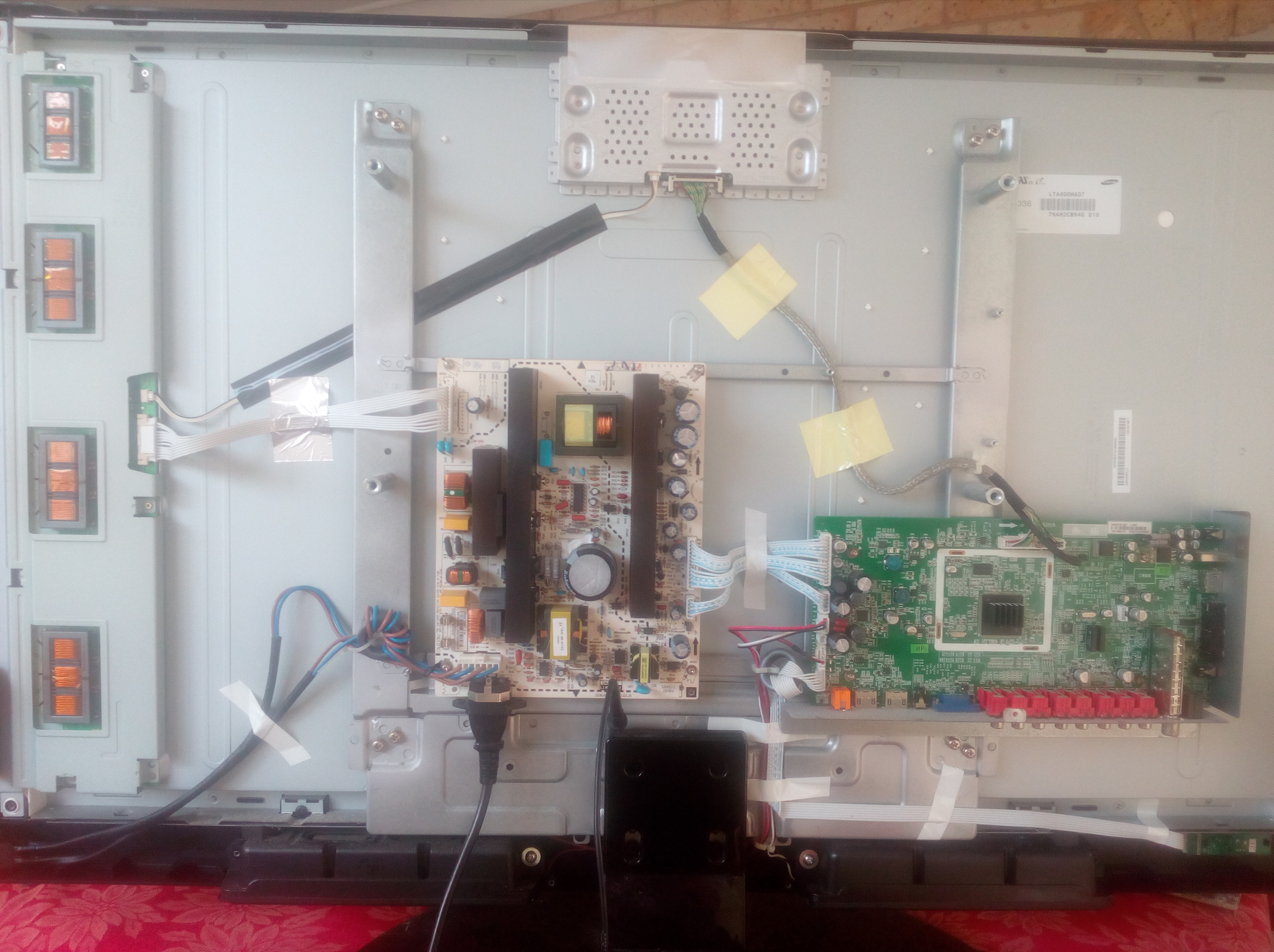

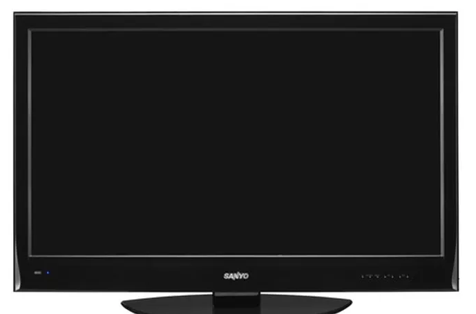

    Picked this up for free and at switch on the front led is a steady blue whereas standby should be red. I hate this problem as most likely eeprom involved. Tried freeze spray and also quick short of eeprom pins 5 and 6. No change. Voltages from power board read....
    Main connector
    BON. O.O
    PWM. 0.0
    12V. 0.0
    12V. 12.0
    G
    G
    32V 0.0
    5V. 5.4
    G
    5V. 5.4
    G
    PON. 3.5
    Connector under that...
    24V. 24.3
    24V. 24.3
    G
    G
    G
    Top left connector...
    BON. 0.0
    PWM 0.0
    then G x 5 pins
    then 24V x 5 pins and all read 24.5
    For next check I will disconnect main and see if I can fully power on the power board and then check if I can force on backlight to see if indeed the circuits will work OK. Any input on these readings and problem are appreciated.
    Re: Sanyo LCD40XR10F stuck in startup
    BON. O.O
    PWM. 0.0
    You have no BL-ON or Dim control signals from the main board.
    • maxvalutech
      • Dec 2014
      • 804
      • australia
      Correct budm and I have now forced PSU on to get all correct voltages and then needed 5v to both blon and pwm to get backlight up nice and steady. Ref first post the 32v is no connection. So PSU and backlights circuit are good and budm is right but does an eeprom issue the turn on command. There are three ICS with service manual idents as prefix 24C. Will try to follow circuits but still thinking flash memory problem with difficulty in getting the file.

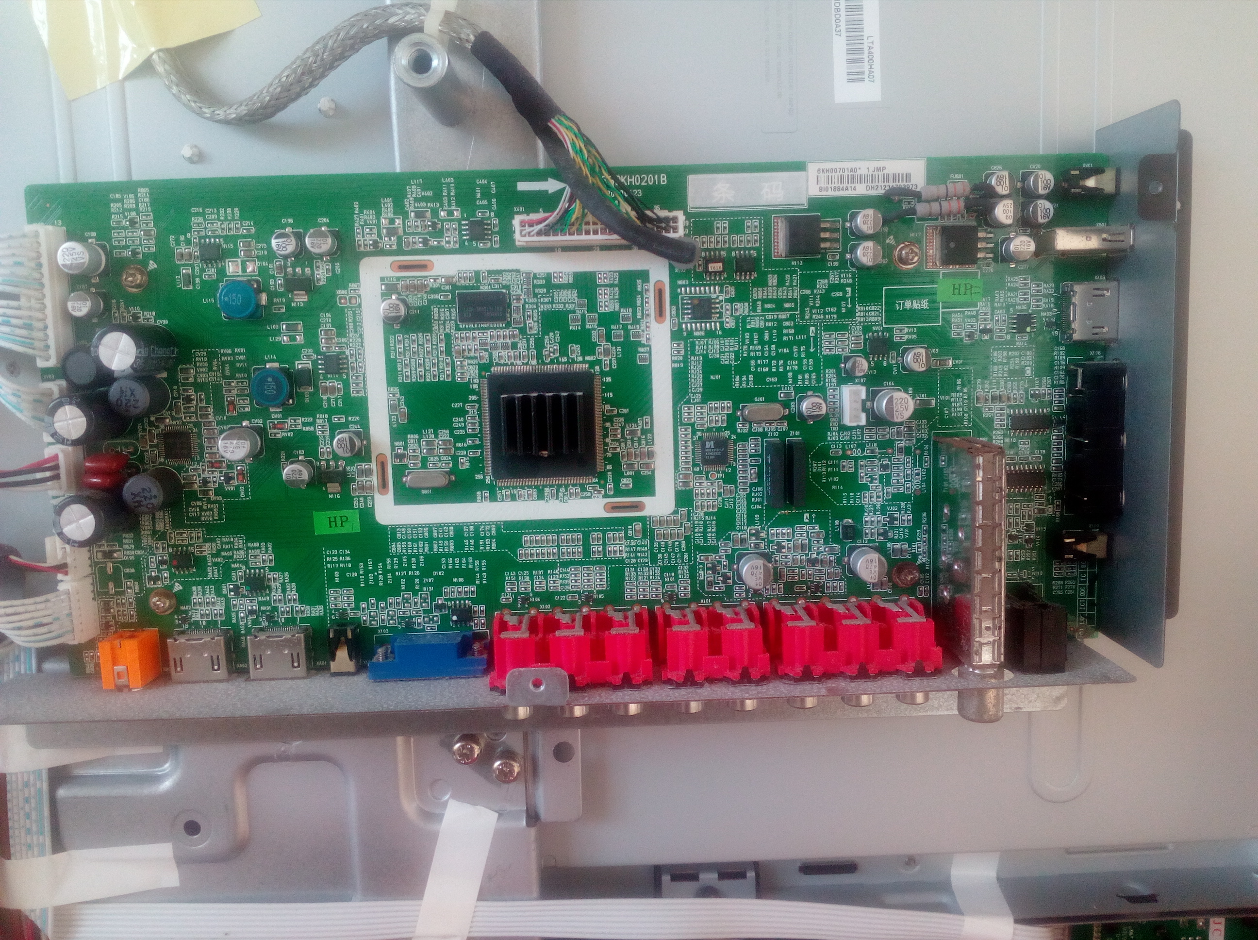

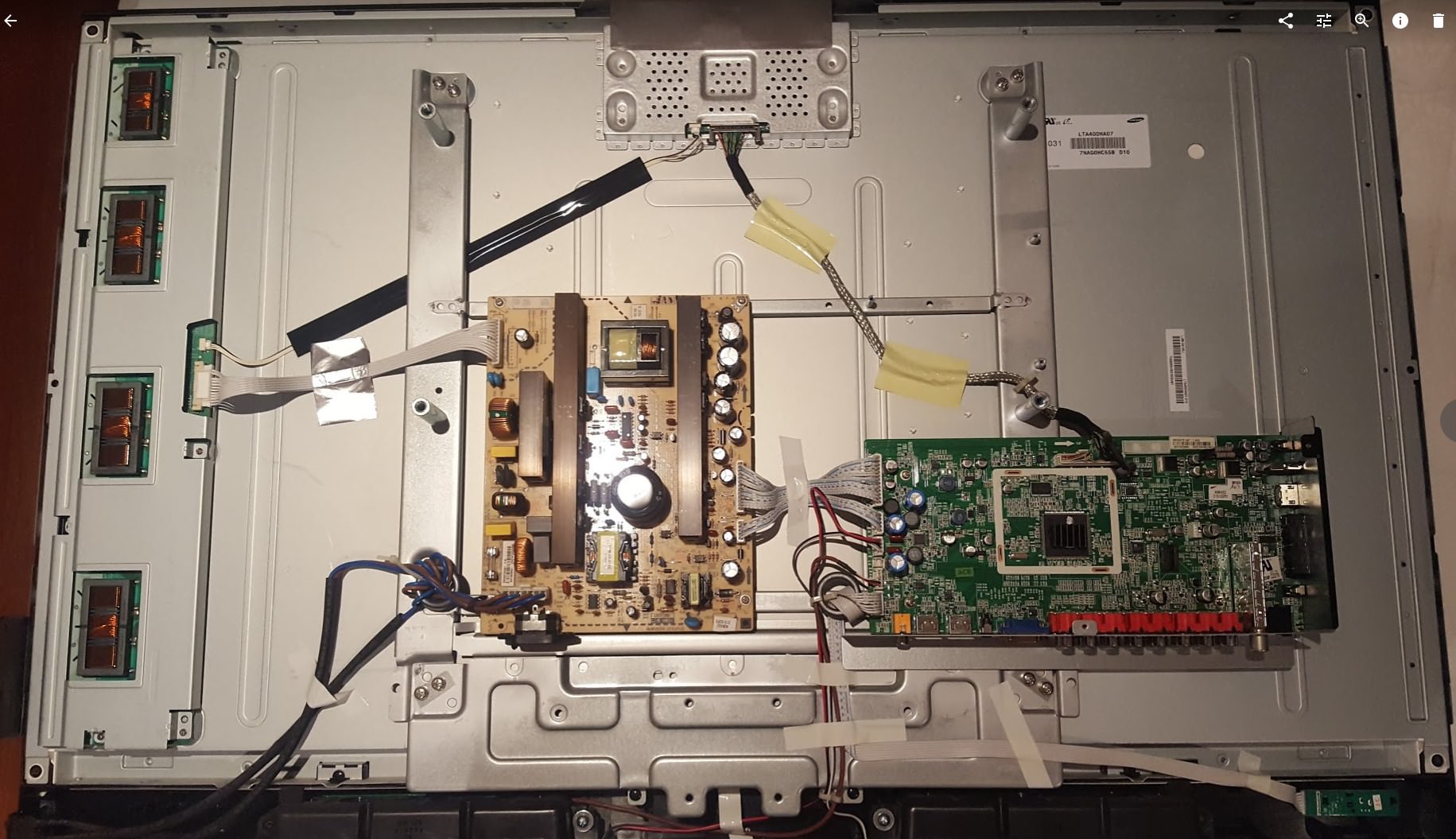

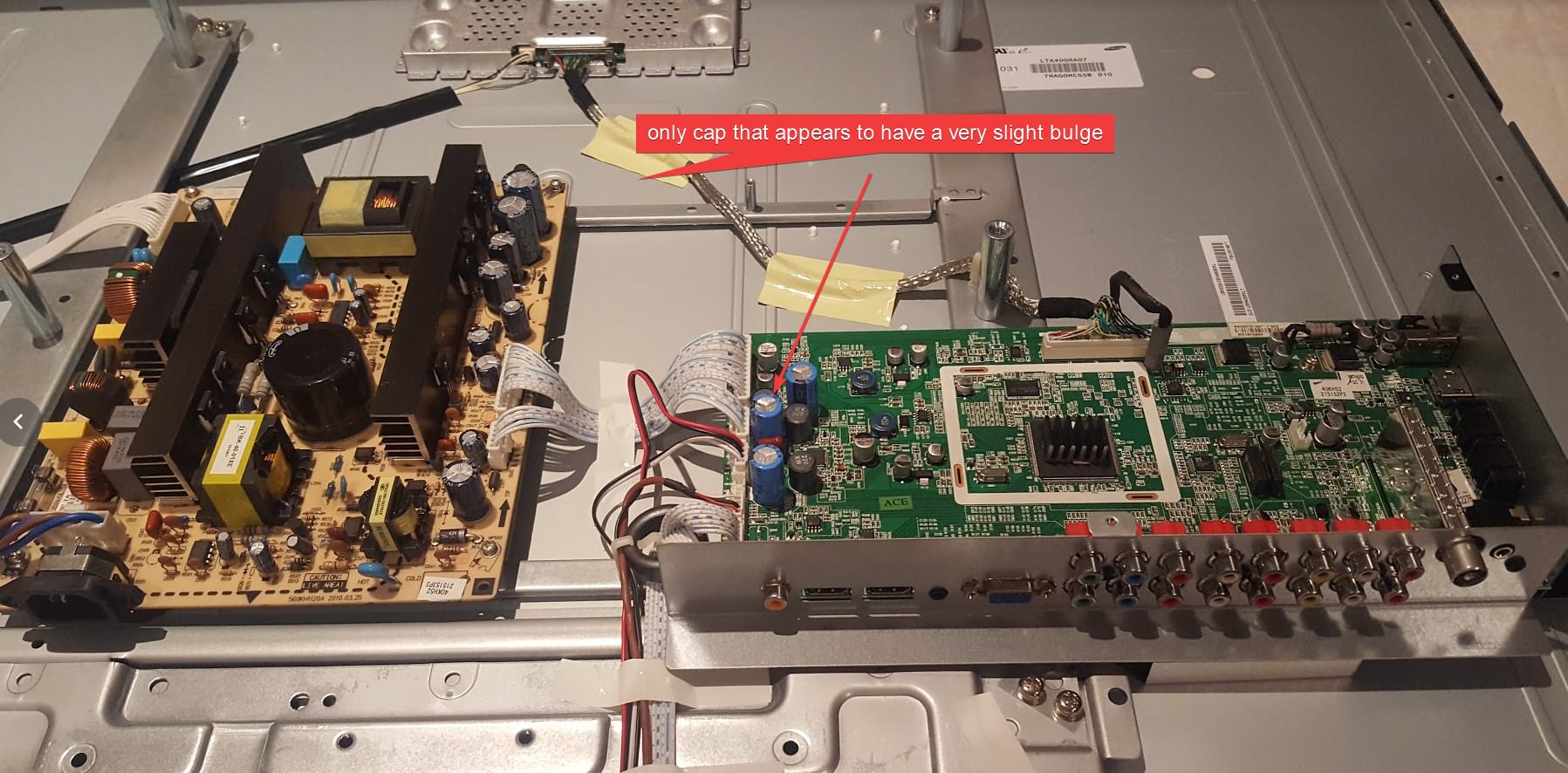

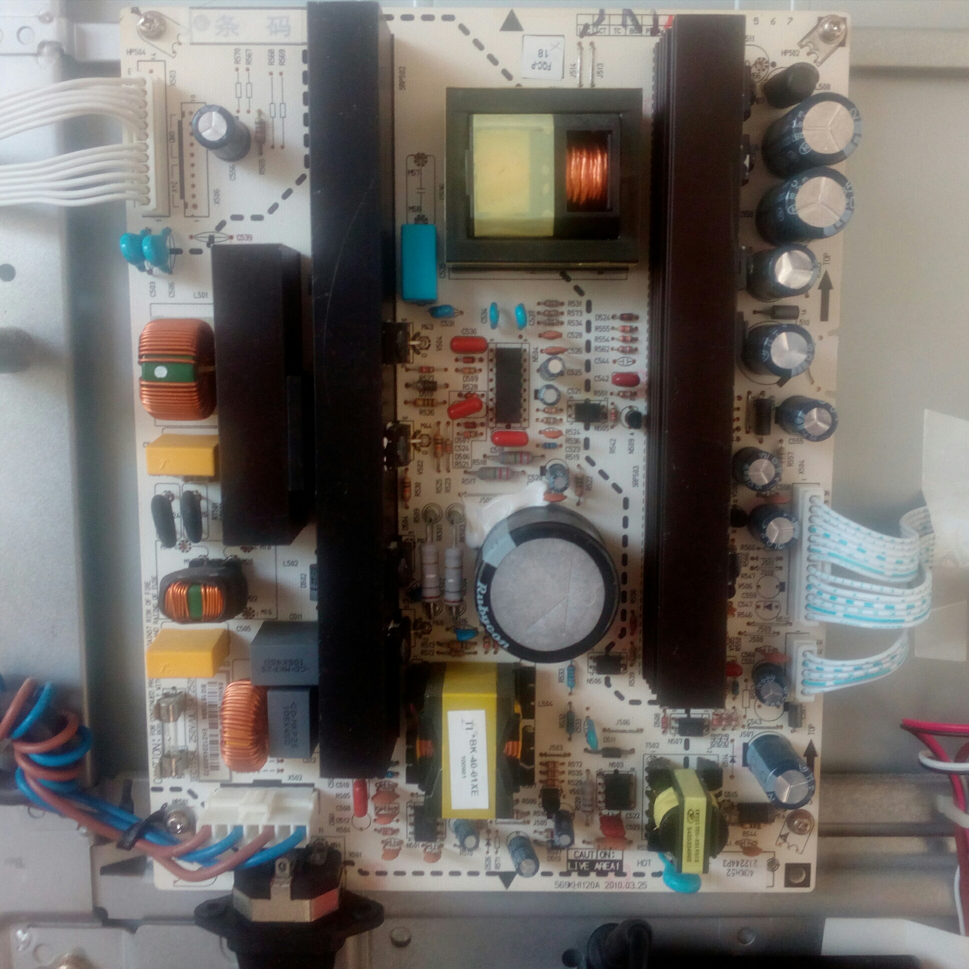

        Sorry, dont mean to hijack, but I was about to post a new thread and then found this one. I believe I have the same issue as OP. Here is what I am experiencing and what I have tried so far... any help would be much appreciated.
        Just tried turning on my Sanyo LCD40XR10F TV and all I get is the blue led light ON which usually indicates the tv is turned ON (normally when the TV is in standby this led light is always red).
        The panel does not show any display or light what so ever.
        No sound is heard from speakers and no electrical noise from internal boards and power supply.
        If I press any of the front touch buttons (power, source, menu, channel+/-,vol+/-) all of the touch button led lights turn ON but nothing happens other than the LEDs turn off after 10secs and the main blue led remains lit.
        Pressing any button on the remote has no effect.
        Tried powering OFF, unplugging from the outlet, all external devices disconnected, waited 60mins and tried again – no luck.
        Also, tried common tv troubleshooting steps e.g. holding down touch buttons for a certain amount of time and then plugging in and still no difference. Tried a few other sequences and still no luck.
        So, I removed the rear panel to search for visible signs of anything that might not look right but could not see anything wrong, however, i am not an electronics guy so I am hoping someone could help me look into this further. I did, however, look for any bulging capacitors and they all look ok to me. There is one thou that has an ever so slight bulge which could be the problem but not sure?
        If all it needs is a capacitor/s change then I am happy to invest in a soldering iron starter kit and replacement capacitors and will attempt a repair, but if it's a major part that's costly I probably wouldn't bother since the tv is almost 7 years old.
        Any help with troubleshooting this issue would be awesome.
        Here are some pics of the tv and internal components.

          I think we may be up the proverbial creek without the required paddle as I recall one of our regular Oz forum members some time ago was looking for Sanyo flash program but no luck. What happened between last turn off of your set to attempted switch on? Was it left in standby - any storms about - that type of info.

            But did you do any Voltage testing like OP did?

              Service manual. I identify eeprom as N805.
                  No i haven't, and don't know how to test. I think i have a tester i scored from a mate years ago. Will see if i can find it. Should i just follow the Voltage Regulator and Inverter guides you posted above?
