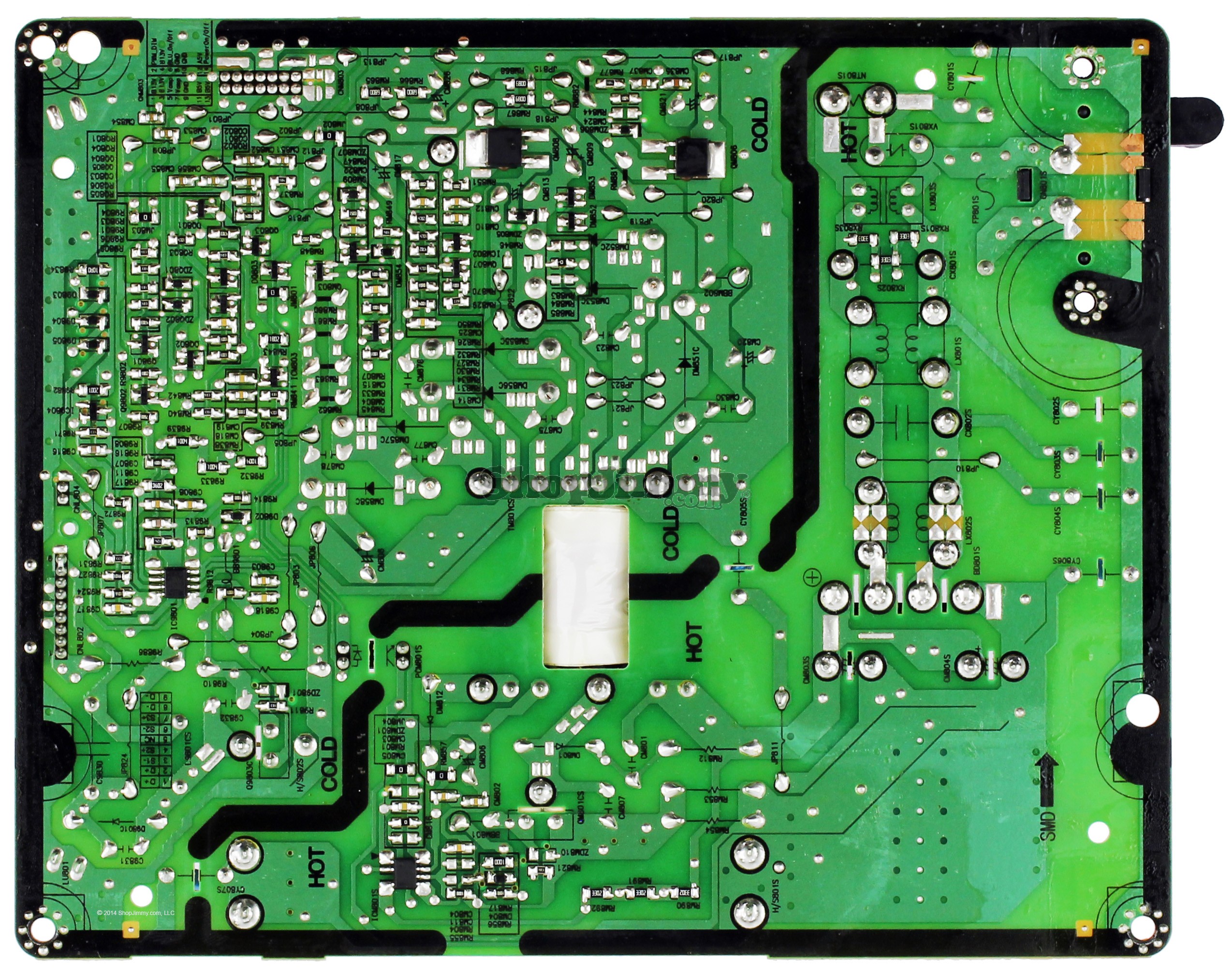

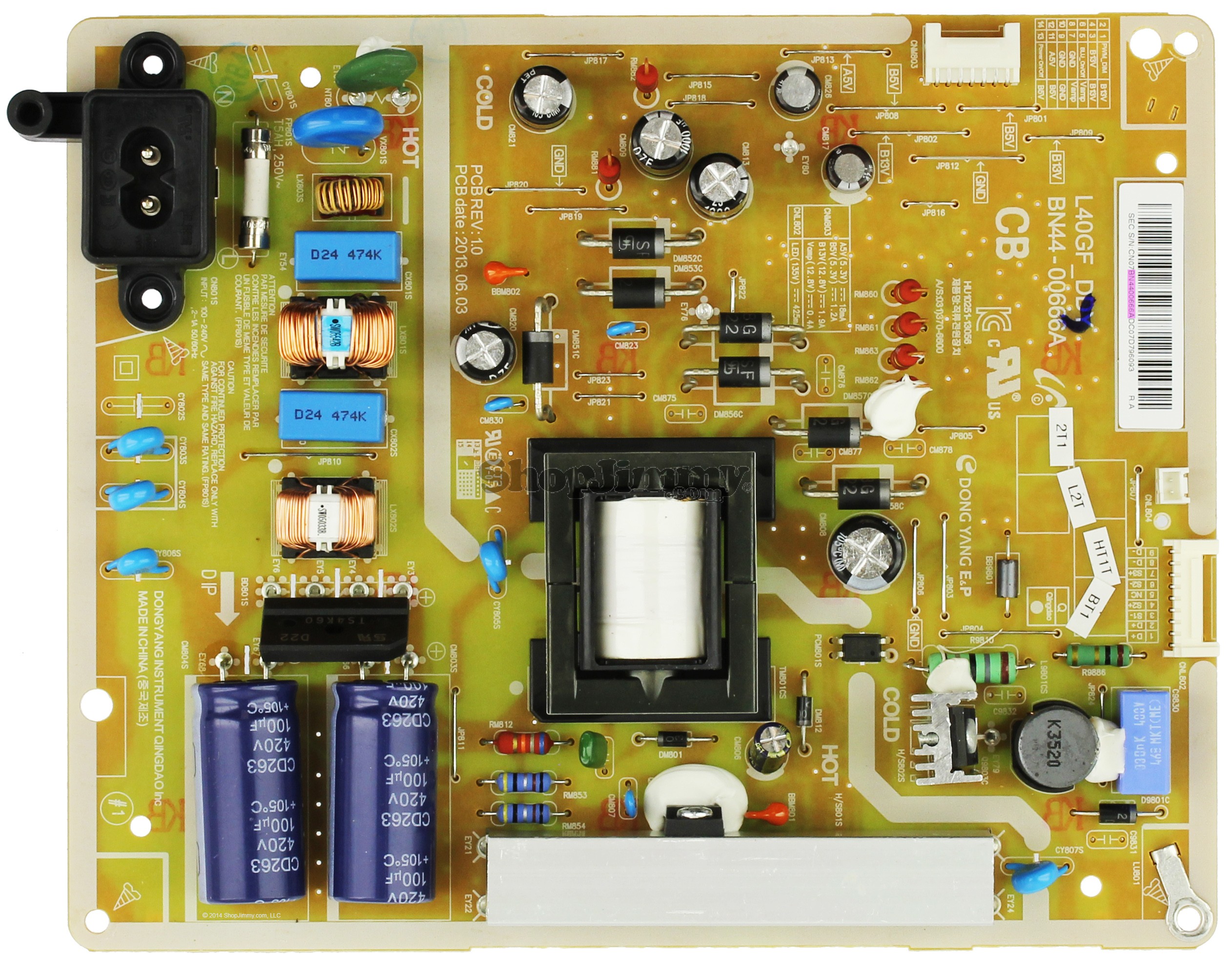

            You have open circuit in the LED sting, that is why the Voltage went up to 215V.
            Pictures provided by shopjimmy.
