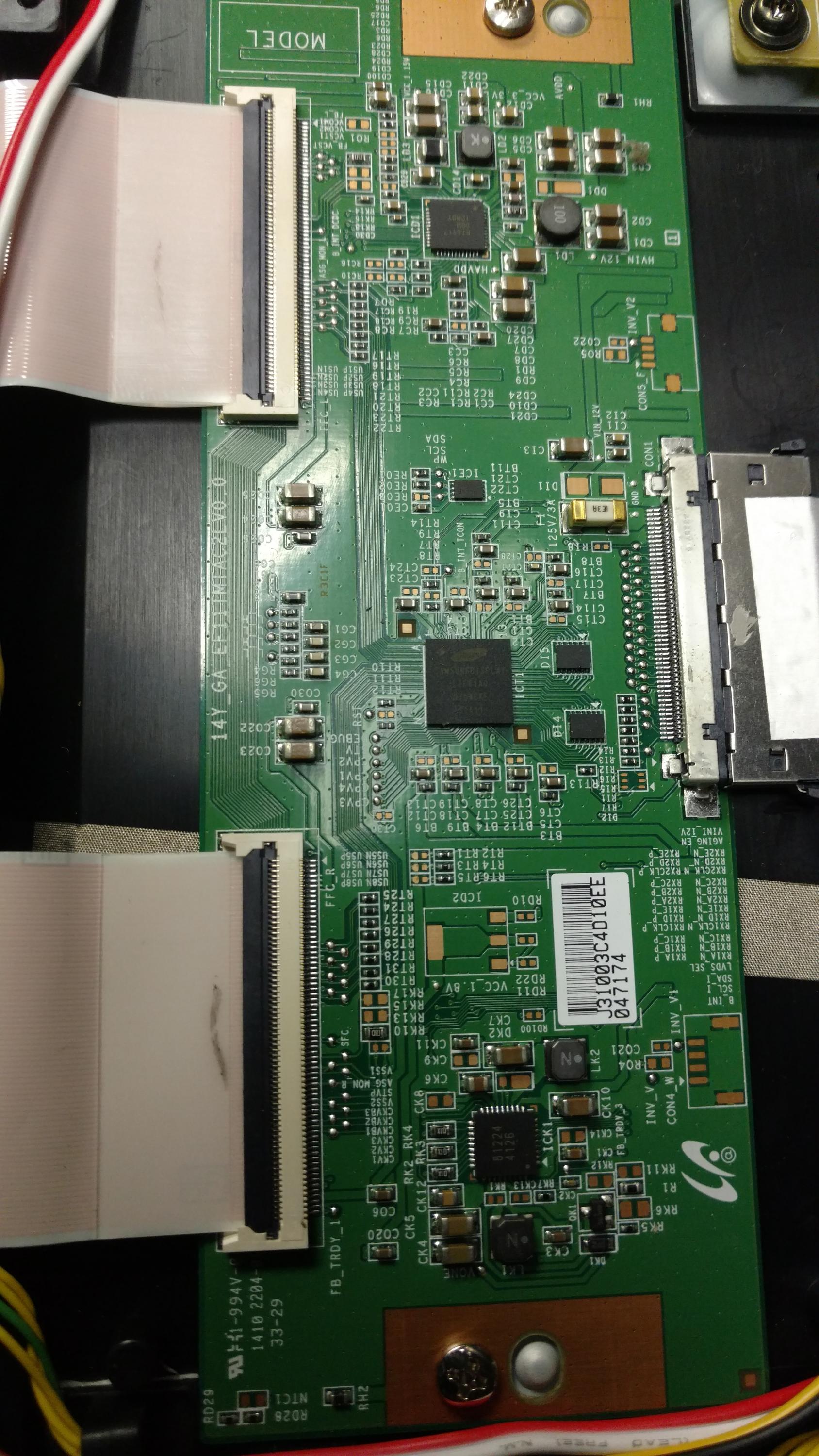

    found a SHARP LC-32LE551U with no main board. Found one on EBAY, set now turns on, backlights come on with blue led status light. no display, tried unplugging one side of T-con cable then other - no change. 12V is present and fuses are good.
    T-con board bad ??? does anybody have schematic ??? thanks

      in my limited experience with a few sharps, if you unplug one of the tcon to panel cables, then the side associated with that unplugged side goes white. Are you saying nothing happens at all? sounds like a problem beyond the main board, but maybe, some of the "status lines" are not correct... maybe.
      Further, which "fuses are good" are you referring to. At the tcon, at the power board?
        Re: sharp lc32le551u no display
        https://www.badcaps.net/forum/attach...8&d=1510237835
        There are many Voltage test points on that T-CON, I.E. VCC_1.8V
        So look for the test points.

          backlight is on - no display. removing either side of T-con cable gibes same pic (blue screen)
          Fuse F1 is good - 12.35V on both sides of fuse.
          Vcc_1.8V + 0V
          INV_V = 0.5V
          INV_V1 = 0V
          INV_V2 = 0V
          seems like T-con is doing nothing. as far as main board is concerned - didn't have one when I got set. This main board came out of this same model # (according to EBAYer)

            so new T-con same symptom. must be main bd version #. how do I find right one ?? can this one from ebay be programmed ??

              got another main board - same issue. tv powers up, backlights are on. no display on screen. disconnecting cables to t-con and main makes no change.
              Andrew F. Ali mentioned firmware doesn't match main board ?? where do I find firmware to mate to main board ??
