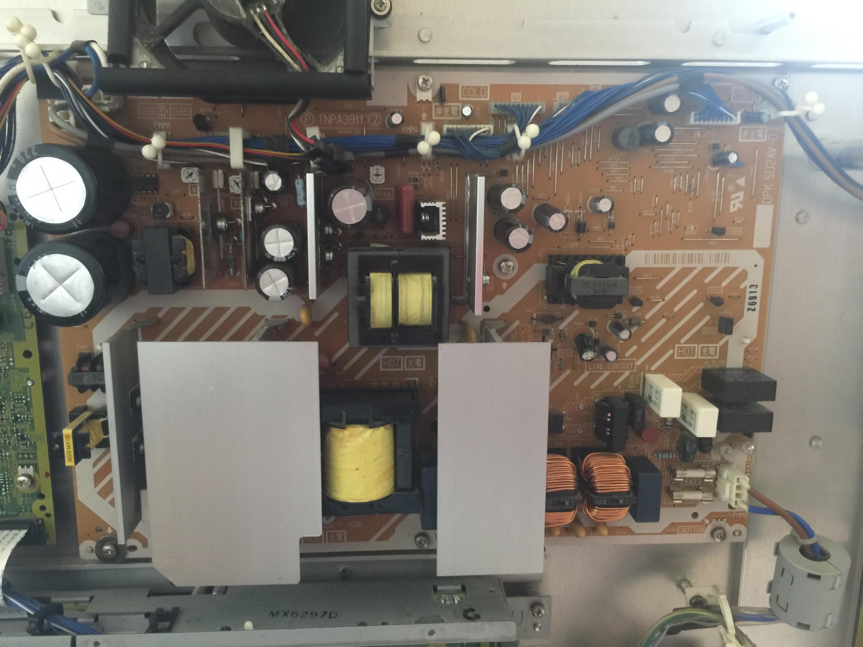

    This plasma was given to me, and initially threw a blink code 11 which is a fan fault. Well, the layer of dust everywhere was pretty obvious. So I cleaned up fans, boards and chassis and was rewarded with a working TV. While open and outside the house, it scanned for and found channels, had picture and sound.

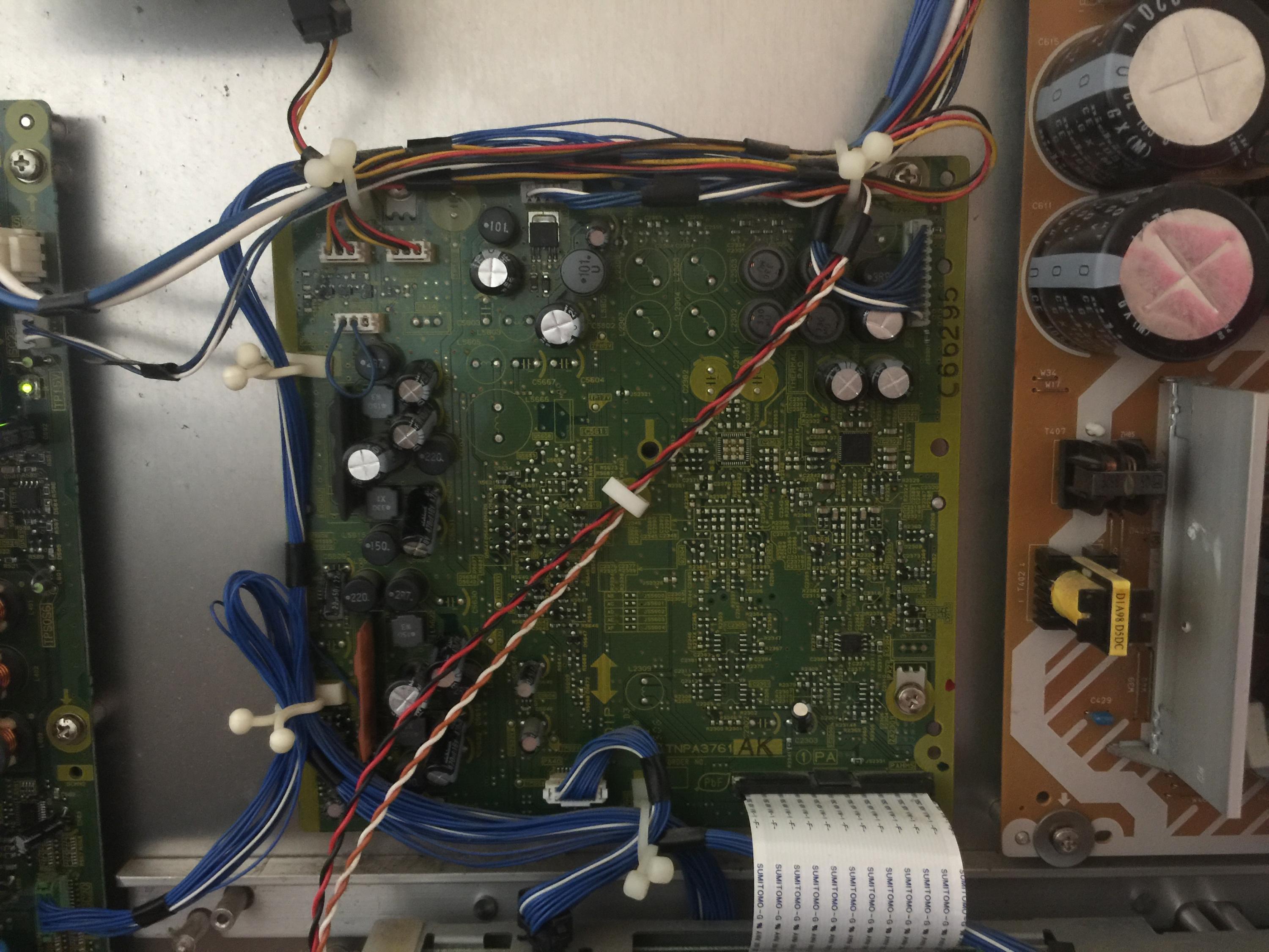

    Buttoned it up and brought it inside. The next time I tried to use it, it powered on with no sound or picture. Standby light is off when off, and red when on. It powers on/off by remote. When turned off, it starts a twenty-blink sequence. SOS20 is not even listed in the service manual!
    One would assume something left disconnected, right? Today I opened it and searched in vain for anything out of place. The boards are populated with Nichicon caps which all look good.
    Left it on, probed VSUS, Ve, and all sub-voltage test points on the PA board listed in the SM, and every last one reads in spec. So I'm puzzled.
    Has this symptom been seen on any Panasonic plasmas? The set is a 2006 Gen 9 chassis.
    Pictures will be posted as soon as I can get my iPhone to play nice with my Windows PC and let me import them.

    I did some troubleshooting per the 42PX60 training manual.
    VSUS 196
    VSCN 36
    VDA 76
    BT30V 30
    VE 166
    VSET2 -87
    All voltages generated by the P board are present, as well as those on the PA board.
    The troubleshooting flowchart leads me to a bad P board, due to the absence of the relay click when the TV is turned on.
    But the same circuit makes VSUS and VDA, which are good.
    Should I replace the P board anyway?
