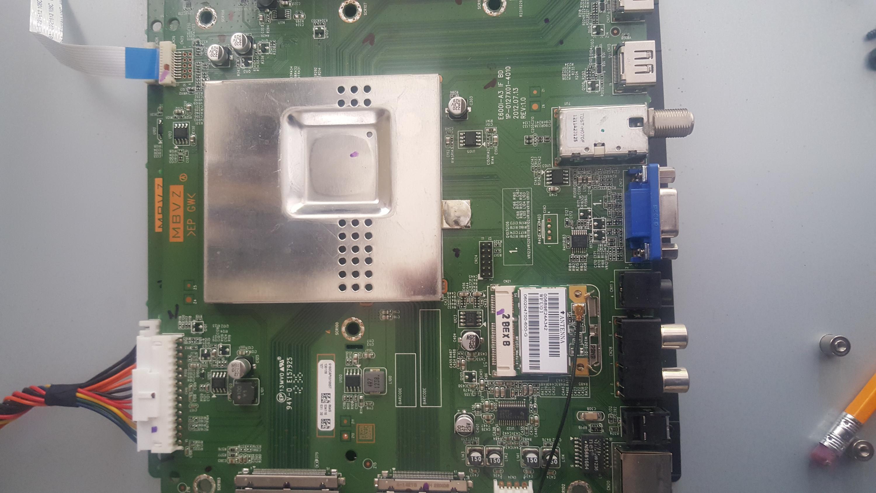

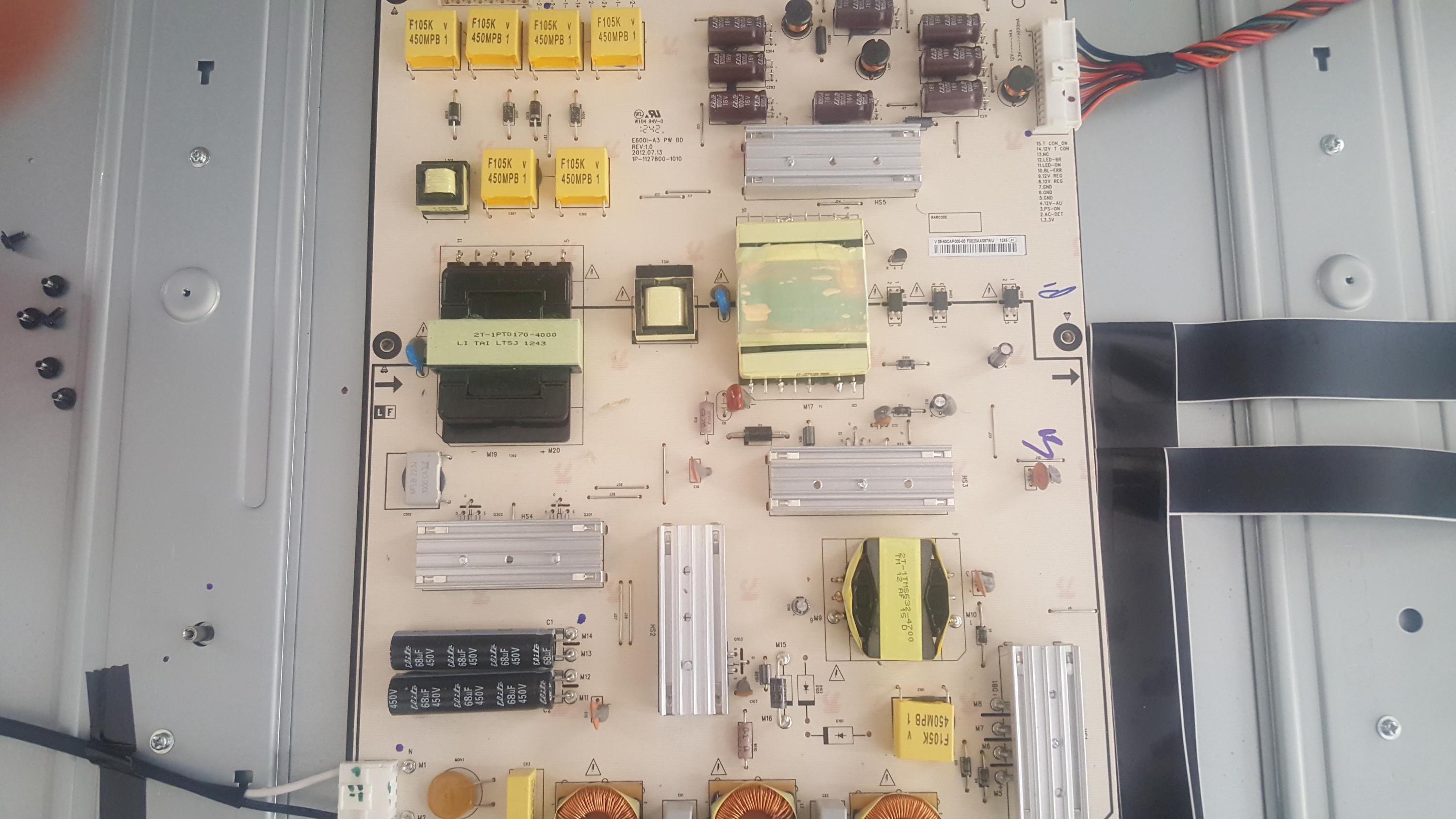

    Came across this on side of the road. It will not power on.
    Here are the reading from cn201 on the power board.
    pin
    1. 3.3v 3.3v
    2. ac_det 3.4v
    3. ps_on 3.3
    4. 12V-AU 12.3V
    5. GND
    6. GND
    7. GND
    8.12_REG 12V
    9. 12_REG 12V
    10. BL-ERR 3.3
    11. LED ON 0
    12. LED BR 2.6
    13. NC 0
    14. 12V TCON 0
    15. TCON ON 0
  • fixerupper75
    • Oct 2014
    • 125
    • us
    Re: Vizio 601i-a3
    With cn201 disconnected the are.
    pin
    1. 3.3v
    2. 4.47v
    3-9 0v
    10. 2.5v
    11-15 0v

      Looks like a mainboard fault with both the Backlight (LED ON) & Tcon On voltages missing.

                I replaced the mainboard and perfect!!! Another set save from the dump. My, I mention it looks good on my wall.
                Thanks all for your help!!!!
