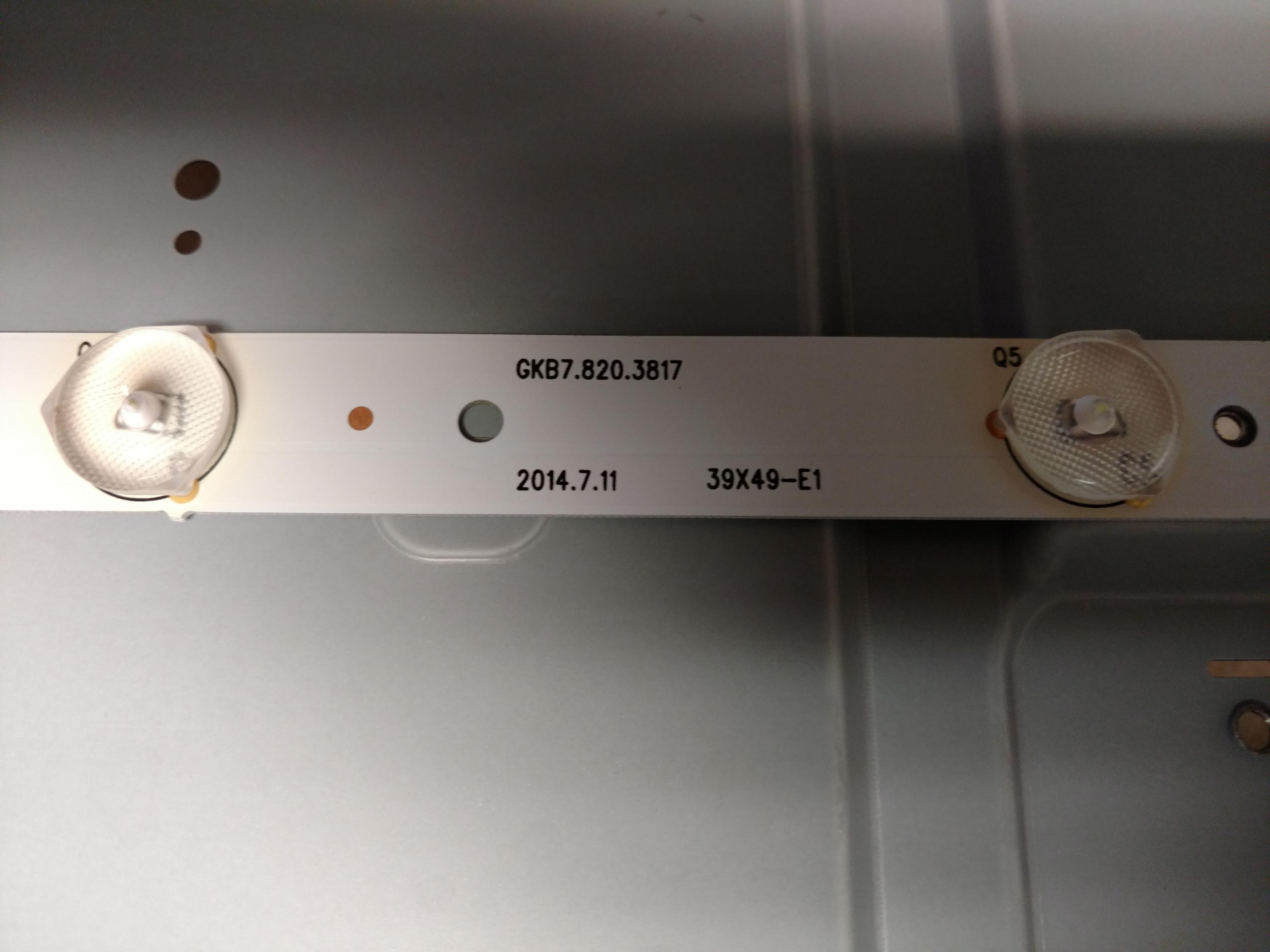

I'm working on this crummy, tiny little Jensen flatpanel with the typical bad backlights problem. Removing the panel and getting down to the backlights, I was able to confirm that there are a handful of Light-emitting diodes that can no longer light up. No surprises here.
Normally, if I run a web search or eBay search for the part number of the backlight strip (39X49-E1) or the model number of the television itself, I can find replacement backlight strips, but such is not the case this time. I do have some spare strips with good LEDs leftover from previous backlight projects, so I got to thinking about using the heatgun to remove them and install them on this television's existing strips. My question is if this a good idea. Will they fit? Are there potential differences in specification that may cause it not to work?
TL;DR? Can I take LEDs from one strip and install them onto backlight strips from a completely different television?
