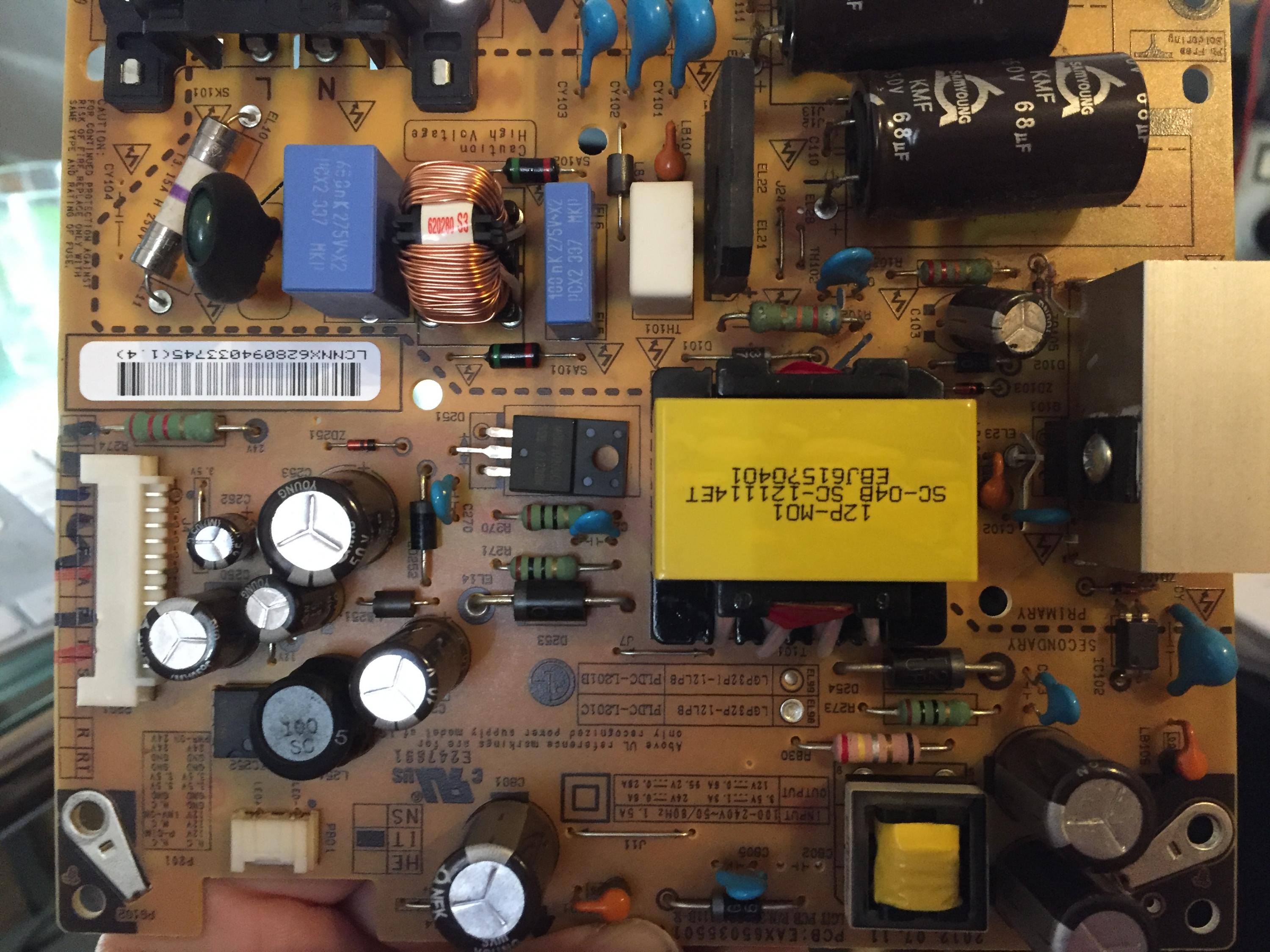

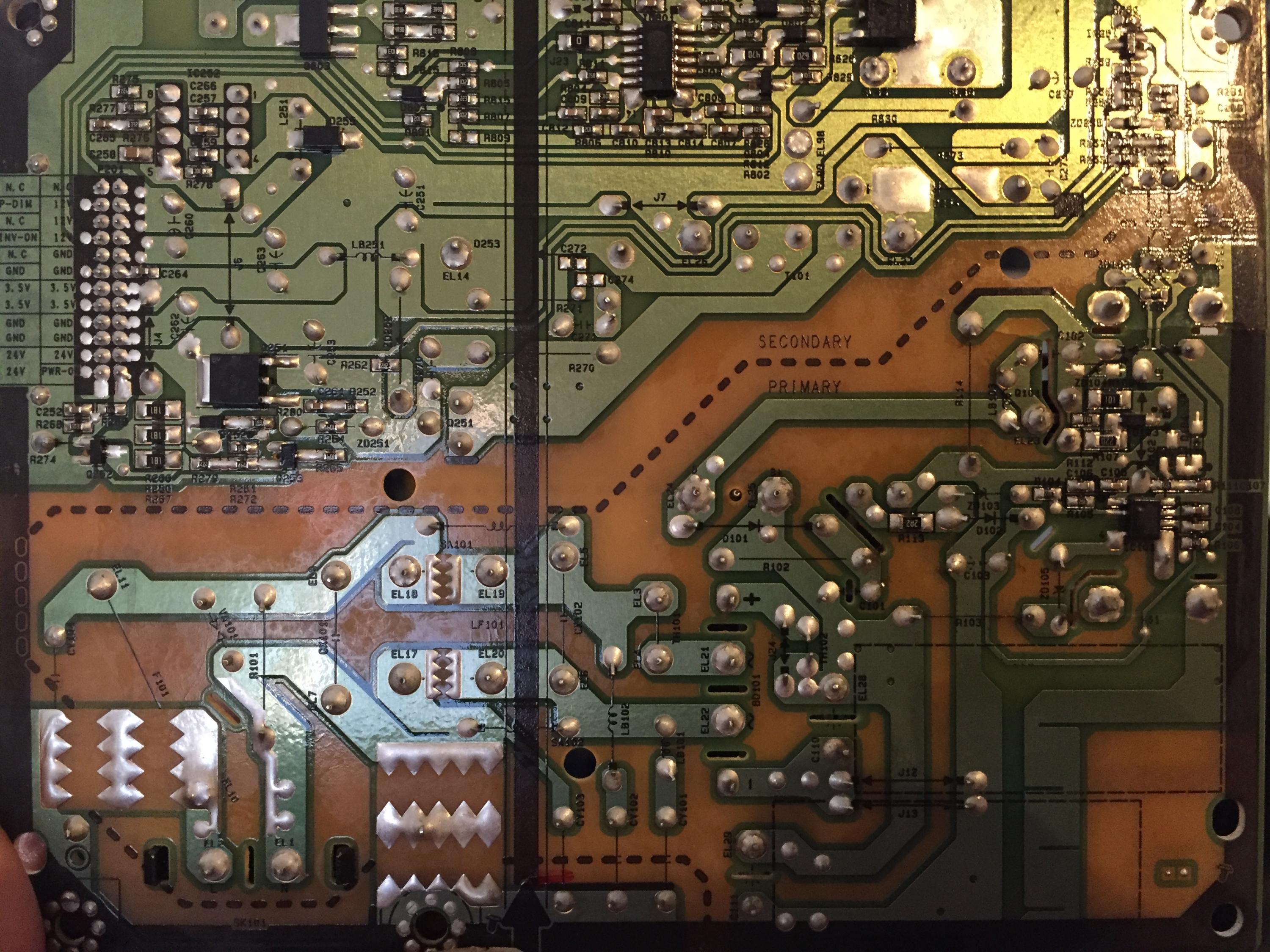

    So this set came in from a customer the other day, does anyone know of a cheap source of replacement PSU's part number EAX65035501 (1.0) that are preferably in the Uk. The PSU repair would have been straightforward enough but some one got to it before me, not quite sure what they did to it as I can see no point of impact on the set or the board ???

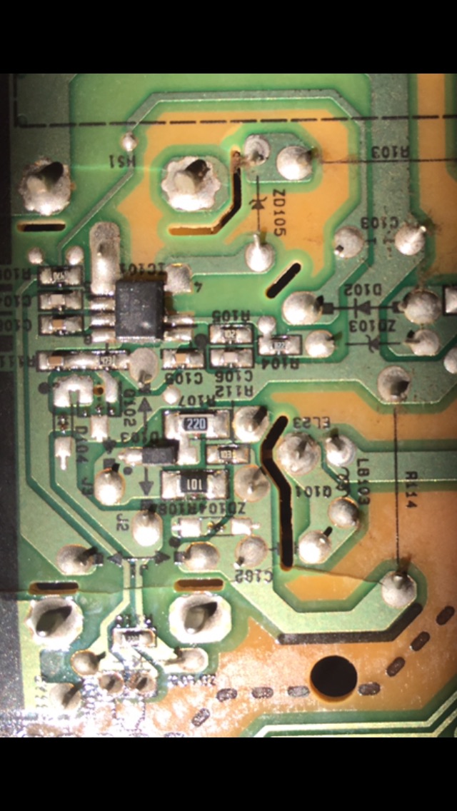

      There looks to only be three traces cracked, why don't you try and repair before sourcing a replacement ?
      I suspect the previous "fixer" dropped the board on it's corner.

        Well spotted. I didn't even see that crack. I agree with Diif that it should be an easy fix.
        If the supply isn't working then another site said:-
        "When the power supply was checked, it was immediately found that the failure was caused by the failure of the Q101 MDF10N65B power FET drain outlet and the "C102 330pF ceramic capacitor" of the "warm GND" due to a material fault.
        I got jammed with fix because I can not find any IC (IC101: SC1S311) of this type, but no substitute."

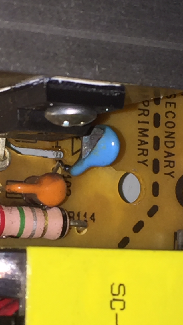

          Any thoughts on the value of c102 not sure how I missed it the first time around see pic
