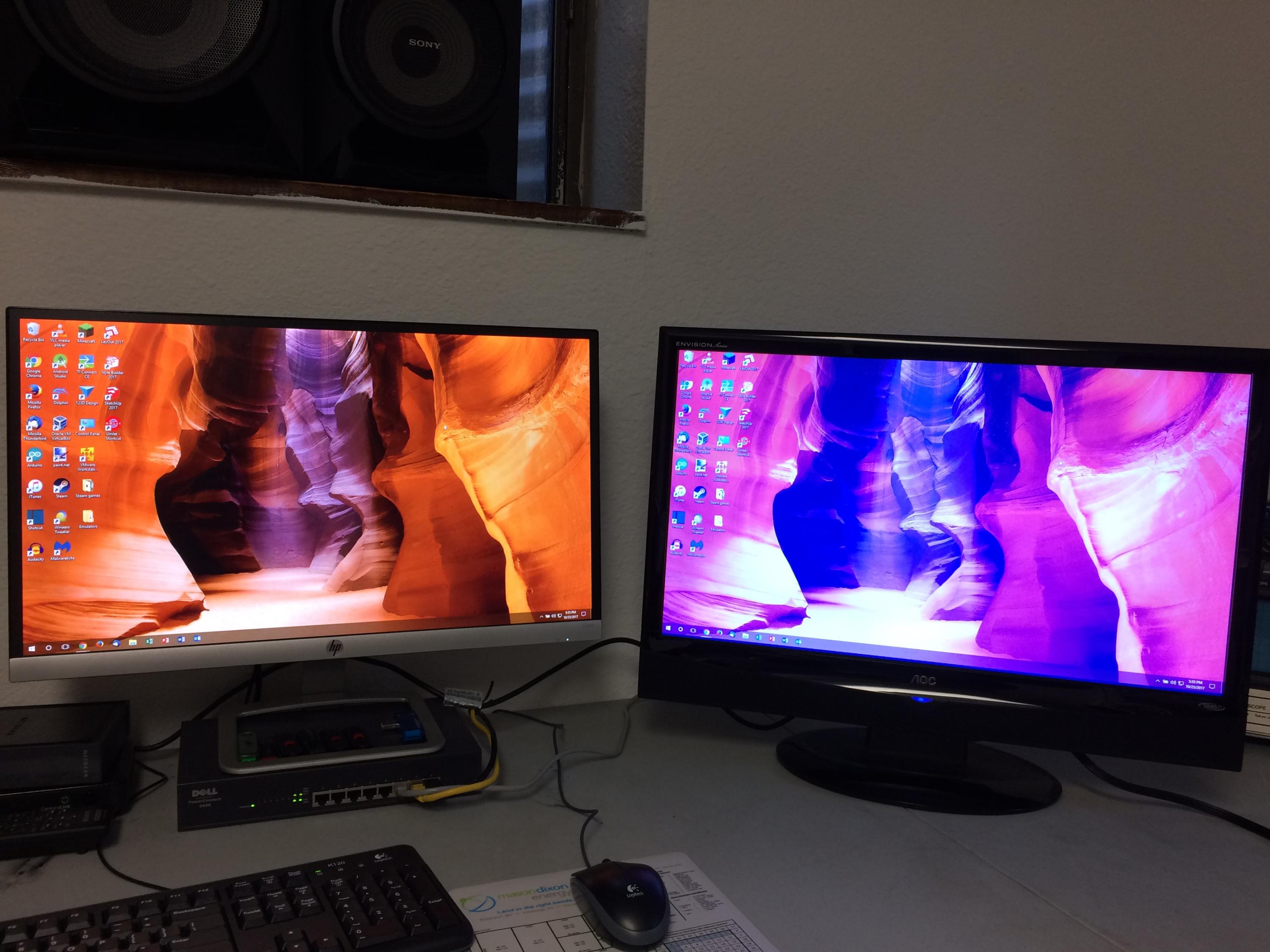

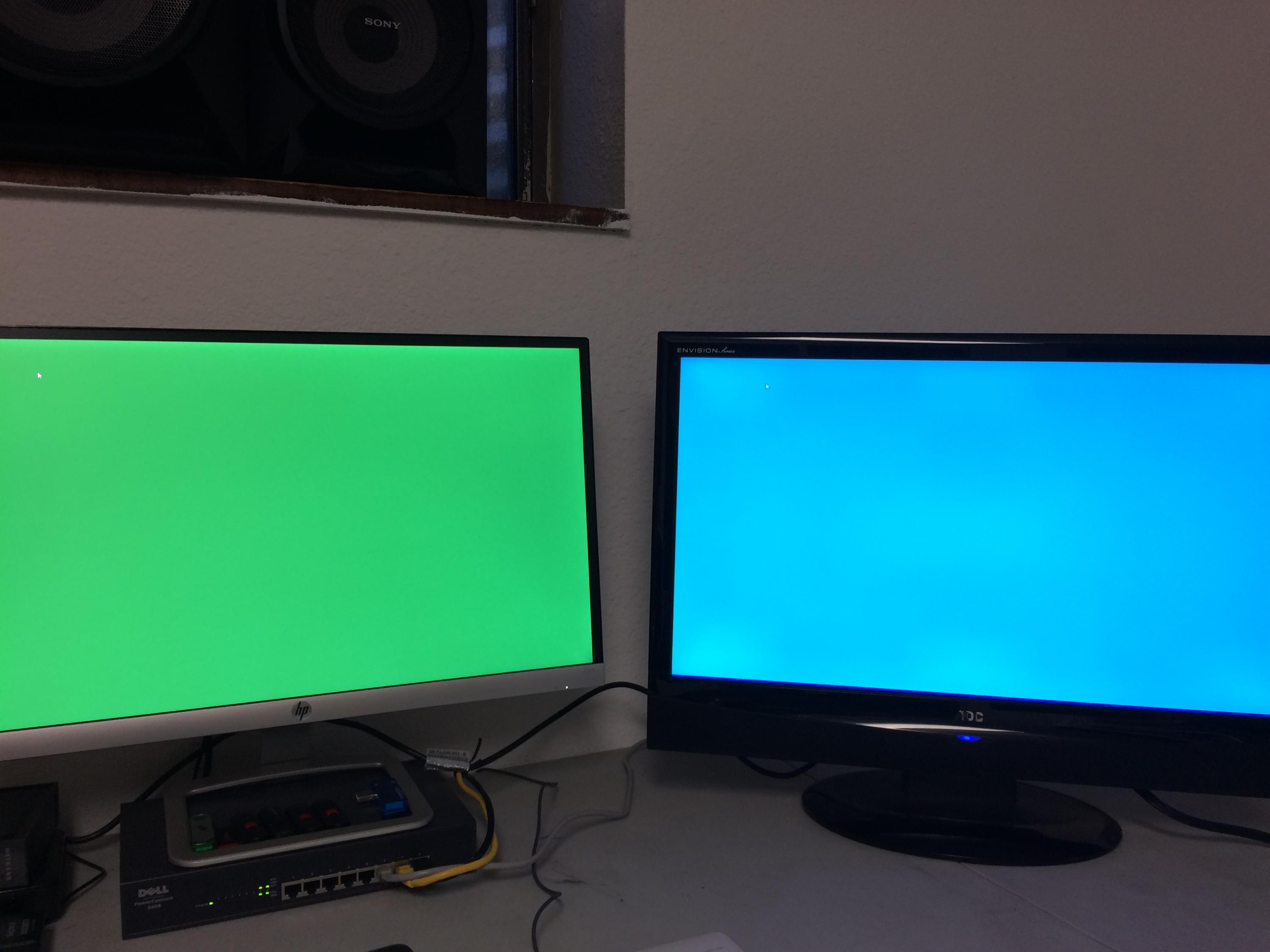

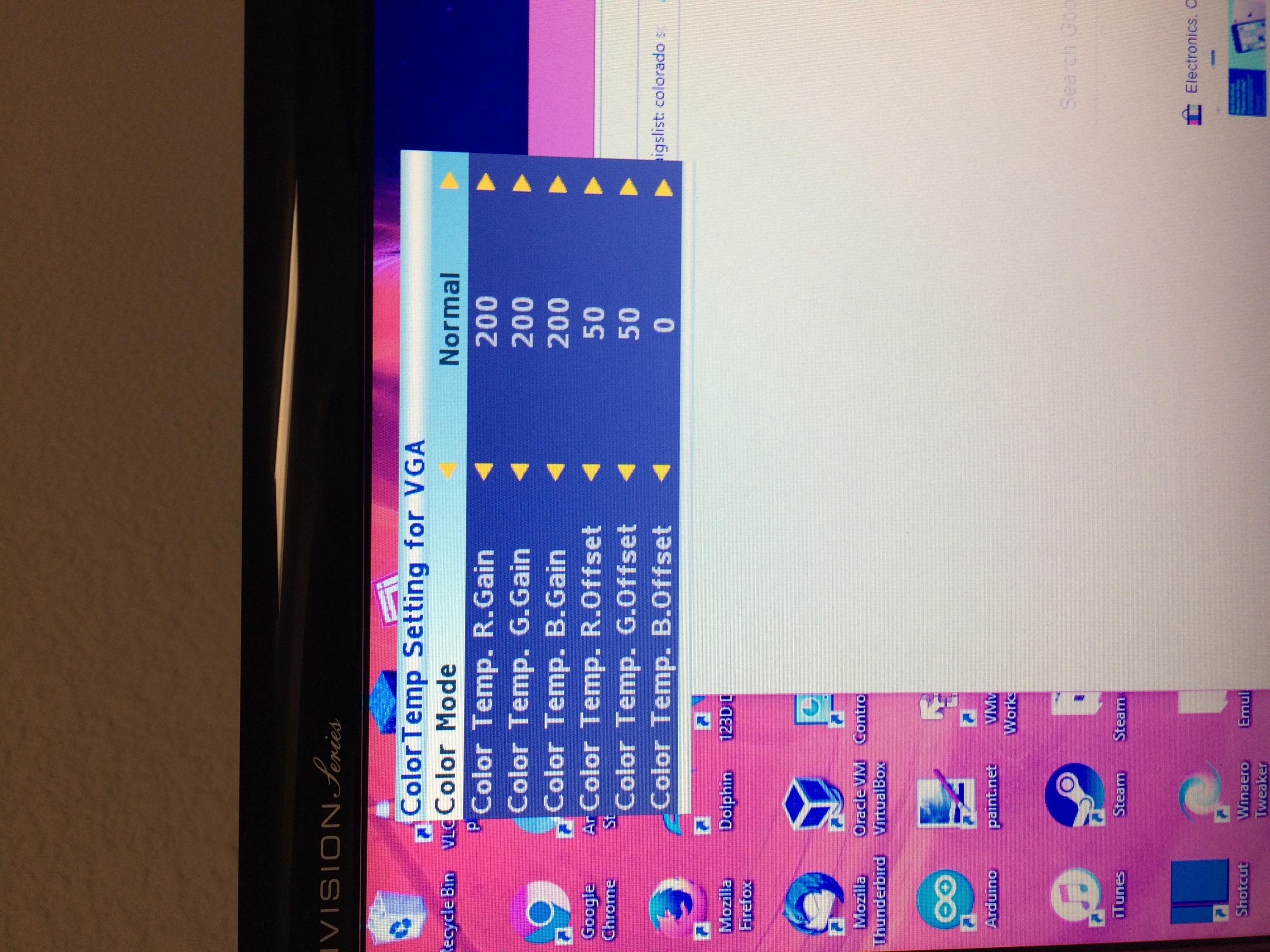

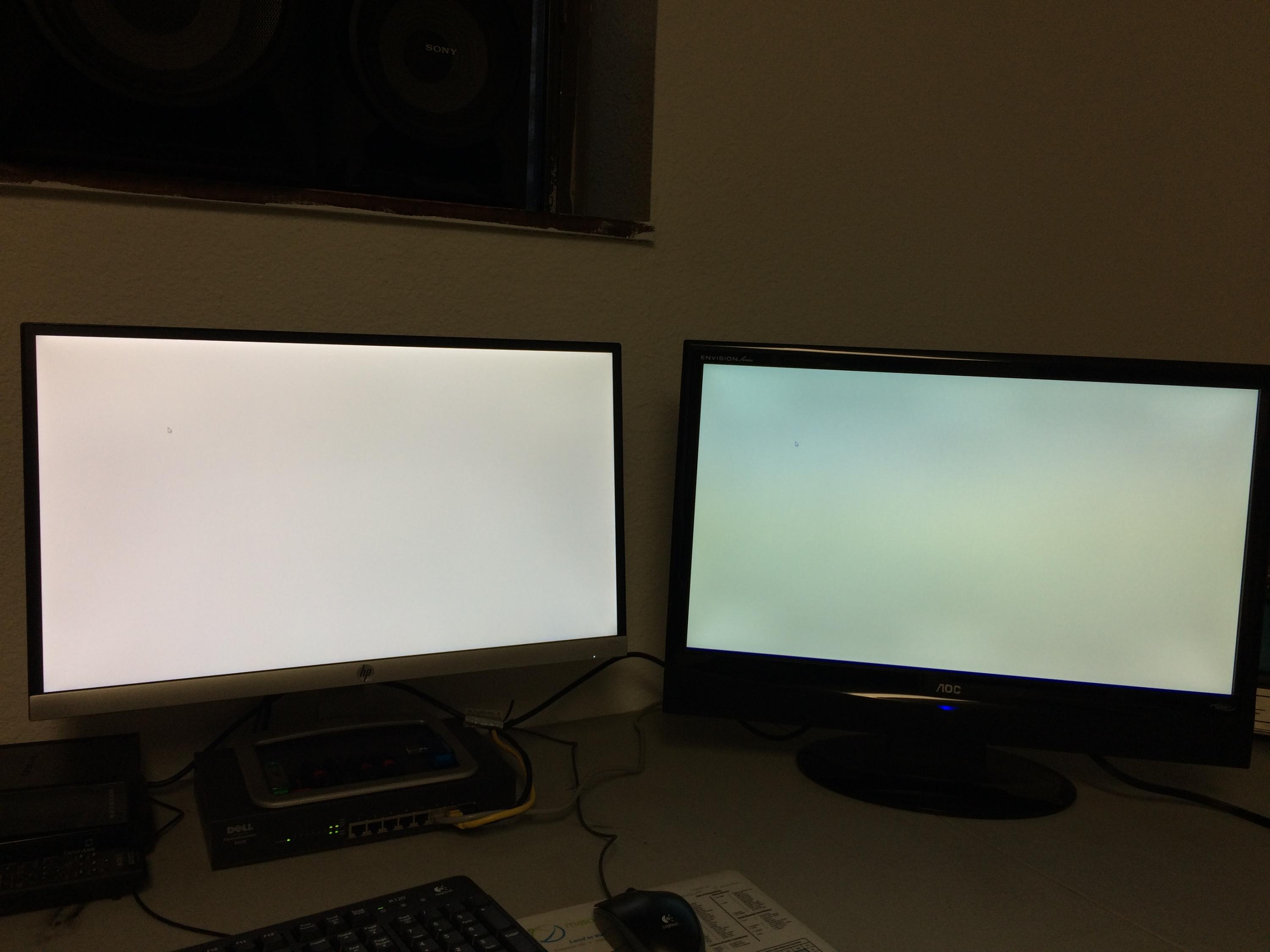

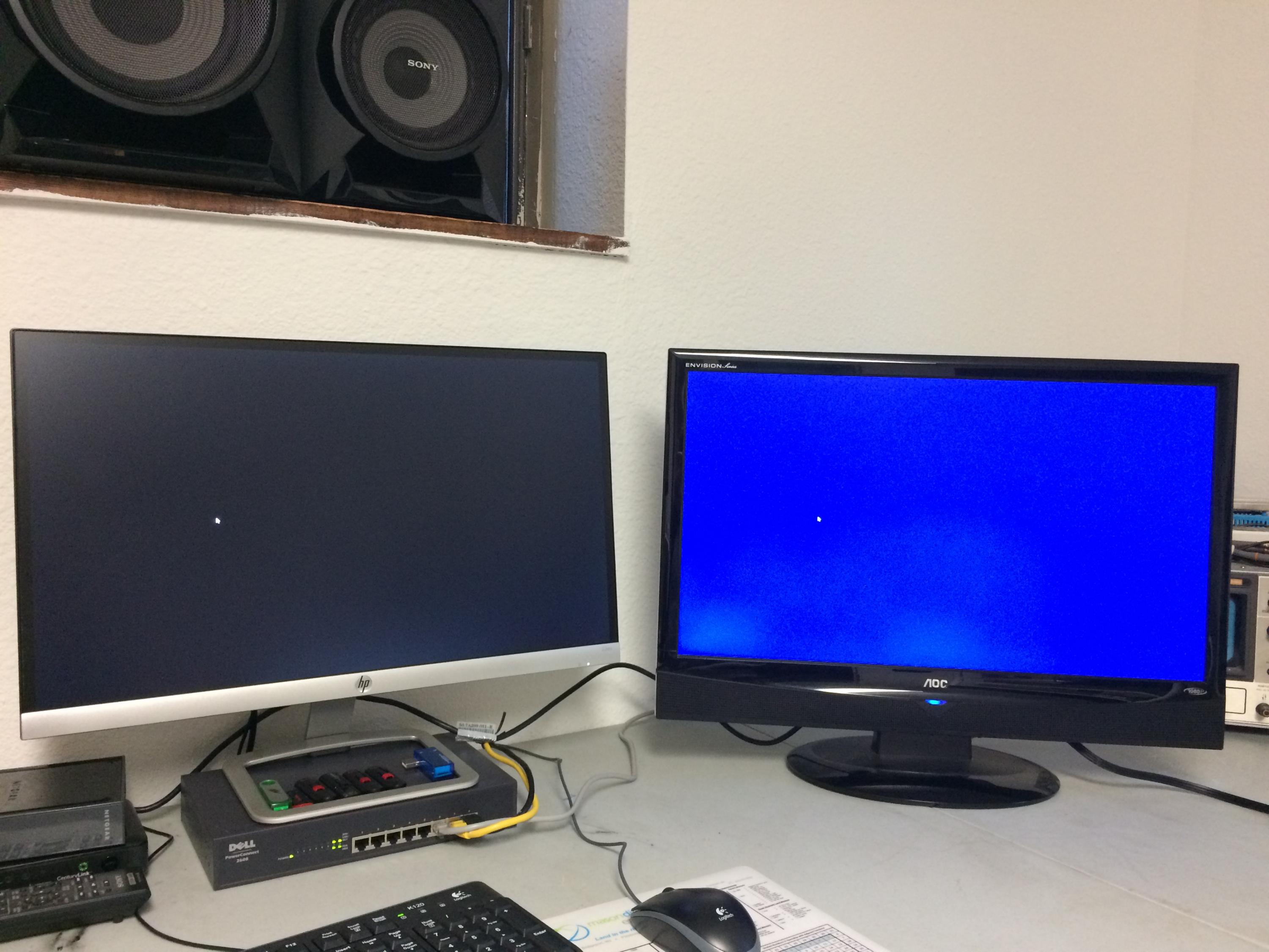

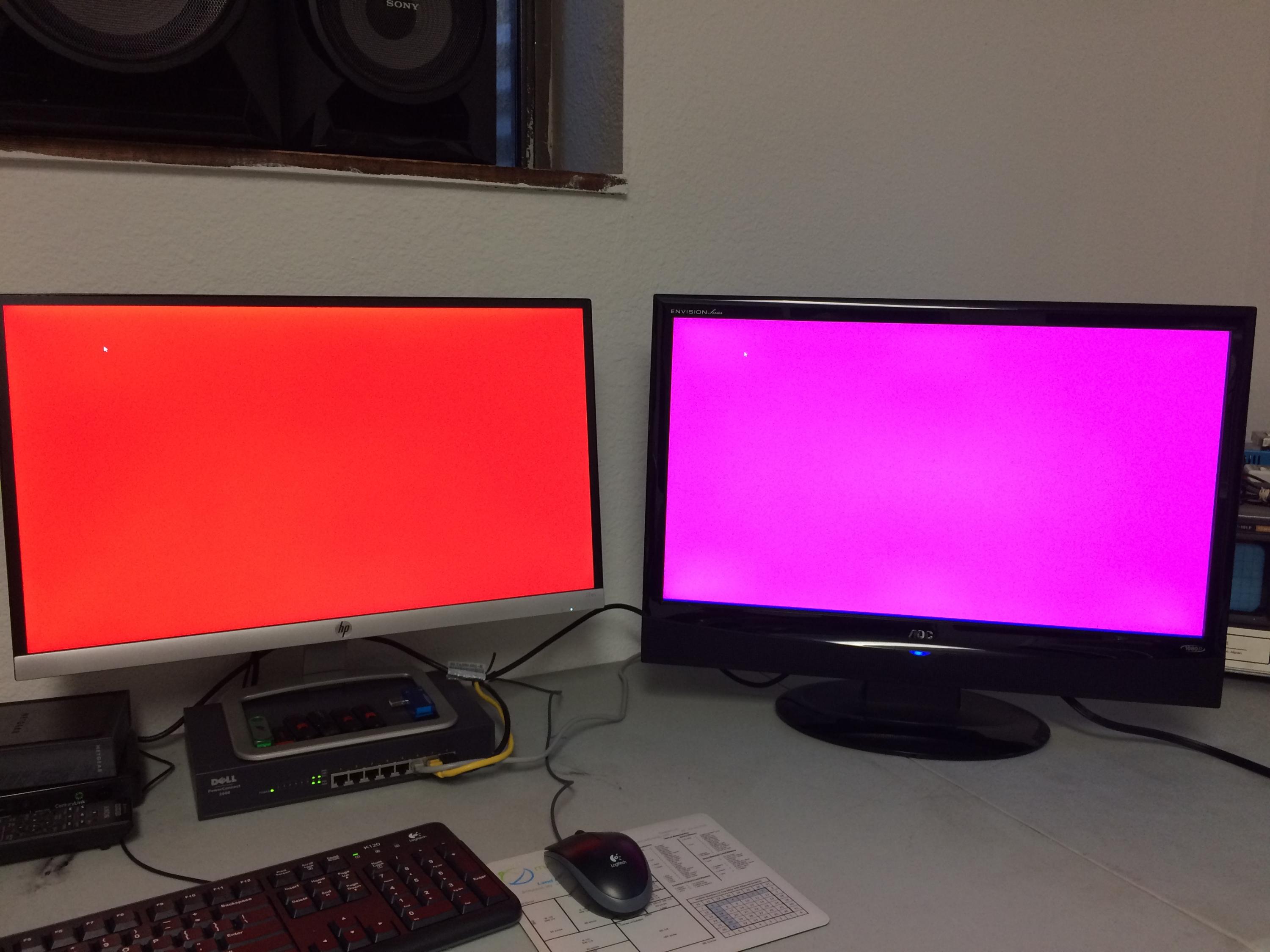

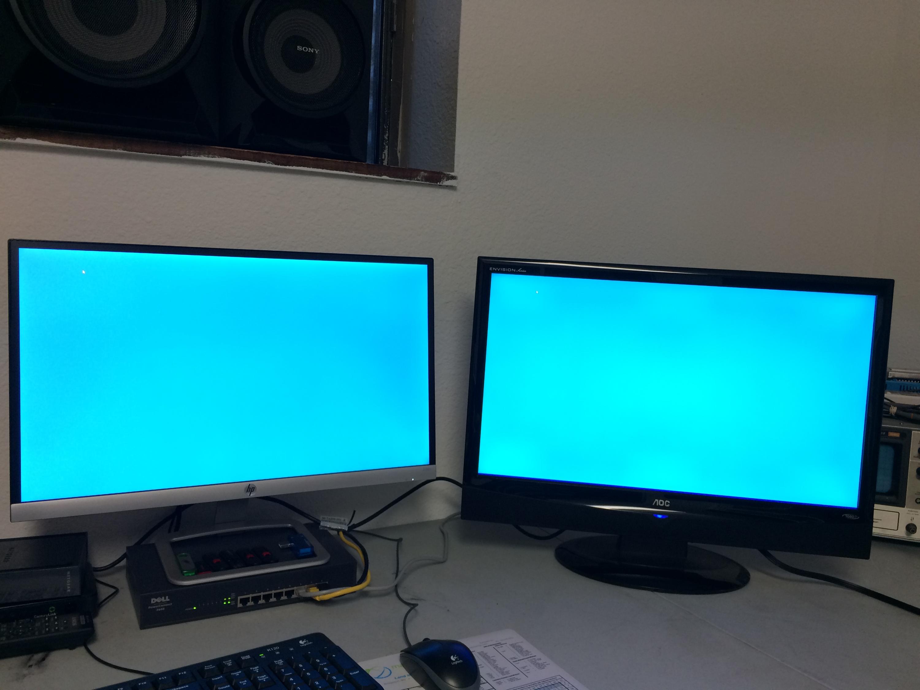

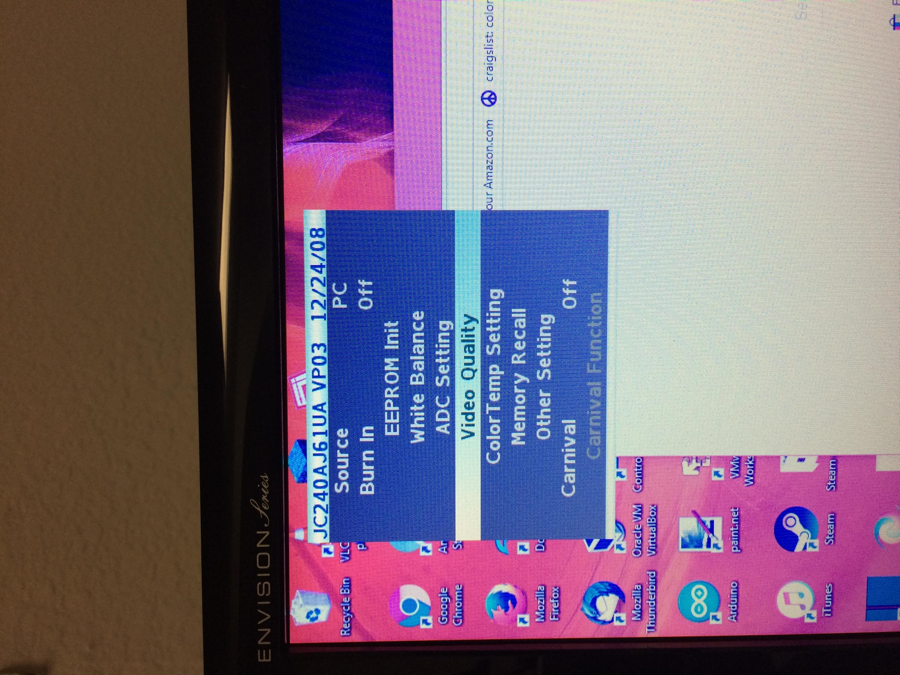

    So I have the AOC 24 inch TV that has really screwed up colors. Upon further investigation it appears that the previous owner messed with the service menu and now everything is messed up. I would like to fix the color issues, starting with the VGA input (each input has its own settings), but I have no idea how to. Does anyone know how to properly calibrate the display using the service menu? The values are a mess, maybe someone has an identical TV and they can give me the values?
    Pics comparing the AOC TV to my HP 23es IPS monitor. Both were hooked up to the same laptop in screen mirror mode, so they should look the same:

    Well, problem solved, everything works as it should now. Turns out the EPROM Init function in the service menu completely resets the TV to the factory default settings, including the color calibration values in the service menu. I'll leave this post up just in case someone else has a problem like this and needs a point in the right direction.
