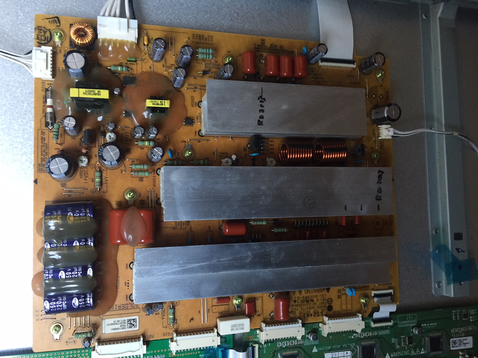

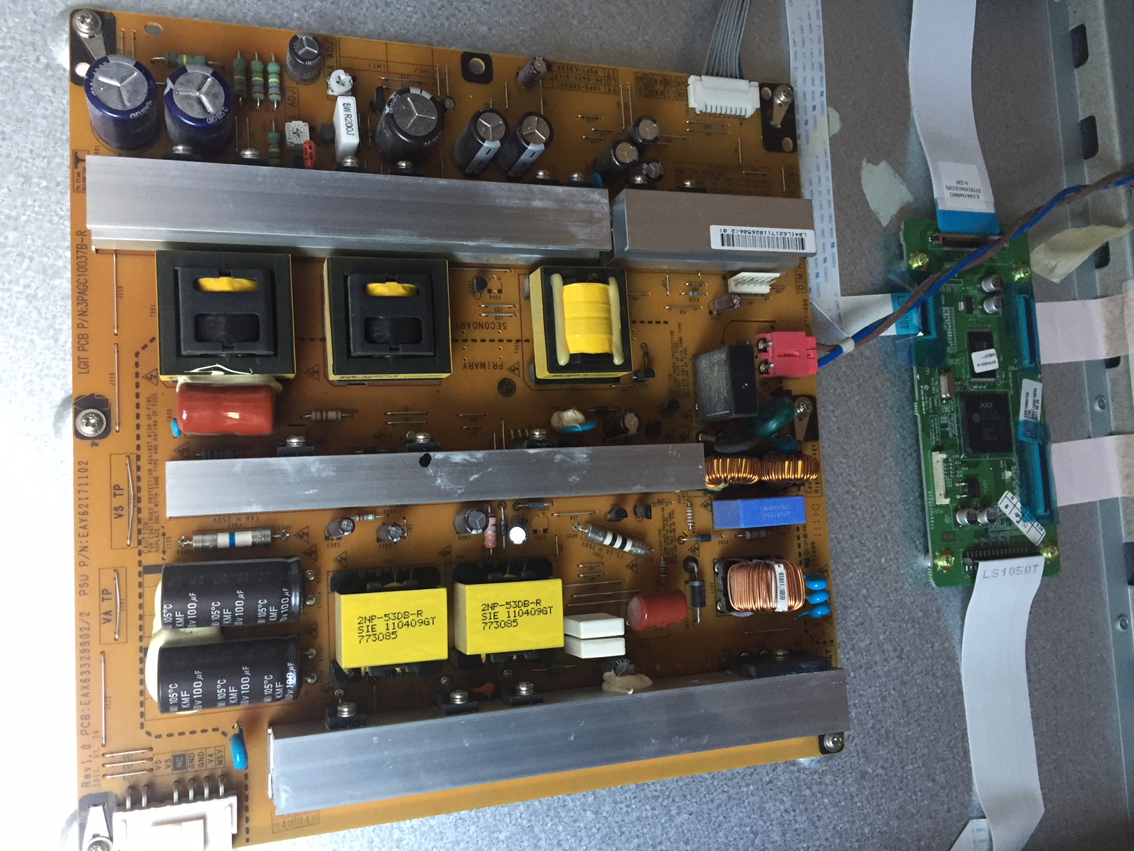

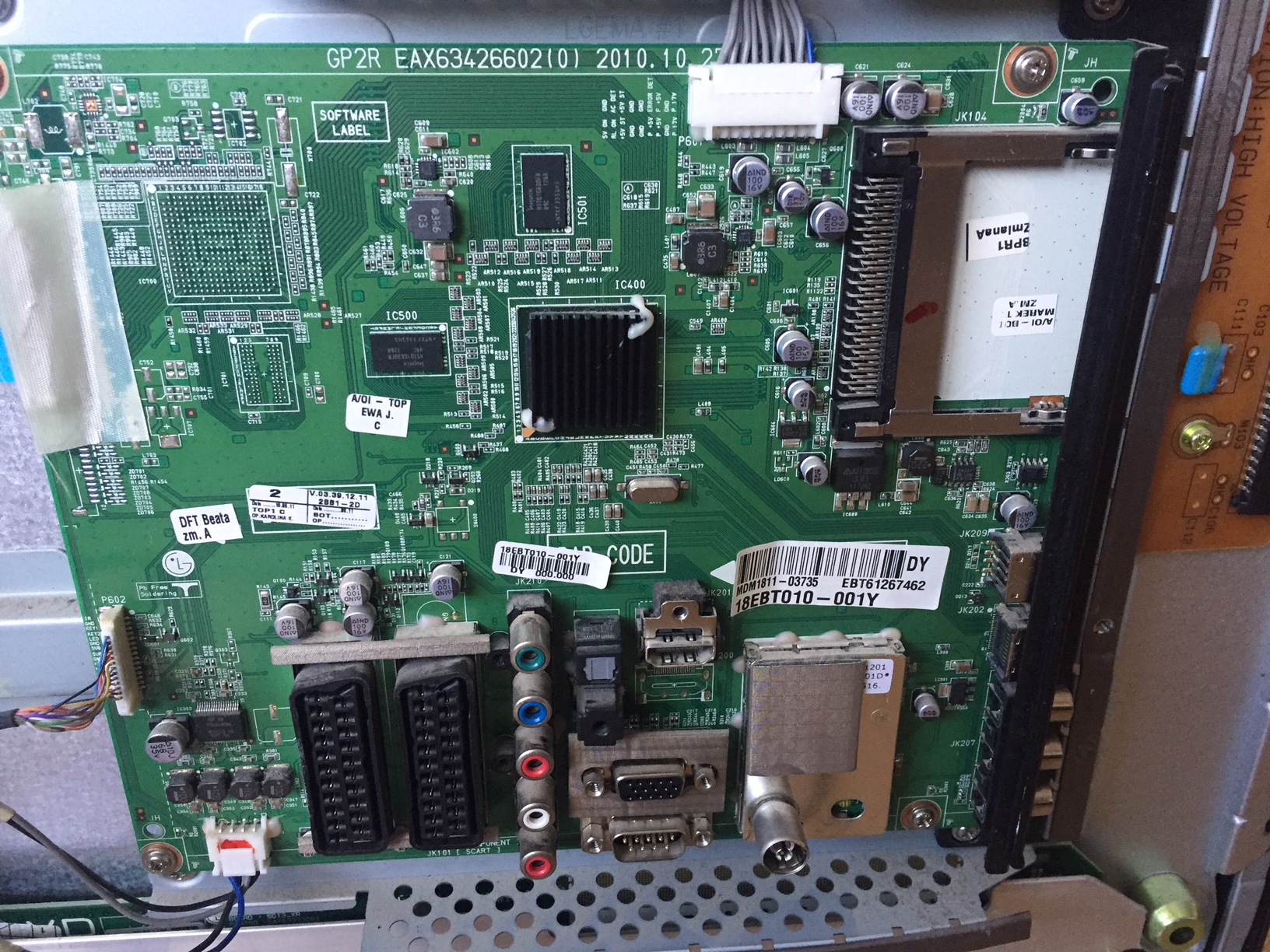

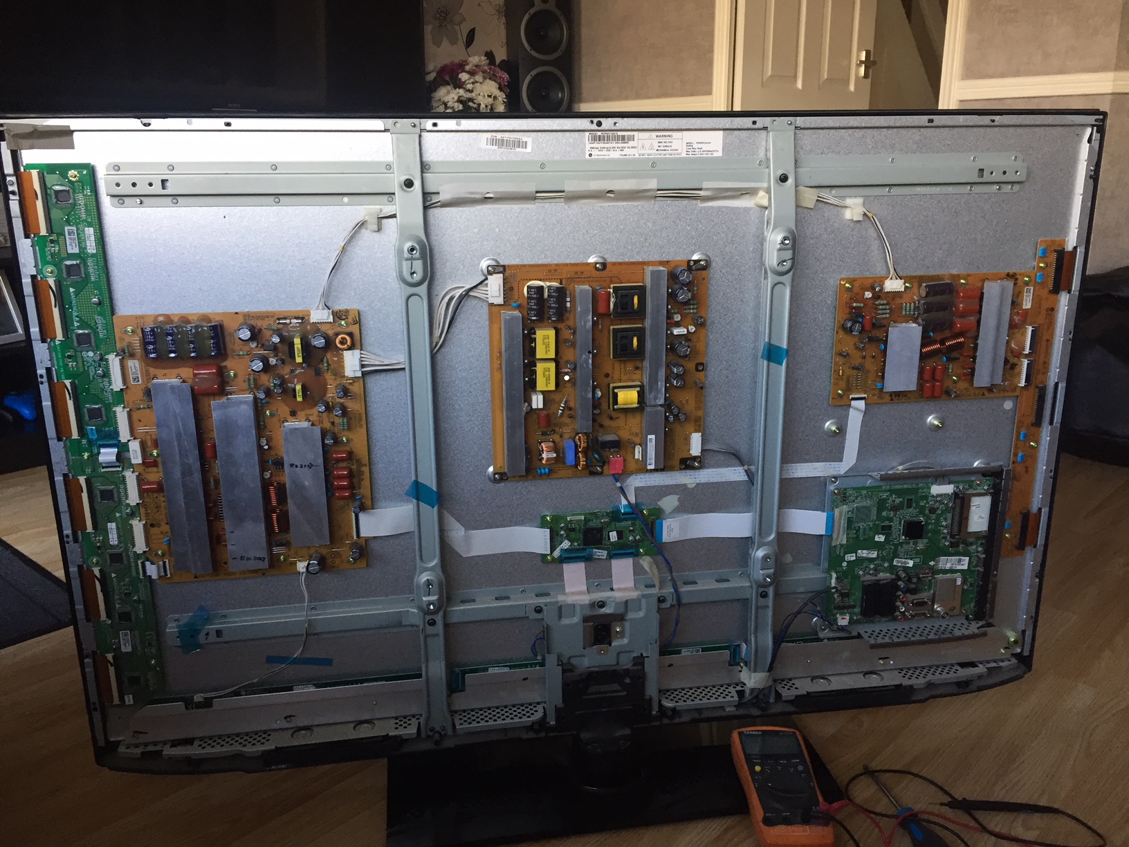

    Hi Guys,
    got this LG plasma, with flashing stand by, took the back off, and it was so thick with sticky fluff, so took out the power supply to clean it up before checking voltages, put it back in and the tv came on, but with very spotty pic, then took out Y-SUS, again, gave it a good clean up and put it back in, turned the tv on, and BINGO, turned on great picture.
    so im thinking to my self, nice easy repair job this is, took out the rest of the boards, give them all a good cleaning and then reinstall,
    turn the set on and, you guessed it, no pic, no screen flash, but the tv turns on and has sound though a scart.
    checked all volts and every one seems to be correct,
    cant find any shorts on buffers, but has i have no flash of the screen, im thinking X-SUS,
    oh, by the way, the led on the control board gives 4 flashes, the 3rd flash lasts longer than the first 2, and the 4th is quick, if that give any idea.

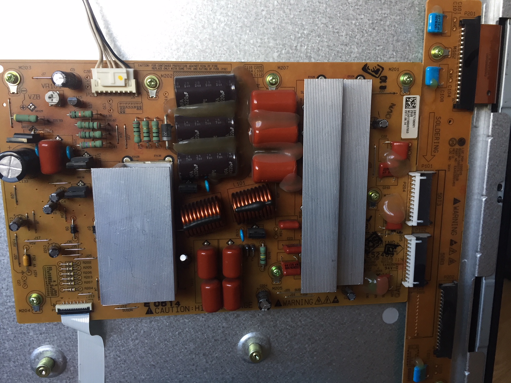

      Re: LG50PT353k
      So where has the centre ribbon to the ZSUS disappeared to? Under the sub board?
      • tw2005
        • Oct 2011
        • 6458
        Re: LG50PT353k
        Actually, just doing some extra research. It only has 2 ZSUS ribbons? found the sub board which is different to yours but suggests a running change in production.
        , certainly not something I've seen before.

            Re: LG50PT353k
            Originally posted by finntricky
            what sort of voltage should i be getting at the point x-sus to ribbon board ?, i only get 4 volts, that can't be right,
            testing fets and some of the reading are strange, but take them out and test ok,
            Not sure on this one but may be worth pulling the boards or at least the ZSUS and closely inspect th esolders particularly on those big coils. previous models have cracked through causing erratic behaviour and then the usual snap crackle and pop for a few IGBTs.
            Kinda been working on some LGs lateley(forgive me) Panasonics all dried up because some fool has spread so much info on how to.

              Is the TV running or in protect? Are the YSUS volatages normal?
              • finntricky
                • Jan 2014
                • 449
                • uk
                Re: LG50PT353k
                all voltages at test points are spot on, give or take a volt or 2.
                and the tv boots fine, with sound and no picture

                  Well it was working, now not, If the volatages are correct on the ZSUS test points too I'd check th eboard then maybe try thr old ctrl bd jumper screen test with the main isolated. can't be much though if you had it and now lost it.

                      should also mention that if the ctrl bd craps itself, you'll see nothing but will have sound. that's the issue with the one I've got, don't remember if the panel primes up or not, if I try really hard I can get some
                      • finntricky
                        • Jan 2014
                        • 449
                        • uk
                        Re: LG50PT353k
                        checked all the solder joints, and tried the auto gen, still nothing, think ill gumtree it, let someone else have a go, not worth spending money on a 720 plasma
