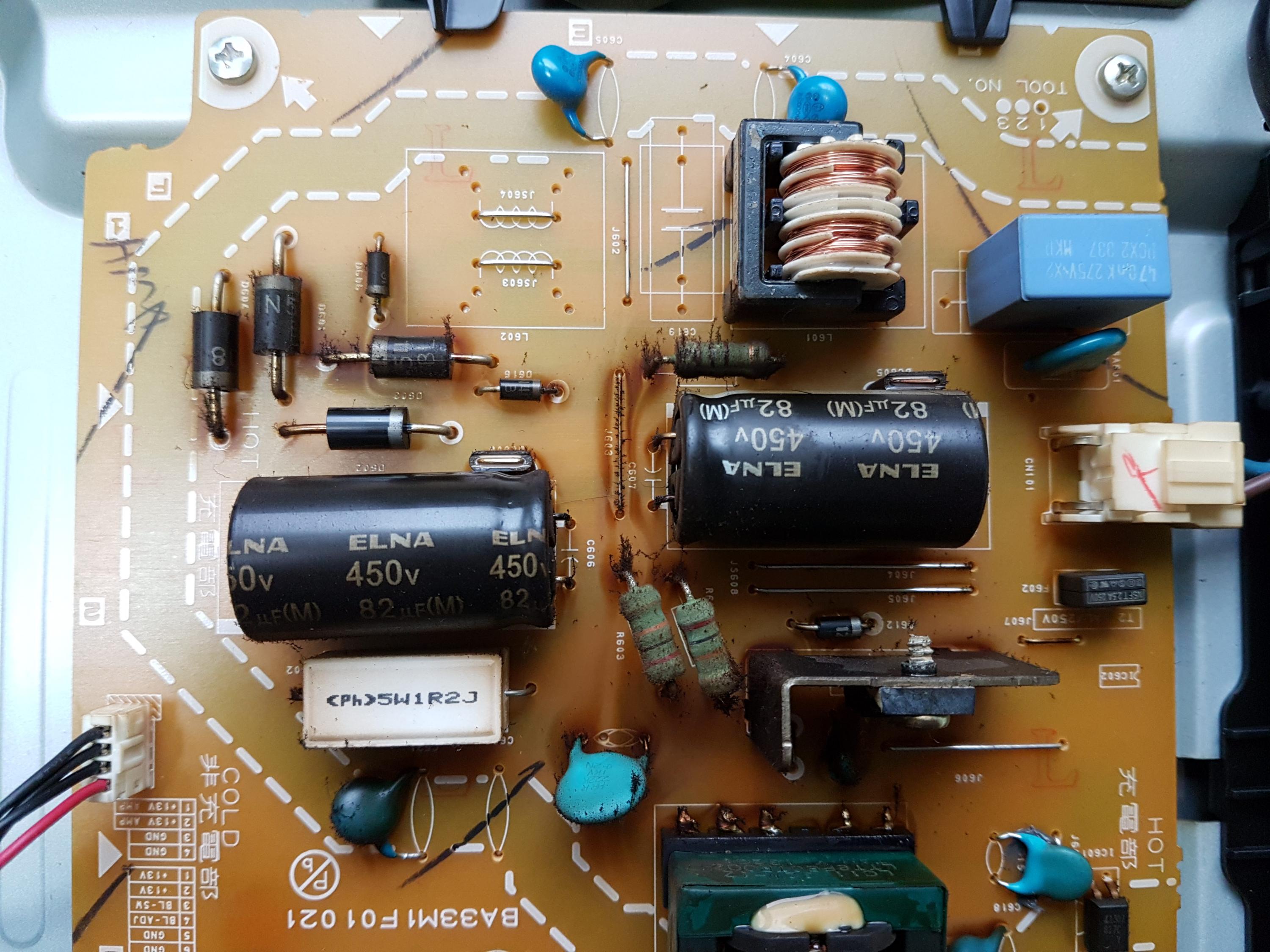

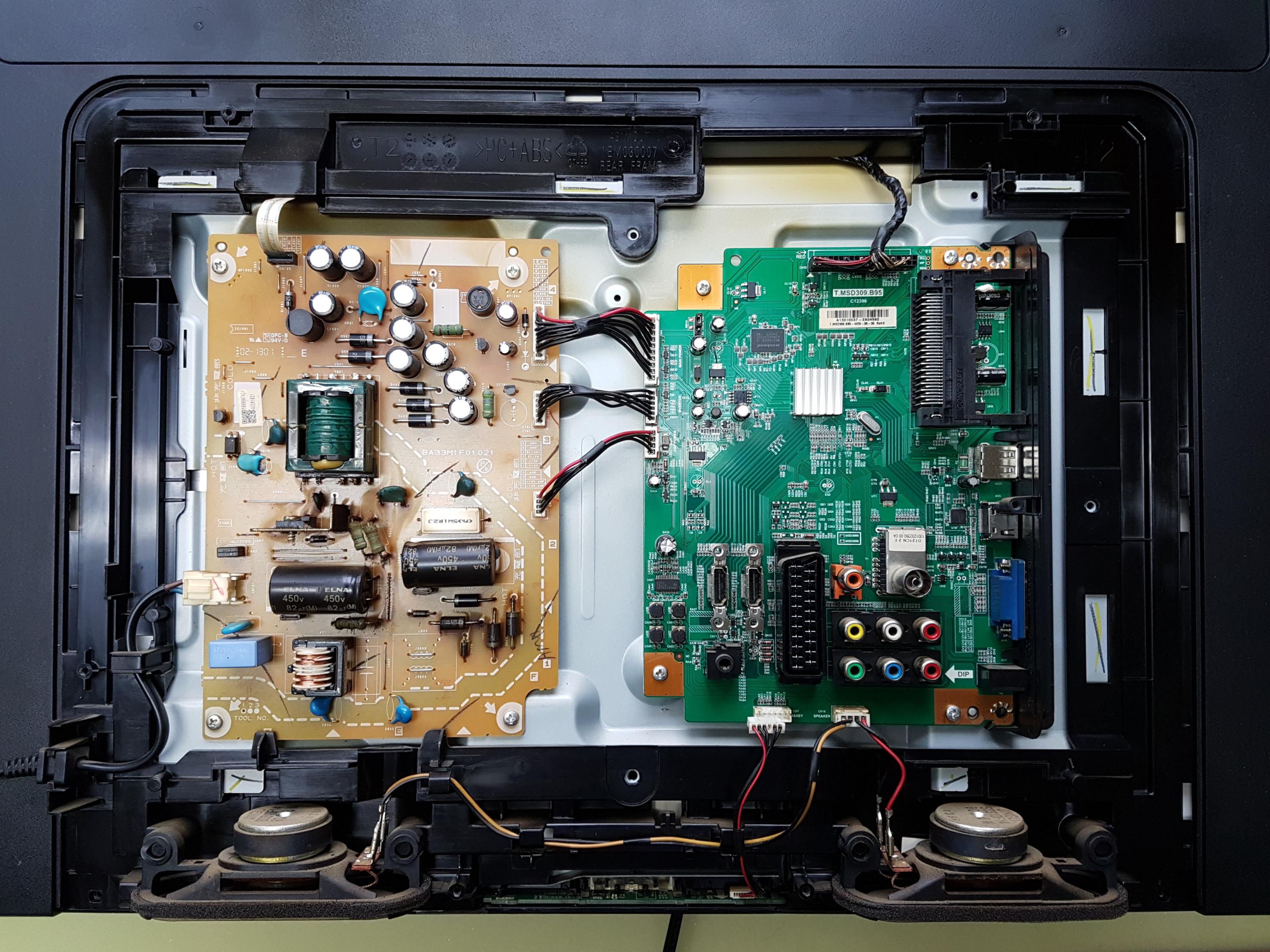

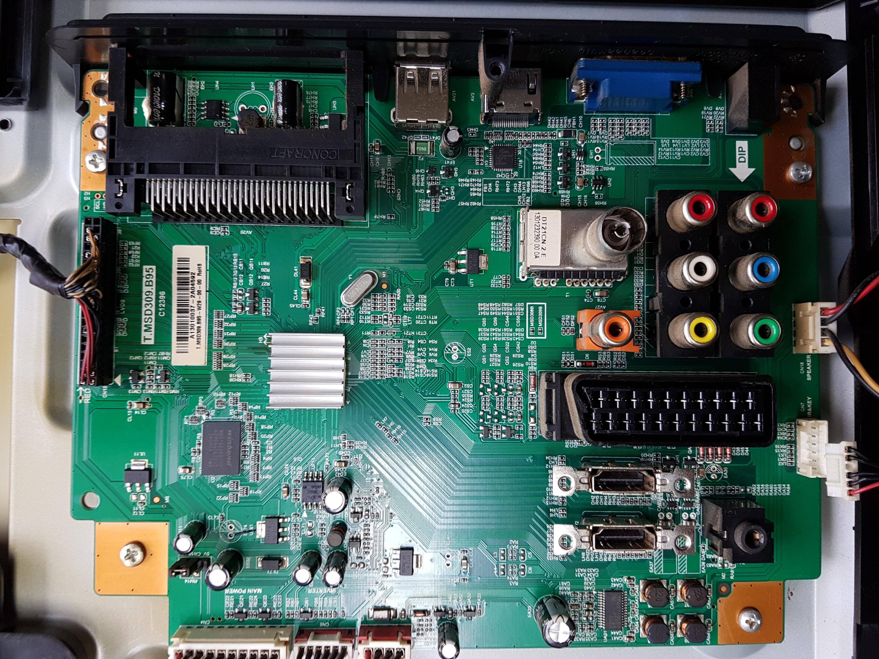

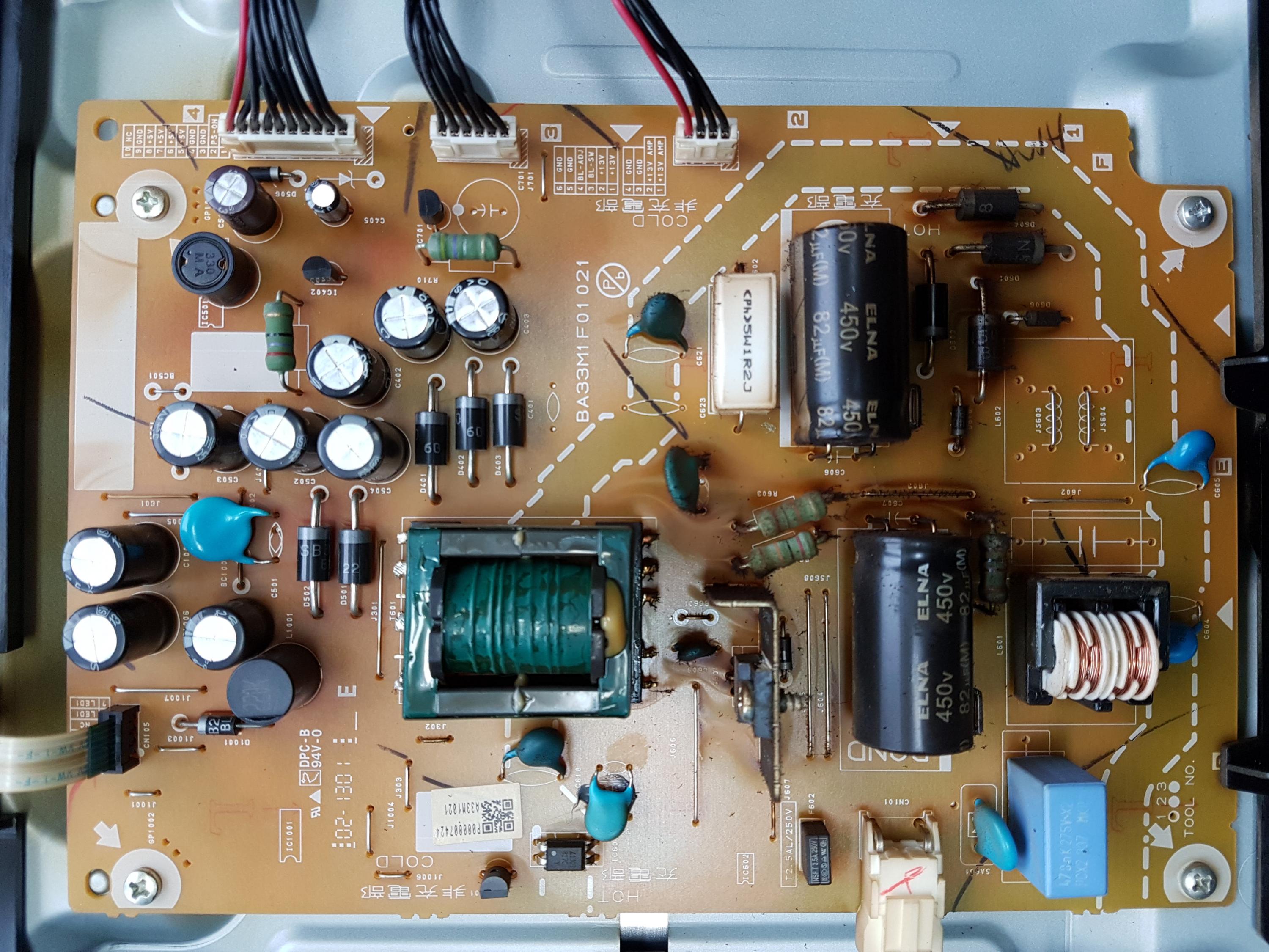

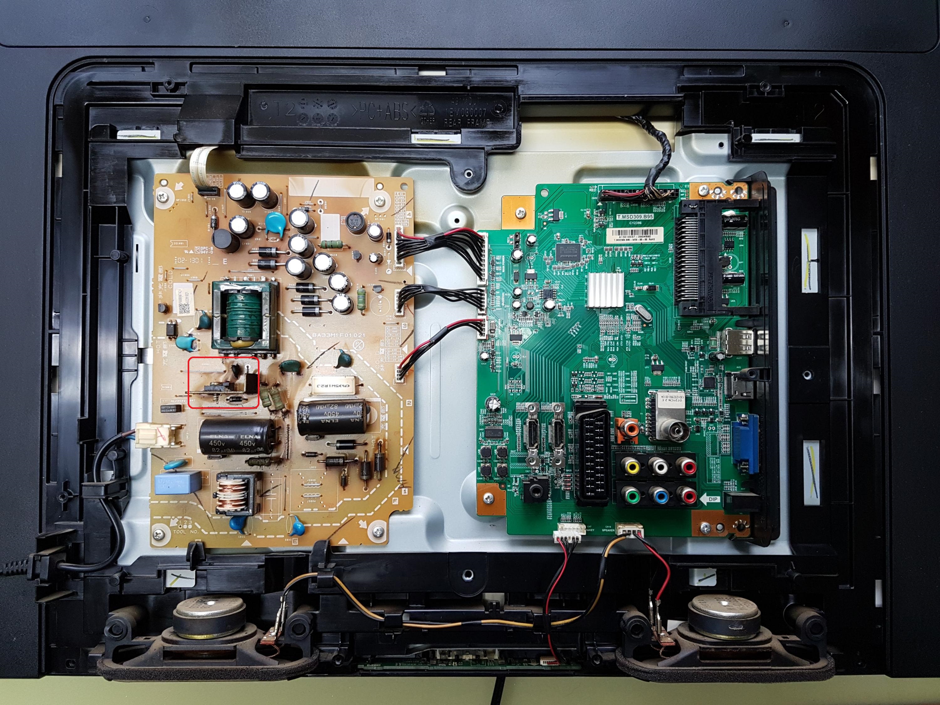

    Hi, I got Funai LED TV 29FL553/10N
    It turns on, draw 27.5W from wall outlet and reset again.
    What could it be? Caps in power supply are visible good - two biggest I measured ESR and capacity and it's ok.
    Could it be EEPROM failure? Maybe someone had similar problem?
    Video with power meter:
    https://youtu.be/pE_0rHrP1Ig

    Do you get a logo and do you see it freeze before it reboots?
    A freeze and an auto-reboot is likely an OS panic due to corruption, especially Android.
    If it just seems to keep turning off and coming back on, reflow the PSU solder joints, including the primary...

      Re: Strange bootloop - Funai LED TV 29FL553/10N
      I see logo for a couple seconds - I uploaded YouTube video how it looks.
      I dont know if it is android - I dont think it is even smart TV.
      After logo turns off it stay black with backlight for few seconds - so I dont think it freezes

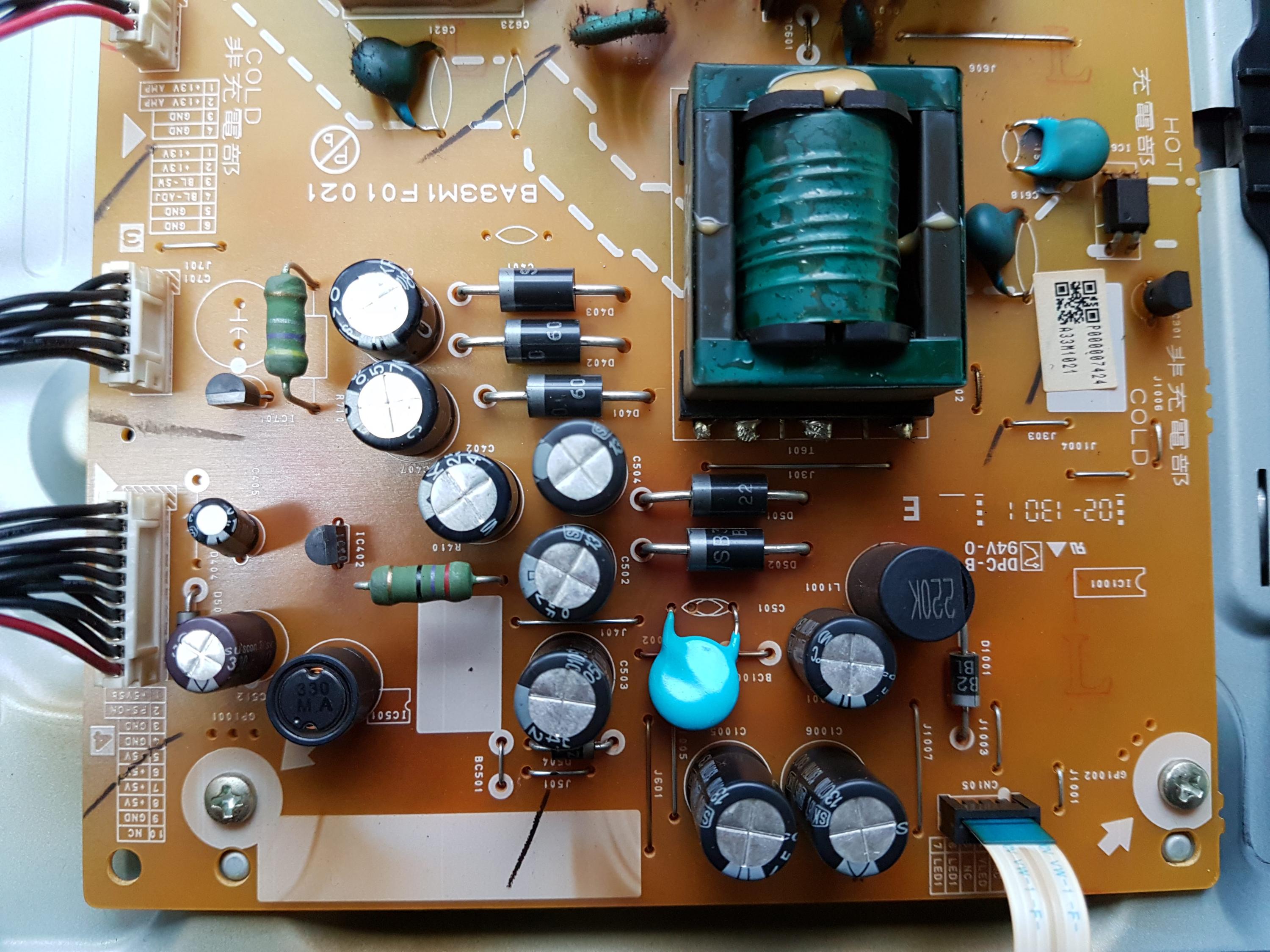

        It look like you have a blown mosfet and possible ceramic capacitor.
        • Folxs
          • Nov 2016
          • 167
          • Poland
          It's just dirt (dust and cigarettes smoke)

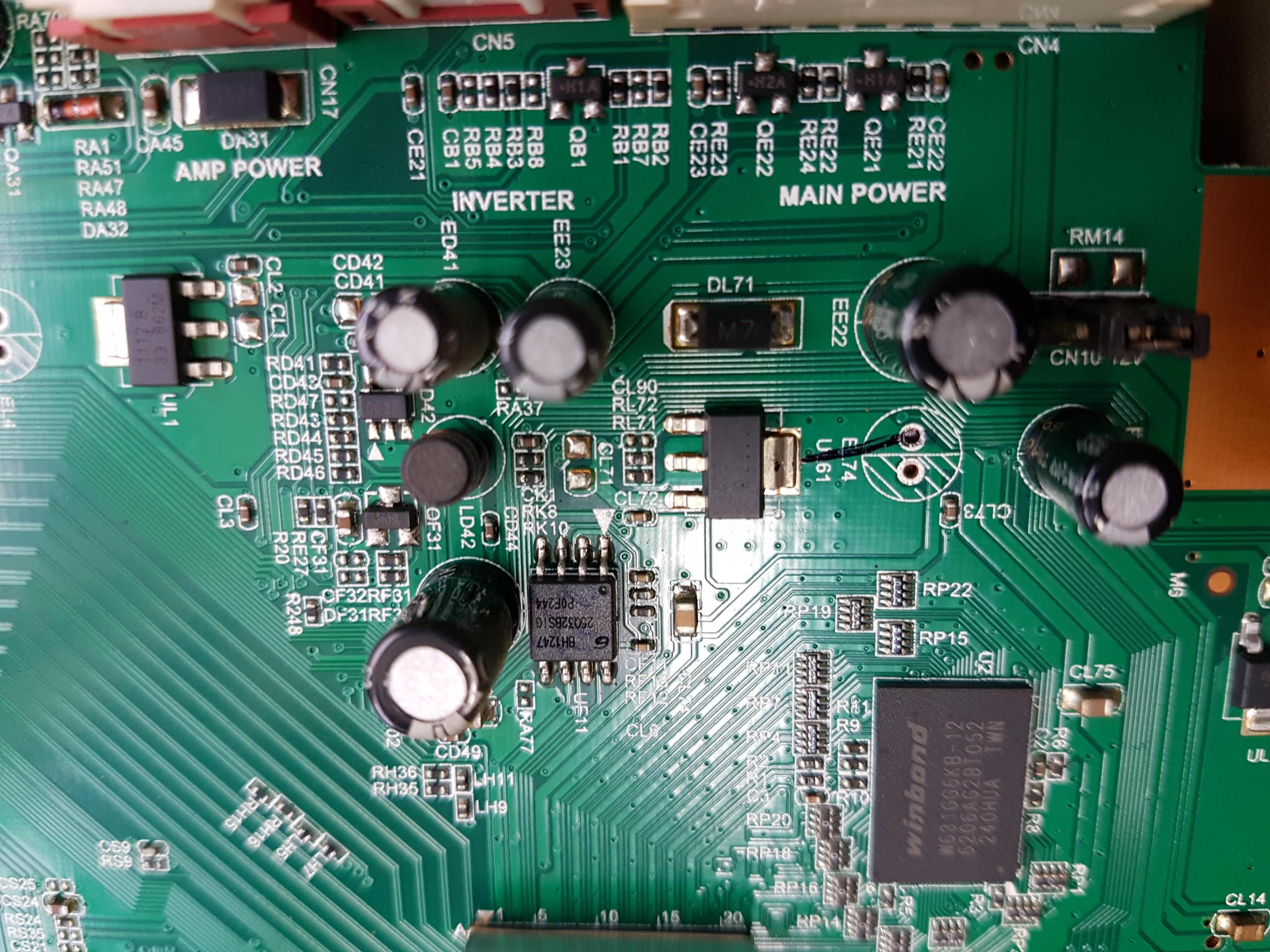

            I've had similar, TV showed boot logo then restarted, and showed logo and restarted and repeat..
            Was the eeprom at fault. Flashed and all was well.
                Ok, I will try to reflash eeprom
                  Reflash helped for a while - now I turned on the TV and the same bootloop. I think that the chip is broken itself and it lost data again, what do You think?
                  I will try if the new chip will help - maybe something drifferent causes erasing the chip?
                    The chips do fail. Just flash the dump you have to a new chip.
                      It's working! New FLASH chip helped!
                      Thanks a lot for sugestions! Especially diif
                      Below I uploaded FLASH Dump for this TV (thanks to zdzifu from elektroda.pl forum):
                      FUNAI 29FL553/10 (mine was 29FL553/10n)
                      Motherboard: T.MSD309.B95 flash 25Q32BSIG
