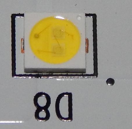

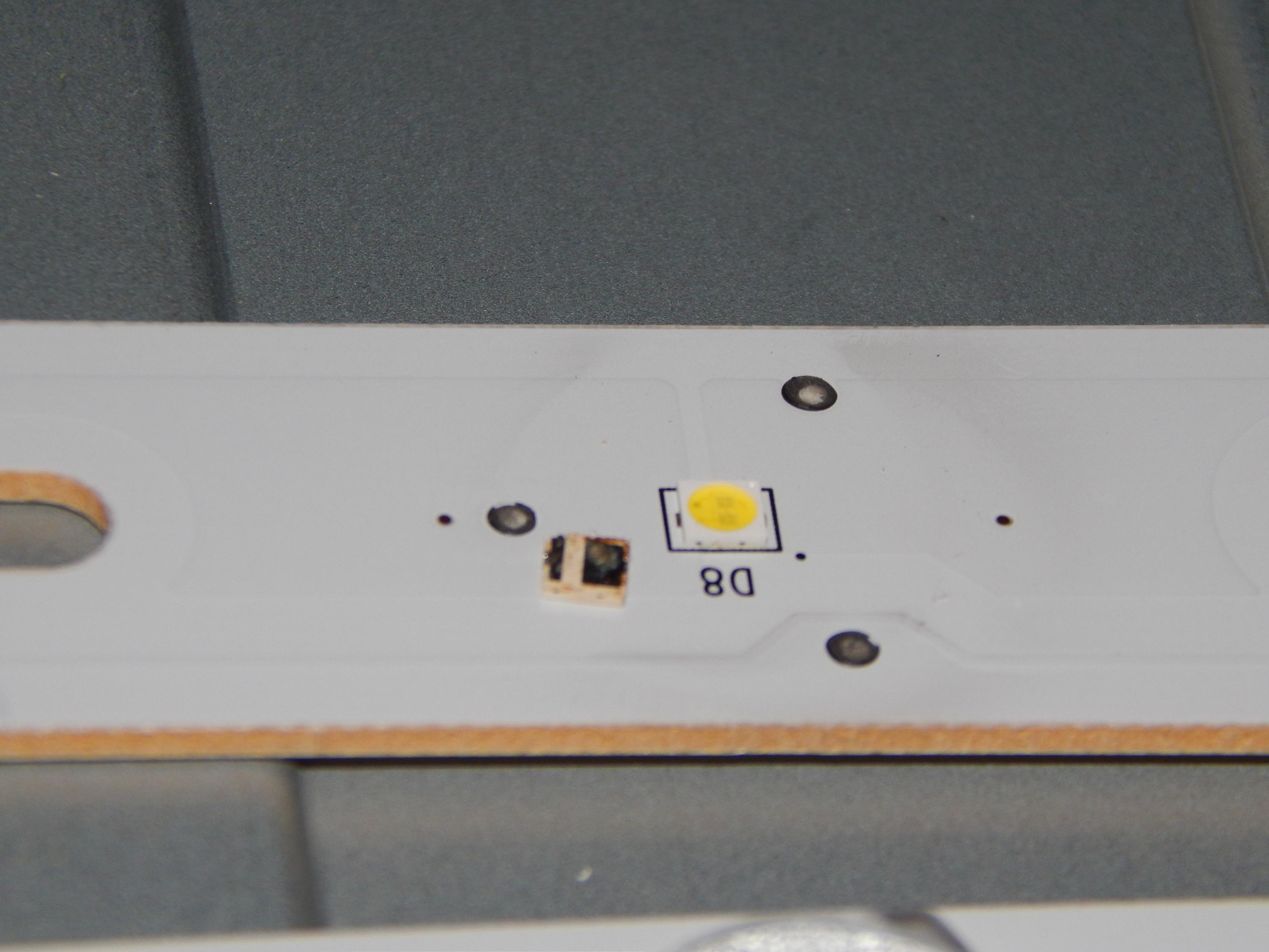

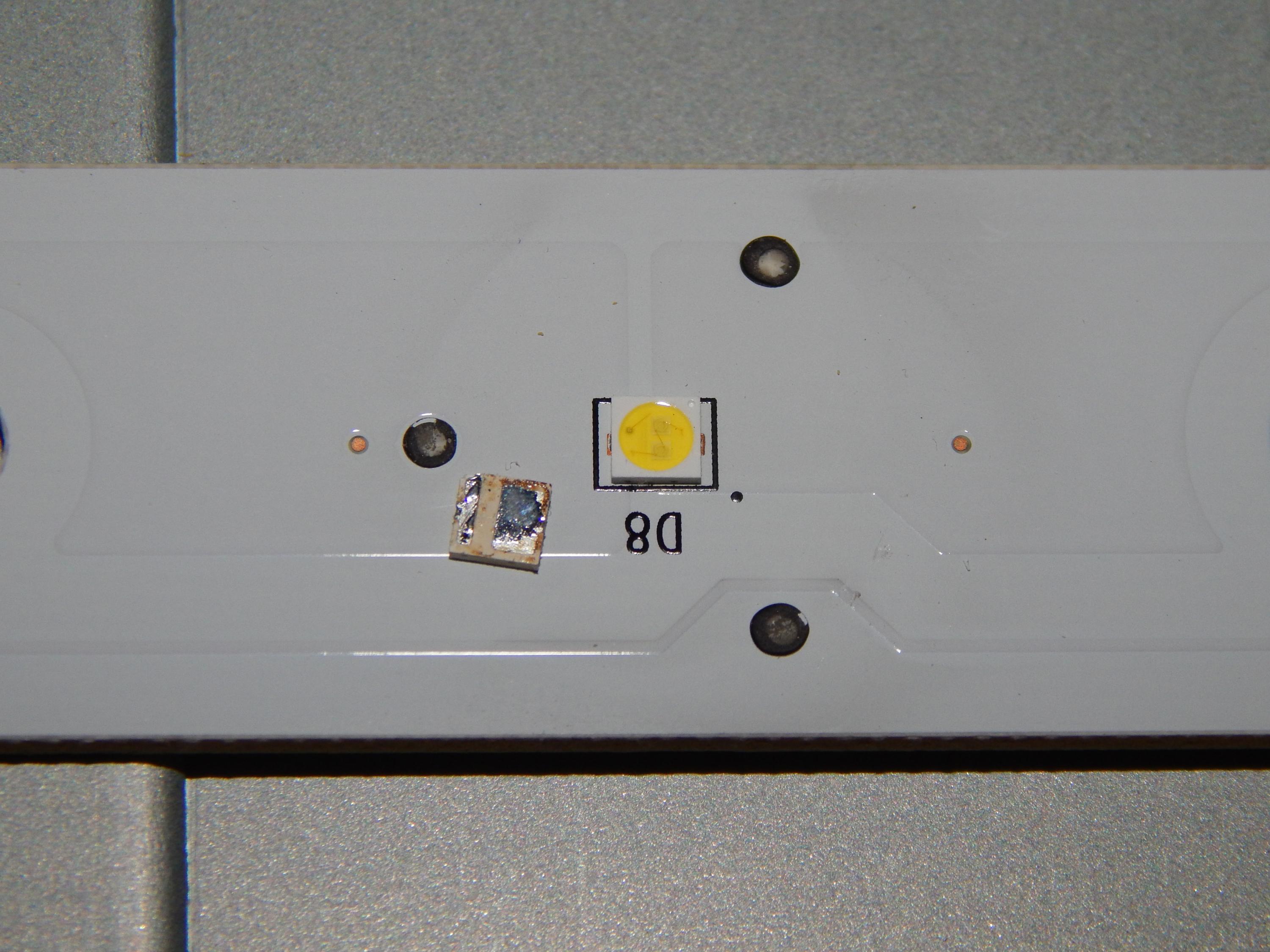

                                Here are closeups of the leds
                                Would these be them?
                                https://www.aliexpress.com/item/350P...b-d12c17a90f37

                                  Re: Toshiba 58L4300U no leds
                                  have you measured the size of the old led? what you also need too do is work out which one on the old led is anode and cathode so you get the correct pad layout
                                    I don't understand what you mean.
                                    If you are referring to which side is positve and which is negative then the small pad is + and the big pad is -. its the only way it will light up with my tester.
                                        The led in post #35 looks like it has two leds in series internal to the pack so may well be 6V leds.
                                          yes i did mean the anode and cathode side also though the physical size of the old led just so it fits under the lens correctly and as dick barton says is this a 3v or 6v led as first link you posted was 3v and second link was 6v
