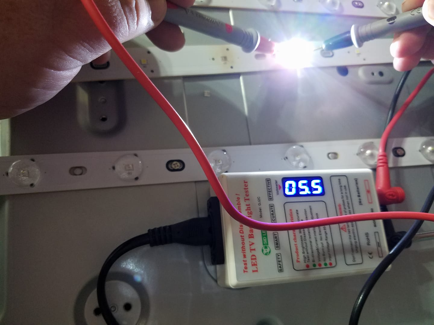

    The led in post #35 looks like it has two leds in series internal to the pack so may well be 6V leds.
    When i put my led tester to it it runs up to 5.5v to light an led fully.

      Here is a shot of the tester.
      Before i took the led off this strip i tested removing led's off a strip from another tv that i broke. I put the tester on that led from a different tv and it only went to 2.5v to light it. So i'm assuming the other tv used 3v led's while this tv uses 6v like you mentioned.

        Re: Toshiba 58L4300U no leds
        So your replacement led must be a 6V led.
          6v leds like in your second link if the physical size is the same they should be fine
