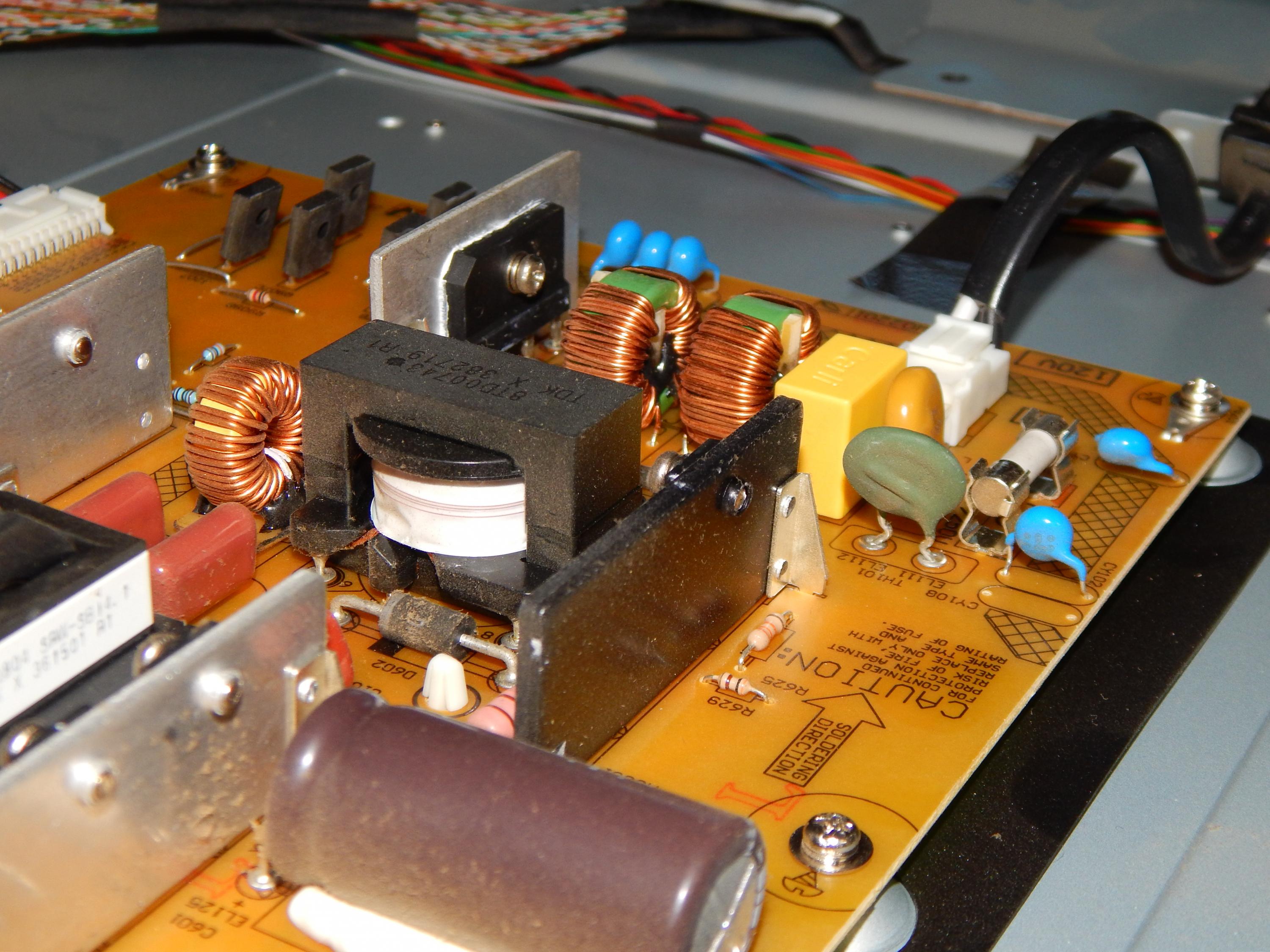

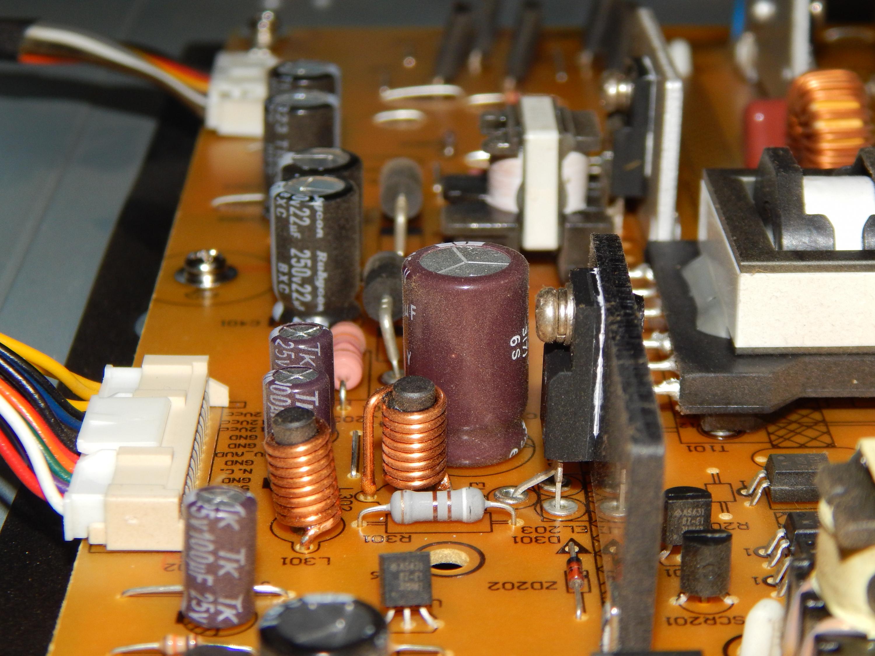

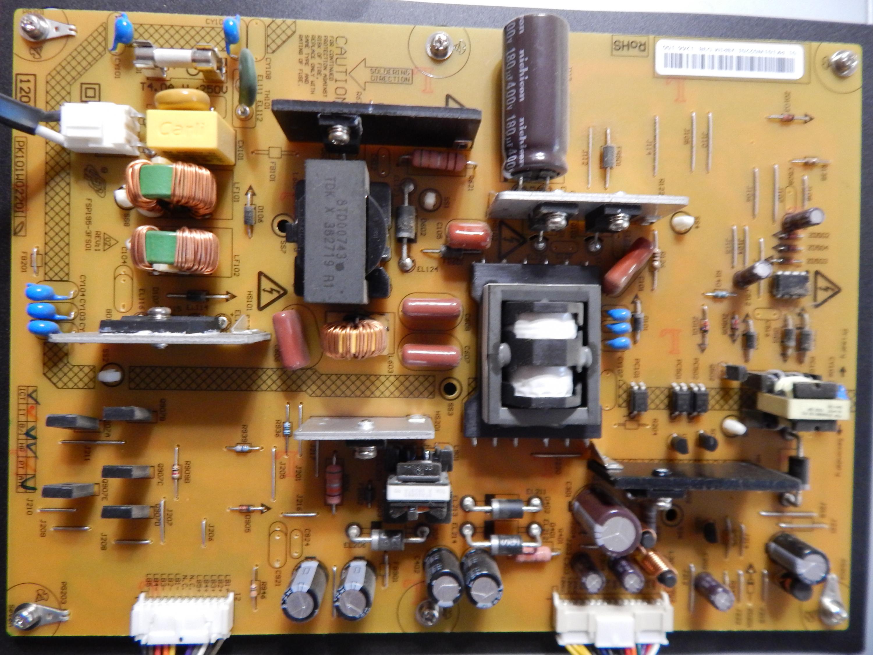

    Ok I just picked up this tv last night. Owner said it has sound but no picture. I got it home and plugged it in and the Toshiba logo lite up for about 2 seconds or so and then went away. I hooked up the dvd player to hdmi 1 and it started playing sound. If I turn the tv off and back on the Toshiba logo does not appear. If I unplug for a moment and plug it back in the Toshiba logo comes back.

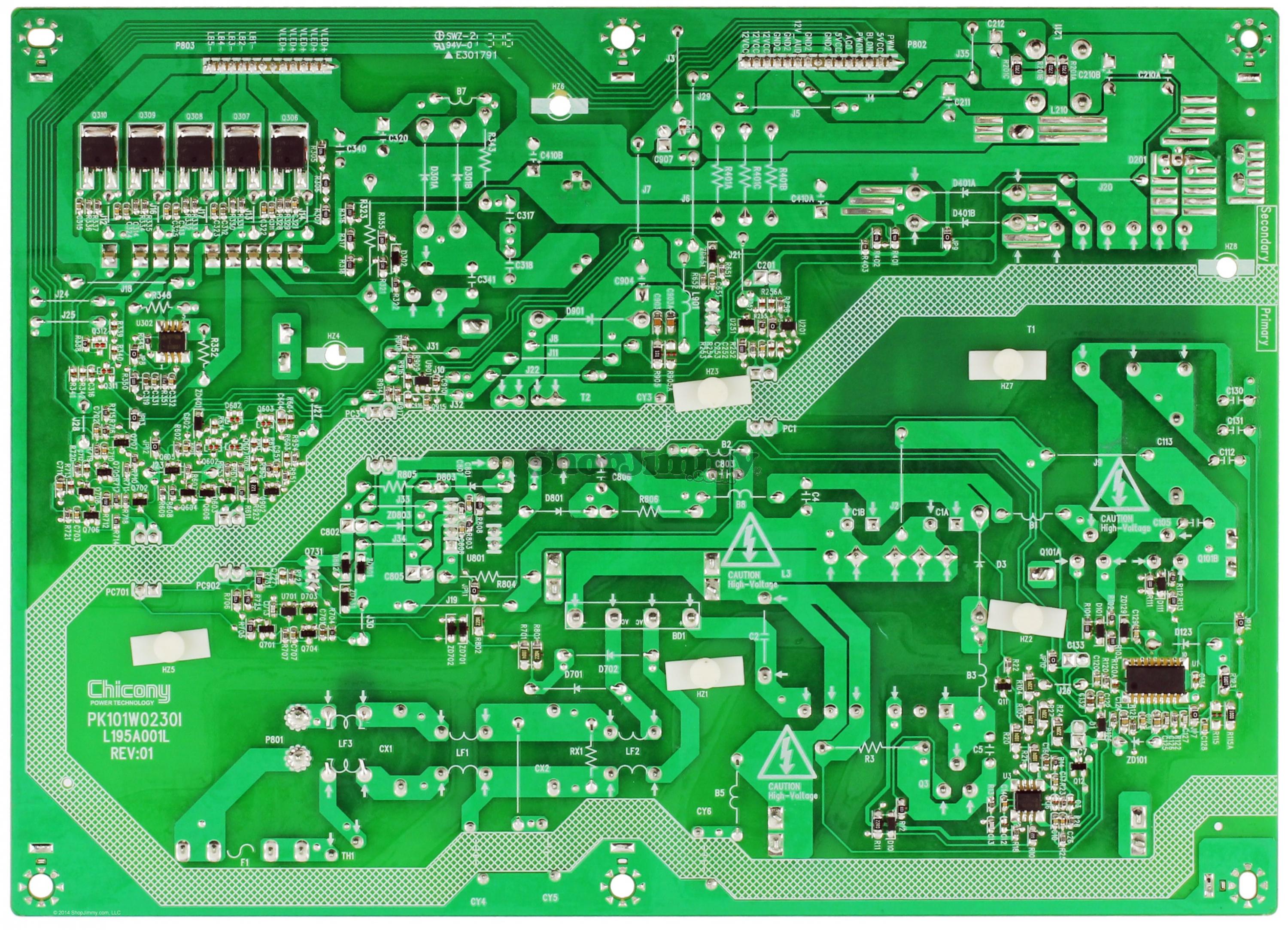

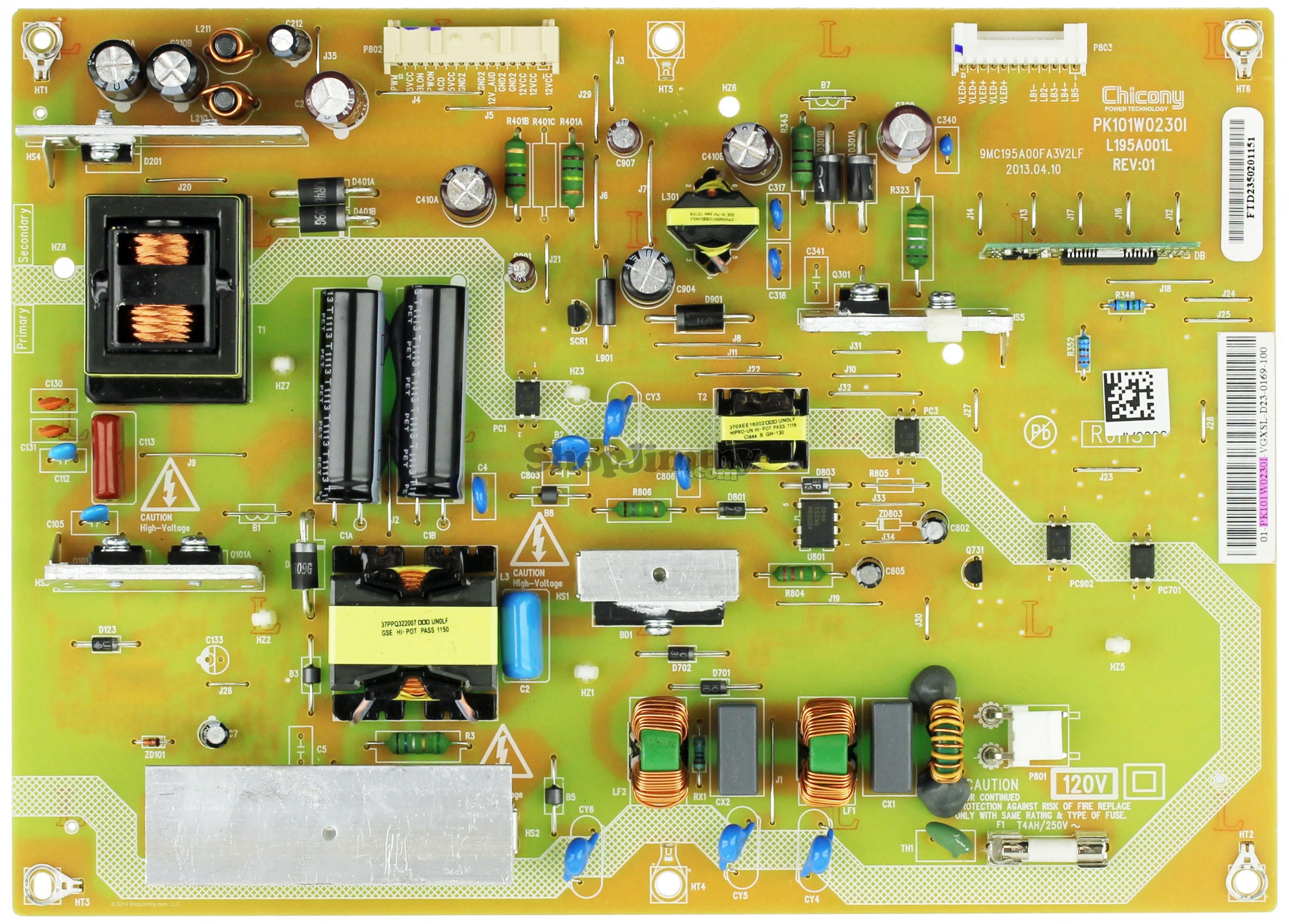

    I have included photos of the power supply. If there is anything you want to see a closeup of let me know. I have also included a video. I don't do videos very well so dont judge me lol.

    Can you measure the voltage on each pin of P803 at switch on.

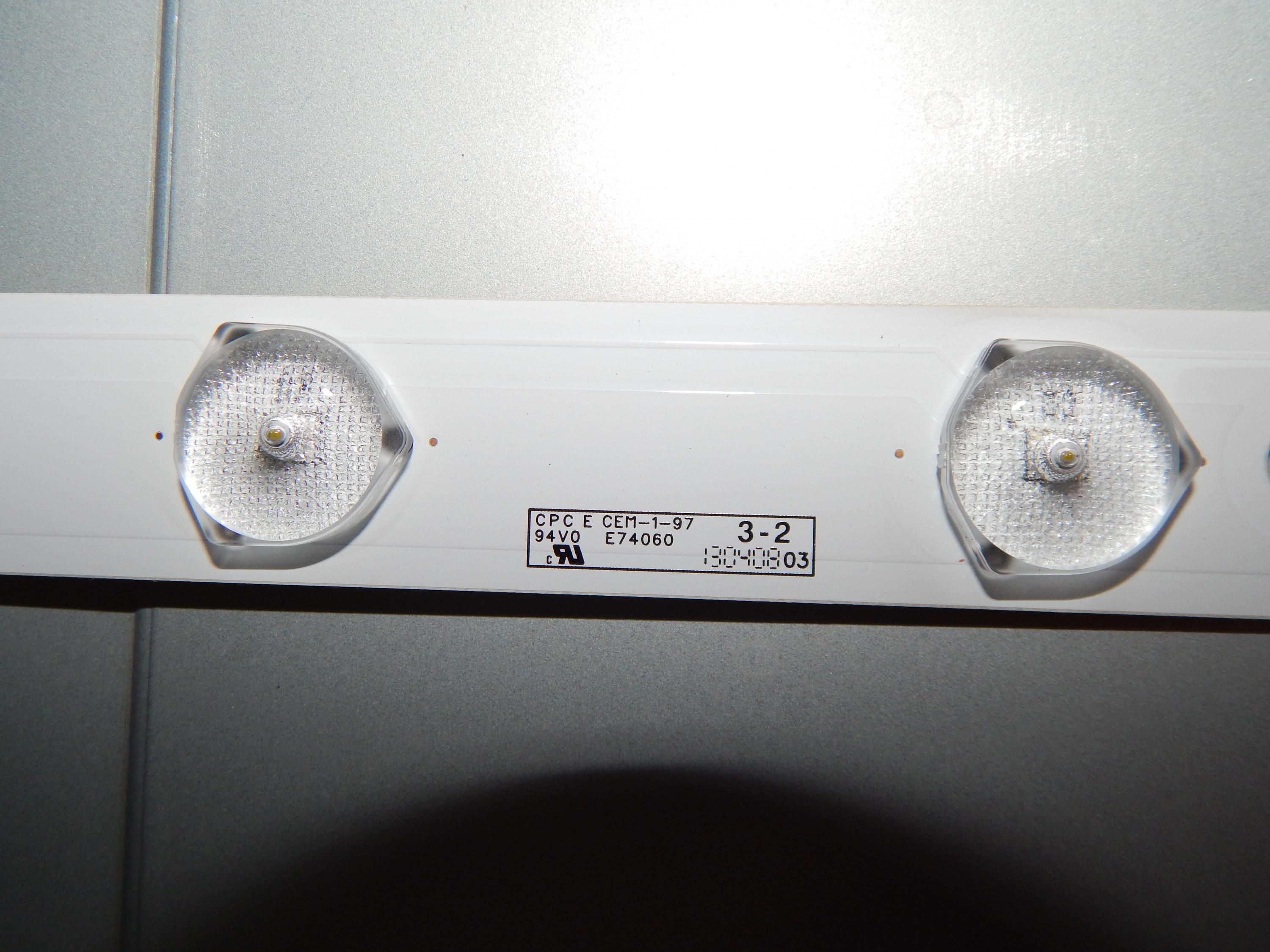

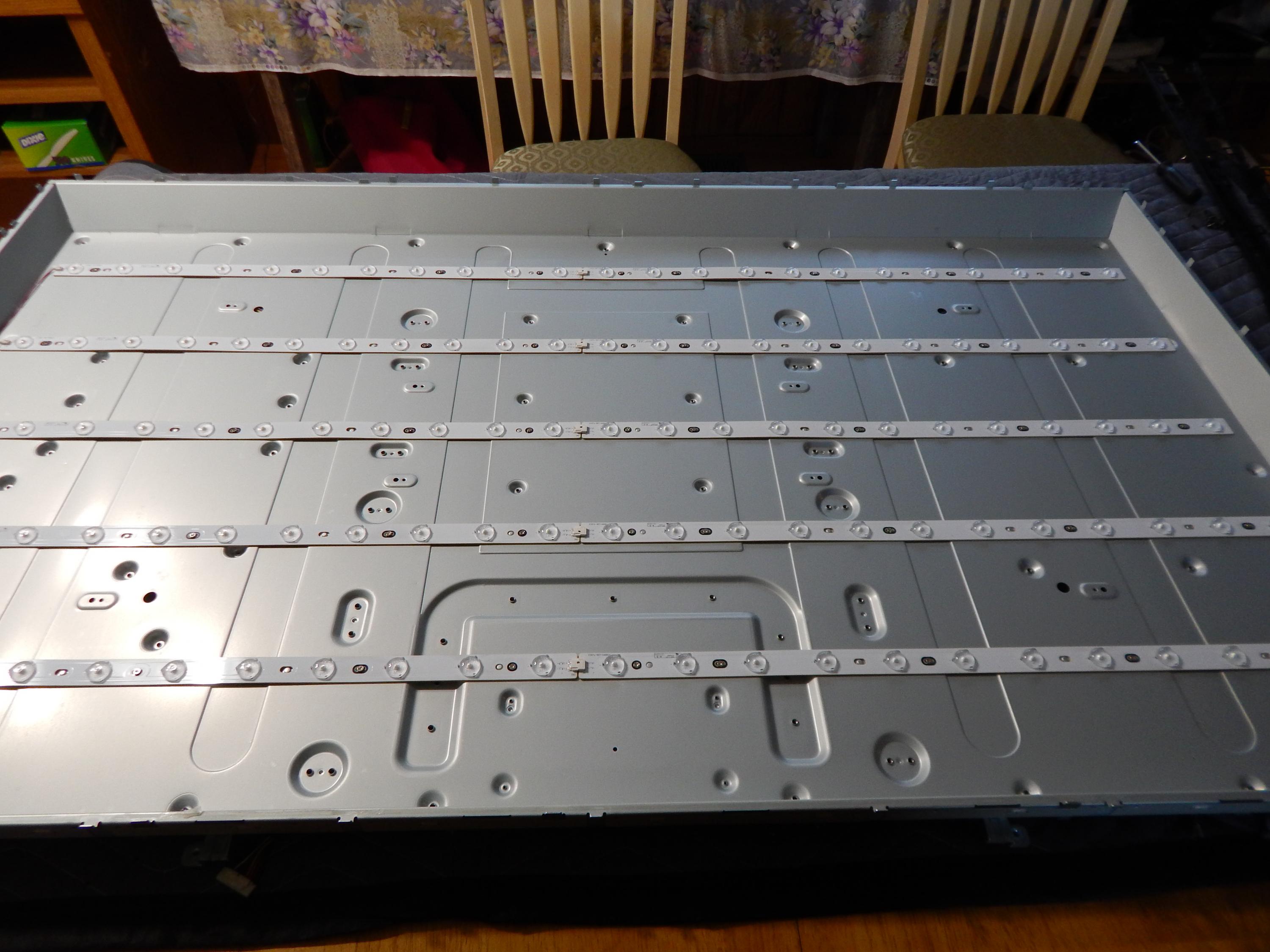

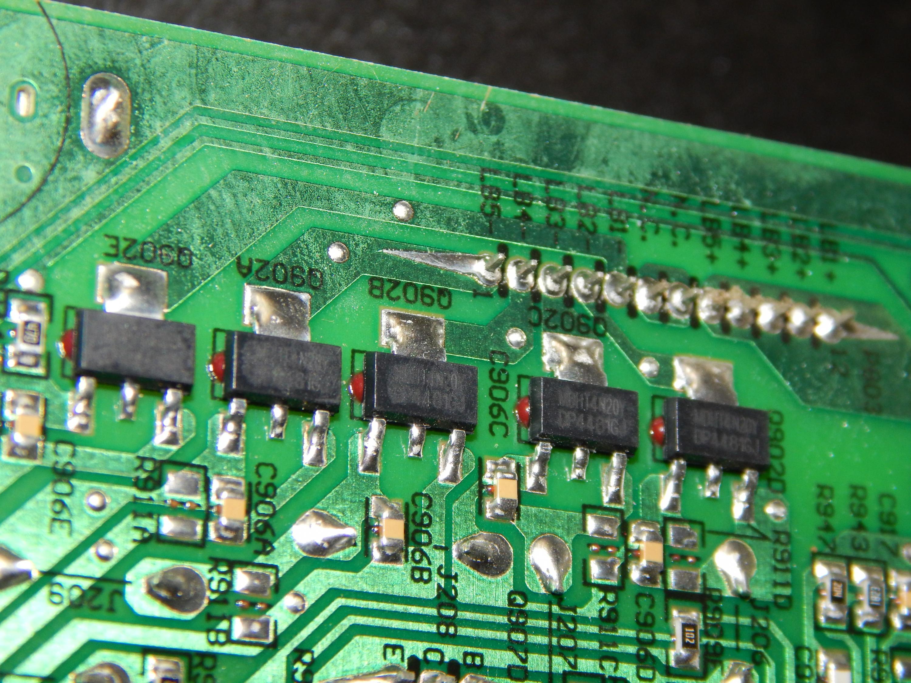

        It looks like you have no return on led string LB3. Using your meter set to diode mode compare Q308 to the others alongside it. However it is possible that you have an open circuit led in string LB3

          Forgive me on this. Im assuming you want me to put it in continuity mode correct but where is Q308

            Looks like open circuit in the LED #3, LB3- is the Cathode return pin of the LB3 LED string.

              I posted pictures of front and back of the power supply board. It's located on the back of the board. Set the meter to diode test with set off and compare to the other mosfets alongside.

                I see why I was confused now. My board it is labeled differently. But I checked the post from long leg to long leg and each one would start at around 1730 and jump to 1940 before cutting out to 1. All had the same readings.

                    Ok swapped pins on wireharness from LB3 to LB2 and vis versa. LB2 now reads 0 and LB3 reads 14.6.
                      Re: Toshiba 58L4300U no leds
                      Bad L3 LED string.
                        As Budm says, you have a bad led string L3.

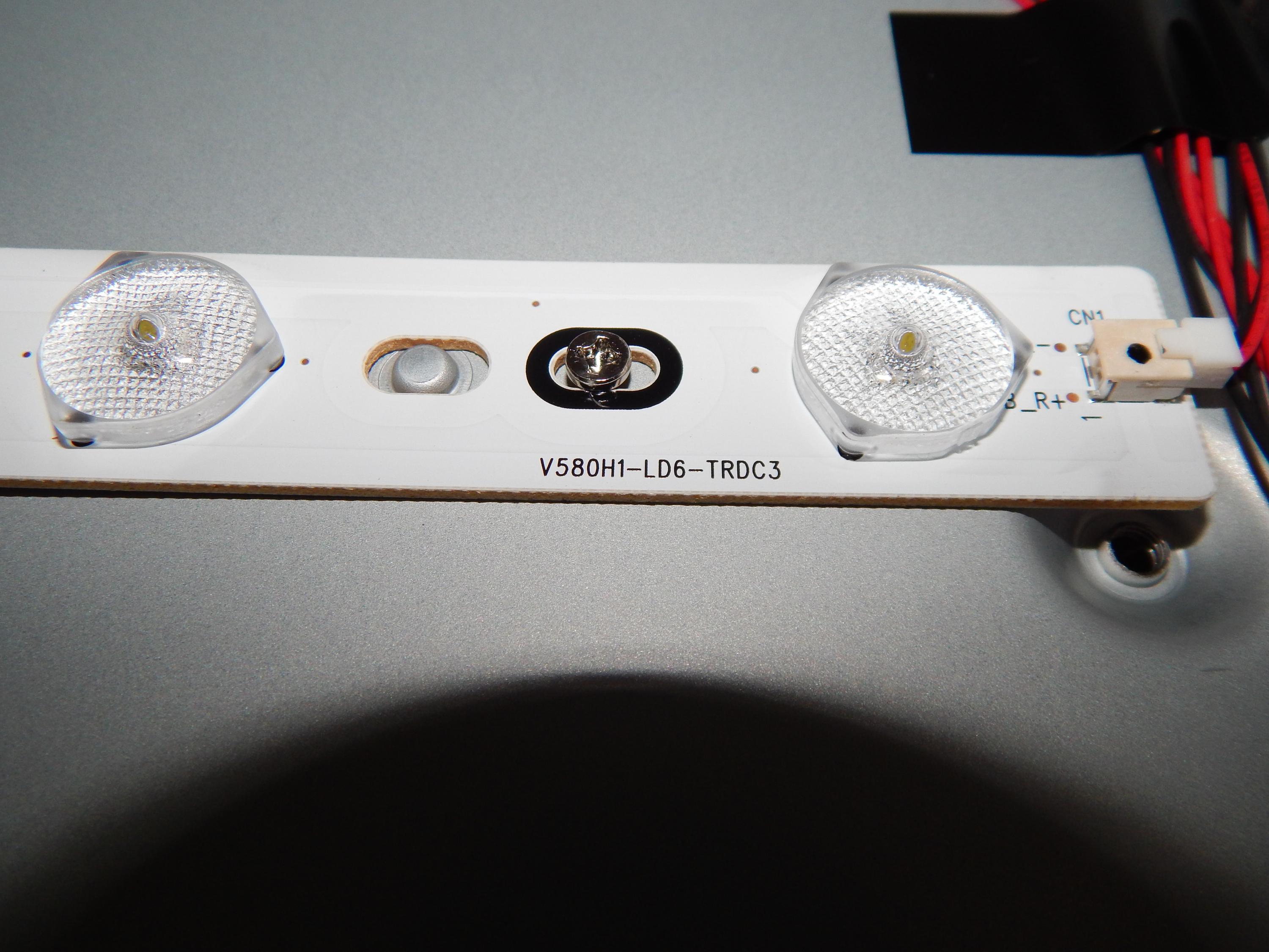

                          I pulled the wire from the plug and did a continuity test and it is in fact going to the center led strand. Did that just incase they didnt put them in order. lol

                              You may find some bad LEDs but you should also inspect the SMD connectors really really well, you may want to re-solder them all or use jumper wires. Those connectors are not well designed and mouted without much mechanical supports.

                                      I did a continuity test from the wire in the hardness to the test port on the led strip at the beginning of the middle strand. Its the only test port on any of the strands that would come back as the same.
