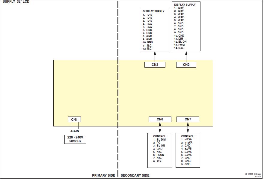

        Can you post pictures of the boards and give the various voltages that are labelled alongside any connectors that you have measured. What's the power supply part number?

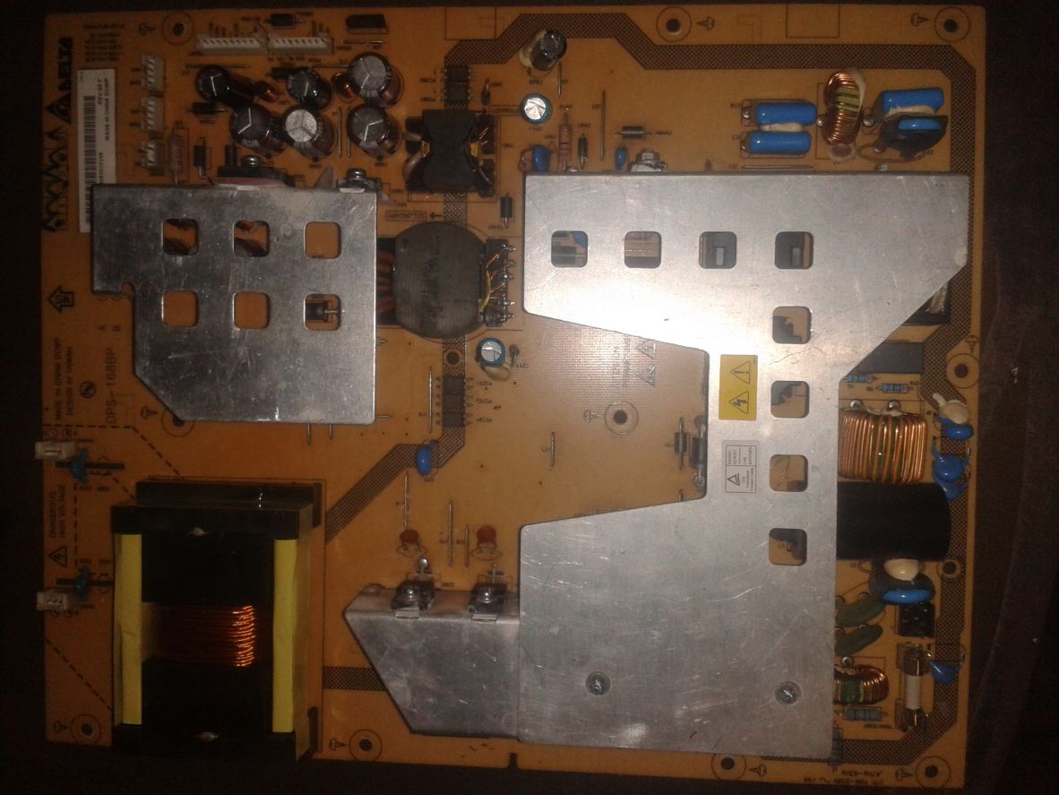

          its a delta DPS-168BP power board
          back light inverter is on power board

            Connect CN6 Pin3 (BL_ON) to CN7 Pin 4,5 or 6 (5VS) and also CN6 Pin 6 (PSON) to CN7 Pin 4,5, or 6 using 1K resistor for each.

              p.s this board doesnt have cn2 and cn3 shown in you picture .

                This may be your power supply. Two sheets shown on the thread.
                Hopefully this matches your power supply. So again jumper standby to BL_ON and standby to PSON

                  looks a bit different .this one is dps-168bp ..then b for 37 inch .
                  will try taking a pic but i really need sunlight

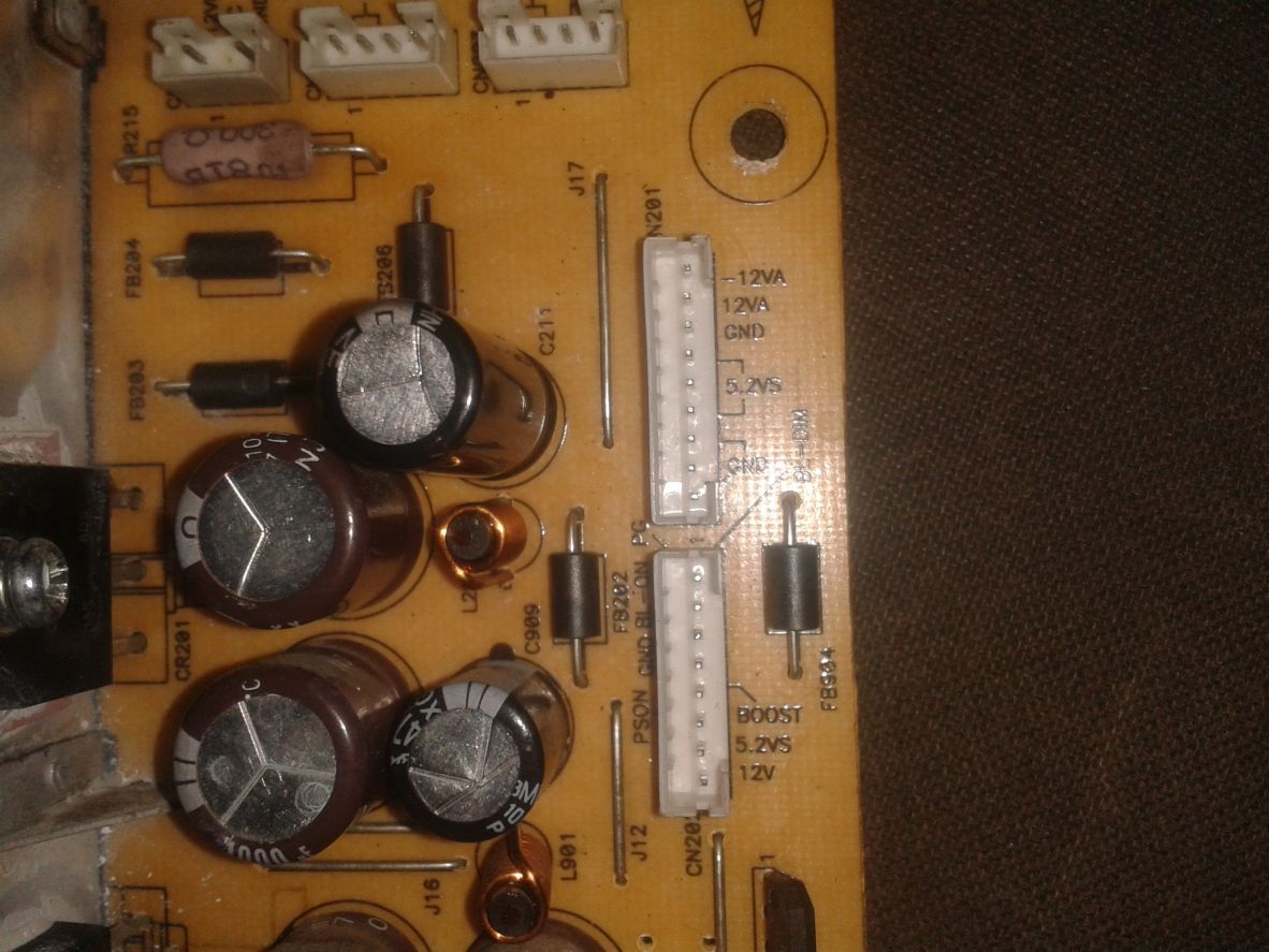

                    • petehall347
                      • Jan 2015
                      • 4448
                      • United Kingdom
                      Re: 37PFL5522D/05 philips 2 red flashes code
                      pics attached i hope
