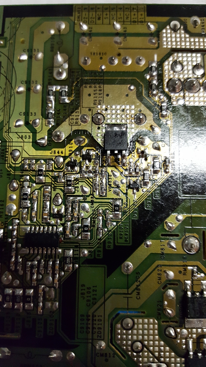

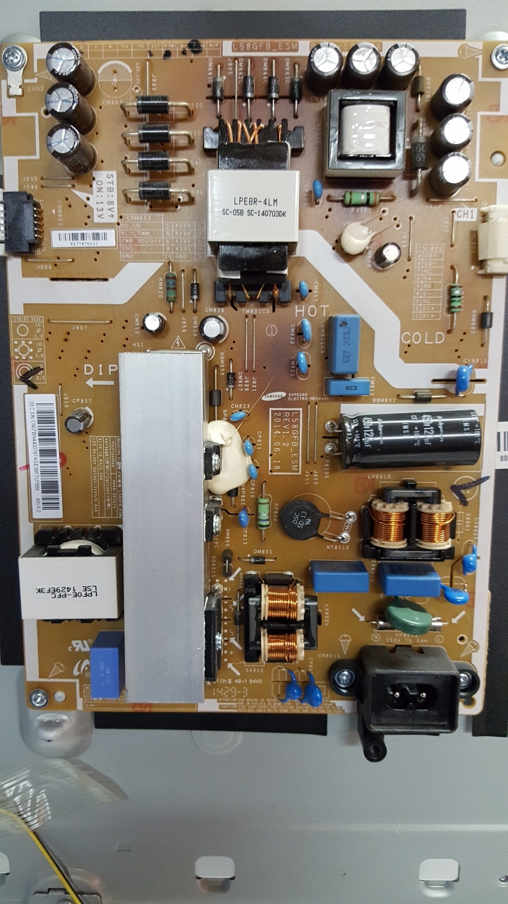

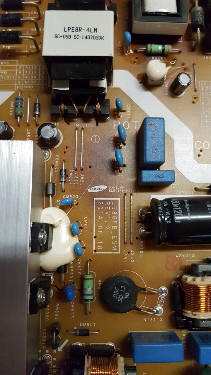

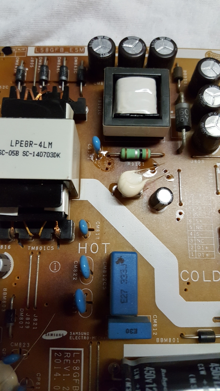

    OK I read the other posts and found same burned board and Q9101 shorted as budm
    So I replaced the Q9101 (ordered from mouser) anyway it worked great for 3 hours and blacked out so i pulled the board and same mosfet Q9101 is shorted again.. there are 3 very brown spots on this board over the two in the middle QM801cs and qm802cs also brown at the 4 diodes at very top of cold section DM841-844 C they seem to be getting hot also... i bought 5 mosfets but don't want to waste another without trying to isolate the cause.. a long shot could be a defective new part but i doubt that seeing the heat marks...
    What would cause that mosfet to fail??
    After checking all the diodes and other components on the board and they seem good.. so i put another new Mosfet on it Q9101.. this time i added some of the silicone heat sink to help cool the hot devices. I haven't run the set yet, but overnight two more things occurred to me..
    1. could the capacitors cause this? they seem good but i did not pull them out of circuit.
    2. Could the LED backlight brightness be too high causing this?
    Perhaps experience could enlighten me.... Thanks

        First thanks to both of you guys for helping.
        What i did was pulled all the diodes and tested. tested caps.. they are ok also.
        I put it all back and put the new mosfet on. Then went with the silicone solution to cool the 3 mosfet that are getting hot under the board. I also tested the backlights with the cheap little tester (did not pull the panels) the top pair pulled 98.6 from the tester.. the bottom pair pulled 68.7v.
        I re-connected and powered on and the LED rail voltage (read from chassis to the top diode and the horizontal jumper near the jack) was 233.6v
        The actual readings on the led connector were 101.4 at top pair and 86.9 at bottom pair.
        I went into the menu and cut the LED level from 90% down to 50% it is still plenty bright, I think that was partially the problem. I could not find the service manual for this one and i am not paying $14.99 for it so I don't really have the optimum settings/voltages beyond the board markings. It has run 5 hours yesterday evening and about an hour so far today.. I will run it all day and test the temperatures with laser thermometer to see how it holds.
        So far so good. Cooling may be the answer and undoubtedly the leds are getting older and drawing more current than when new. I think it was designed to fail in a calculable amount of time by Samsung design.
