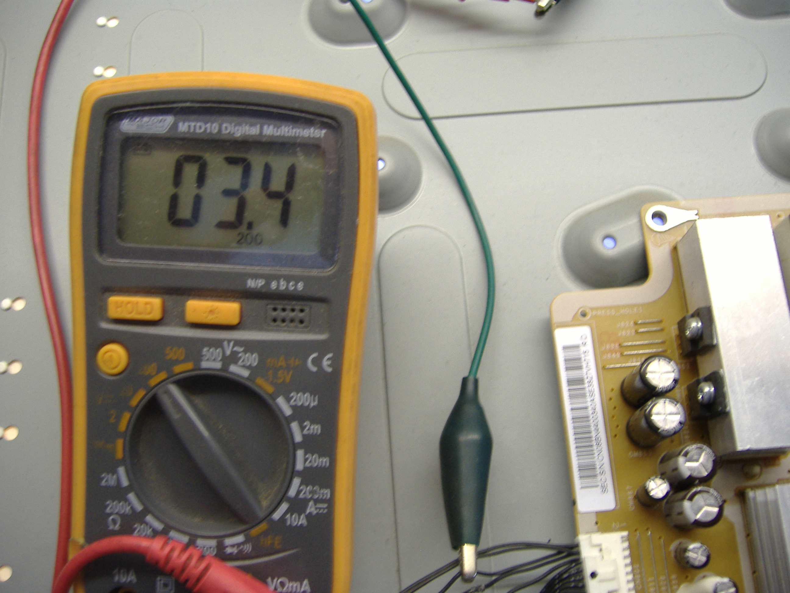

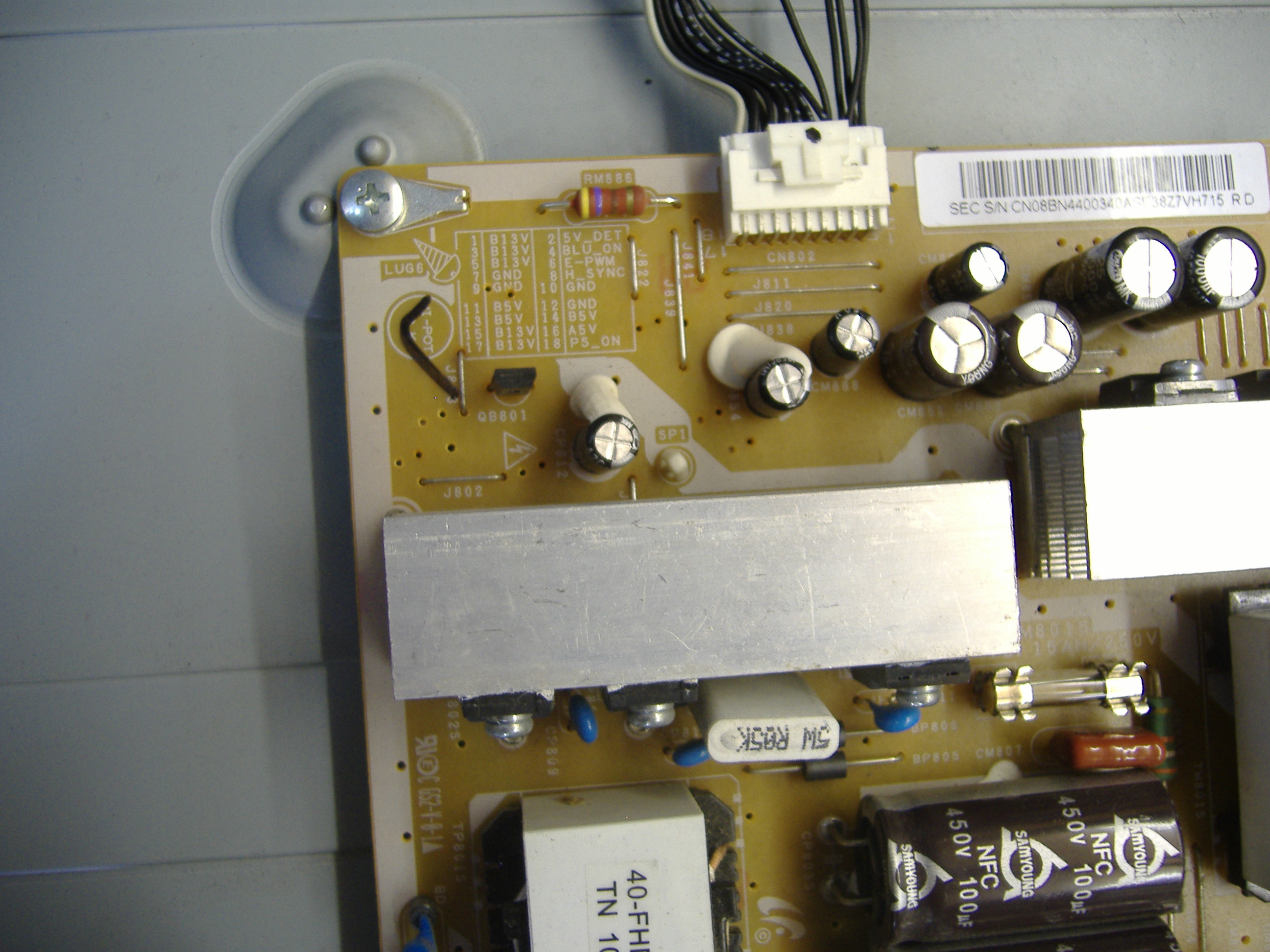

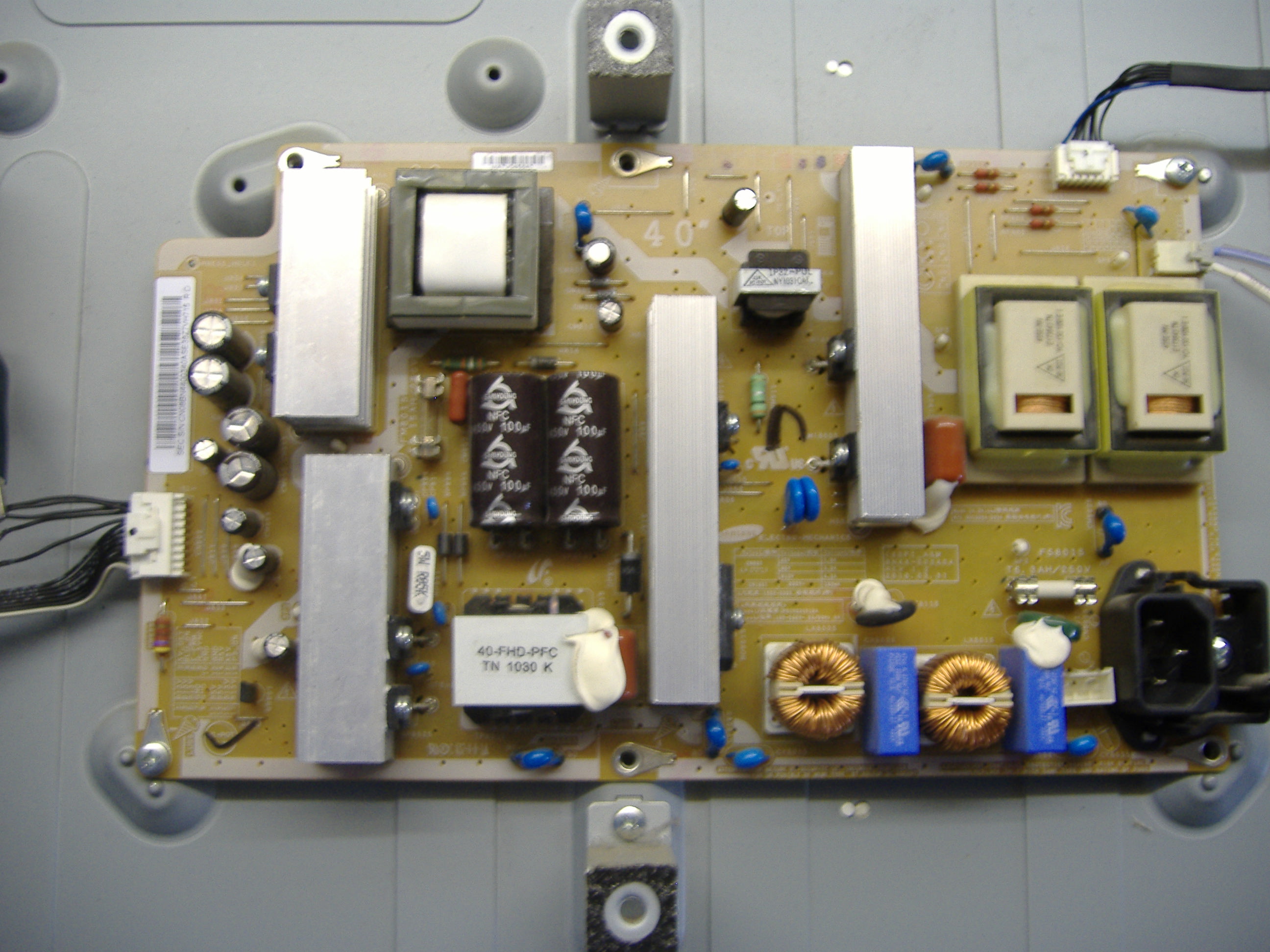

    Hi guys,
    This Samsung looses its back lights about a minute after switch on.
    Voltages back lights on. (CN802 psu to main cpu photo3)
    1. B13V 12.2V
    2. 5V_DET 3.4V
    3. B13V 12.2V
    4. BLU_ON 5.2V
    5. B13V 12.2V
    6. E-PWM 3.8V
    7. GND 0.0V
    8. H_SYNC 1.8V
    9. GND 0.0V
    10. GND 0.0V
    11. B5V 5.2V
    12. GND 0.0V
    13. B5V 5.2V
    14. B5V 5.2V
    15. B13V 12.2V
    16. A5V 5.2V
    17. B13V 12.2V
    18. PS_ON 0.7V

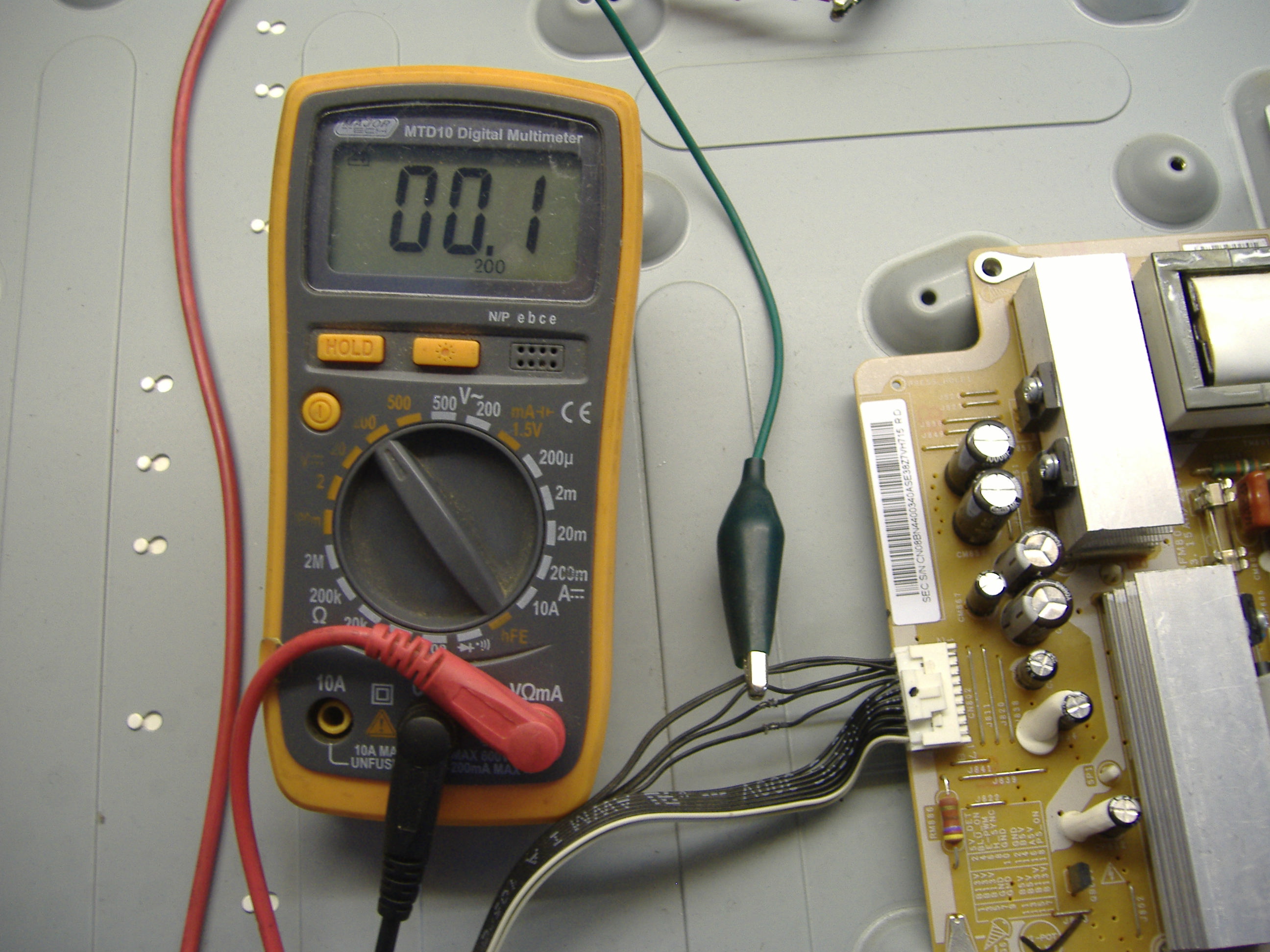

    Voltages Back light gone off
    2. 5v_det 0.1v is the only voltage that changes (photos 1 & 2)
    all other voltages remain the same.

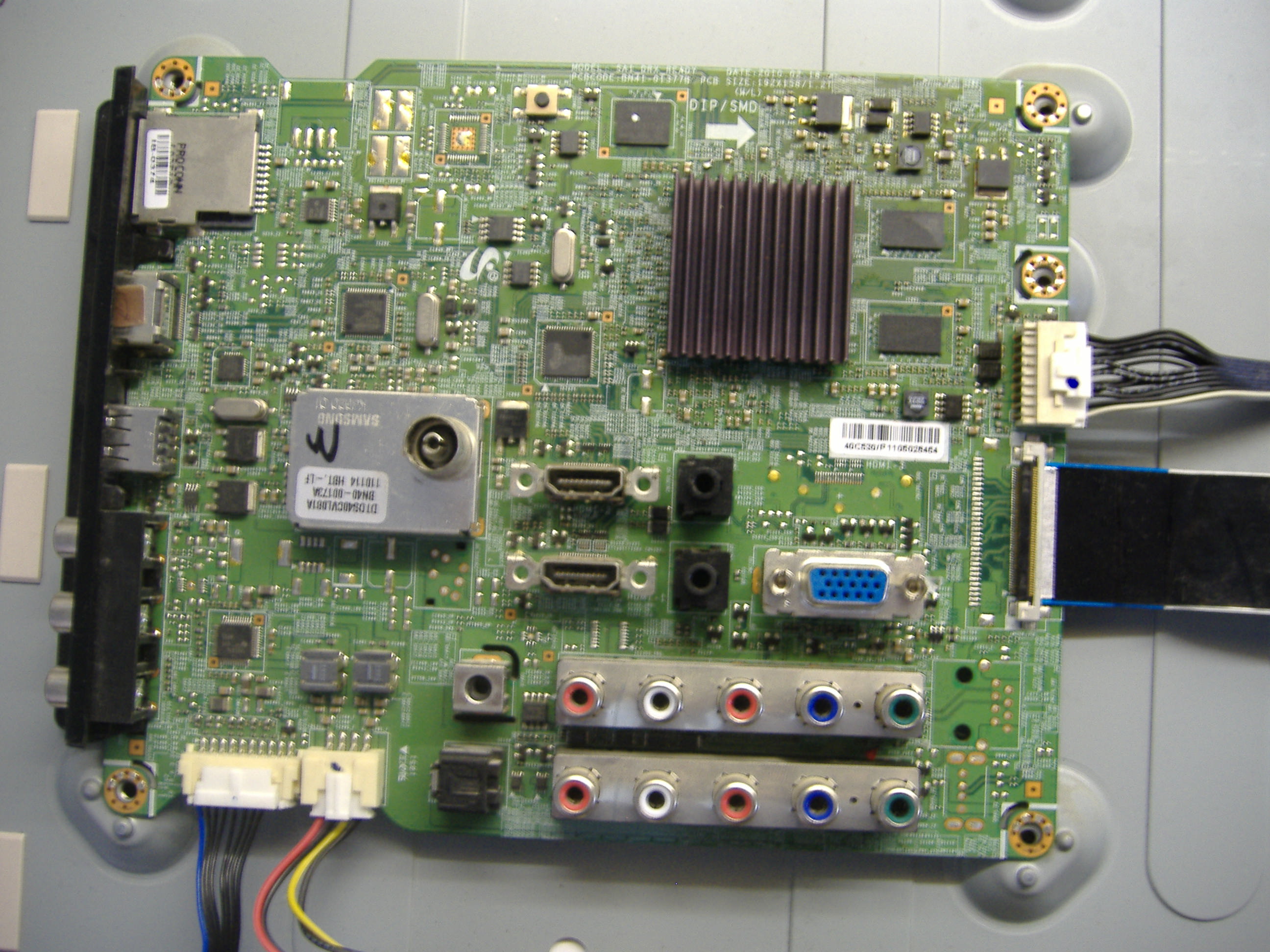

    If I unplug cn802 to cpu pcb the 5V_DET voltage rises to 5 volt on the power supply side, and the backlights come on.
    Guessing the inverter needs this 5V_DET voltage to be 3.4v or more for the backlights/ inverter to power up?
    I have tried another PSU & Main CPU pcb with the identical results.
    This confuses me,.... where does the CPU pcb get the info from to switch the 5V_DET from 3.4v down to 0.1V?
    Both CPU pcb's have the same fault? or a faulty lamp triggering the 5V_DET?
    If someone could please help
    Re: Samsung LA40C530F1R Backlight goes off/ 5v detect drops
    I cannot clearly read the power supply/inverter board P/N, BN44-003??
    Pictures are very poor.

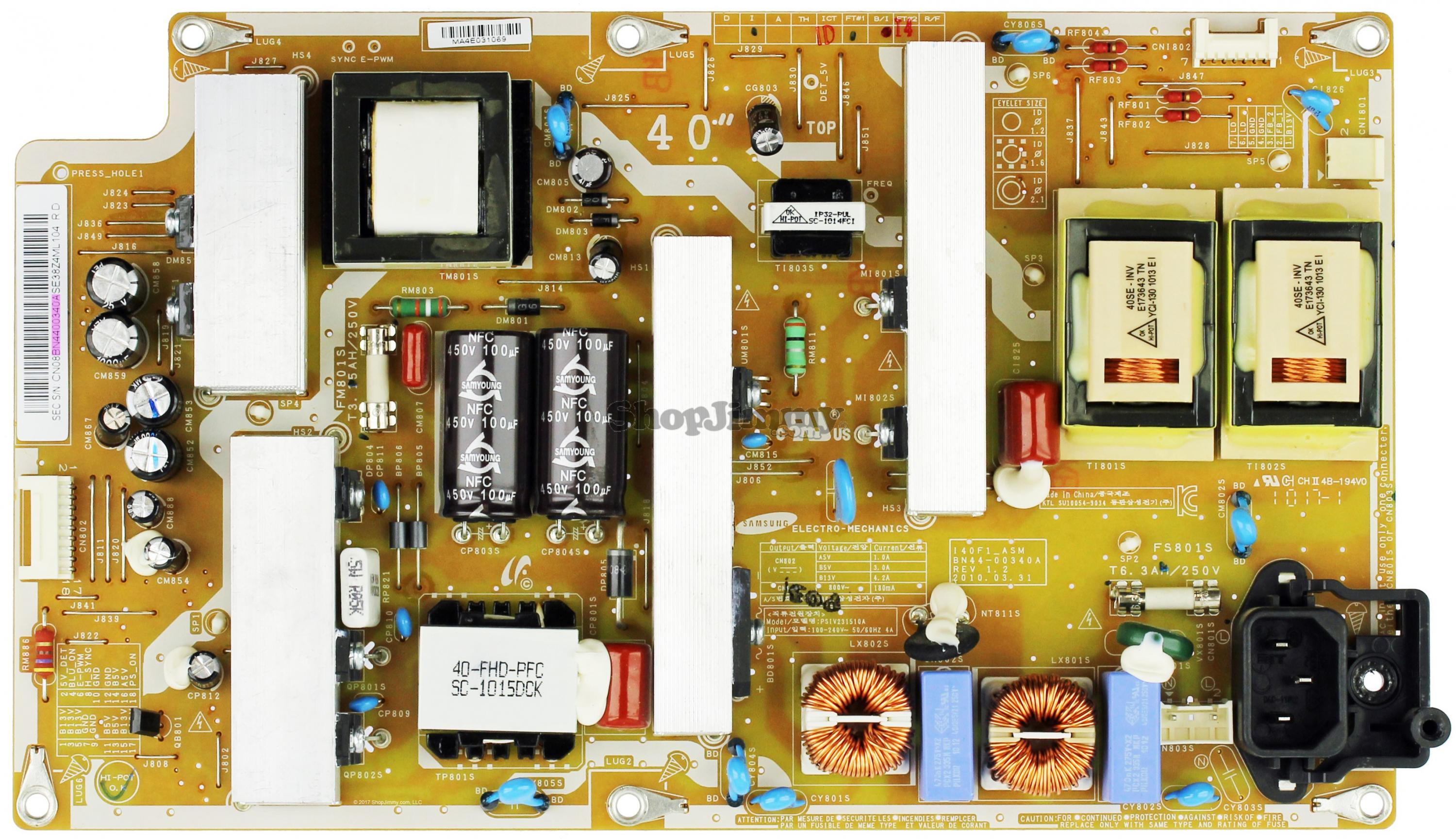

      Is this it? Shopjimmy has a repair kit for $22.

        Hi Budm, sorry for the poor pictures,will try in future for better pics. The psu/inverter pcb is BN44-00340. Thanks for the the links & photos. I now have tested three main cpu pcb's & two psu pcbs giving the same fault symptom.
        I have repaired a few of these pcbs in the past (common is c1831/ spike suppressor going short blowing fuse & the two fets m1802/1 driving eht tx's going short circuit)
        The date stamp on the tv says 2010, so I guess after seven years the lamps will be pretty worn. I guess I have to open the panel/ lamp house and see if I can identify the faulty lamp/s

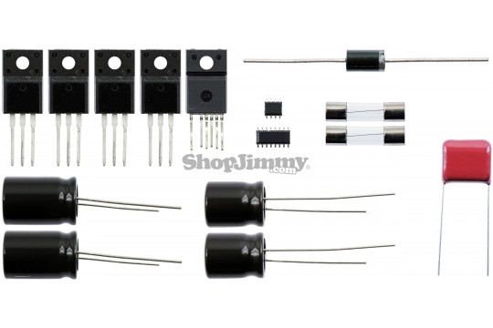

          Hi tvtimmy, thanks, nice clear picture of the psu pcb. I wonder what the kit includes? is the kit for the specific problem that I have? As I said to Budm in the post above that it starts looking like lamp failure. will open panel and let you guys know what I find.

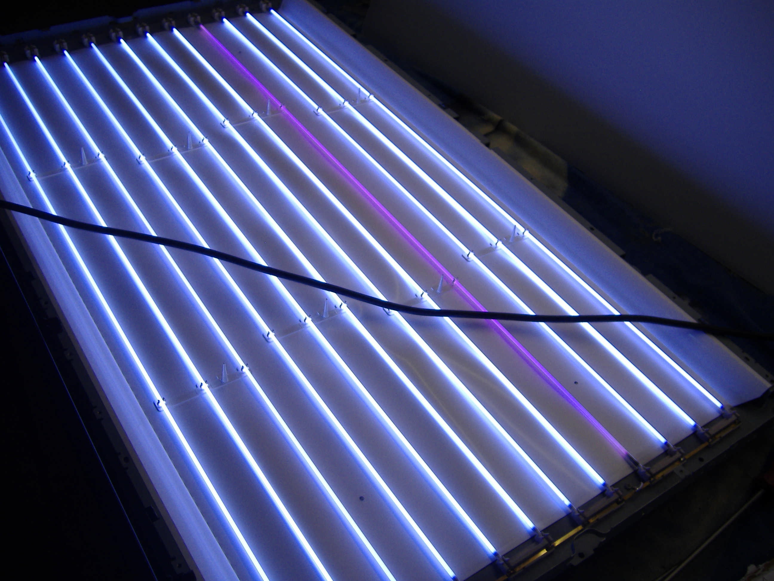

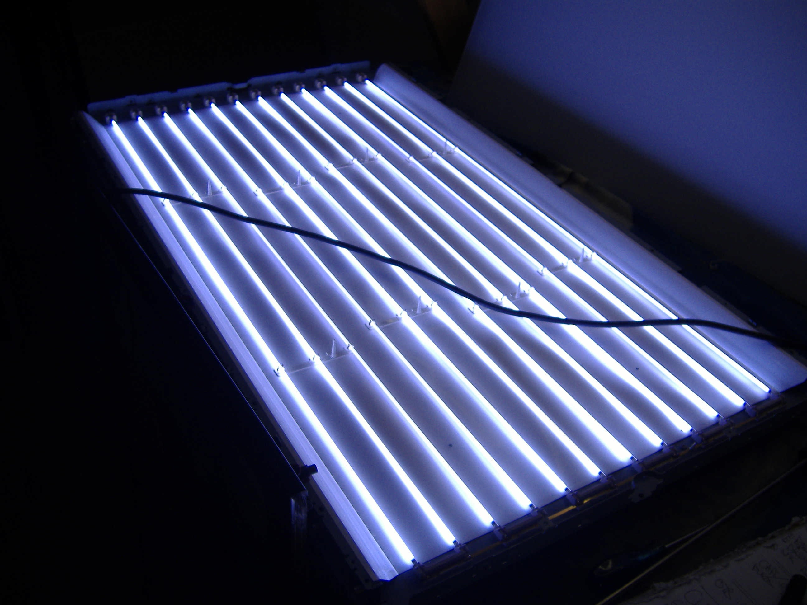

            certainly worth stripping the tv down and inspecting the ccfl s first before wasting money on a repair kit, ive had a couple of old ccfl sets recently with bad tubes but usually show the 2 second to black fault, a minute running seem a odd amount of time but if you can power up the set without the lcd attached and watch the tubes you may see one failing etc causing your fault.
              The kit doesnt say where the parts go, unless you buy it.
                Hi Vince, thanks, quite right, one of the lamps turned out to be faulty. The other lamps also look blackened at the tips. Can the lamps be bought loose? I took one out of a scrapped panel and managed to get the lamps running. (photos)
                Thanks again input from Budm & tvtimmy as well
                              "When Main Board is disconnected from PS Board the backlights go on " That's good.
                              Check the resistance of that 5VDET pin on the main board side against GDN to see if it shows low resistance or not.
