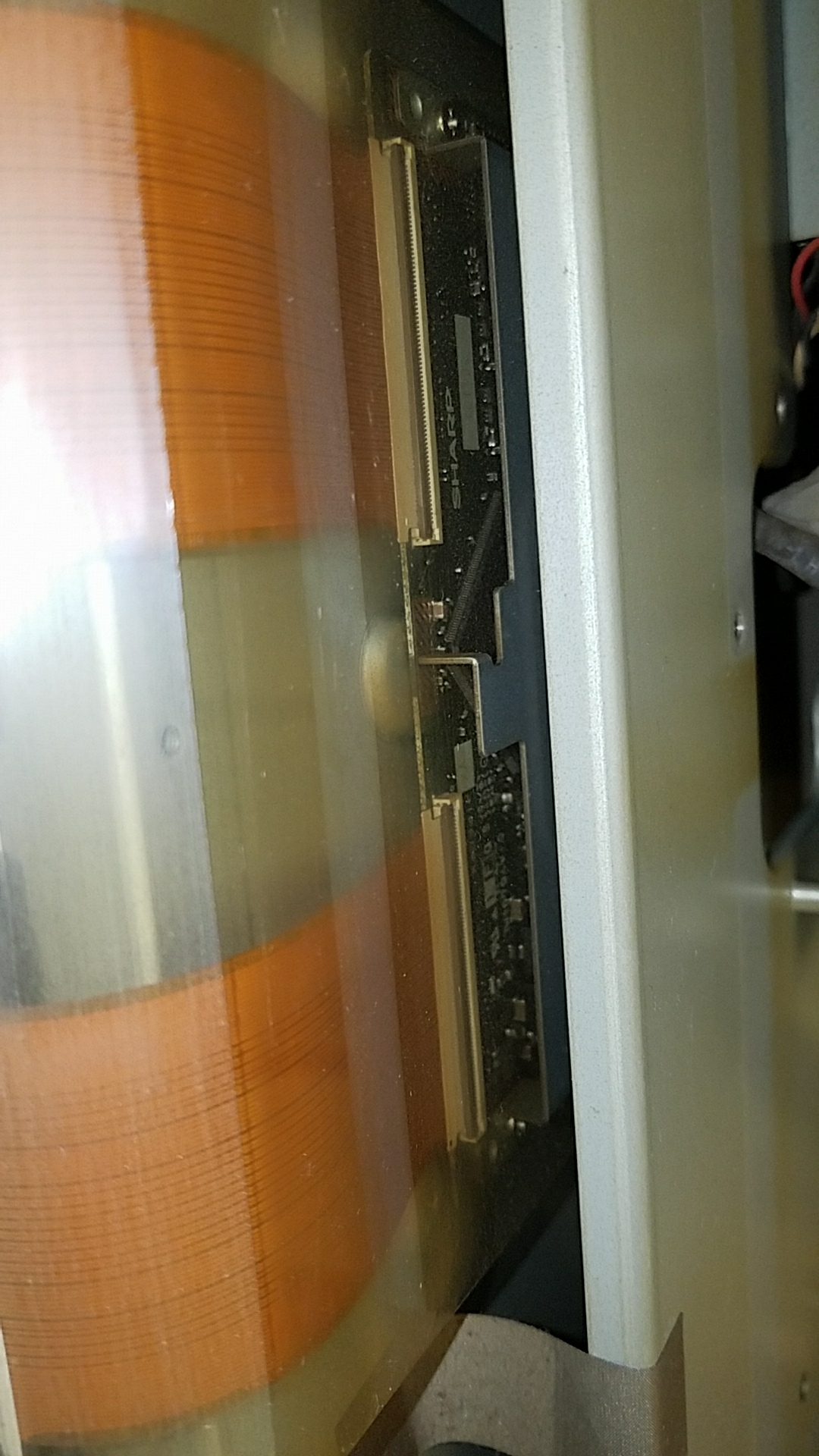

Olevia 237-T12 horisontal lines after 1 min
    Please check this video, the symptoms after 1 min

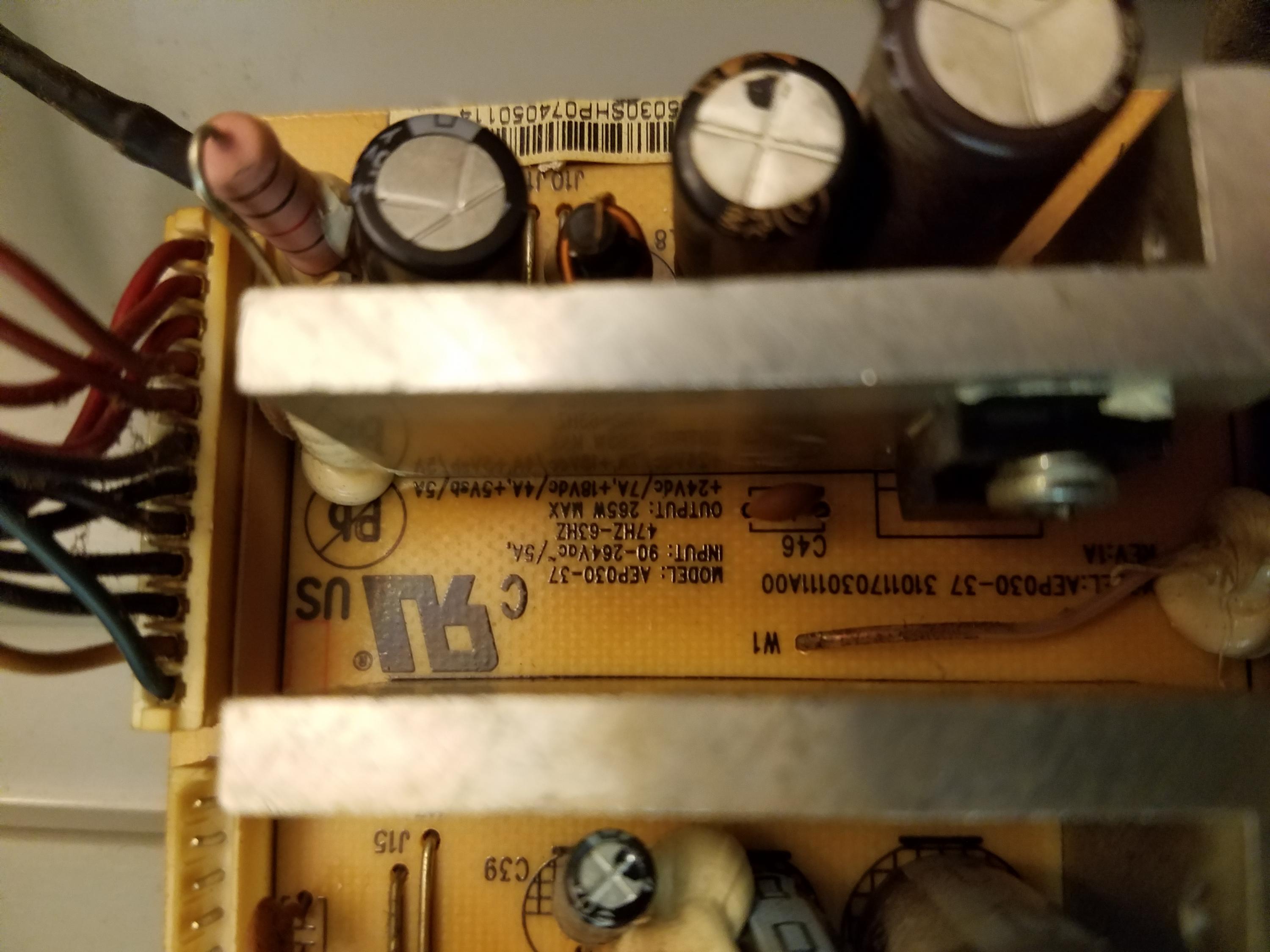

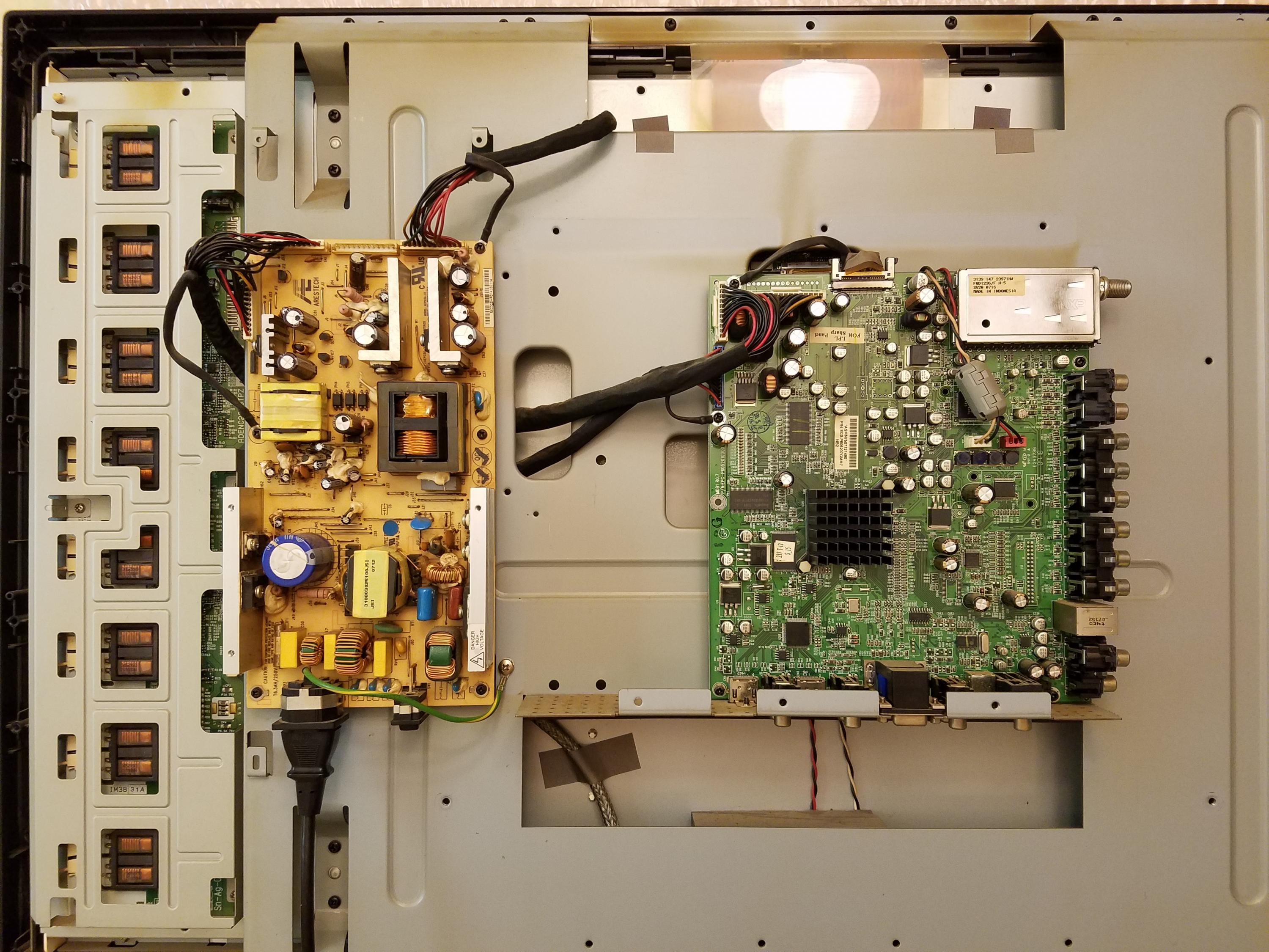

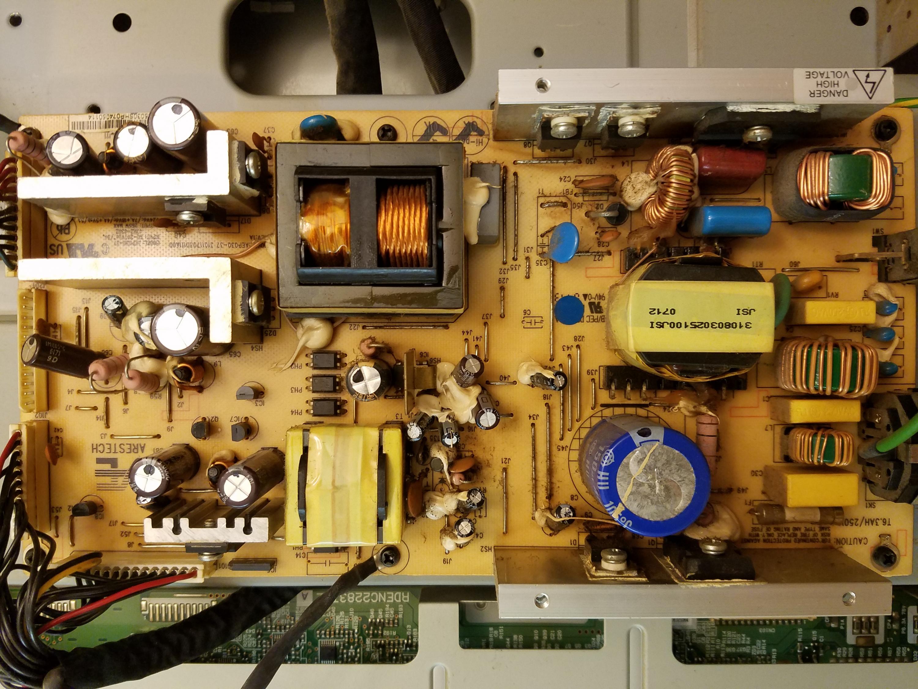

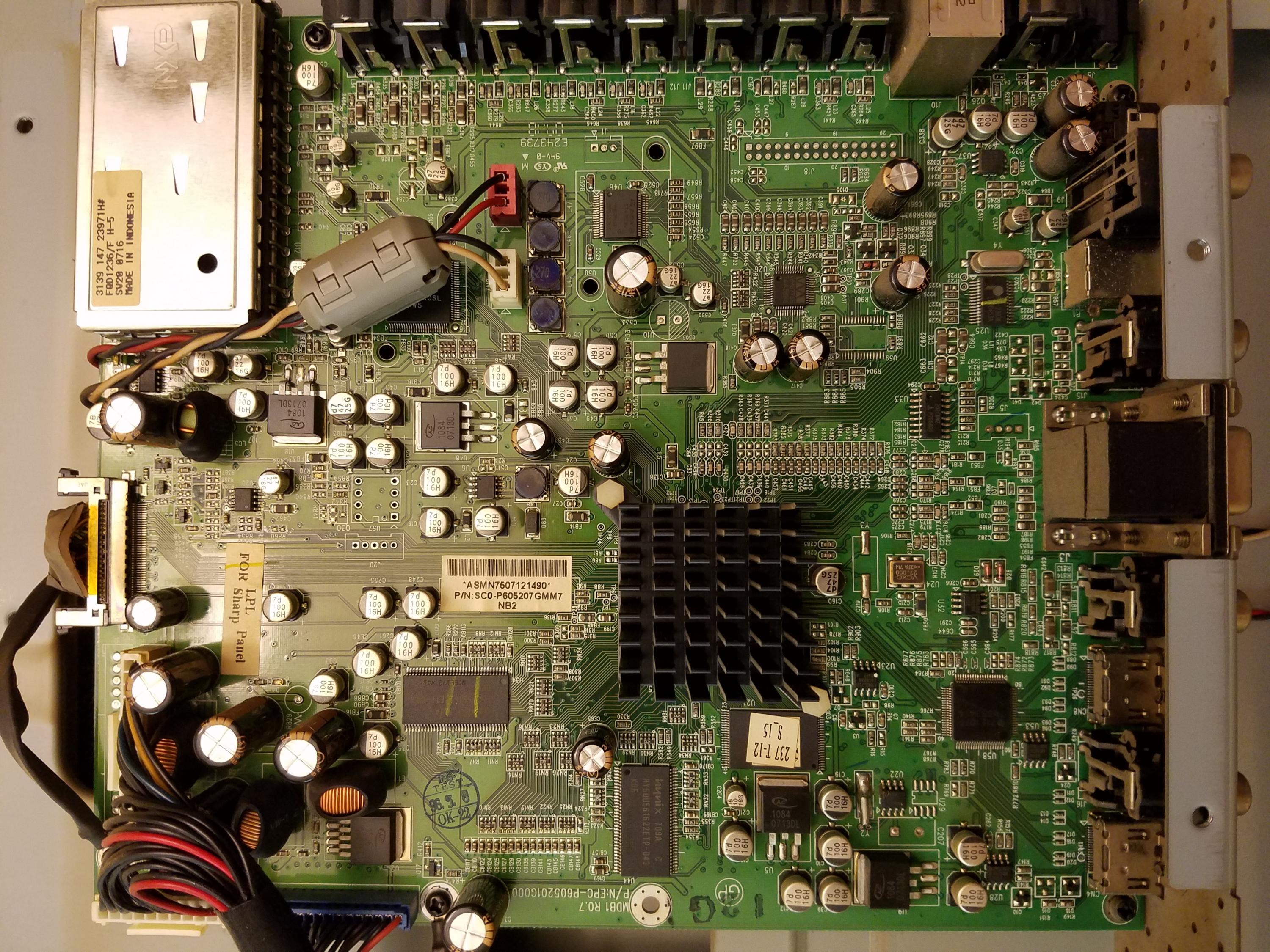

      Looks like Backlights to me.....However,.....Remove the back...Upload pics of the boards and their lay-out...Measure and post voltages on PSU.
        Re: Olevia 237-T12 horisontal lines after 1 min
        Here are some photos.
        All voltages are about 4% higher than the specs printed on the PSU.
        5.2v
        18.7v
        25.0v
        I replaced one bulged capacitor on the +24 output rail but it did not help.

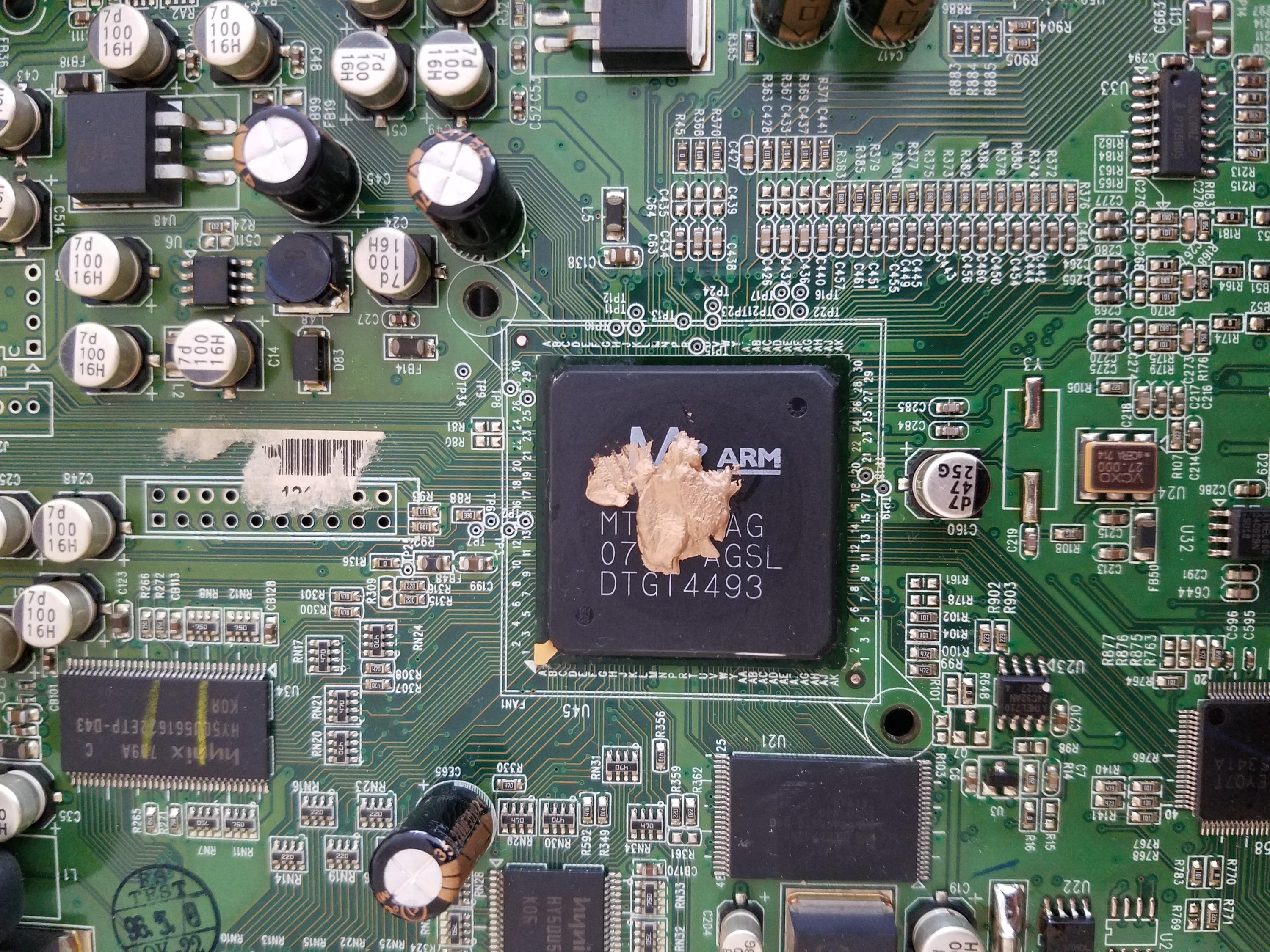

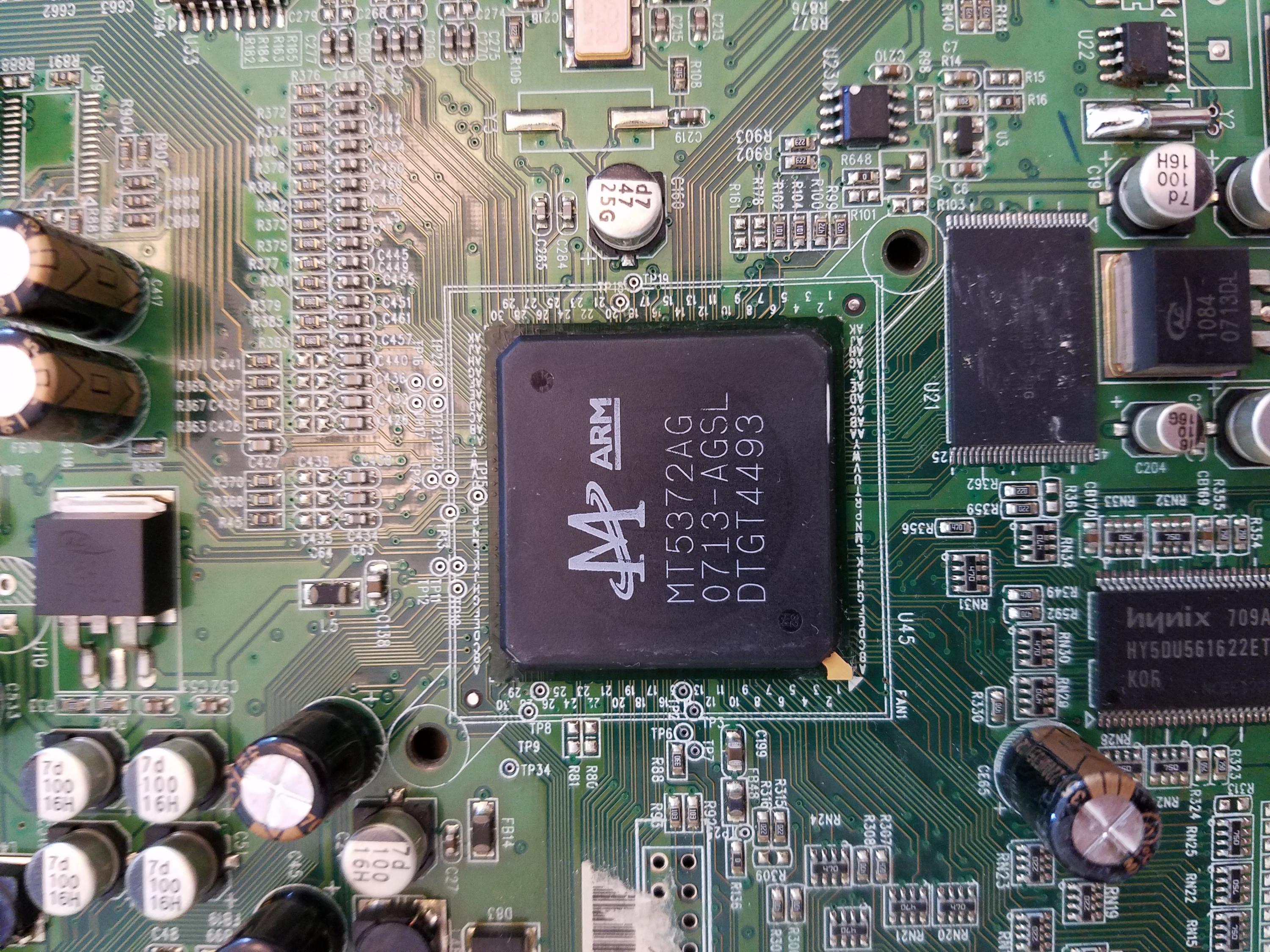

            OK I did a little bit of diagnostics.
            When I press on the BGA chip on the mainboard the screen distortion reduces.
            So I guess it is the main board.
            Is there any way to fix?
              You could try to heat the BGA ; see video
              https://www.youtube.com/watch?v=XOpi3FbeqpY

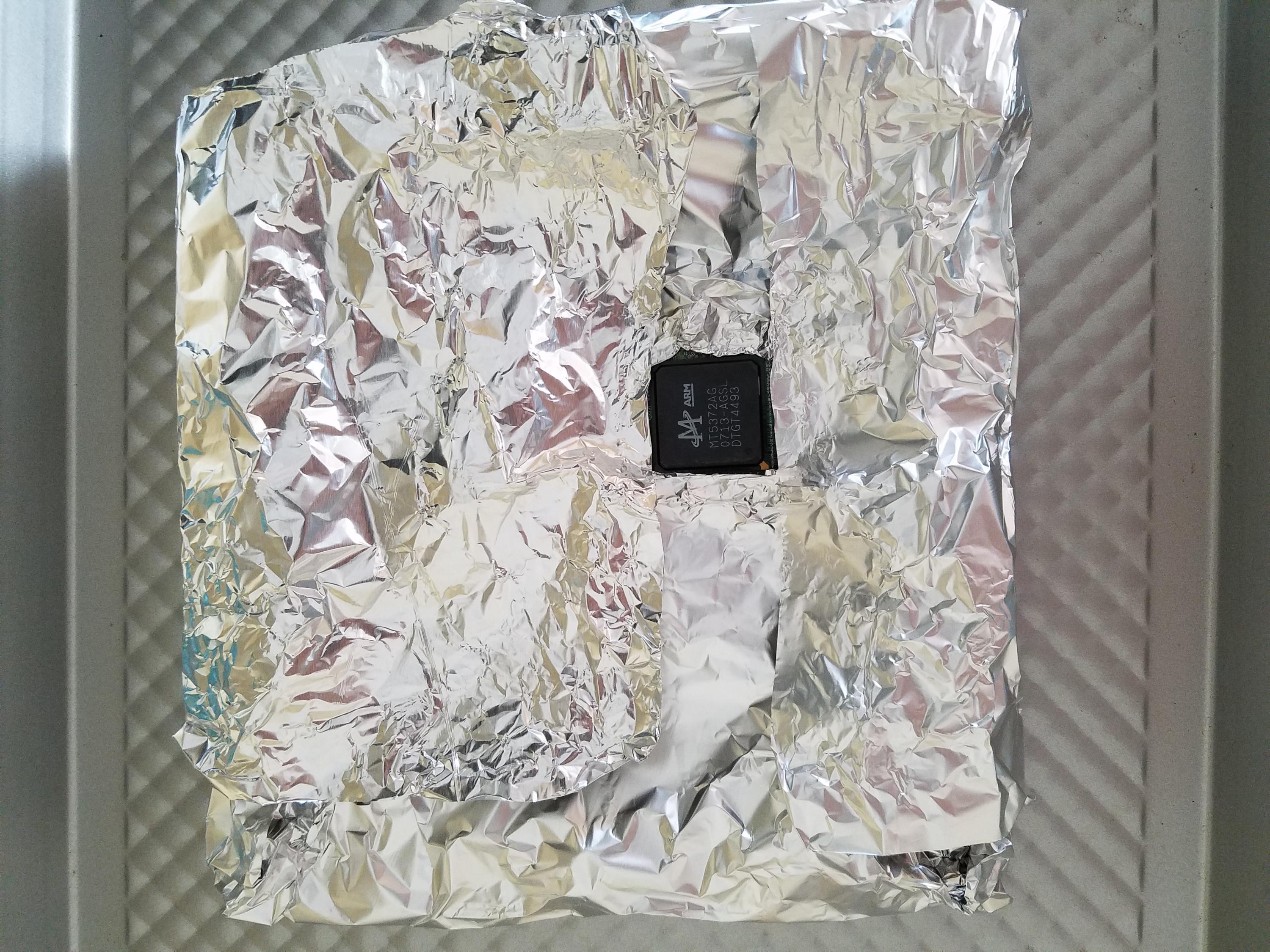

                Baked the board for 8min on 375F and it works now!
                here are some photos:
                  HDMI ports still get the lines and jumping, and it looks like Digital TV went out. I only get analog channels now.
                    after 3rd bake attempt I just bought the new main board for $10 off ebay
