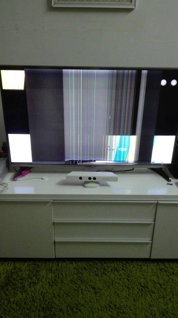

    My LG 42LB6500 TV is showing some wierd patterns on the screen. I've attached a picture of the screen below.
    Could it be a cracked screen or something else? Any help/pointers is truly appreciated.

    Clean and re-seat the T-CON Bd. cables to the Panel and from the Main Bd.

      It's either a cracked lcd panel or someone cleaned the screen with something and the liquid got onto the board that connects the panel to the t-con, Bet the t-con is at the bottom of the screen on this model

          Definitely a cracked screen, not worth fixing as replacement panel usually costs the same as a new TV if not more.
