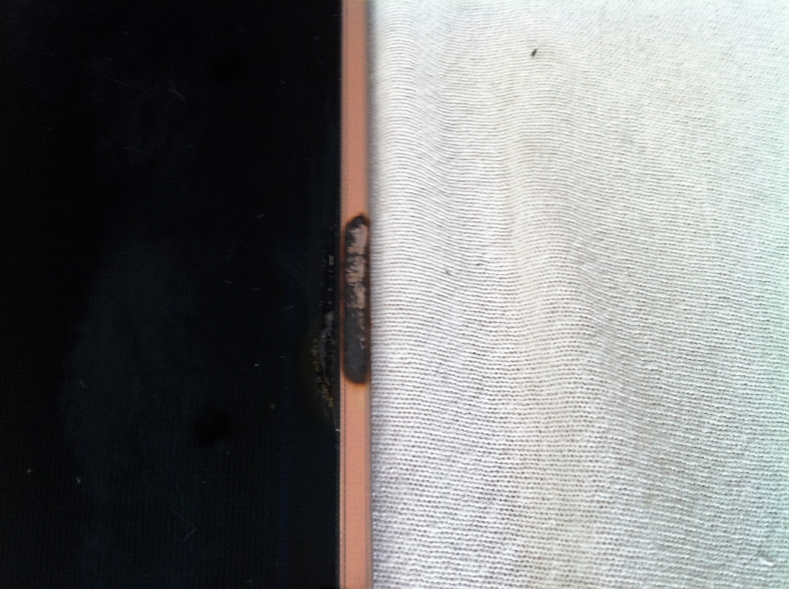

    Dear Forum,

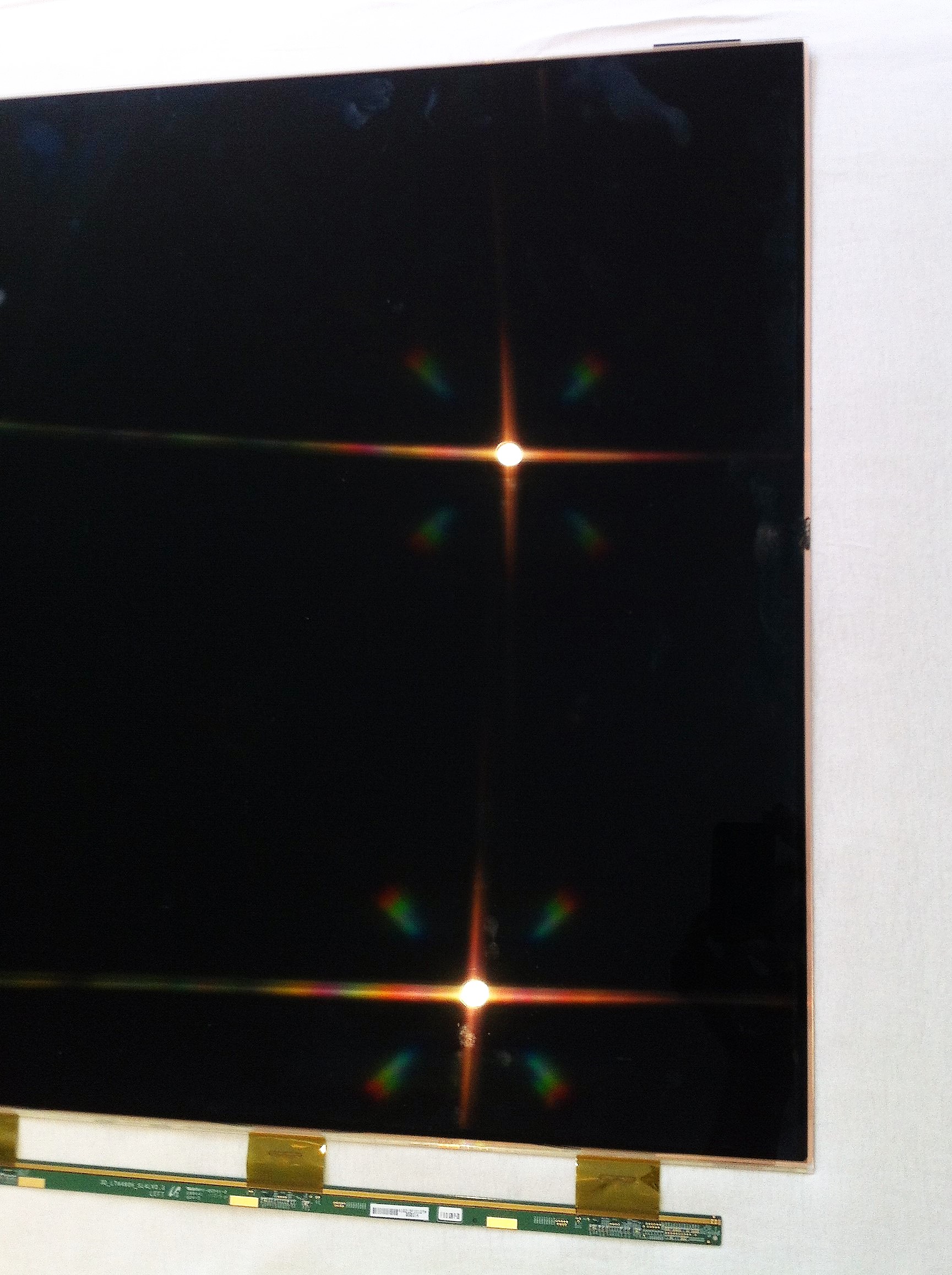

    My Samsung UE46D6510 has some horizontal bars/flickering and as I touched the bezel at the mid of right hand side it was very very hot (my fingers are almost burned).
    First I thougt there is something wrong with the LED Backlight but as I disassembled the Panel (LTJ460HW02-J) it shows that the panel melts.
    When power is applied, then the melted area begins to smoulder and to smoke.
    Question 1: Whats the Problem here?
    Question 2: Can this be fixed?
    Would be great if you could give me a hint.
    Kind regards
    FluxFlux
    Re: Panel is melting (SAMSUNG UE46D6510)
    1: It is a Samsung and the warranty is up so it is going into self destruct mode. Reality is probably a manufacturing defect leading to that driver IC failing destructively, although I've never seen one that bad! That certainly isn't normal. You may consider contacting Samsung about this as they may consider a good faith repair although I doubt it on a set this old (D series = 2011).
    2: No. Unfortunately not without a new panel. At which point you may as well buy a new TV. Perhaps don't buy a Samsung again. They aren't very well built compared to other manufacturers and rely on marketing a bit like Apple rather than producing a quality product.
      Hi Tom66,
      thank you for your fast reply.
      Two more questions to get it correct:
      1: The IC form the TAB produces more current that the PCB circuit inside the panel is getting to hot and burning?
      Or
      2: There are additional "falut" mini-ICs inside the Panel (kind of sandwitch) ?
      Overall: For me it seems that this could lead to a real fire if I would have the set on and running while not in the room/house.
      Thank You.
      fluxflux
        1: There are components on that tab bond chip that are responsible for controlling the rows of the LCD panel. They select which line of the panel data is sent to at any given time. If the components go bad this could happen although it is really, really rare. Something must have gone badly wrong. It is probably drawing too much current from the T-con board causing the device to overheat. This would be almost certainly down to that chip on the tab bond, rather than any other part.
        2: There is an IC bonded to each tab, sometimes two, which control various functions, generally controlling rows or columns of the display panel. Some newer panel designs use "gate in panel" technology where the gate driver chip (that drives the rows) is embedded into the LCD glass. The function is more or less the same but the cost of producing the panel is less.
        Yes, this is a potential fire hazard so I would recommend reporting it to your local authorities and Samsung. While the plastic casing of the TV is usually made of flame retardant plastic, meaning it is unlikely that a fire would progress, it is still an unacceptable failure mode.

              There is no solution but replacing the panel. His tabbonding is melting deu to heat.
              Side tabs removal wont help. This is fault from the factory , not liquid. The tabs are on top of the tv not bottom

                  This is unlikely to be liquid damage as that tends to corrode. This is probably the silicon chip failing on the tab.
                  In any case, the high heat in that area has probably permanently damaged the liquid crystal matrix, so that is not usable any more.

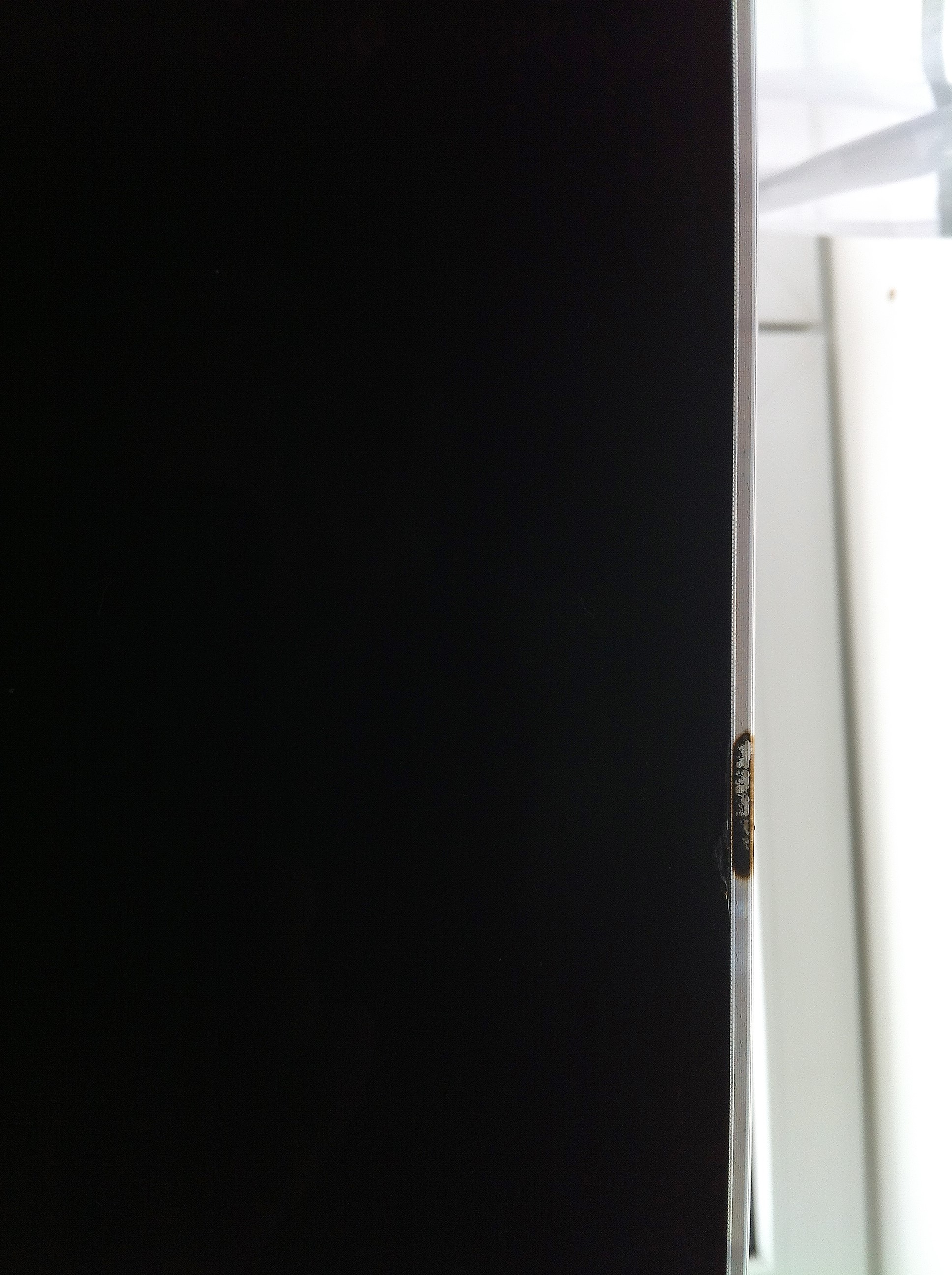

                        Samsung's AU series "high quality" panel internally melting
                        by Biruslapio
                        I got this 55 inch AU7X00 TV, it was rebooting and showed no image only a blink of the backlights.
                        I assumed it was either panel or motherboard. Turns out it was the panel, and after applying some tape on the ribbon cable that goes to the left side of the screen, the TV turned on with image, then I suddenly noticed a dark spot and the pixels were turning black on the left edge, I was sad and thought I smashed the screen somewhere, found nothing visually, it looked in perfect condition and if it was there before it would've been noticeable while I was inspecting the TV the first time....
