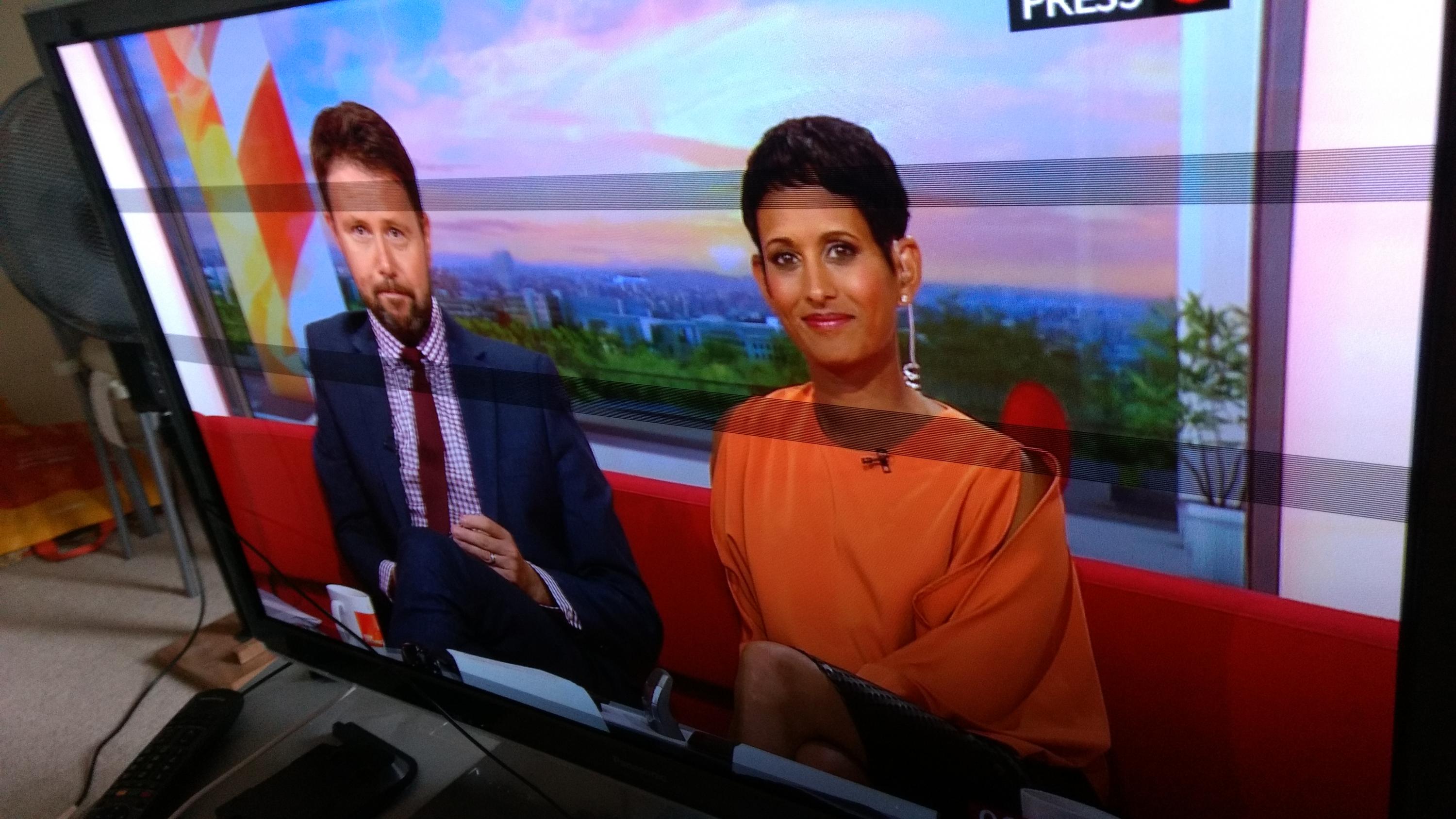

LG50PA6500 after replace y-buffer (bottom) picture is very noisy and cut in half
  • pulper111
    • Aug 2017
    • 39
    Re: LG50PA6500 after replace y-buffer (bottom) picture is very noisy and cut in half
    I've re-soldered a few connections on the Y-sustain board that were a little suspect but it has not made any difference. I'm wondering though if you wouldn't mind taking a look at the following pictures and letting me know if it provides any additional insight. The pictures were taken when no input (antenna, HDMI, etc) was provided to the TV. It provides I think a clearer picture (no pun intended) of what is going on. The top ½ of the screen has a purple/pink blotchiness to it over the entire ½ of the screen. The bottom ½ is black (what it should be). When the LG “no signal” shows up on the top ½ of the screen, it causes the “blotchiness” to bleed down, vertically, into the lower ½ of the screen (see the first link).
    I should get the lower buffer board tomorrow but in the meantime, I'm hoping this might help shed some light on the cause of this issue. Thank you!
    https://imagebin.ca/v/3YLEhgbFejga
    https://imagebin.ca/v/3YLEyXuDyQ21
    https://imagebin.ca/v/3YLFO9Dql7dV
      All you are seeing is that the upper half of the display is overaddressed for one reason or another. I'm not sure why, though. It could be anything like a faulty control board, signalling issue from control to Y-sustain or Y-sustain to Y-buffers, or lower to upper, it's a mystery.
      One thing that makes me suspect it's the lower Y-buffer is that this set chains all the data from the lower into the upper. Remember my lightswitch analogy. Well this set has 1080 lightswitches for a 1080p panel. Each switch is toggled from bottom to top in order, it's not like each board does it in pairs, it's one after another. And for one reason or another that's not happening correctly on the upper board. So my thought here is the signals that control that board are bad for one reason or another but not certain to be completely honest.

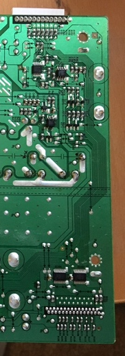

                          It will be the back of the Y-sustain board. Upload me a clear picture of it and I'll show you where you'll be working.
                          • pulper111
                            • Aug 2017
                            • 39
                            #33
                            Hi Tom - here's a picture. let me know if you need anything else. thank you!
                            https://imagebin.ca/v/3Z9stg62FcSe

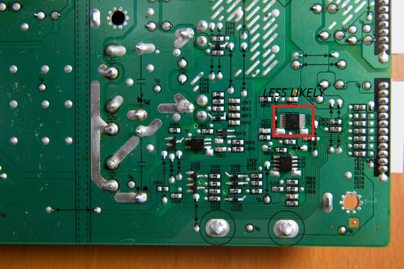

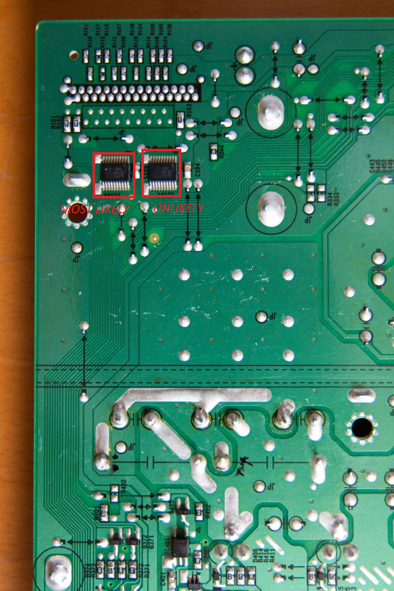

                              #34
                              Can you get me a clearer picture of this part of the board, maybe in two halves?
                              • pulper111
                                • Aug 2017
                                • 39
                                #35
                                Hopefully this is better! The marker markings you'll see on the board are where I resoldered. Thanks!
                                https://imagebin.ca/v/3ZErmowRPx4e
                                https://imagebin.ca/v/3ZEs8MbuGzp6
                                  #36
                                  It'll be these chips.
                                  If you don't feel comfortable removing them and reusing them, you might be able to order the parts from DigiKey.
                                  I've highlighted the relatively "likeliness" that a part is causing the fault by seeing the general direction of the signals, so if you feel not confident swapping all three parts then you could try swapping them in this order.
