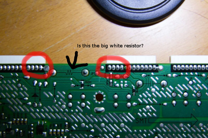

                            Re: LG50PA6500 after replace y-buffer (bottom) picture is very noisy and cut in half
                            That's an isolation pin. The thought is that the gap between the traces on the circuit board isn't sufficient, so they add an unused pin between high voltage components.
                            In fact, that's quite useful, because the only high voltage - relative to other pins - that goes to the Y-buffers is the Vscan supply. So you know that these pins are the Vscan pins that go to the buffers.
                            Please see the image. The red points are Vscan. Once the boards are installed in the set, you can test from these pins on the top. You will want to test to the floating ground pins. That can be any pin on the connector on the rightmost of the image for both buffers.
                            Another thing to verify is that the control board ribbon that goes to the Y-sustain is properly seated and no pins are damaged.
                            Finally there is a small possibility that the lower buffer is damaged, because it sends the signals to the upper buffer through a buffer IC. It would be difficult to determine if this is the fault without an oscilloscope and high voltage isolation kit, so unfortunately it will probably be a crap-shoot at this point.
                              Thanks for the picture. Regarding your question on the pic, that is the big white resistor in the middle.
                              I'm a little confused with your directions regarding checking the Vscan.
                              1. Do I check both boards for Vscan and provide the numbers?
                              2. Any of the circled pins on the picture are fine for the positive lead?
                              3. I'm not quite clear regarding the floating ground pins. You indicate on the right most of the image, but I'm assuming you mean the right most of the image for the right connector, and the left most for the left connector. If i choose one of the last two pins on the appropriate side, will they be the ground?
                              The control board ribbon is properly seated, as far as I can tell.
                              The lower buffer was damaged previously on this TV. It had a short in it (checked by continuity testing between the pins attaching the Y-buffer to the Panel and the pins attaching the Y-buffer to the Y-sustain), so i replaced it with the lower buffer board from the other TV which did not have a short. Interesting the board numbers on the Y-buffer lower are the same between the two TVs (the EBR#) but not the KP number on the sticker. When I've researched purchasing another Y-buffer board, I have not seen reference to the KP number so I assumed that is isn't important. Nevertheless, the number on the ribbon that connects the two buffer boards was different (LS1208 vs LS1238). Just mentioning this in case it matters. I did replace the upper one with the upper from the other TV but that did not make any difference to my symptoms.
                              Thanks Tom!
                                OK so I'll briefly explain "floating ground" as it's a term few people understand. Basically the buffer ICs are high speed "shift registers" which could be thought of as an array of switches, which get toggled one at a time. Think about a load of light switches but you can only ever turn one on at a time and you can only go forwards. So turn light 1 on, turn light 1 off and light 2 on, and so on. They are kind of like that.
                                Because they are high speed logic circuits they need a good ground and so they make the Y-sustain output, which is definitely *not* ground (it swings +/-200V!) the ground for the buffer/scan chips, and isolate the logic signals feeding them using isolator devices which can basically send information over a barrier of either light or magnetic energy. You can see an isolator in this pic on the bottom right, it's the white chip that crosses the gap in the two copper planes, right at the bottom.
                                https://imagebin.ca/v/3Y6PLuXTJKpe
                                Anyway, the Vscan output is referenced to this "floating" ground. The "light switches" inside the scan/buffer ICs can switch between the floating ground and the Vscan voltage. If they are switching at the wrong time, not often enough or too often, you might see what you are getting on the panel right now.
                                So when you test the Vscan you test to the floating ground output.
                                The floating ground carries the main power that the plasma panel uses during sustaining. So there are a lot of pins in parallel. While the continuous current is only around 1 amp, the peak current is upwards of 200 amps, several thousand times a second!
                                Since you are getting light on the panel - and one half is "almost" okay - I'm inclined to suggest, at least not in the immediate from what I can see, that it is not a Y-sustain issue, because the Y-sustain supplies both boards with the same floating ground output.
                                Anyway, that was a bit of a digression...
                                This connector in the bottom of the picture is a floating ground connector. Use this for the upper buffer. You can use any pin on this connector.
                                https://ibin.co/3Y6Pr8I5XI6c.jpg
                                Then test from this using the black probe on this floating ground, to the Vscan on the upper buffer that I identified previously. You can use any pin in the Vscan group.
                                The floating ground for the bottom buffer is the middle one of these. Same rule applies, any pin in this connector, black on FG, red on Vscan part
                                  Hi Tom:
                                  Thank you for the information. I did understand a little bit of it! I appreciate your time.
                                  The measurements for both the upper and lower buffer were approx 151V (would vary from about 150 to 151.6 or so).
                                    In which case, all I can suggest is that you replace perhaps the bottom buffer. I'm not certain though.
