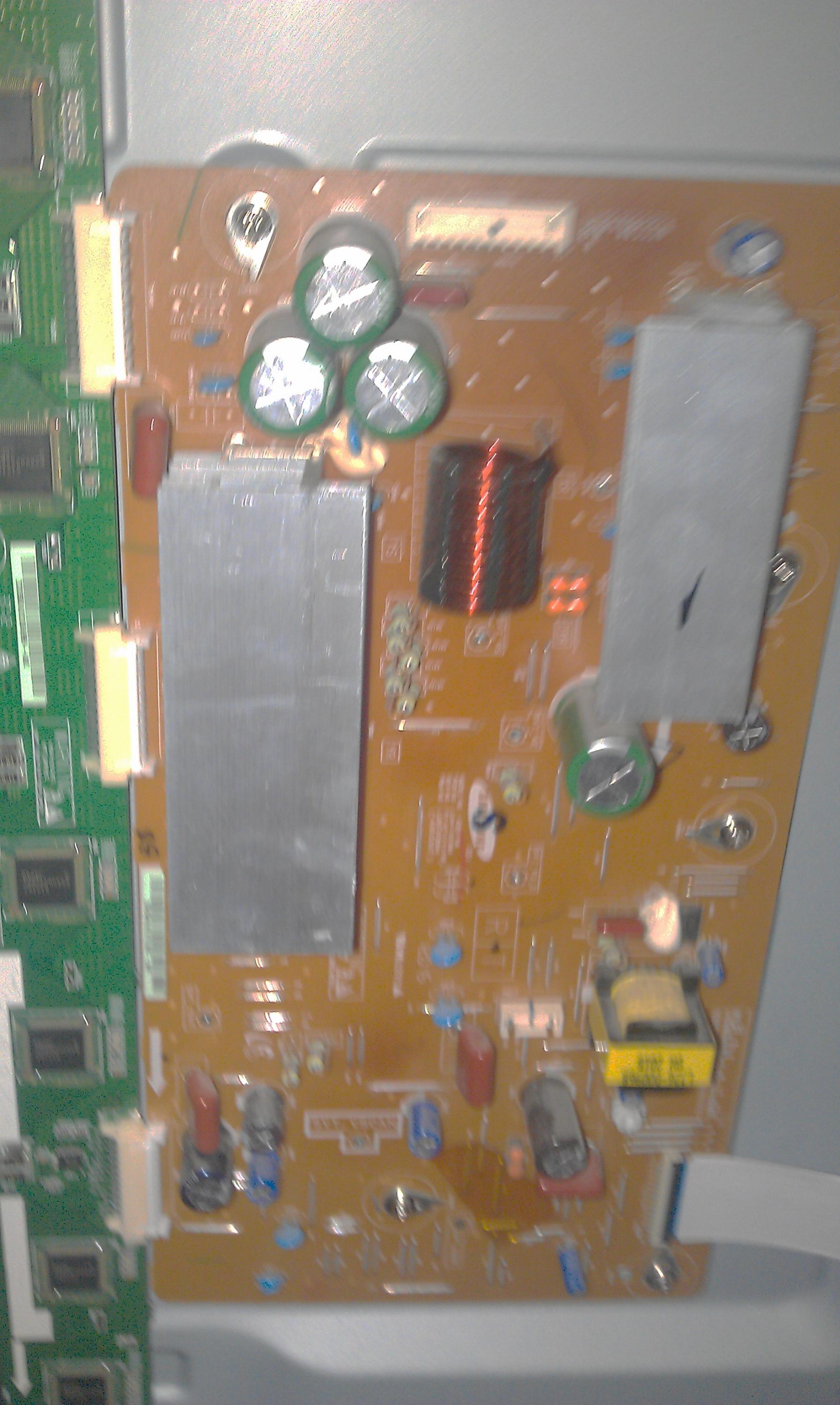

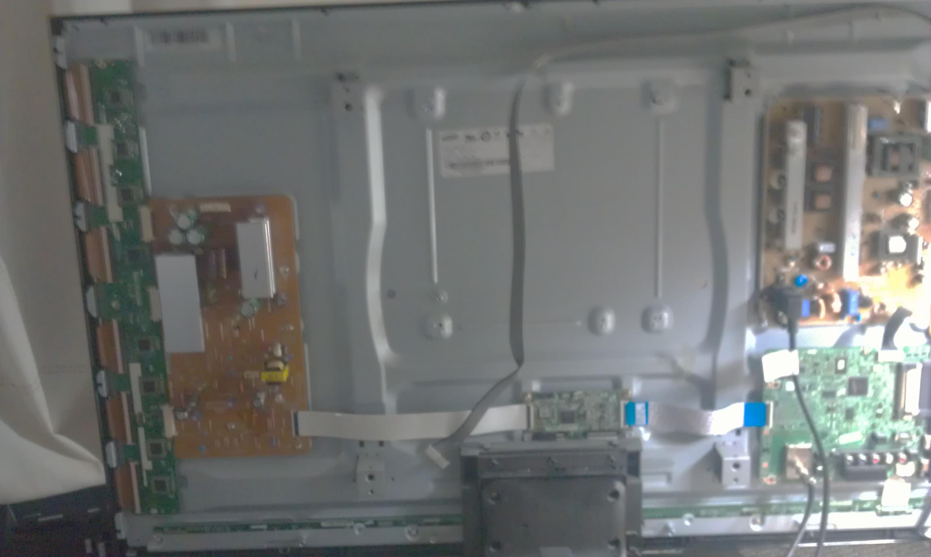

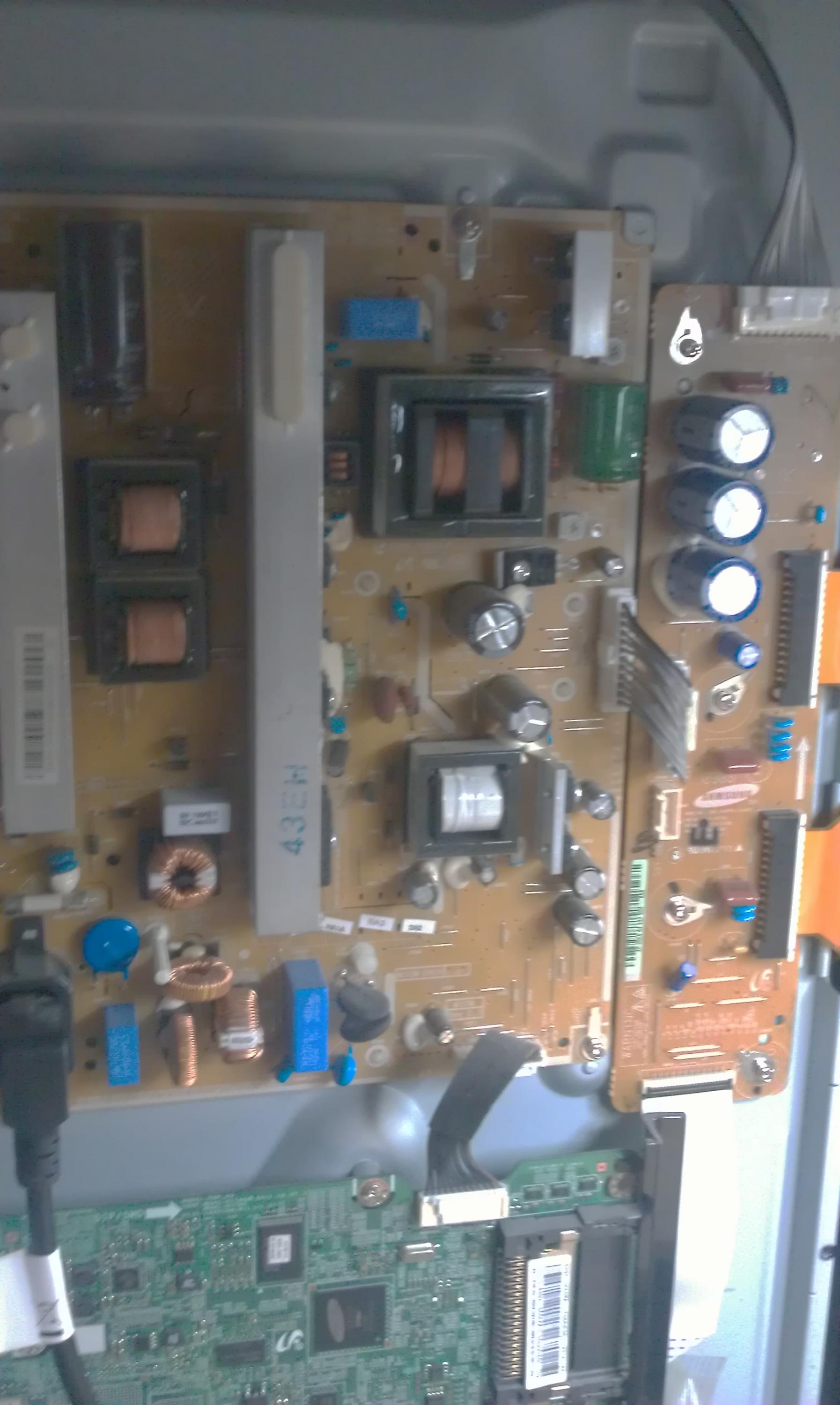

                  Re: Samsung PS43 E4501W Plasma Tv
                  A few pictures of the board. X - Main seems to have been incorporated into the PSU. My phone camera sucks , I can't get good pictures. I will get me some battery's for my Digital Camera asap.
                  • Techstar
                    Tv Restoration
                    • Dec 2012
                    • 122
                    • United Kingdom.
                    I will post some really high quality close ups soon , once i get new Duracells for my proper cam. Samsung PS43 E450 - 1W
