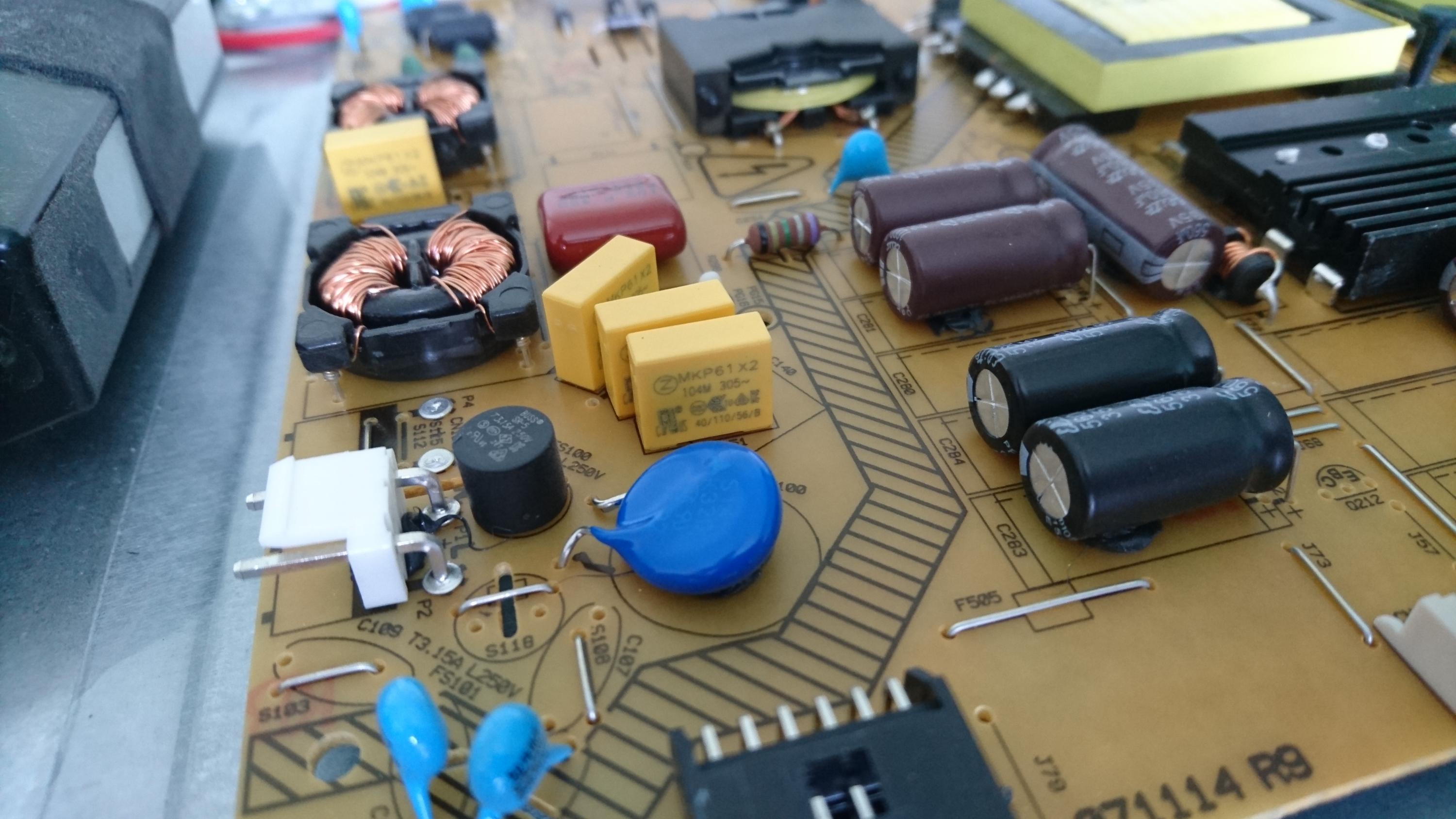

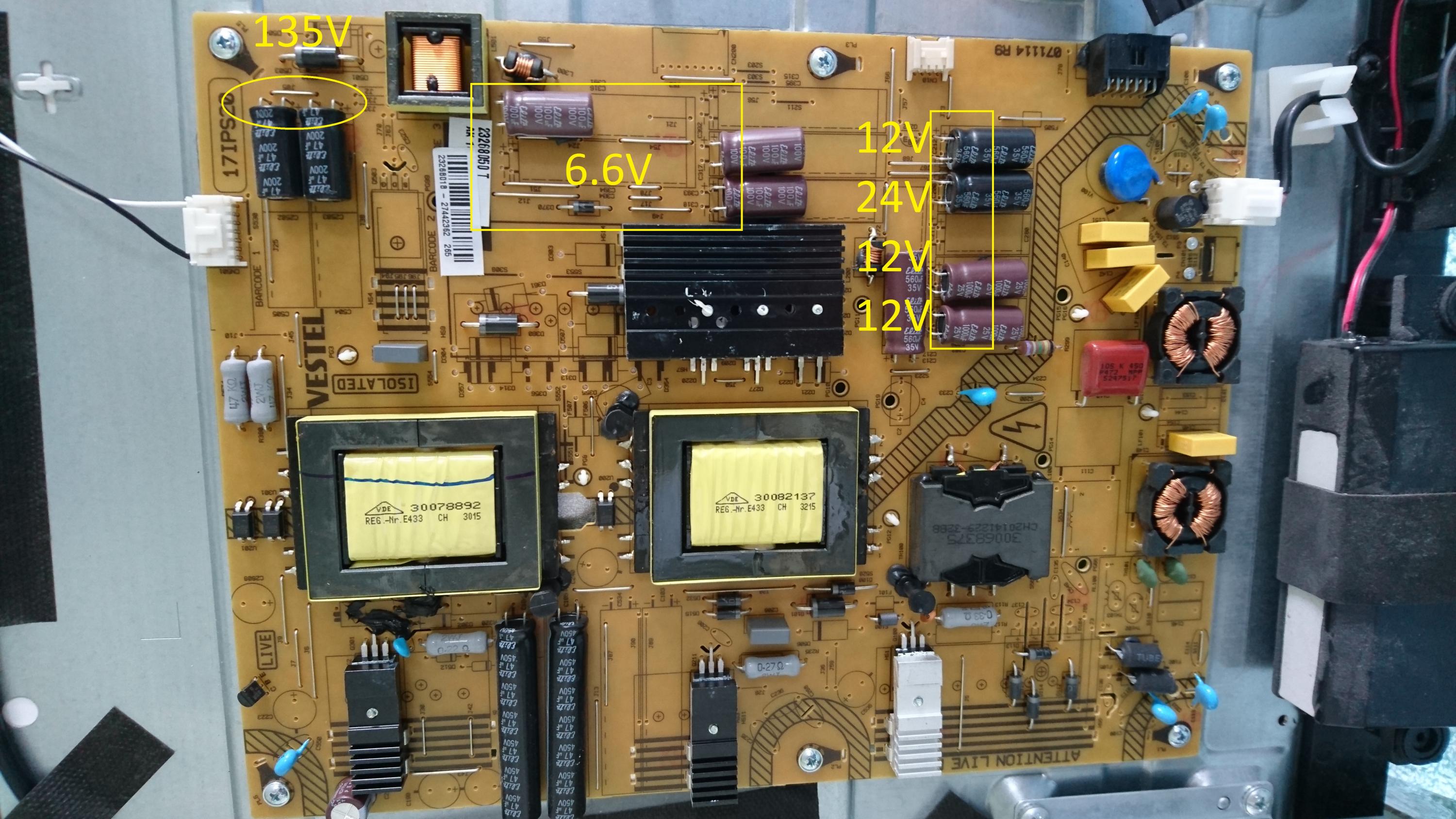

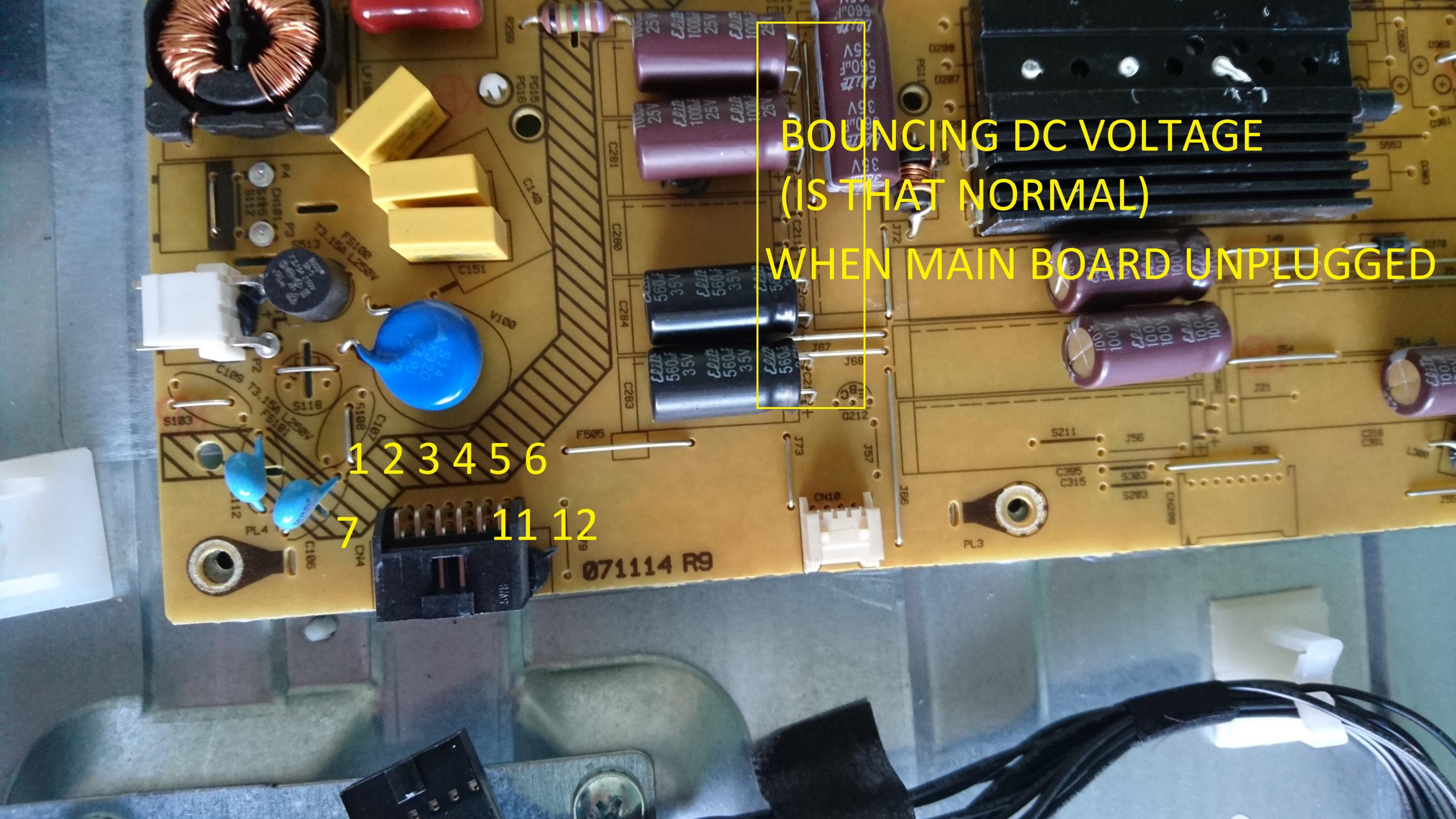

    Hi guys this has just come to me and im not too sure were I should be checking voltages etc.....Vestel board hahaha
    I seem to have a voltage bouncing around but not sure if im checking in the right place see attached photo
    the set powers up, the hmdi channel info comes up, then after a couple of minutes it will freeze then switch off and on again, its gradually got worse the more I do it......i.e the screen stayed on longer when it 1st started checking it
    there is no signs of burning any where or shorts on the board
    I have circle where the voltage is bouncing around, and also were there is a suspicious area in which the diodes read 0 both ways(not removed as of yet though)
    wanted to check the voltage properly 1st
    MAIN BOARD PINS
    1= 23v[25V ON] 7=
    2= 8=0
    3= [3.26V ON] 9=0
    4= [3.26V ON] 10=0
    5= 11=12V
    6=12V [11.9 ON] 12=12V
    the ones that are blank are reading mV and moving around

        OK, shepp...OK....If the diodes appear faulty....lift one end and re-test...then worry about voltages......from your questions I misinterpreted as you not having any knowledge...SORRY. my bad....

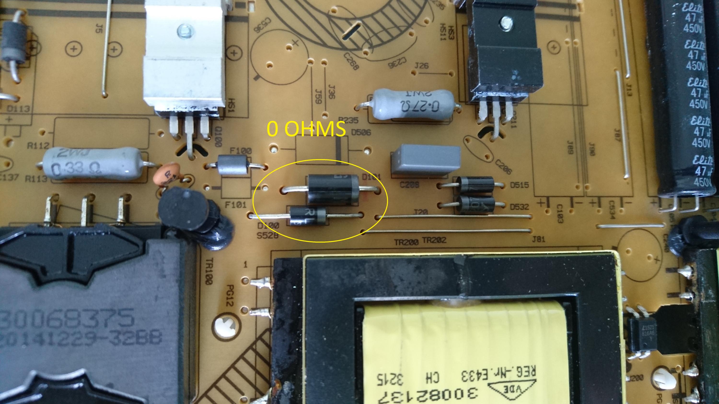

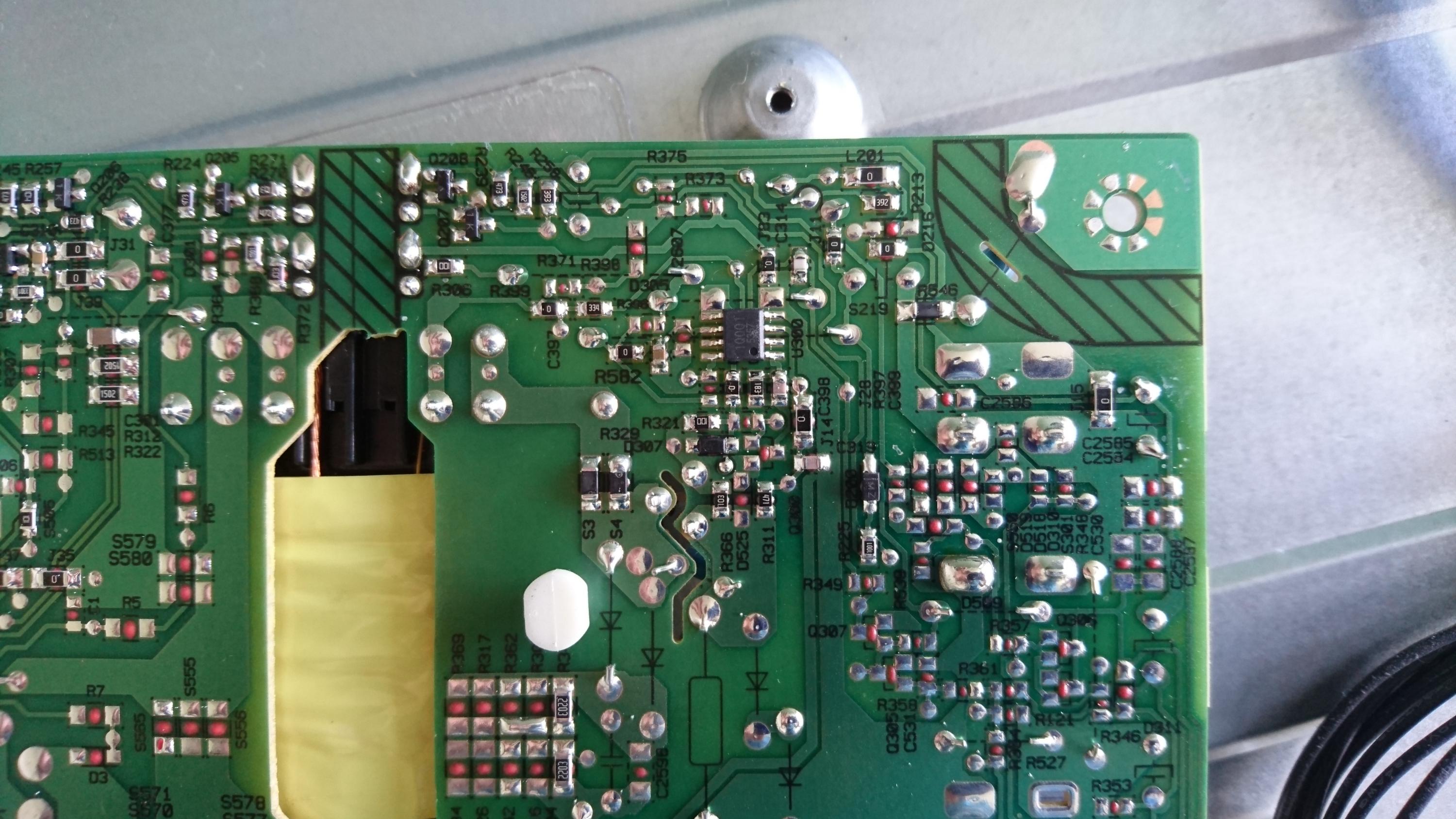

          Pulled the biggest diode off today and it has gone 0 both ways, in the attached Pic of the 2 diodes.
          the transformer in which they are connected is the 30068375 transformer not sure what that does but if its to do with the LED backlight then it would make perfect sense
          • dick_barton
            • Aug 2015
            • 6643
            • Wales
            Re: Panasonic TX-40CX400B - 17IPS20 - DULLSCREEN+ON/OFF/ON/OFF fault
            When you replace the diode use the same type. That is, if its an ultrafast Schottky diode then replace with likewise.

              Yes Ultrafast one.. MUR460G - Β£2 off ebay so ordered it.....then found the same ones on RS for 0.34p ....typical

                    Right .... so ive changed the Diode and the screen is nice and bright now, but its still switching off rather quickly, it powers up, I press menu, scroll and then it freezes and switches off then powers back on and so the cycle begins

                            Is this the 5 volts standby you are missing? try and follow the line back, it must lead to a regulator ic or diode and then check if its supply is working, I can't see the main board even turning on without 5 volts standby

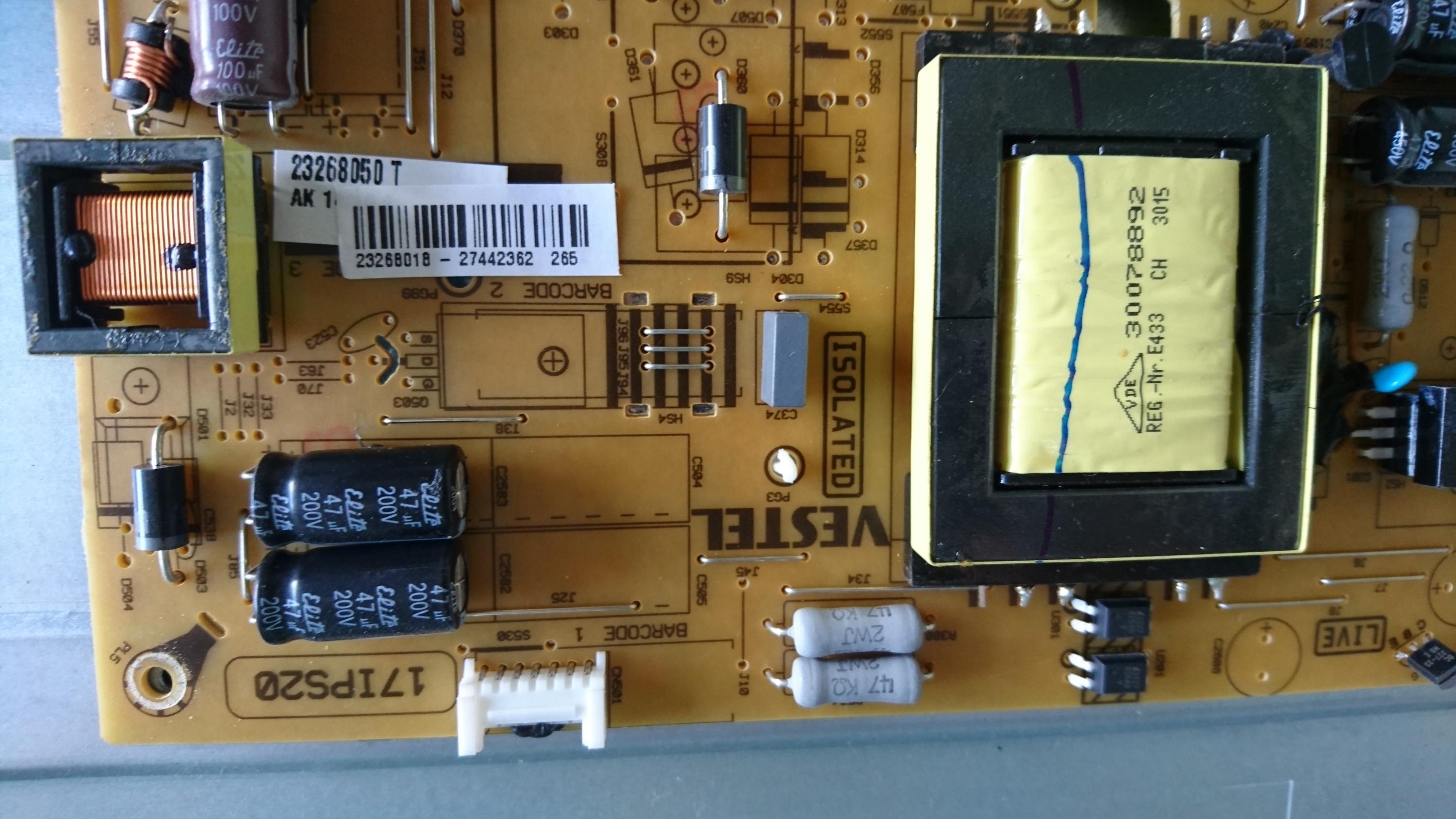

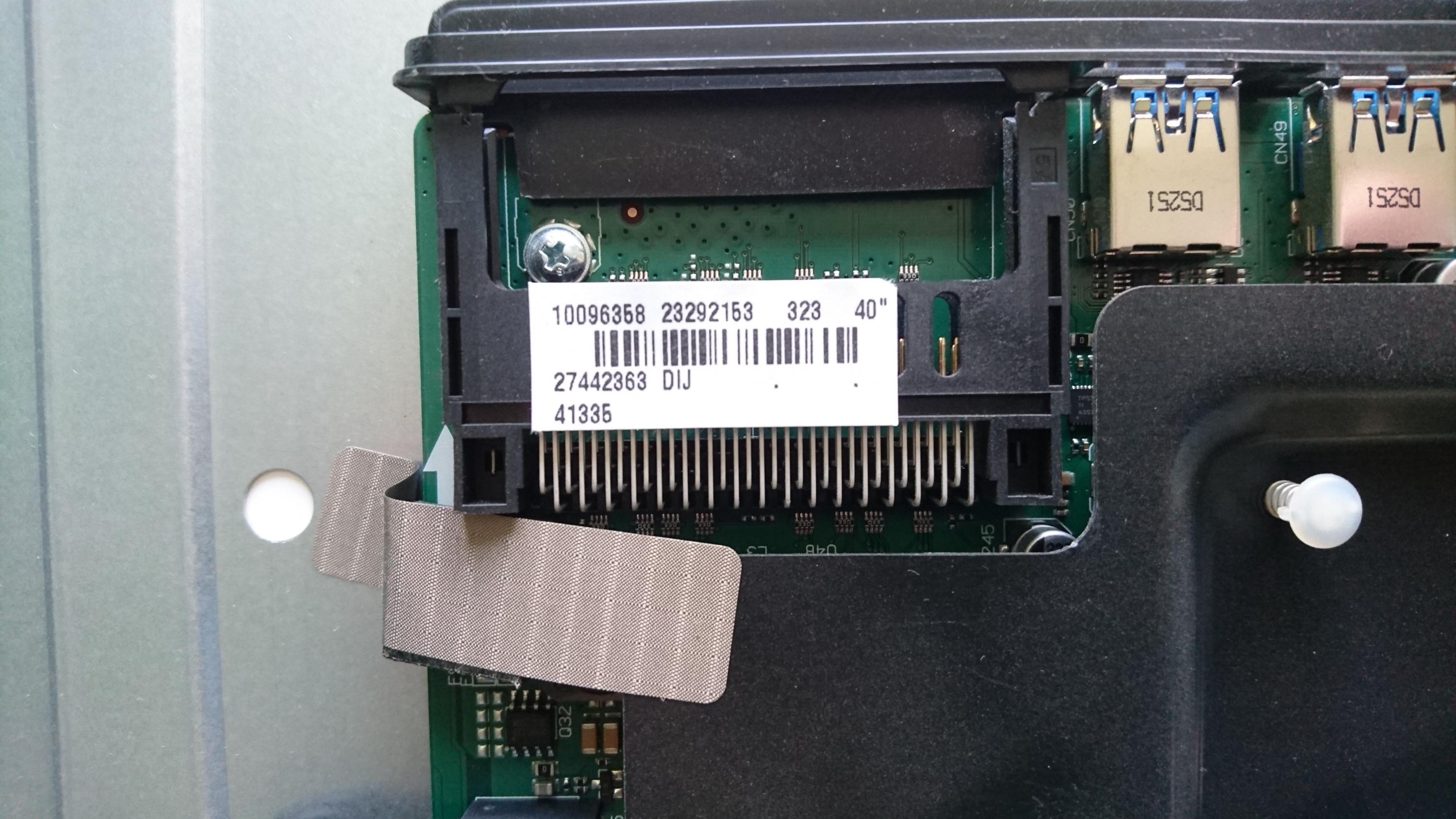

                              Q212 for the 5v isnt even on the board its empty check pic no.2 right bottom corner of yellow box
                              and I cant find any 5v signals, found a 3.3 and 12v and 24v, think the 3.3v is for the backlight control and thats it, im gonna run through the testing again tomoz and post results just in case they have changed

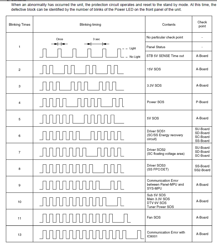

                                right so its blinking 4 times twice, then when it reboots it blinks 3 times then 7 times
                                in standby I seem to lose the 24V off pin 1 and get 1.8v on pin 2
                                attached is the blink code info that I could find, any ideas anyone, im not familiar with the terms on the sheet, so is P-board is PSU and A-Board Main and also what is SU, SD, SC, SS-Board?

                                  It may not use 5 volts for standby, it may use the 12 volts as standby? Standby must be working or you would not have a blinking led and any codes. The 24 volts will shut down in standby
                                  I dont have that manual
                                  NOTE: Those codes are for a PLASMA TV, This is an LCD tv correct?

                                      Being that it is actually a Vestel produced tv I dought the Panasonic codes will apply
