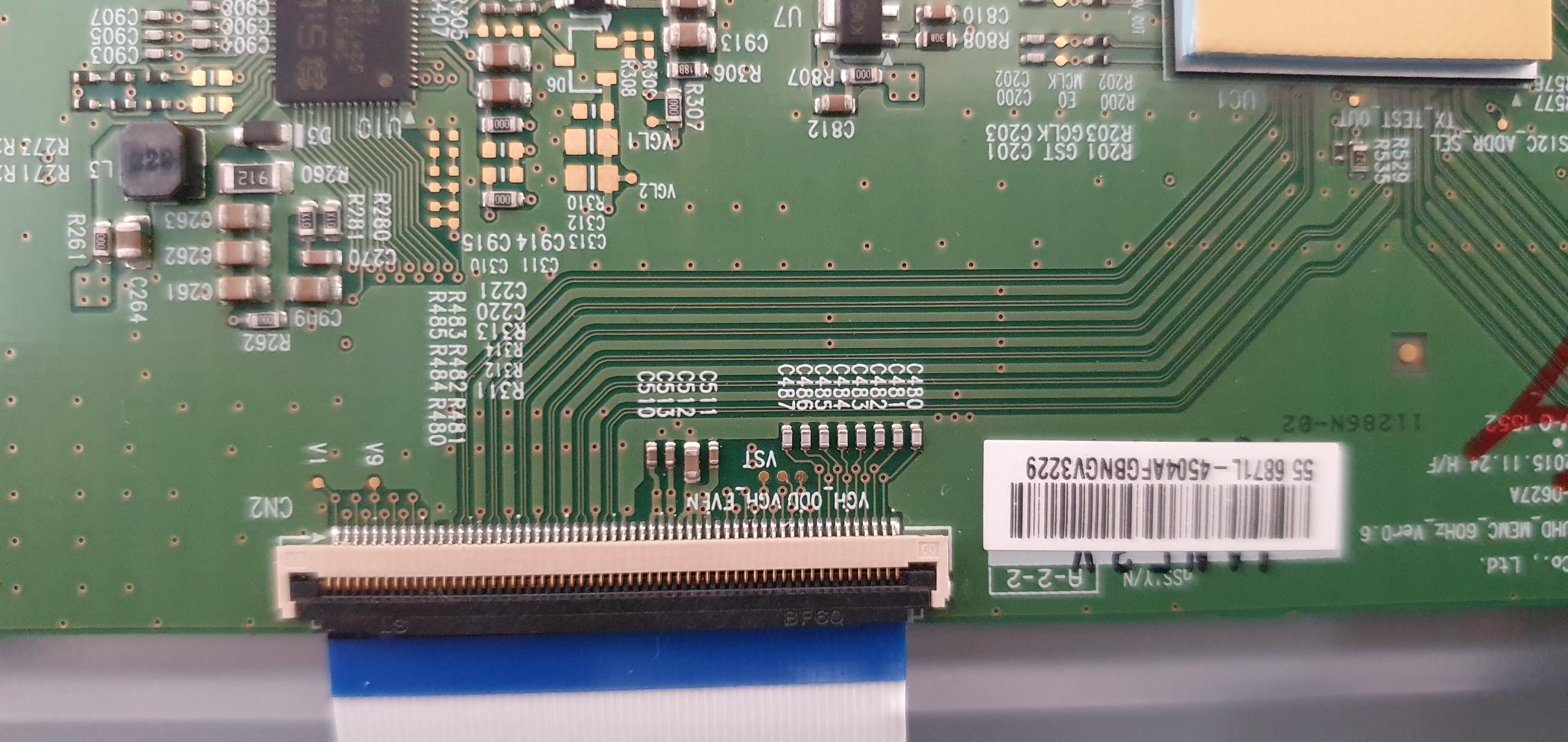

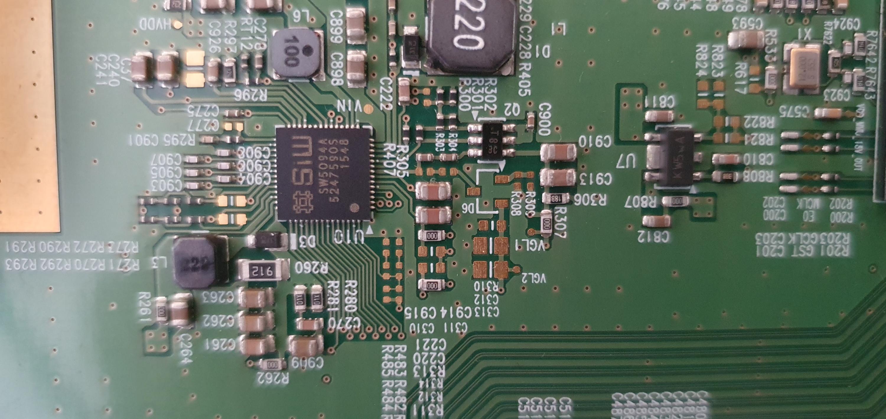

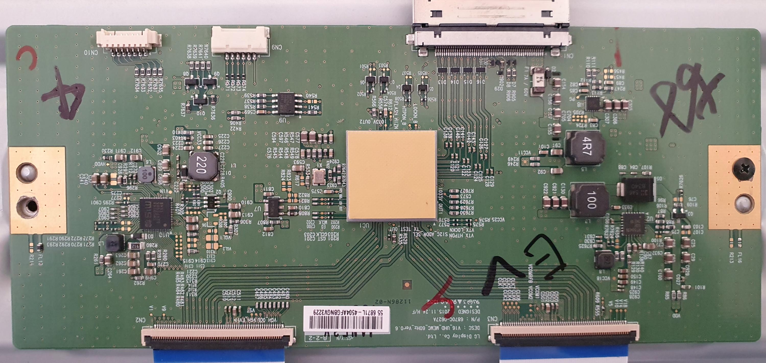

Panasonic 55DX600u second fault - panel brightness pulsing on right side
  • fixxy88
    • Feb 2023
    • 27
    After getting the backlights up and running a second fault has emerged on this TV. I was going accept defeat and move on but thought I'd have a quick look at it in case it was something simple. The right side of the display exhibits a panel brightness (not backlight brightness) pulse every 2-3 seconds in a stable timing.
    I poked about on the TCON test points and found one voltage that is fluctuating in the same pattern. VGH-ODD (Pin 47 of U10) is sitting at ~-6.5v then goes up to ~28v when the brightness pulses then goes back down to ~-6.5v again in a repeating pattern.
    Aside from feeding in an external 28v and probably damaging things, I'm out of ideas and any help here would be super appreciated. Cheers
