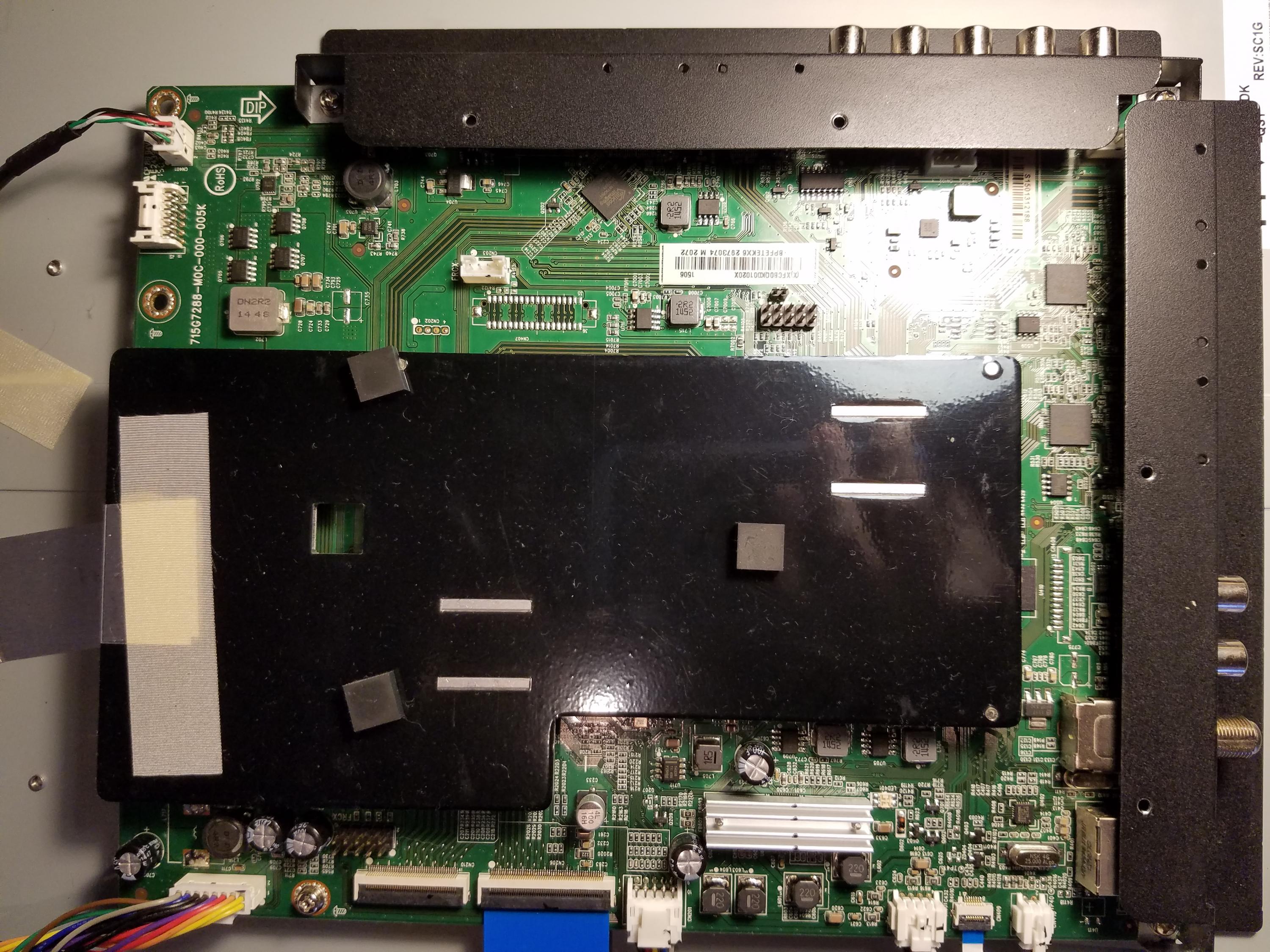

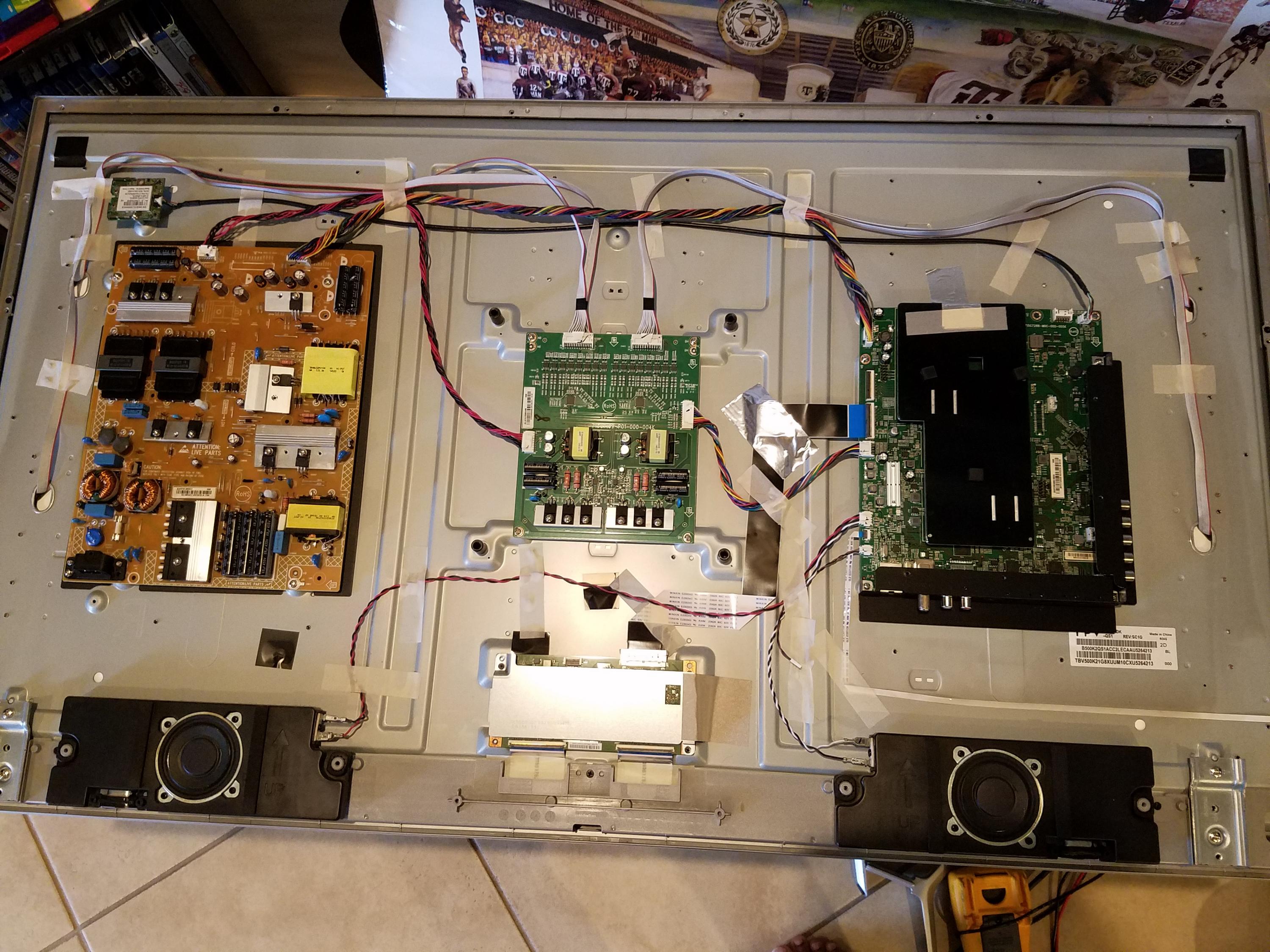

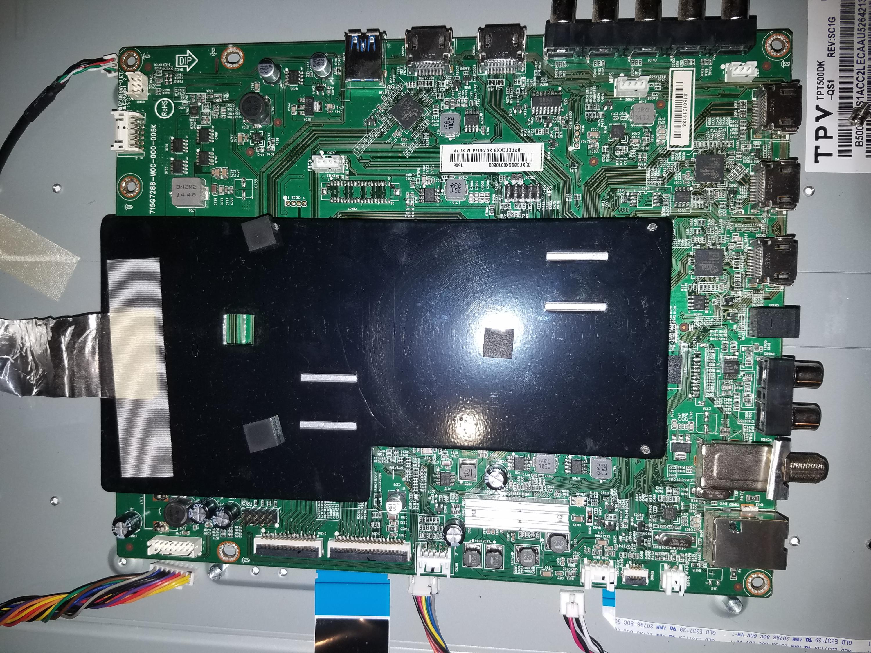

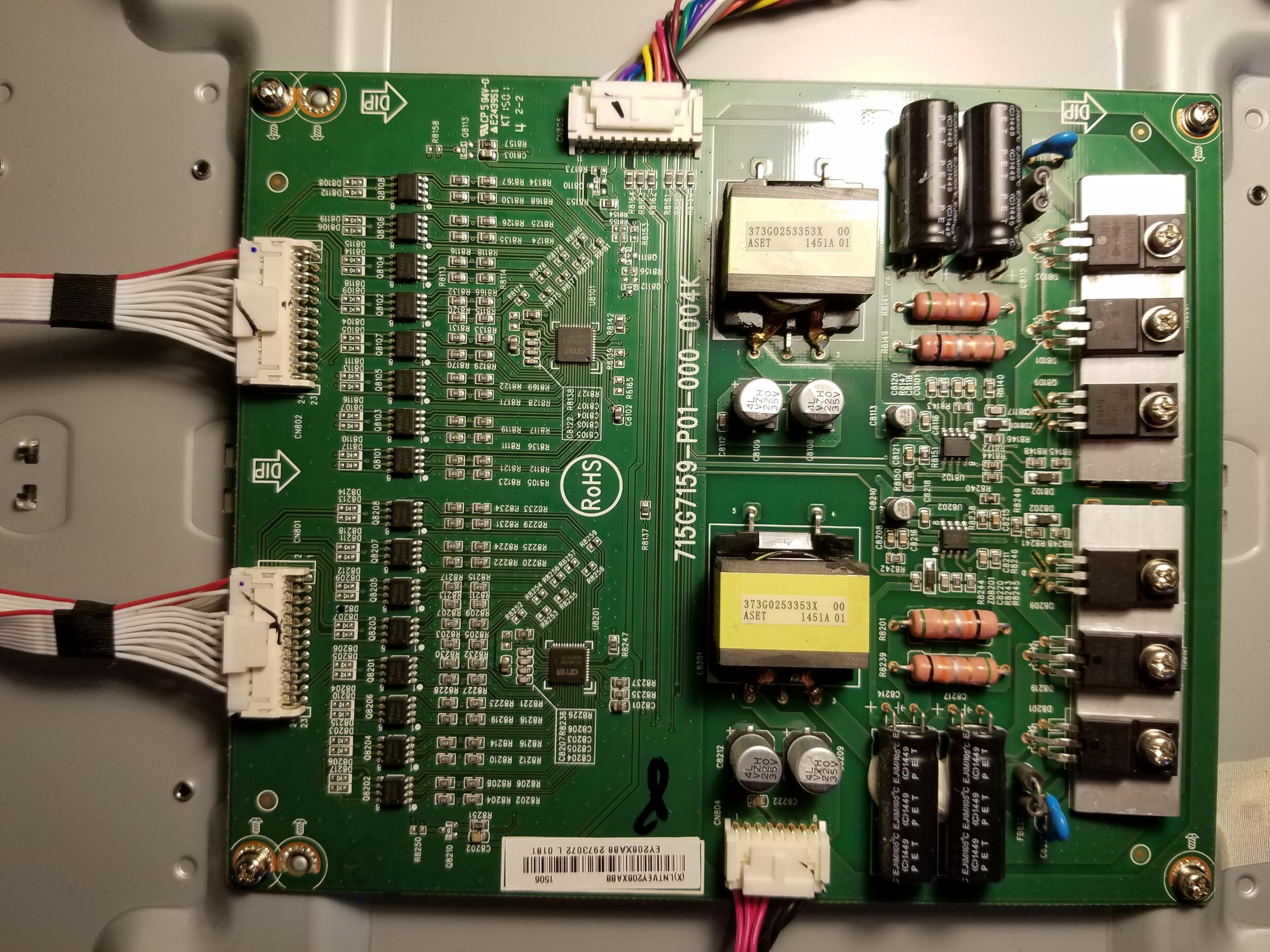

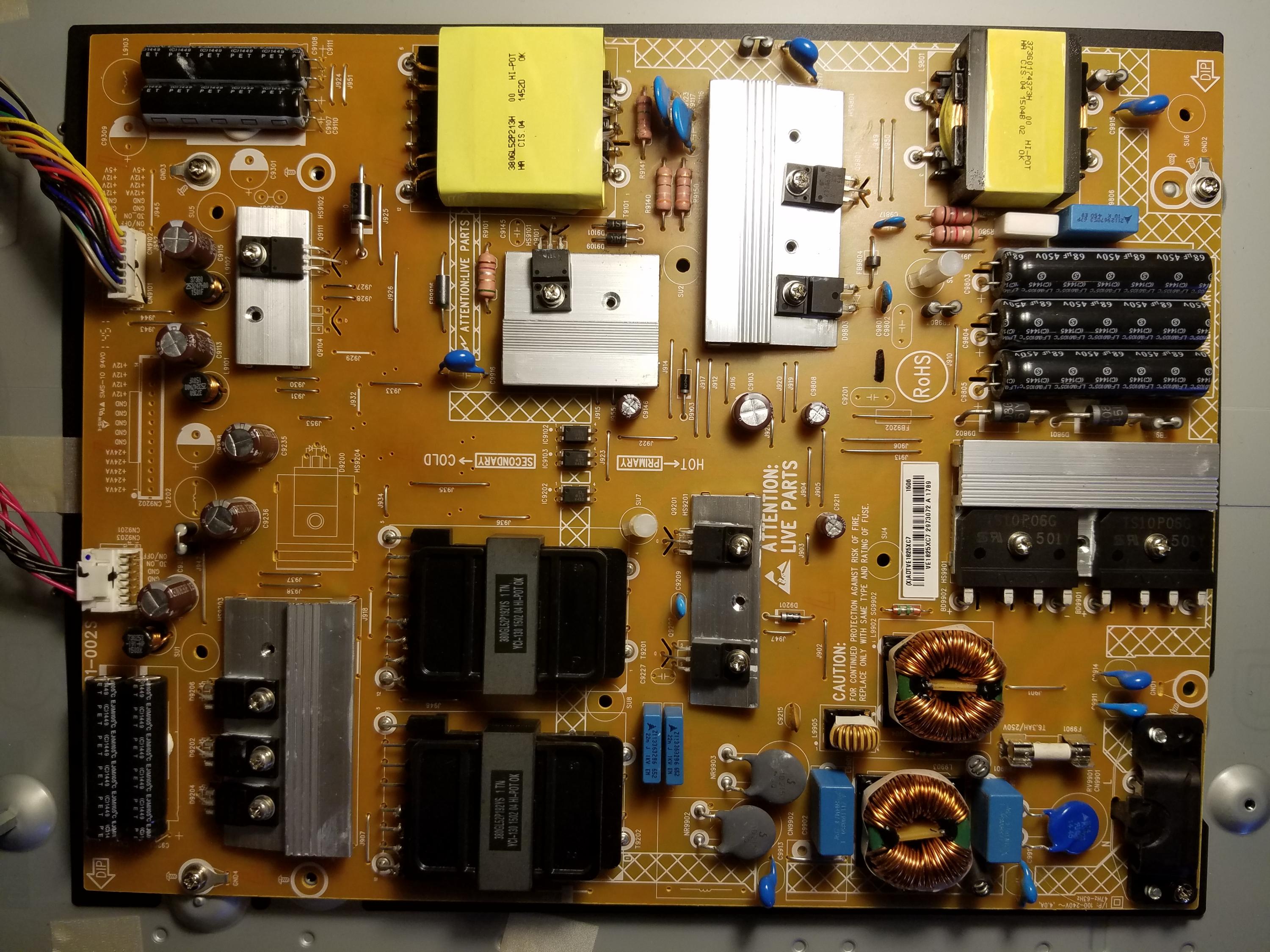

    Need good clear straight on pictures of back of tv with cover off and each board.
      Re: Vizio M50-C1 - it turns on then turns off
      I figure I need that. I'll be doing that in a bit when I get back. I tried to look for signs of bad capacitors and found none. Thanks
        Here is what I got. Got a multimeter to test.

          And also Need voltages from connector that goes from power supply board to main board. Will need pin#- PIN DESCRIPTION -Pin voltage in standby-Pin voltage when pushing power button and picture of connector on power supply board.

                                  What dcv do you get across C9804 main cap on power board when it tries to power on? I don't think 22v is the problem. May have some bad caps on main board.

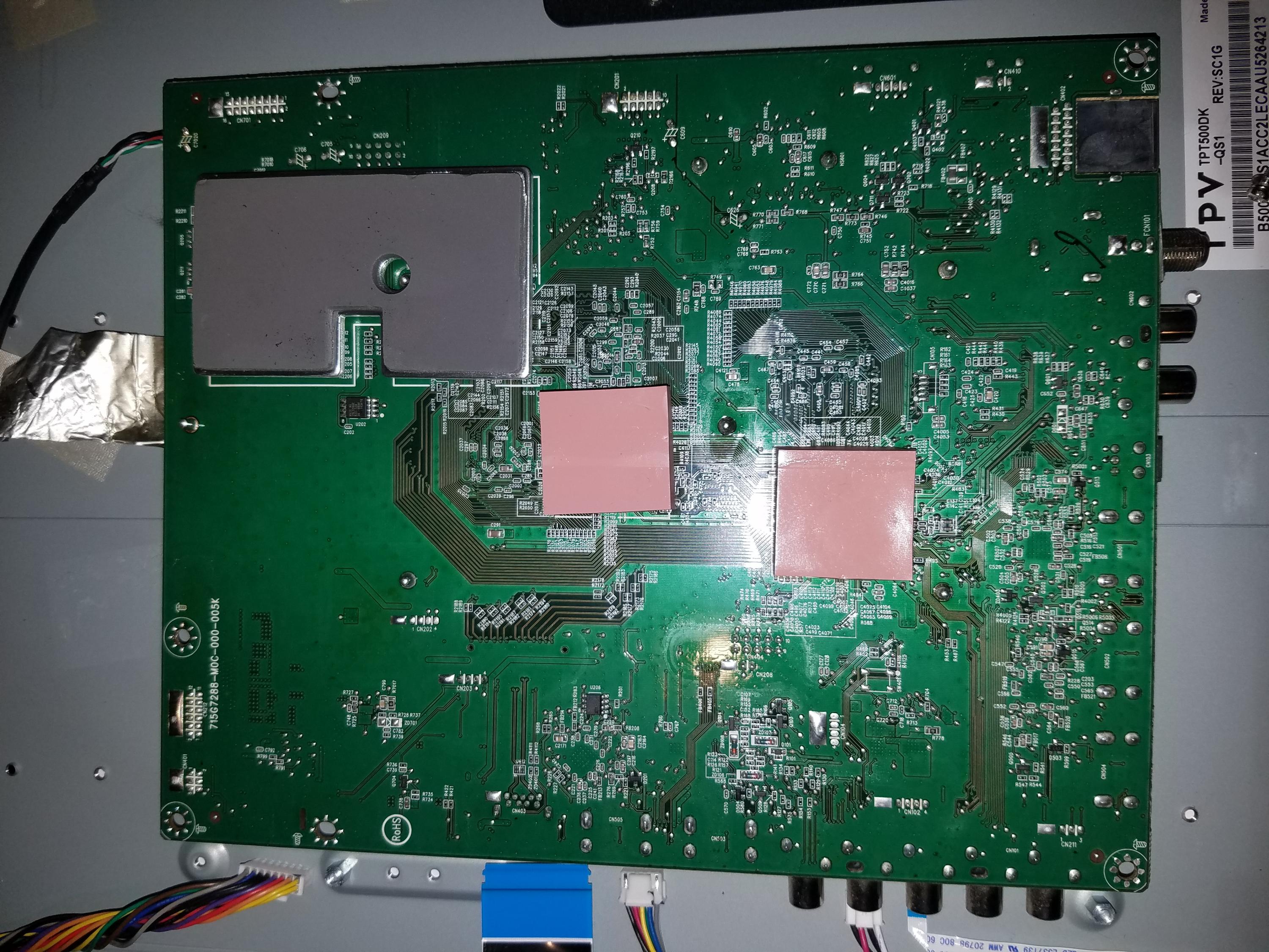

                                    Thanks man. Just checked and its 395V. Tried looking at the main board and not seeing any bad caps that I can notice. I tried removing it and looks like it has some adhesive that I cant pull it out. You think that its ok to pull it out to check the whole main board?
                                      I got some time today and got the main board out. There's no signs of bad capacitors on the main board that I could notice. How would I be able to test it? Would I need to solder it out to test? Any other suggestions on components that I would need to check out?
