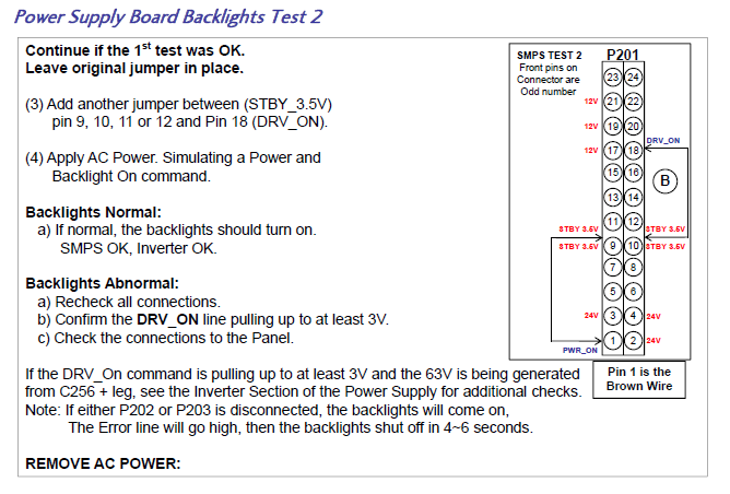

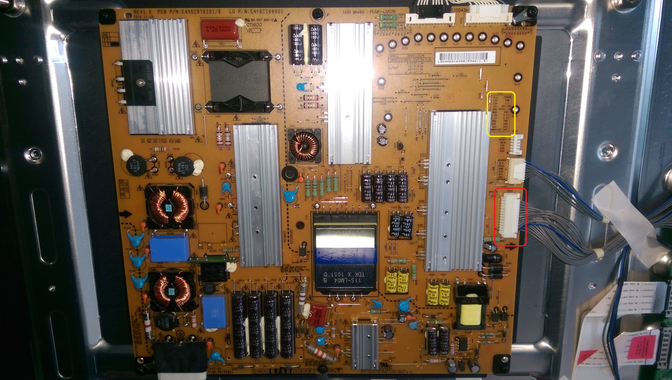

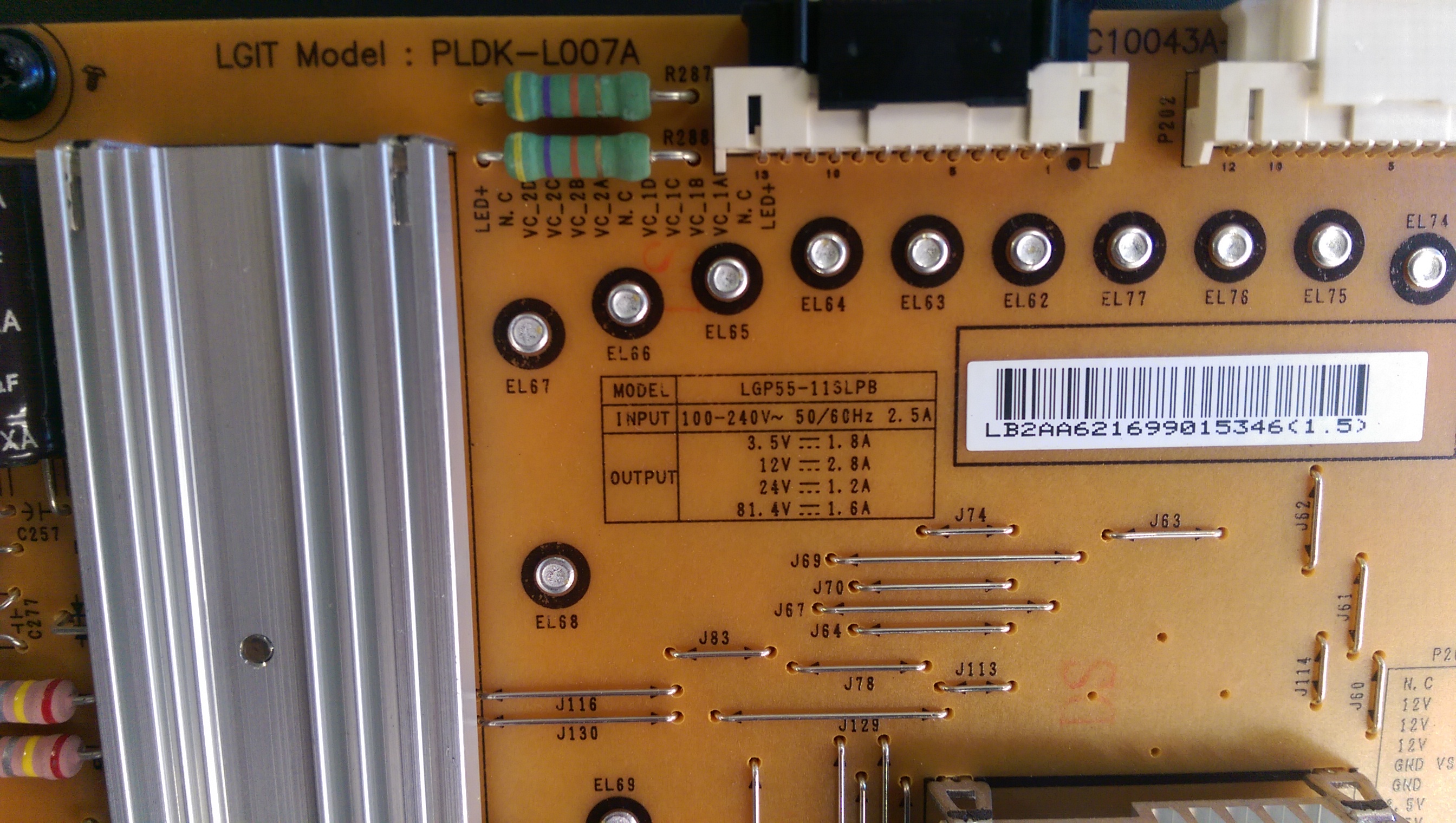

    A good place to start is to provide the voltages as written in the yellow box as found on the 24 pin connector in the red box.

      With the TV turned off, the only voltage present is the 3.5V which measures 3.551 with respect to chassis.
      With the TV turned on I got the following:
      Pin..........Label..........Voltage
      1.........POWER-ON......3.437
      2->4........24V..........24.73
      3->8........GND...........0.003
      9->12......3.5V...........3.541
      13->15....GND...........0
      16.......VSYNC-IN.......0
      17,19,21...12V.........12.09
      18.........DRV-ON........0.036
      20,23........NC............0
      22...........PWM..........3.186
      24.........ERROR.........0

        The voltages look good. I'm not sure what Vsync-In does but I am a little suspicious that DRV-ON is low.
        Have a read through the following thread.
        https://www.badcaps.net/forum/showth...light=55LV5500
        This has a blown Q507 device which should supply the voltage to the Tcon.
        Edit
        There is a schematic for the set at the above link. It looks like DRV-ON is the Inverter control input.

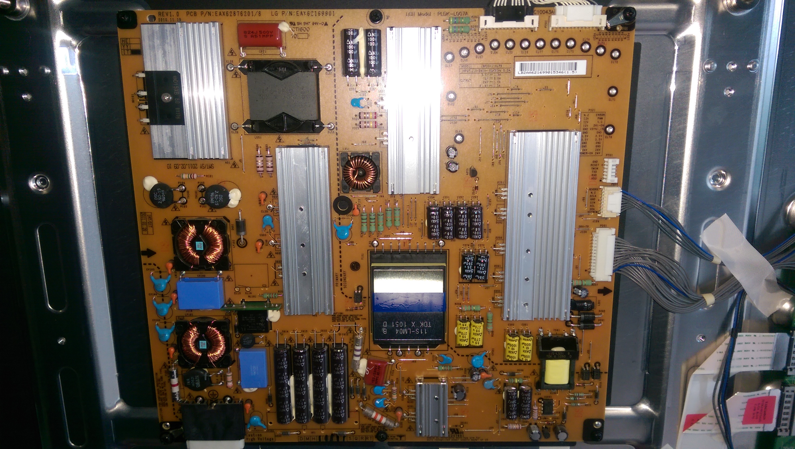

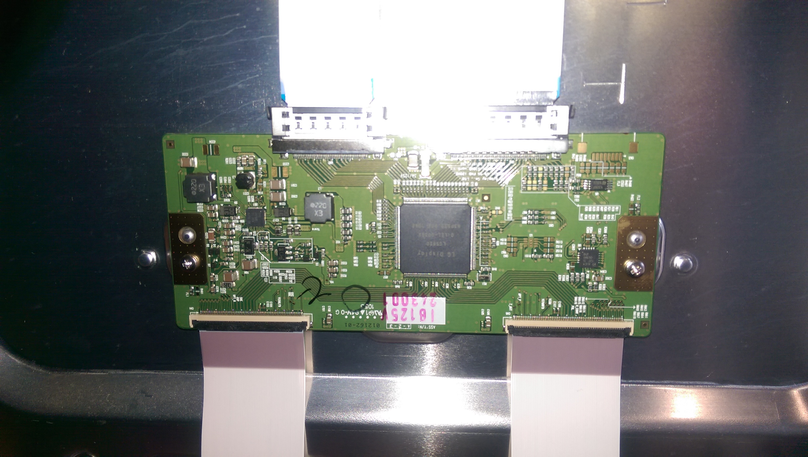

          Can we see the pictures of the whole backside of the TV so we can see how all the boards are connected together?

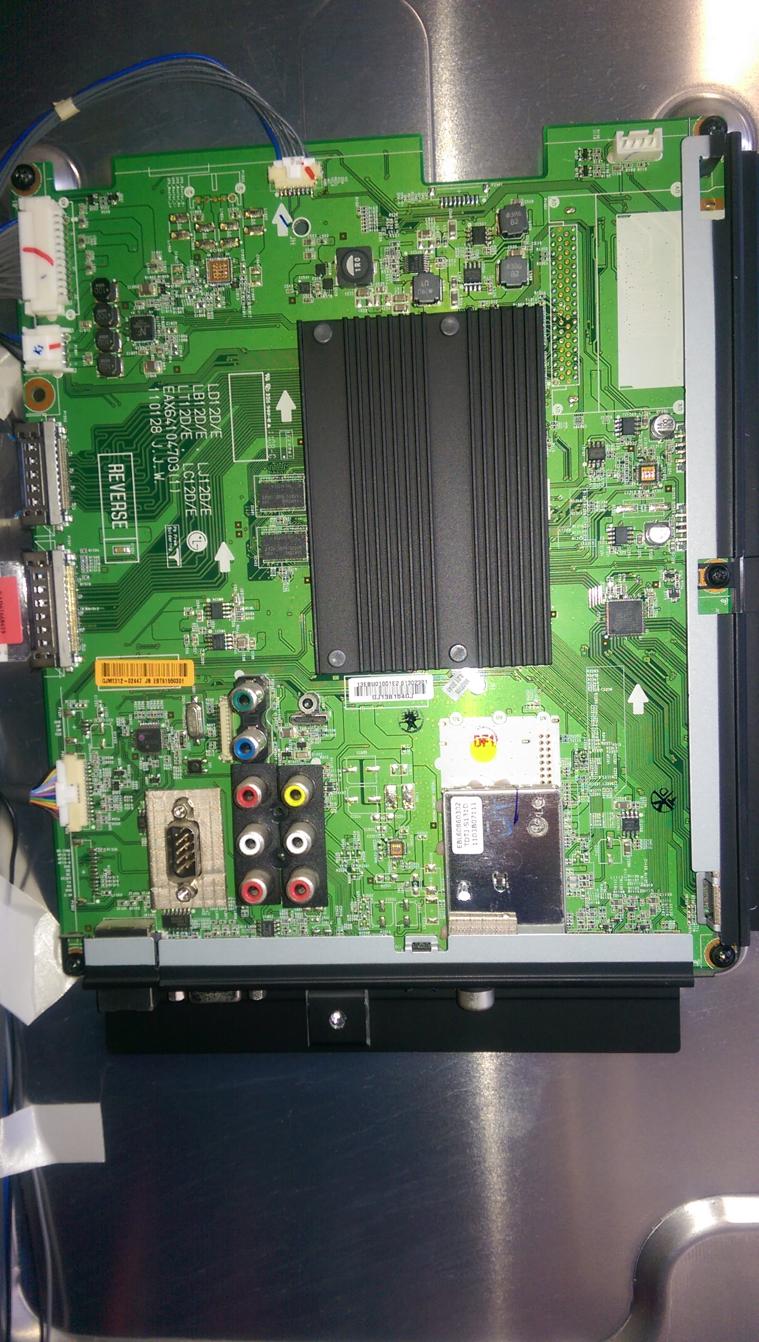

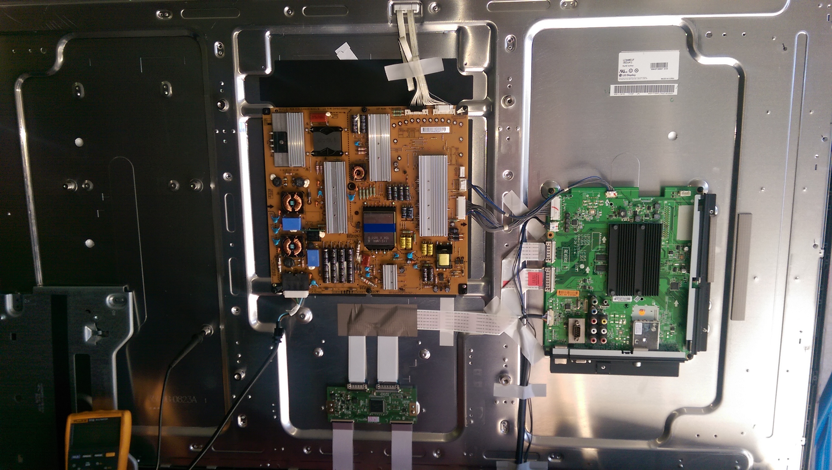

            Here is the layout of the boards of the TV, looks fairly common to other models in other threads.

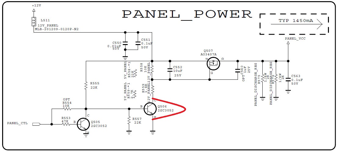

            From the training manual for a 55LW5600 (not my model but seemed very similar) I was able to test the DRV-ON signal, when I applied the 3.5V supply to the DRV-ON connection, the TV's backlight came on.
            Have checked Q507 and believe it is working, I took the main board out of the TV and tested it on the bench, I applied 12V to L511 and put a short across Collector to Emitter of Q506 and was able to see volts appear at PANEL_VCC. While I had 12V connected to the board, I could measure 1.9v at PANEL_CTL which was enough to turn on Q505 which turns off Q506. I believe that volts on PANEL_CTL means NO volts to PANEL_VCC based on the inverting logic of Q505 and Q506.

              PNL_CTL is active low, the PANEL_VCC is the Voltage for running the T-CON board, that PNL_CTL should go the mirco controller pin.

                I agree, PANEL_CTL needs to be taken low for the 12V to be allowed to go to the T-CON board, so I am thinking the processor is not commanding the output, either due to detecting a fault or is faulty itself, this would also explain why no sound, the processor is not working at all or has decided there is a fault condition, The flash of Red then White of the Bezel LED a clue as to a fault code?

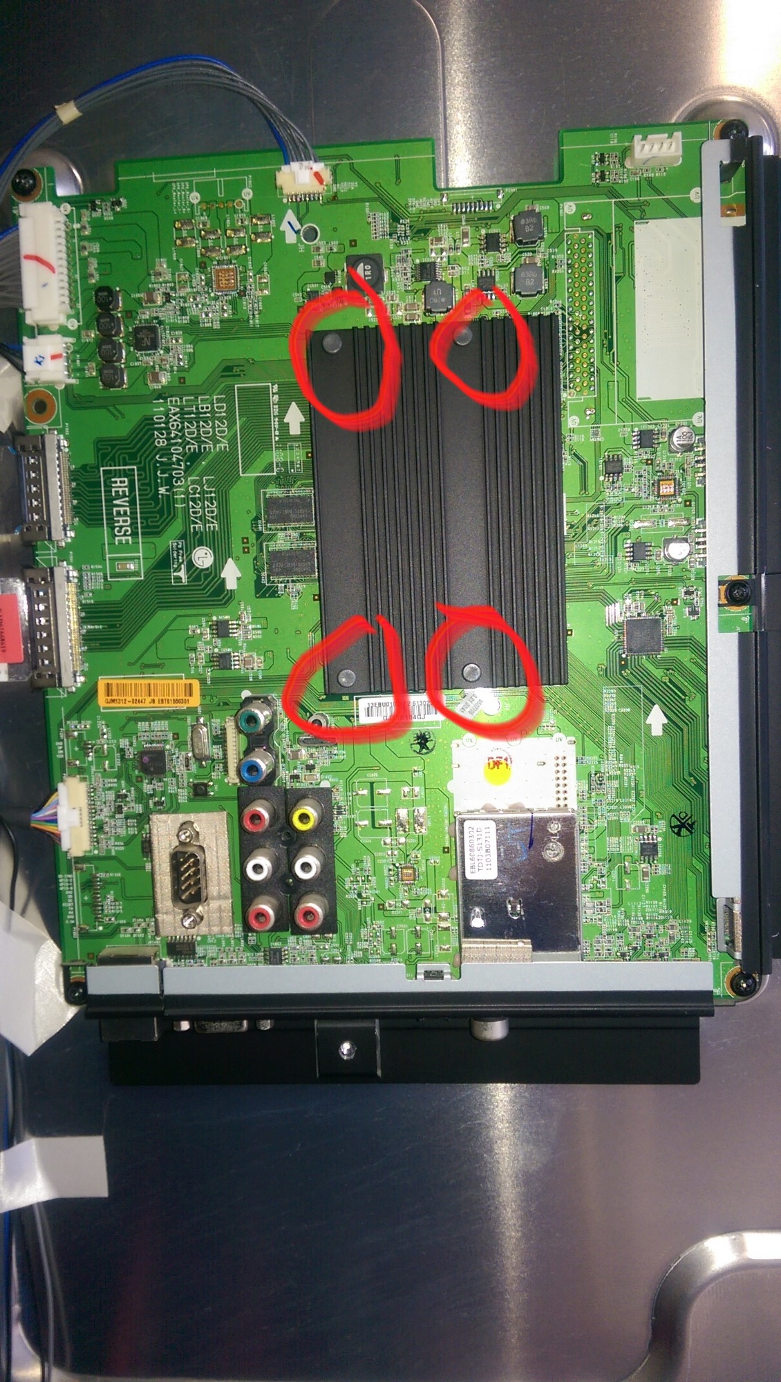

                  Just as others have done. I removed the main board and heatsink and used a little flux around the drive ice and the two PCs of memory I think. These three chips are all bag, ball solder.
                  Link to video of reflowing thebthree chips. A li%let liquid flux then heat with hot air then allow to cool don't move while heating or parts could be misaligned.

                        There are 4 spring loaded pins on the big black heatsink that have to be removed. Pinch the ends from the backside and push through. Take off the rubber pad from the icu and use a heat gun on LOW for about 45 seconds. Make sure you heat the entire area. Let cool then put back in and try it. I have two that have been working for 3 years now.
                        • eriklhayes
                          • Feb 2019
                          • 3
                          Re: LG 55LV5500-TA No picture, No sound
                          That did it! THANKS. Sweat equity pays off again!

                            Thanks for all the suggestions above! I reflowed my unit today with a heatgun for about 45s, and it worked wonderfully after putting it back together. However, about 2 hours of operation later, the screen suddenly turned black, and I got the flashing power LED conundrum again, with no backlight, putting me right where I started.
                            Just tried reflowing for a second time with more heat, for 1min, but no go
                            Is the board just totally fried now and I'm out of luck?

                                Update: I stuck it in the oven per all of the descriptions online, and it seems like it's back to life for now. I wonder if it's because some other component needed to be reflowed, aside from the ICs under the heatsink.
