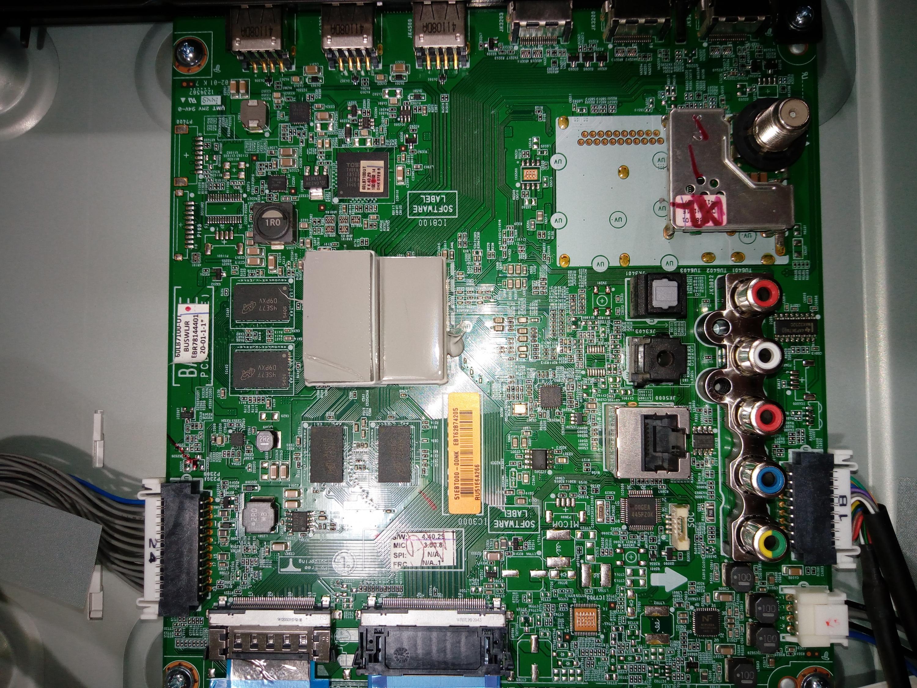

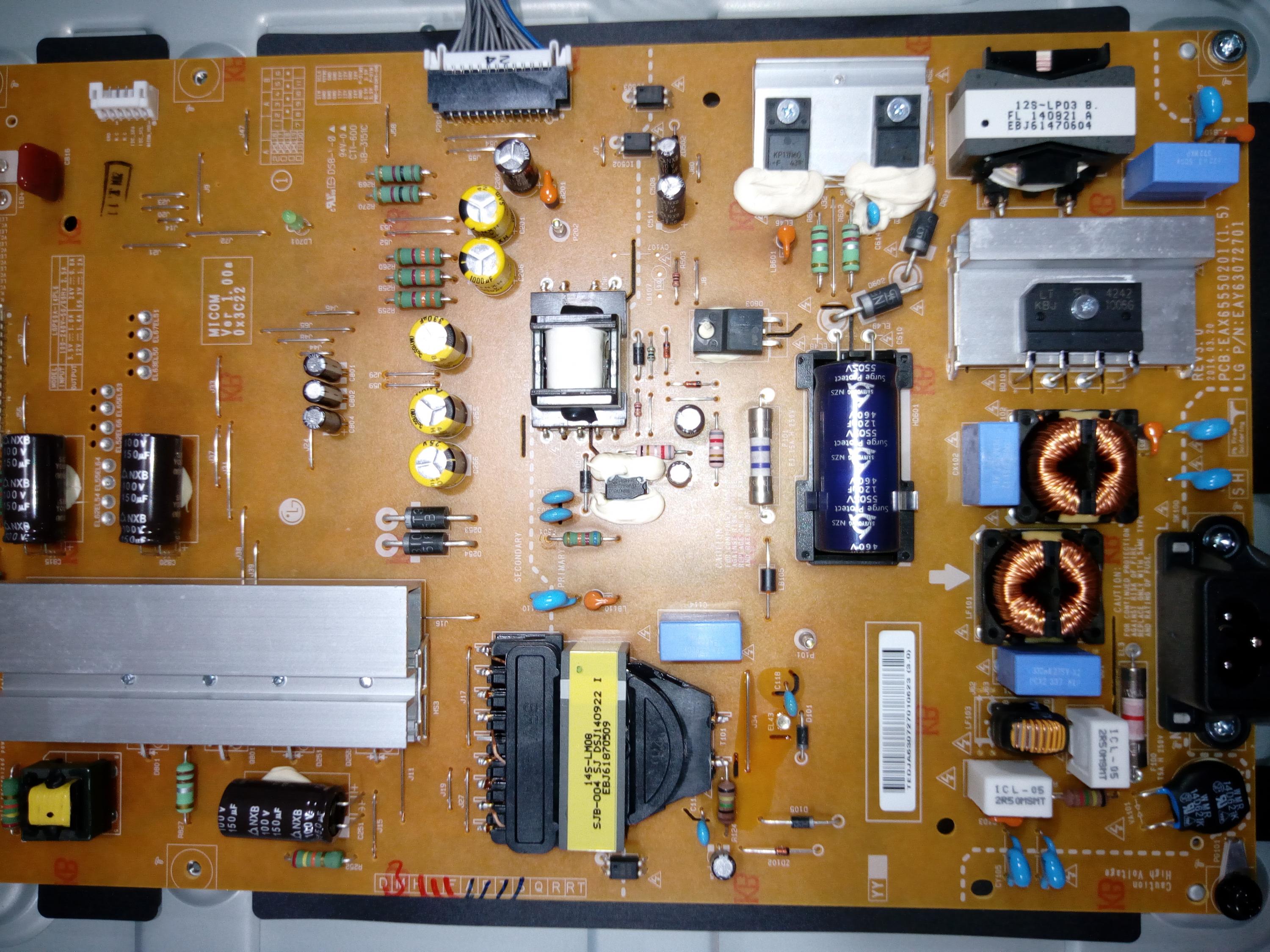

    Any sharp focused pictures of the boards?
    • Steveakus
      • Jul 2017
      • 11
      Re: LG 60LB7100 Intermittent No Backlighting
      If different pics are needed please let me know, thanks

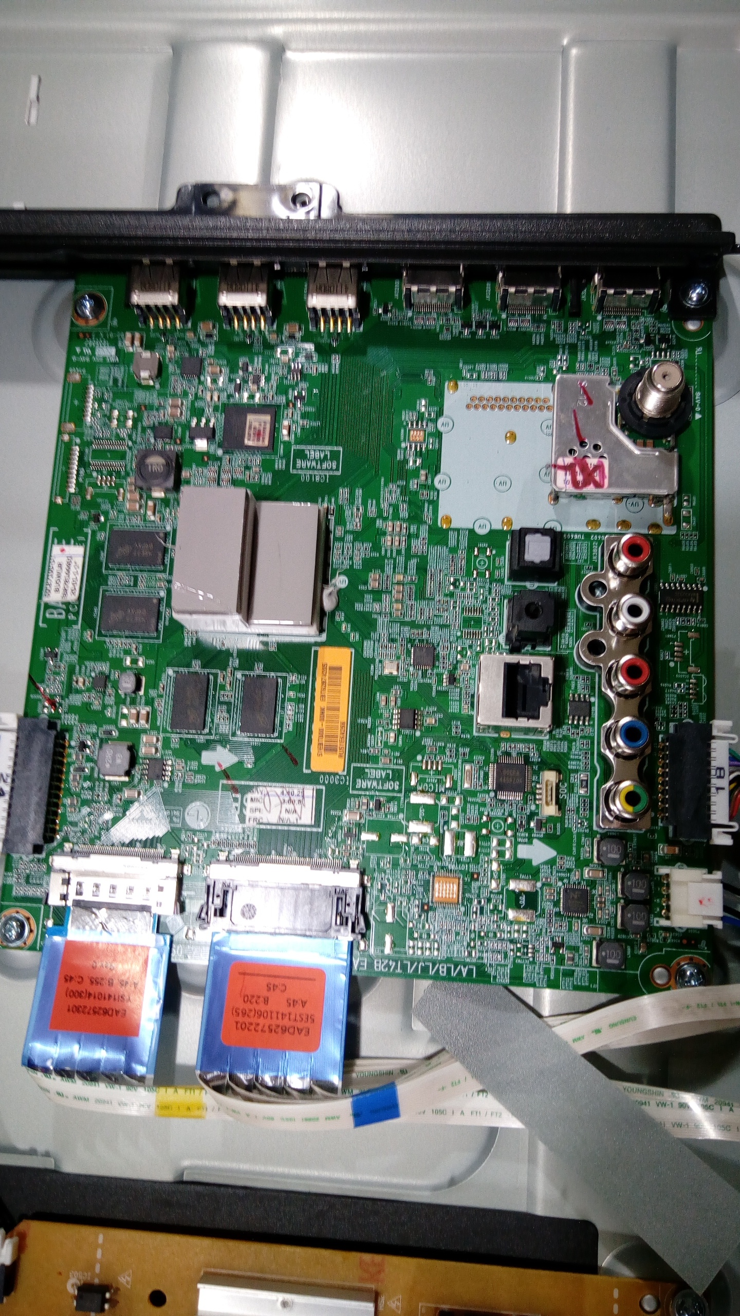

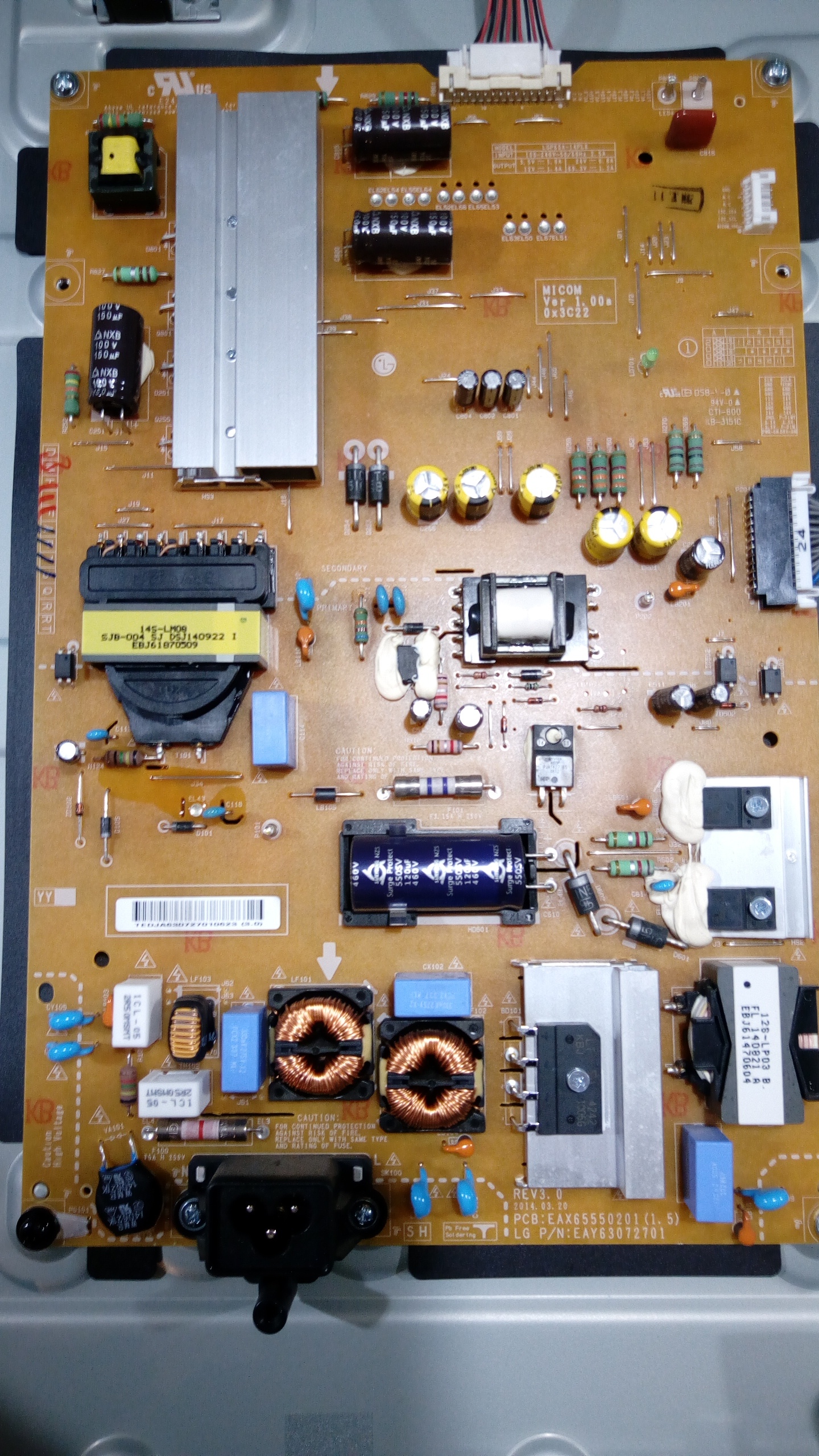

        These may be better pics?
        • dick_barton
          • Aug 2015
          • 6643
          • Wales
          The pictures are not focused well so I can't quite make it out but it looks like the circuit board legend says output (leds) 56.3V at 1.2Amp.

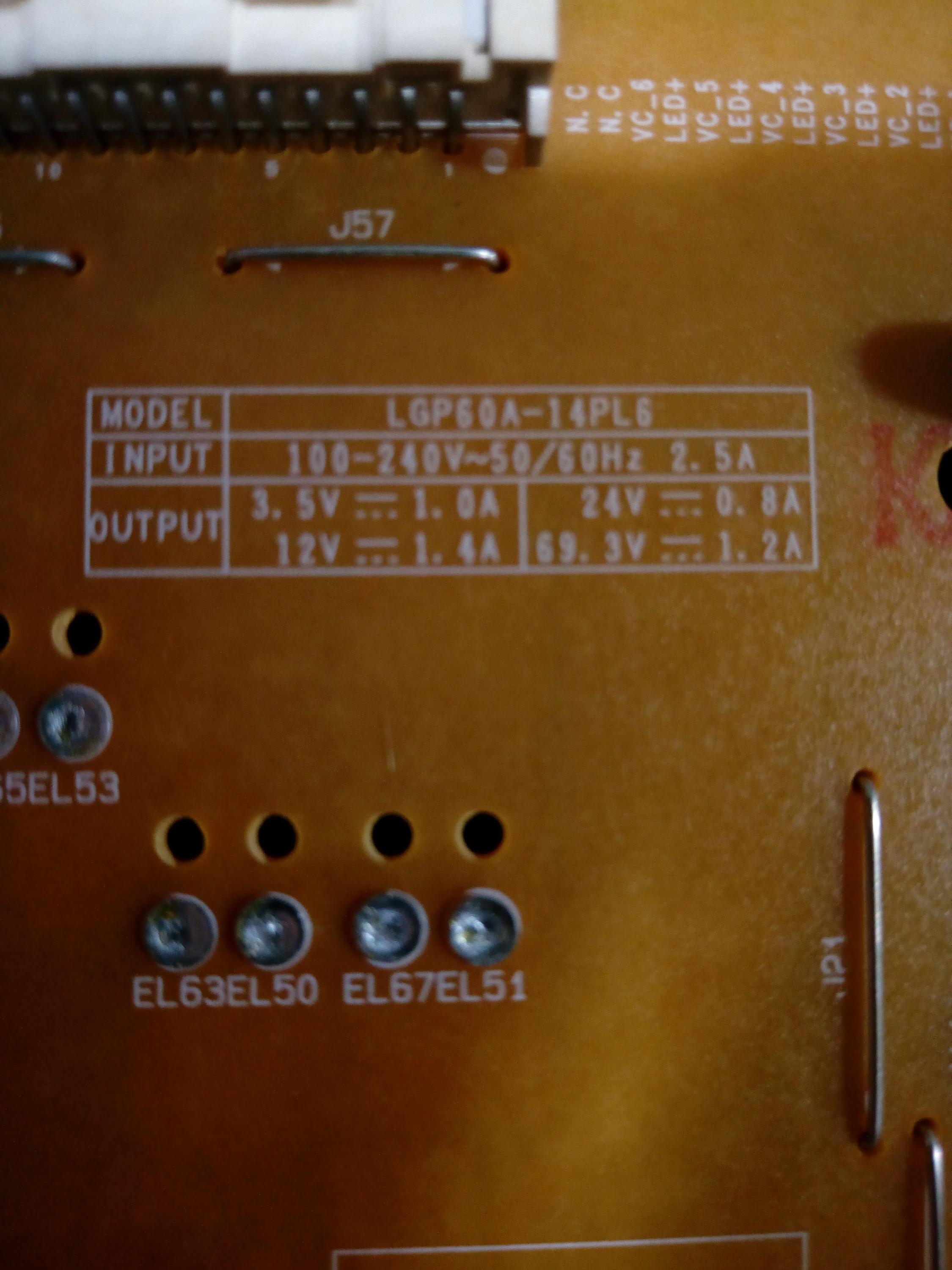

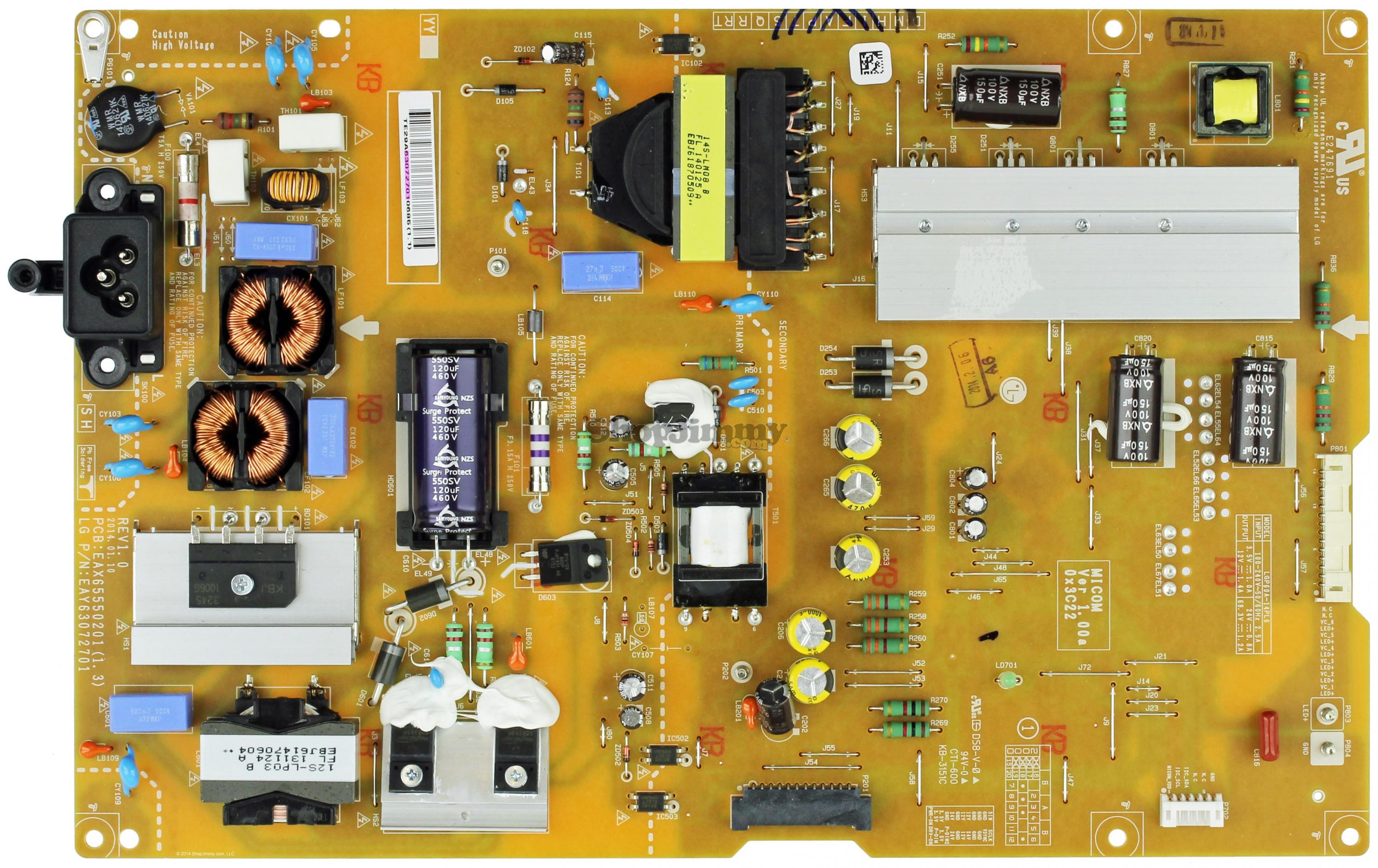

            Here is close up of that legend
            And a pic from ShopJimmy of the same model board just for clarity. I cant seem to get a good enough pic.
