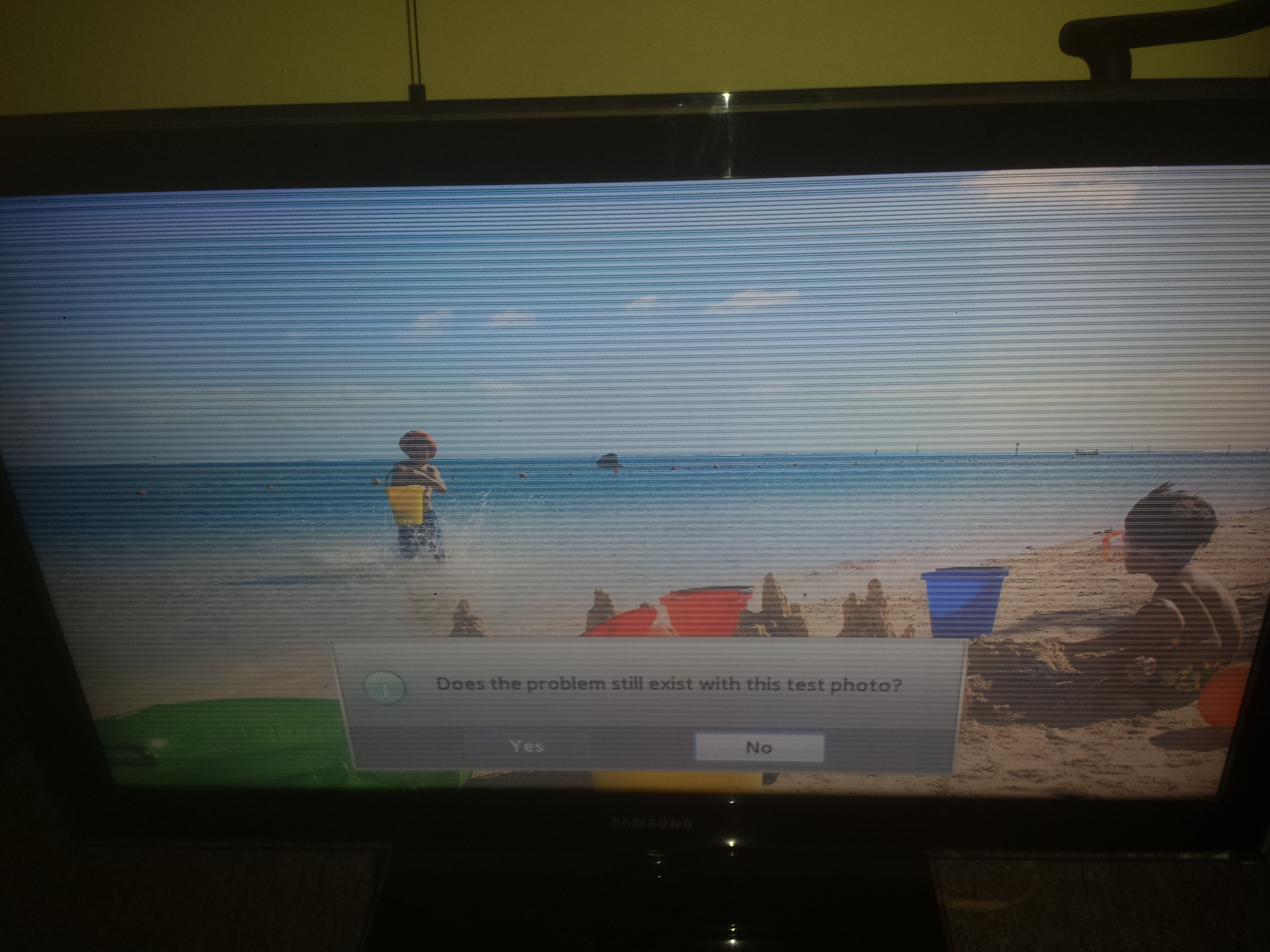

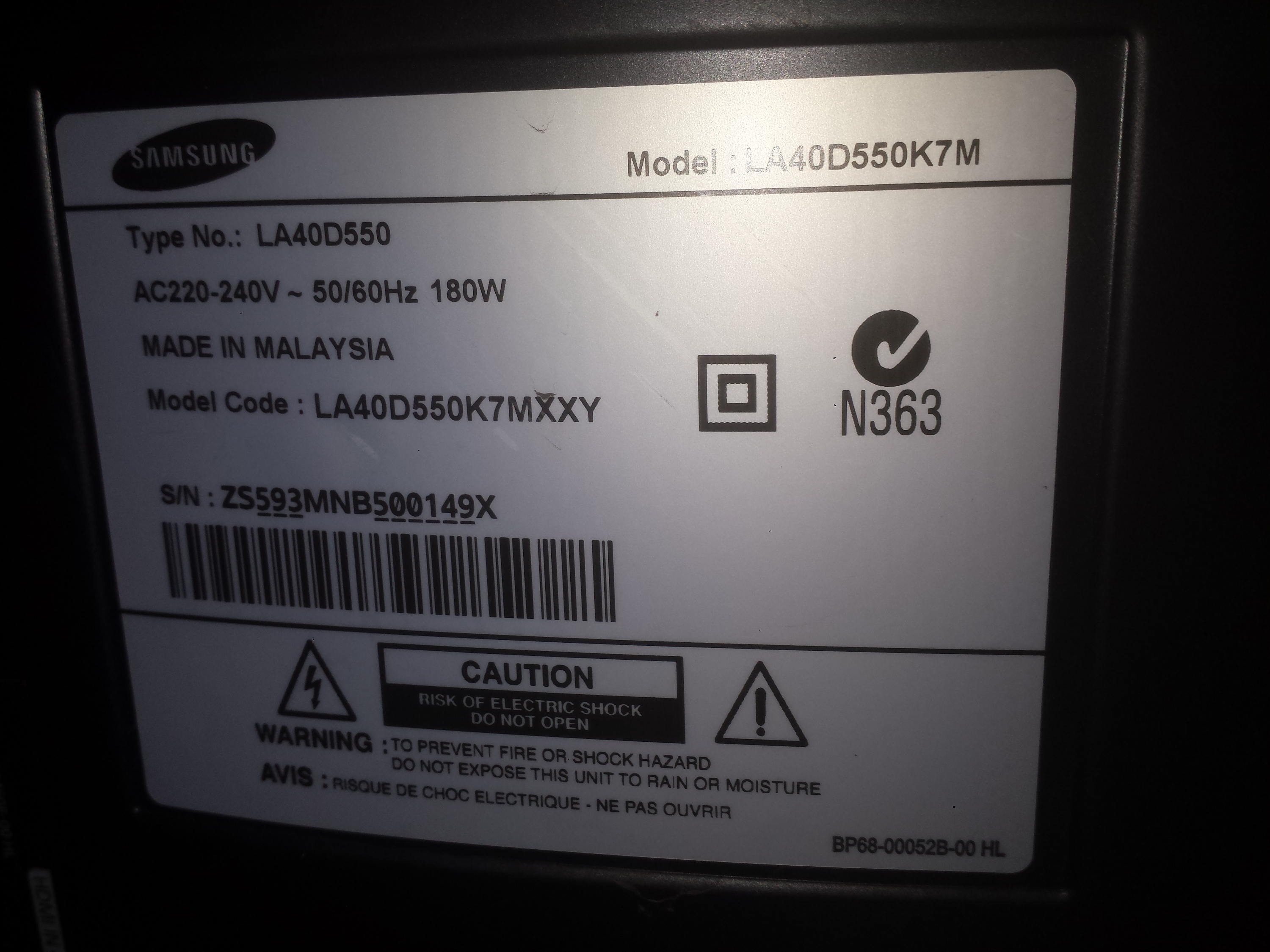

    I am working on this tv at the moment its displaying horizontal lines.

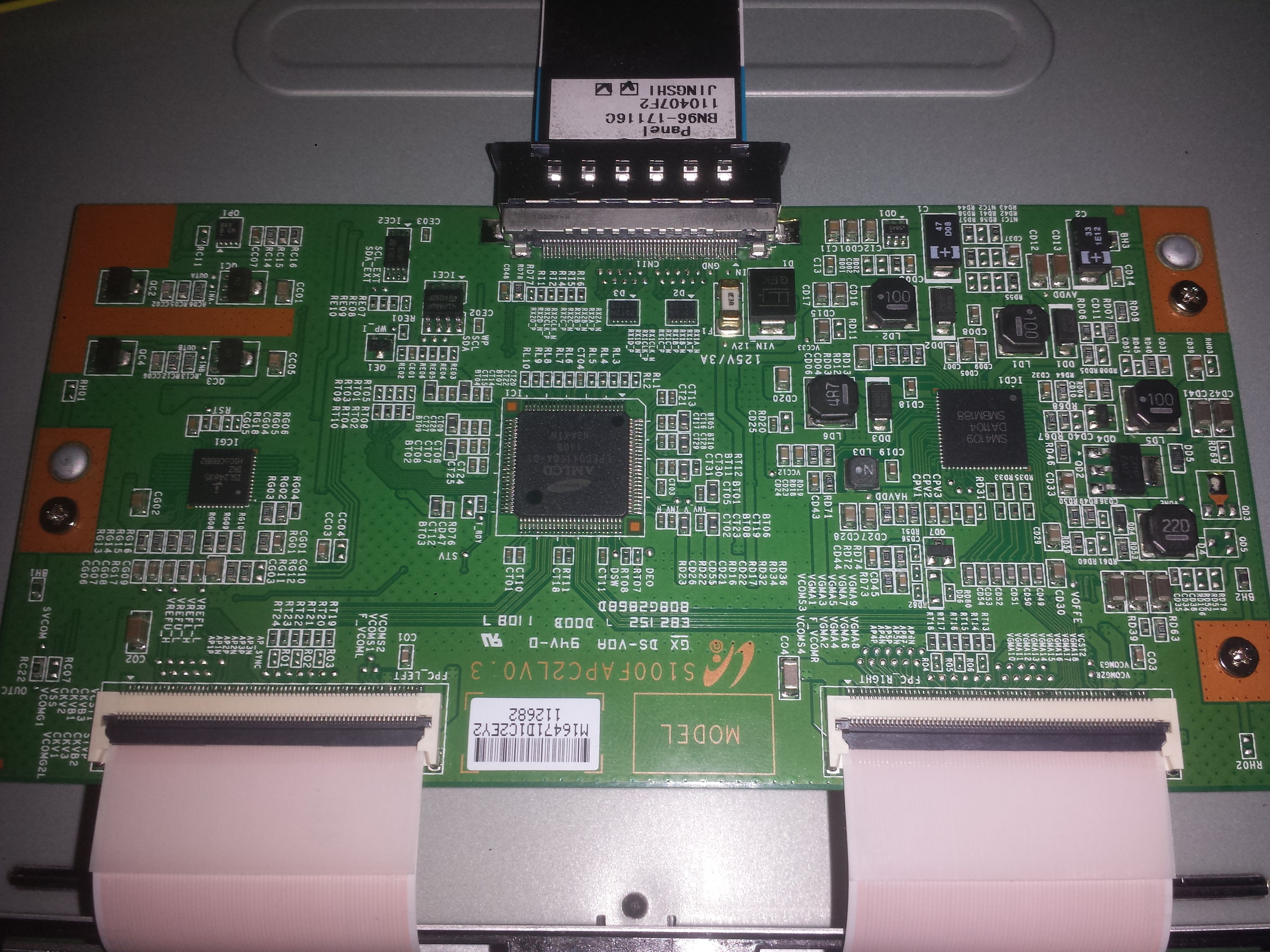

    upon disconnecting the right side ribbon (backside) ribbon cable from the T-Con I get no lines just a perfect picture and half black screen.
    connecting the left side ribbon(backside) I get a distorted picture with lines all over half of the screen and half a black screen...
    Before I toss the rest of this tv out before removing PSU and Mainboard is the panel bad or is it t-con or assuming both?
    Someone fix up the title and add make of tv "Samsung" in front of model I seem to have forgot.

    I would try a replacement Tcon. They don't seem too expensive.

        I would try cleaning and reseating ribbon cable on bad side.

          Dskall cleaned with ISO, no difference same interference.
          Anyone know how to test the t-con what voltages am I meant to be seeing?

            T-con voltages (typical)
            1. Vin (Vcc): 12Vdc or 5Vdc
            2. (Vlogic,LCM, Vddd,VCC): 3.3Vdc
            3. Vda (Vs, Vsource,VDD, Vdda,Avdd): 14Vdc~20Vdc
            4. Vgh (Vgon,VGHR, Von, Vddg): 20Vdc~30Vdc
            5. Vgl (Vgoff,VST,VGHF,VGHEVEN, Voff,Veeg): -5Vdc~-7Vdc
            6. HVDD about 8v
            7. DVDD,VDDC 3.3v, 1.2v
            8. VCOM about 28v

                A pattern of lines can mean t-con or main board.
                • Amraks
                  • Nov 2011
                  • 725
                  Re: LA40D550K7M - Bad T-Con Or Bad Panel

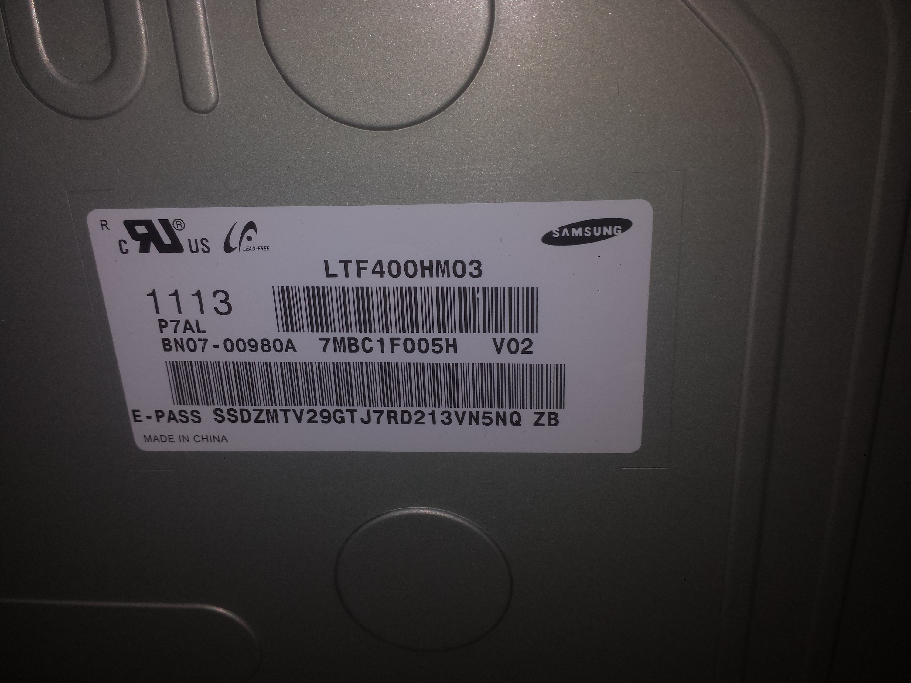

                  It was a bad panel new part is doing the same.
                  I would say this tv is now parts.
