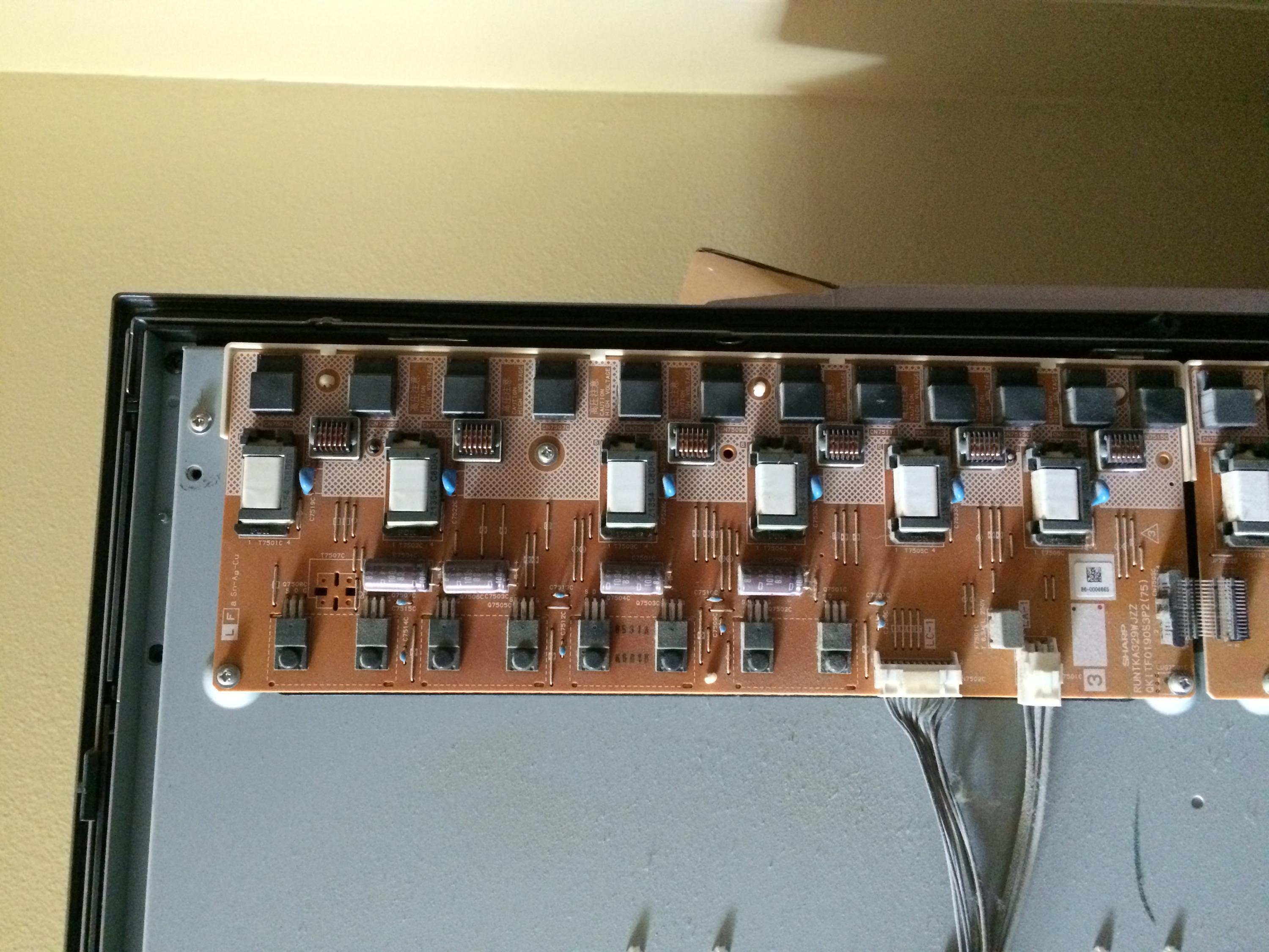

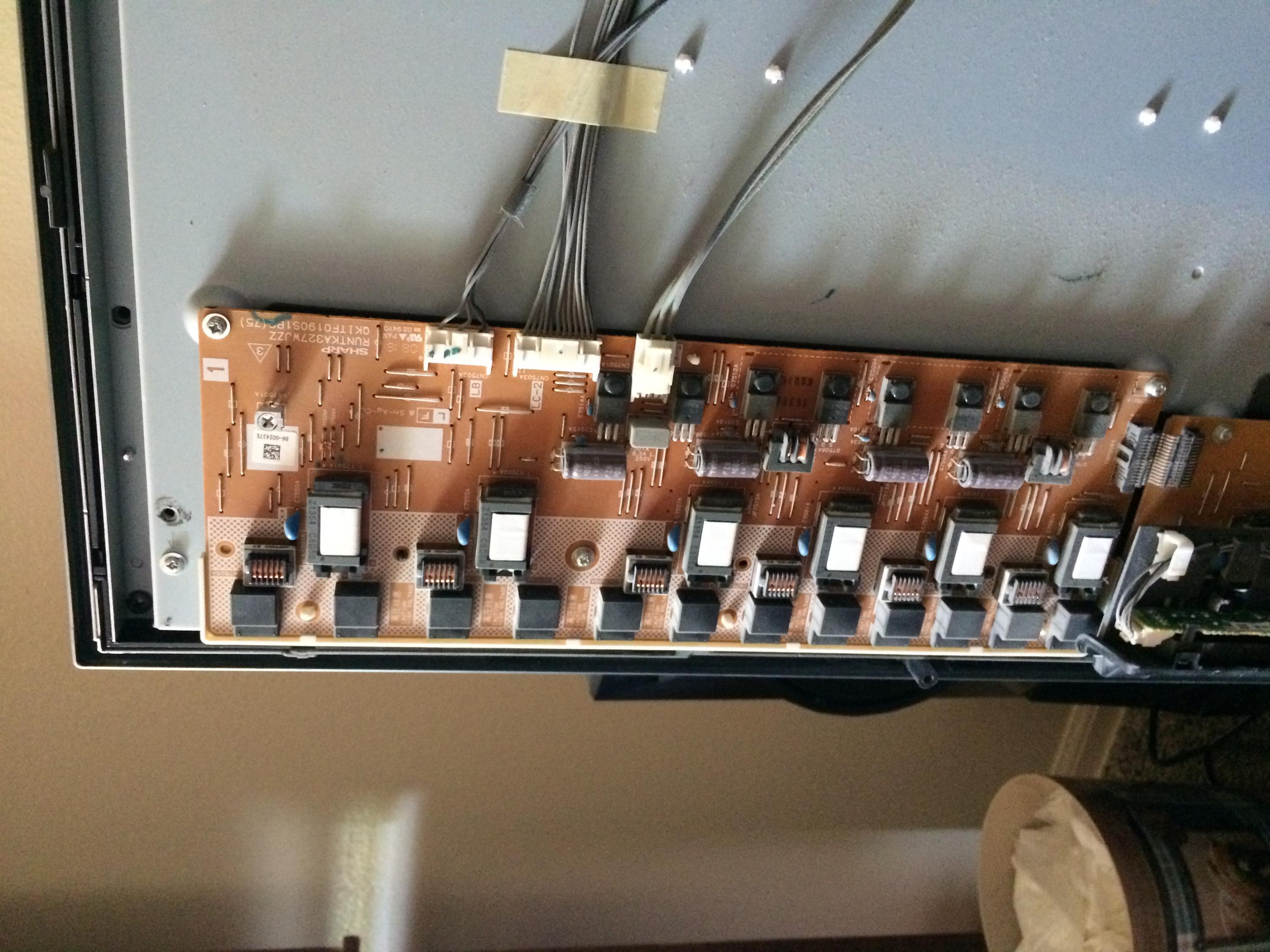

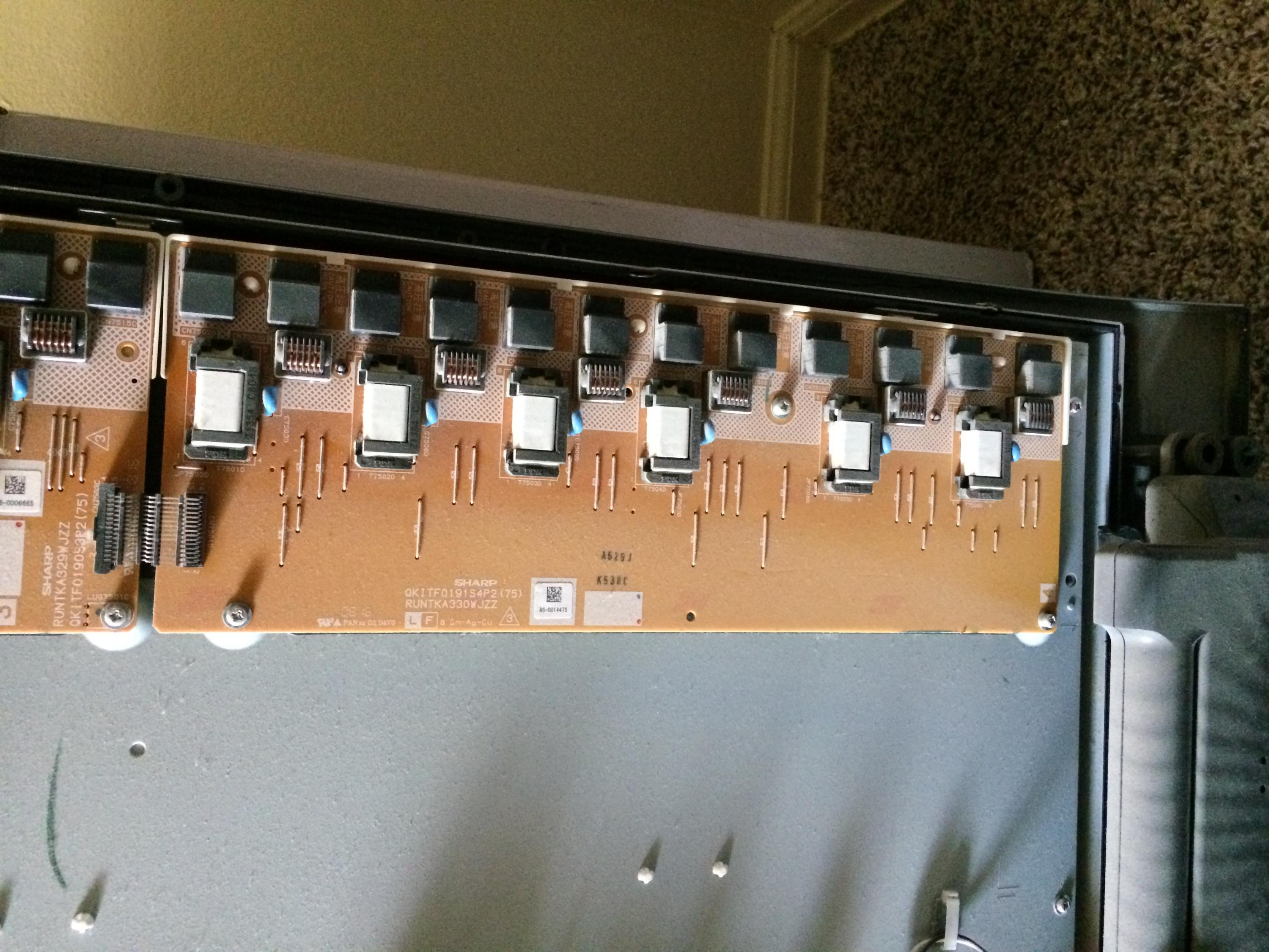

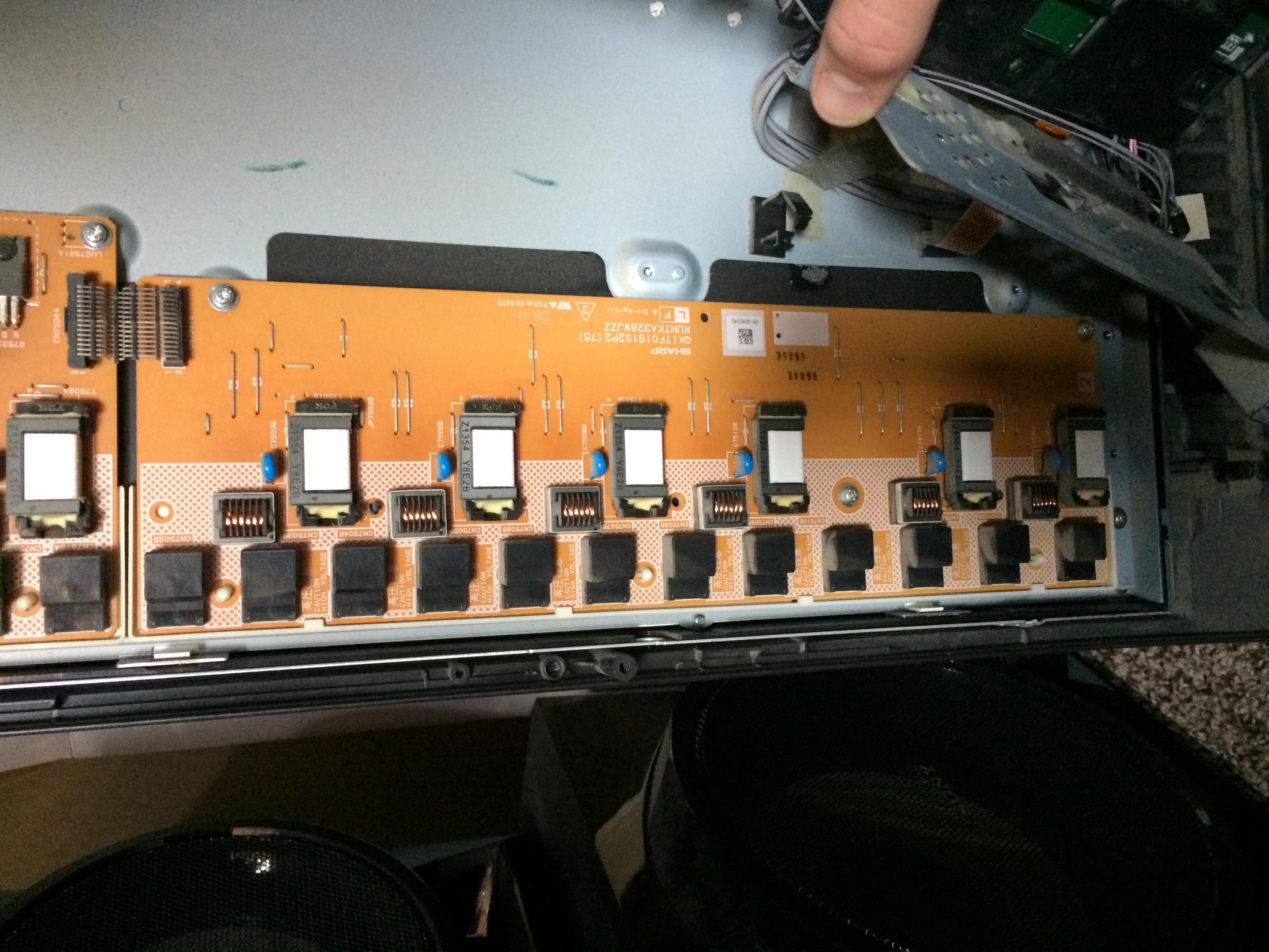

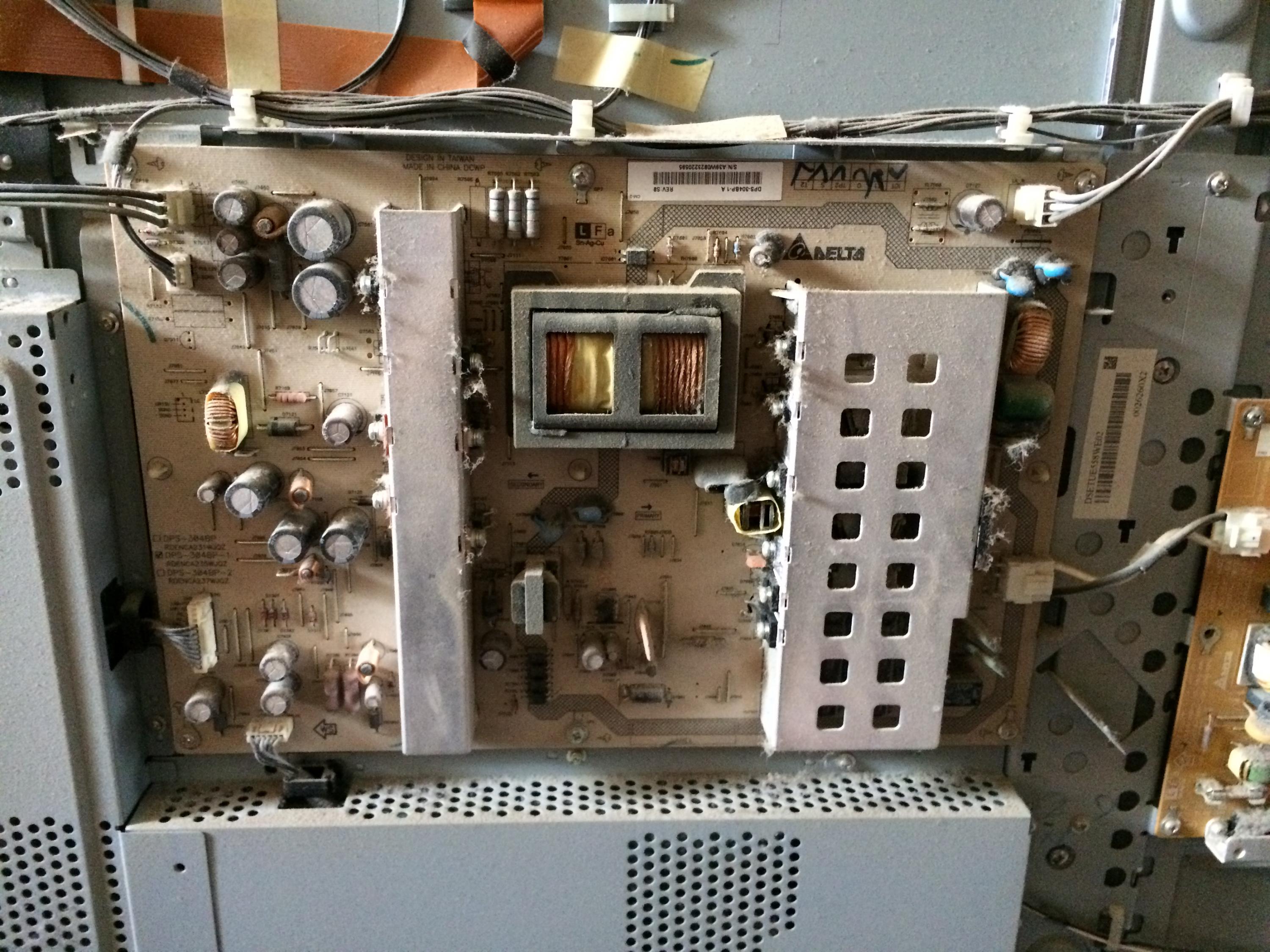

    My sharp lc-52d64u has a flashing green power light whenever I try to power it on. The light flashes once every 1.5 seconds.
    If I hold down [vol-] and [input] when I apply power to the TV I can hear a relay click and the backlight will flash on and off multiple times, as you can see in this video: https://youtu.be/I-J6n2XXWmw. It appears that every other tube isn't lit, as indicated by the dark rows running across the screen. After a few seconds the screen turns off, the relay clicks, and the power LED starts flashing again.
    If I disconnect the inverter board on the left of the TV and leaving the right connected, you can see in this video: https://youtu.be/uRFizk37lwo that the backlight lights up nice and bright and doesn't flash when I power it on holding [vol-] and [input]. It eventually turns off and the TV resumes the LED code.
    I didn't see any bad caps inside the TV. At this point I'm pretty sure I have bad inverter board(s) on the left side of the TV, but before I buy new ones I would like to do some more troubleshooting to be completely sure of the problem.
    I have attached pics of the boards and the service manual can easily be found online.

    Witch the inverter boards disconnected, take your DMM, put it in Ohm's mode and compare the output winding of each transformer. If there is a difference from more than 3%, then the transformer is bad.
    Looks like the inverter on the right side isn't firing up.

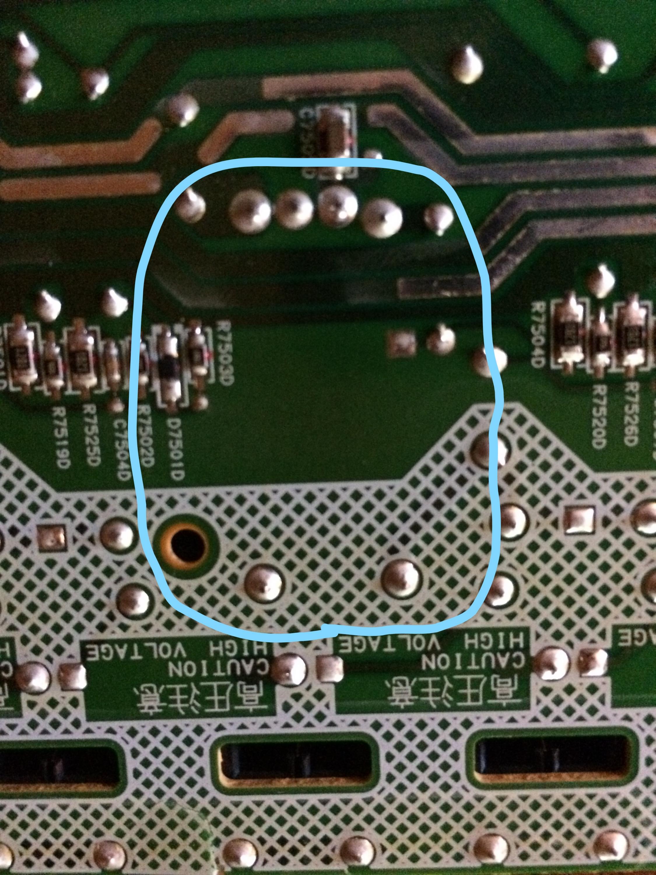

        Hmm, I tested all of the small transformers and they seem fine. I can't find out how to test the bigger ones, which pins should I test? Here is a pic of the transformer's pins.
        • dskall
          • Oct 2016
          • 2905
          • usa
          Re: Sharp lc-52d64u flashing green power LED, won't turn on
          Have those traces gotten hot?
          • Ifixstuff9
            • Jul 2017
            • 120
            I'm sure they have gotten hot during use, but I haven't tried heating them up myself. Now that you mention it, a lot of the traces on the board appear to be in bad shape.

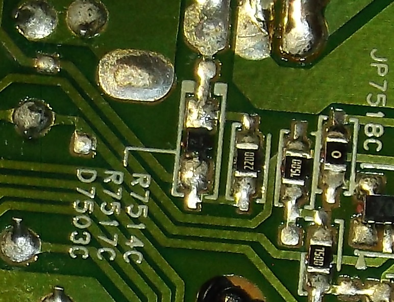

              Any idea what the component in the center of the attached picture is? I think its either a capacitor or a diode, but I could be wrong. It doesn't have any discernible writing on it.
              • cliff_hootarski
                • Jul 2006
                • 411
                D7503c - Diode
                • Ifixstuff9
                  • Jul 2017
                  • 120
                  Ok thanks. Is there any way I can test that diode in circuit? I have a feeling it might be bad.
