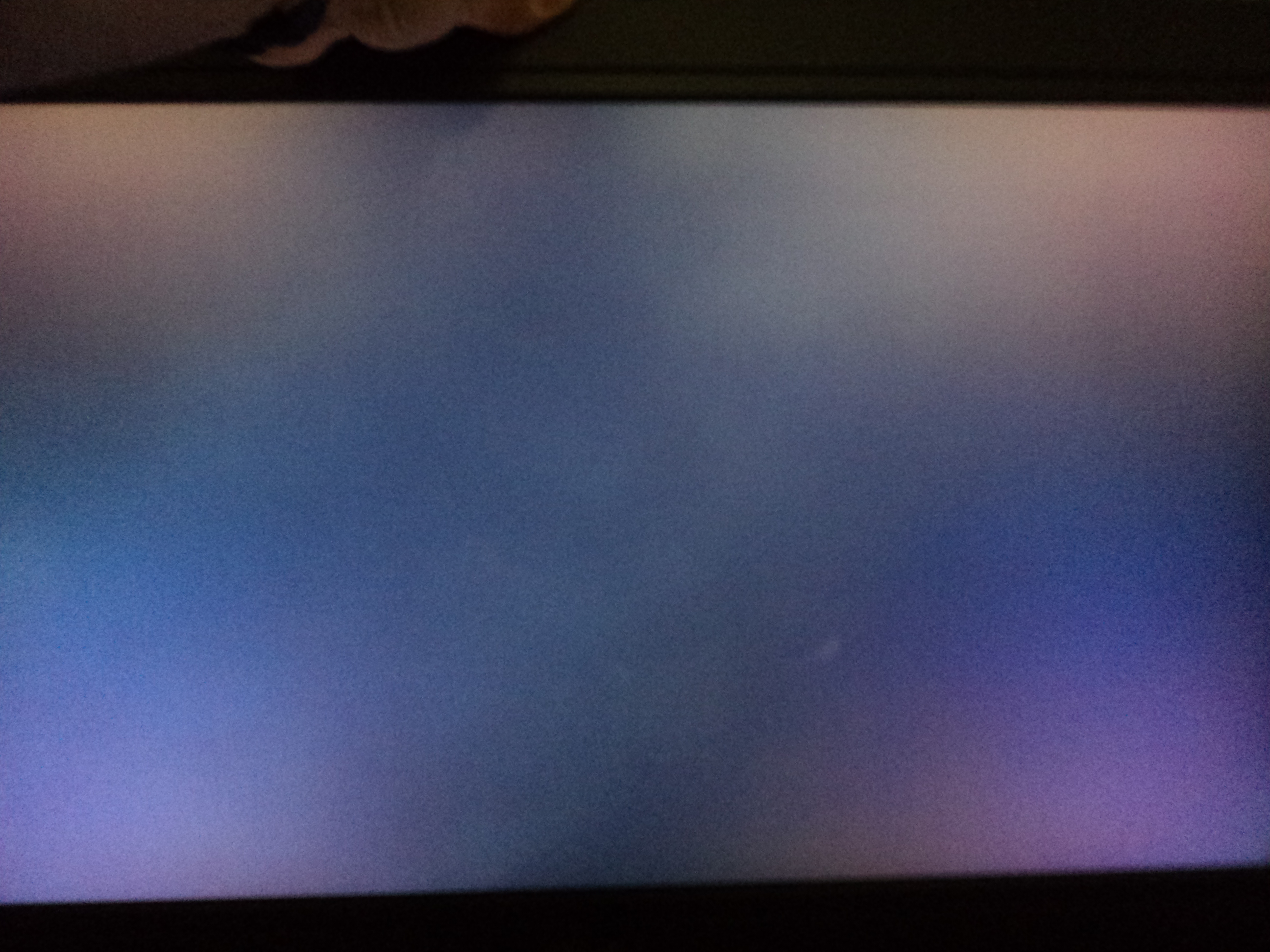

                  Hi attainteddragon;thanks i disconnected 1 ribbon cable and turned on tv and i get Half screen gray half white,i did the other side something, also removed and wiggled one side of the LVDS wire and i had pink and blue,i don't have a scope,is there any component or board i should look over, thanks

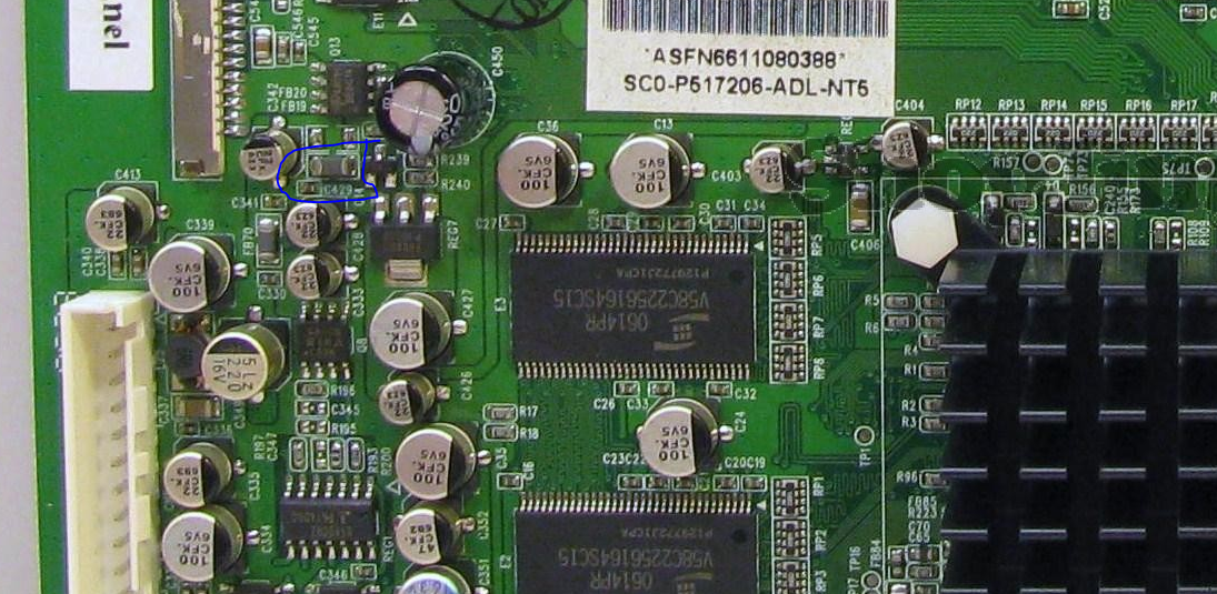

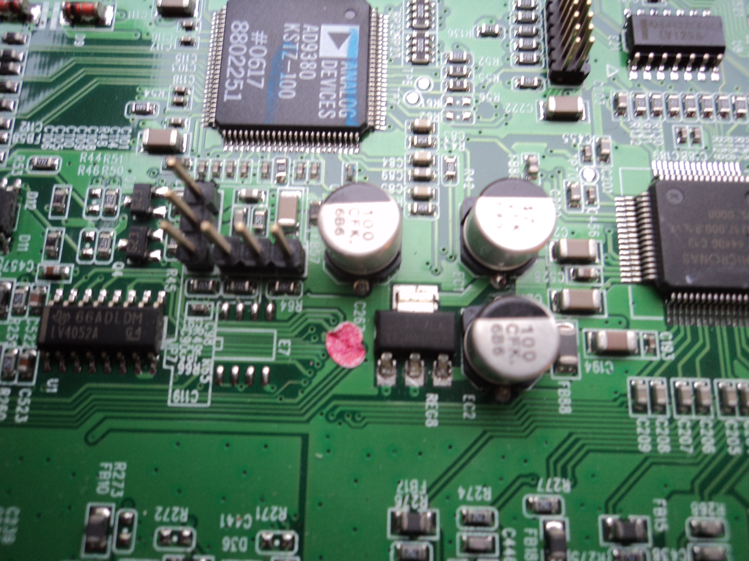

                      Hi guys; today i took out Main board to check it out and i found out this L1117LG Regulator might be bad, i used on diode test
                      Pin 1 to ground 0.000,
                      pin2 to ground 0.000,
                      Pin3 to ground 0.574.
                      Here pics of the part on circuit =L1117LG

                        Re: Olevia 232-S12 no pic
                        You will need to check it for voltage with power on the board
                        • dick_barton
                          • Aug 2015
                          • 6642
                          • Wales
                          Pin 2 is the output so it looks as though you have either a defective regulator or something is shorting the output. I would lift off the regulator and check it and if the regulator appears OK then check if pin 2 solder pad is still shorted

                            Hi guys i replaced the regulator L1117 with this AMC 1117 -F0631j but i think it did not like it cause it blew up a these 2 components,see pic,now the main board is doomed,this is not the board just to let you know the location
                            • jetadm123
                              • 2169
                              The 1117 regulator comes in several different voltage outputs. Are you sure the replacement was the same output as the original? Suggest you remove regulator and check output pad to ground for a short. Actually, you should have done what dick suggested while you had the original regulator off the board.
                                That is inductor (Ferrite bead: FB????), it looks to be for feeding the Voltage to the regulator. You should have checked the resistance on pin 2 and pin 3 pads against GND before installing the new regulator first, then you check it again after installing new parts to make sure you did not have any solder bridges.
                                Right now you have shorts circuit that need to be found first.

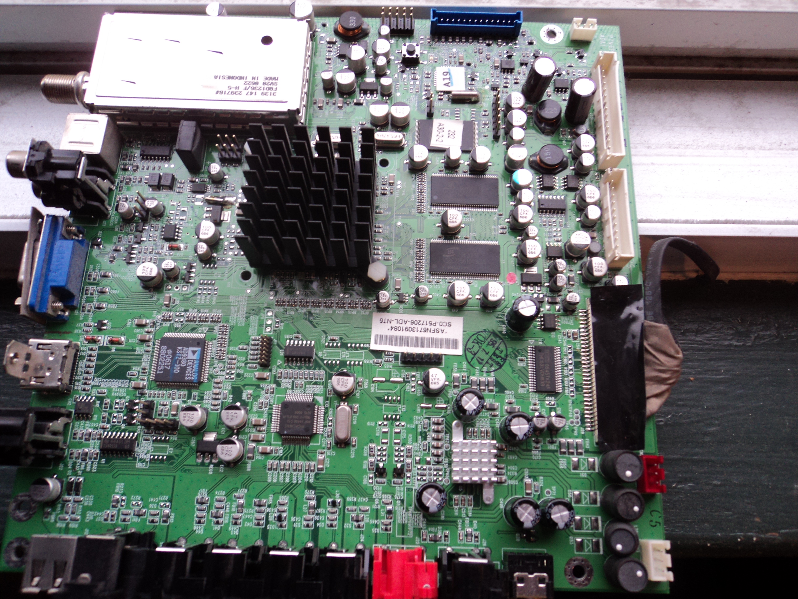

                                    Hi guys ;i've got another main board from Ebay and it does same thing,today i went to test voltages per service manual that downloaded from the site but this service manual misses the schematic for Voltages,but the trouble shooting tree has some tips,.
                                    i have fallowing needed voltages
                                    CN904-pin 7 to Ground =5v,Pin 8=5v
                                    also have main Board Cn 4 - pin 1 to GRD =5v,and Pin 3=5v
                                    CN 5 -Pin2 to Grd = 12V
                                    But i went to check the 12 volts at the T-con board and 12v missing,the fuse is OK,so not 12 v reaches T con fuse,
                                    what does that tells you/ any other advice,i'd hate to a buy a t-con board and waist more money,thanks
                                      if you do not have 12v at the input of the fuse, then it will be the main board. just to make sure, disconnect the t-con and check to see if the 12v comes up or not.
                                      with this replacement main board, do you have your voltages on the regulator position that you replaced on the last board?
