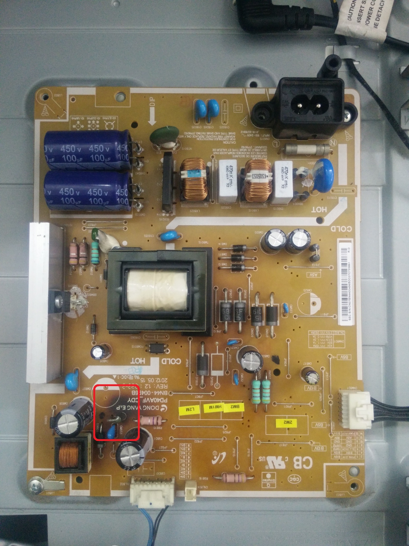

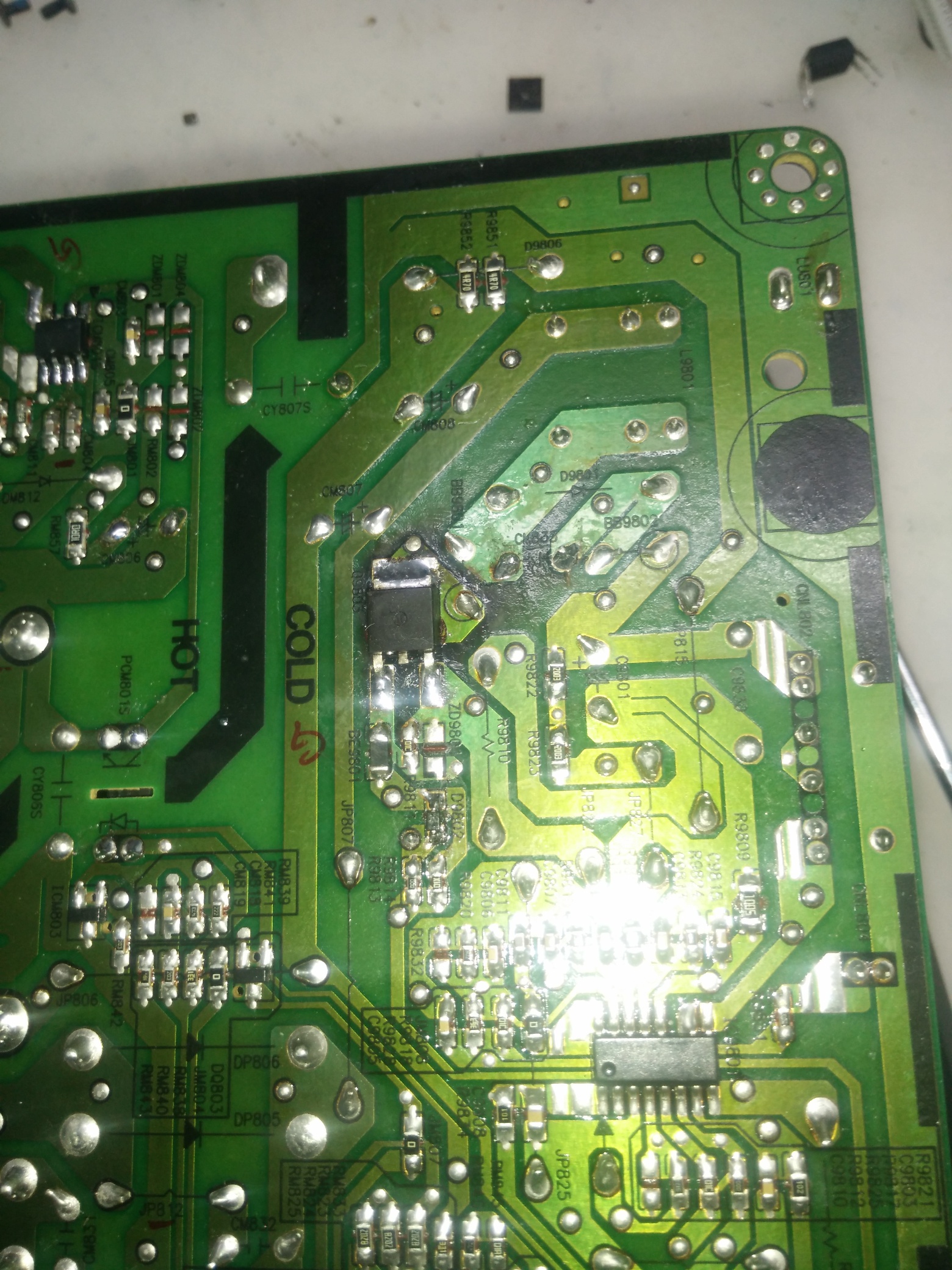

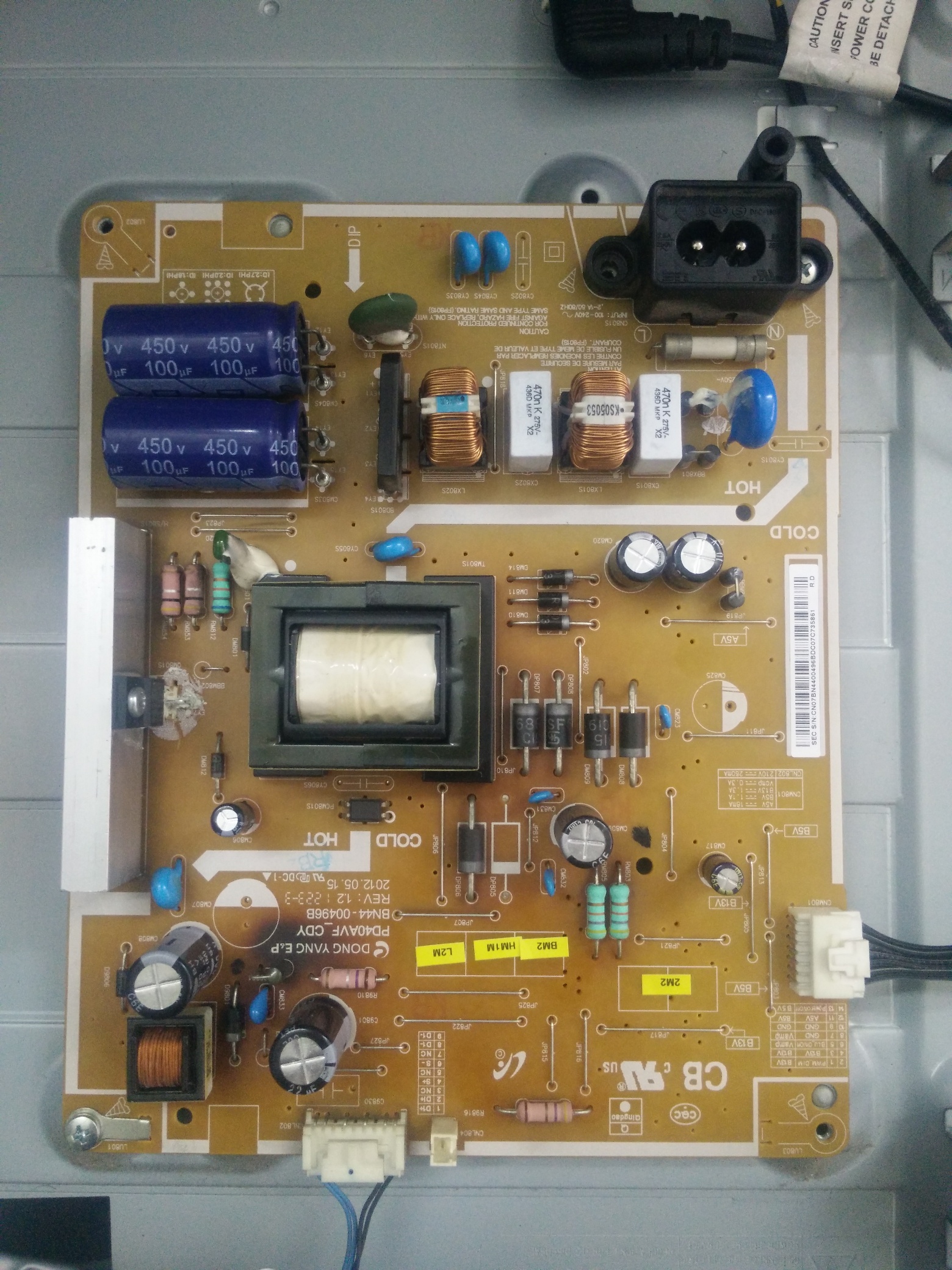

    Hi everyone,
    I have this board, the output here only available 2.2V at the A5V circuit. Definitely this things doesn't powers up.
    B5V
    B13V
    measure 0
    LED connector at D1/DI+ give me constant 90V
    So far, I replace optocoupler as the anode/cathode doesn't give correct reading. Also replace the SSC 2S110 out of trying.
    Can anyone give me some suggestion?
    Also I need the schematic for this board too.
    I am familiar on laptop electronics, but not so much on TV powerboard.
    Mainly repair laptops, sometimes LCD/LED monitors. Also accepts changing/reballing/reflow BGA job request.

    Re: BN44-00496B A5V only have 2.2V
    What has caused the burning up on the circuit board ?
      In the center of the burning up , there is a vertical resistance or maybe an inductor coil , it's not clear . Maybe it has changed of value or open ..

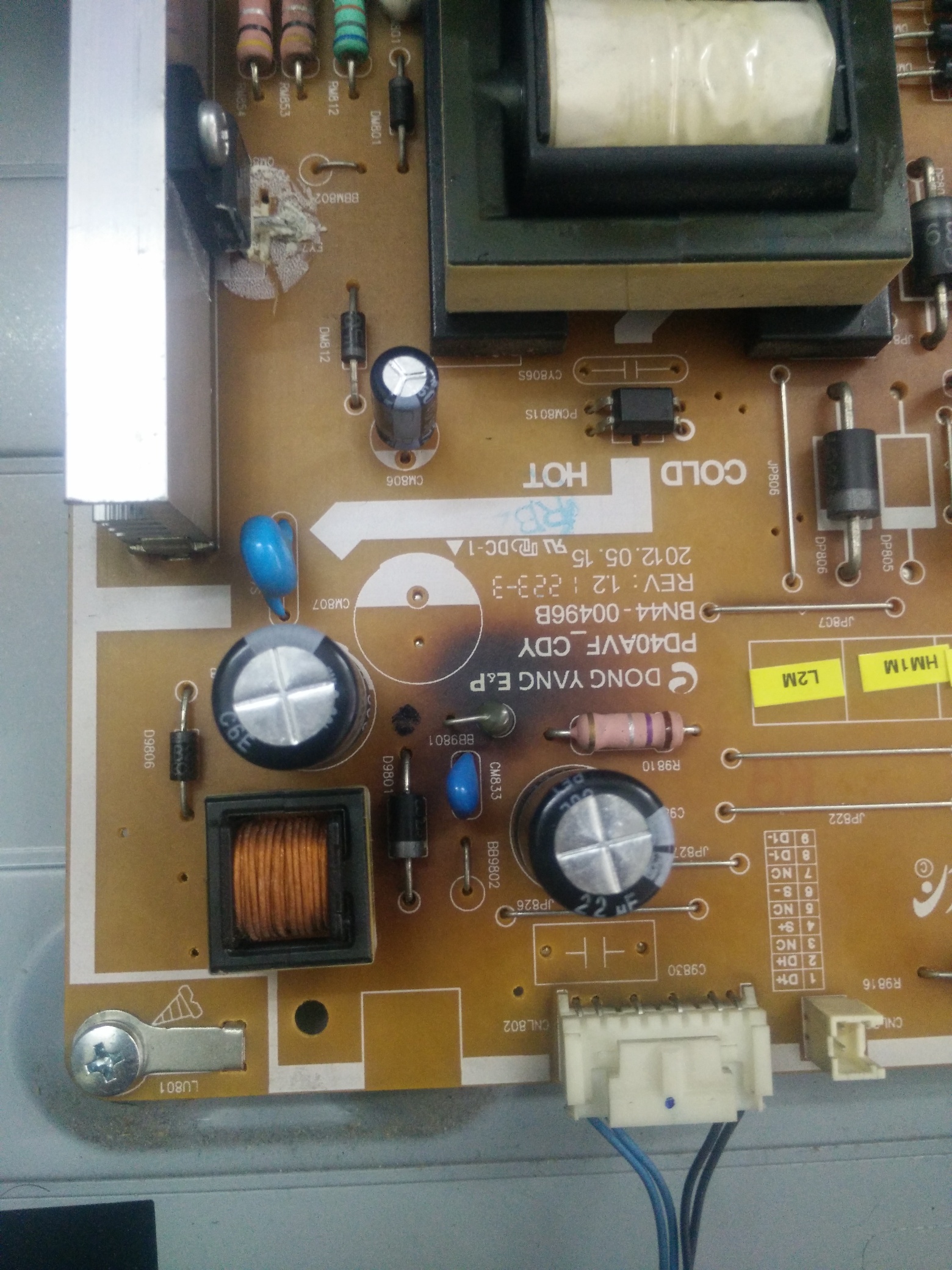

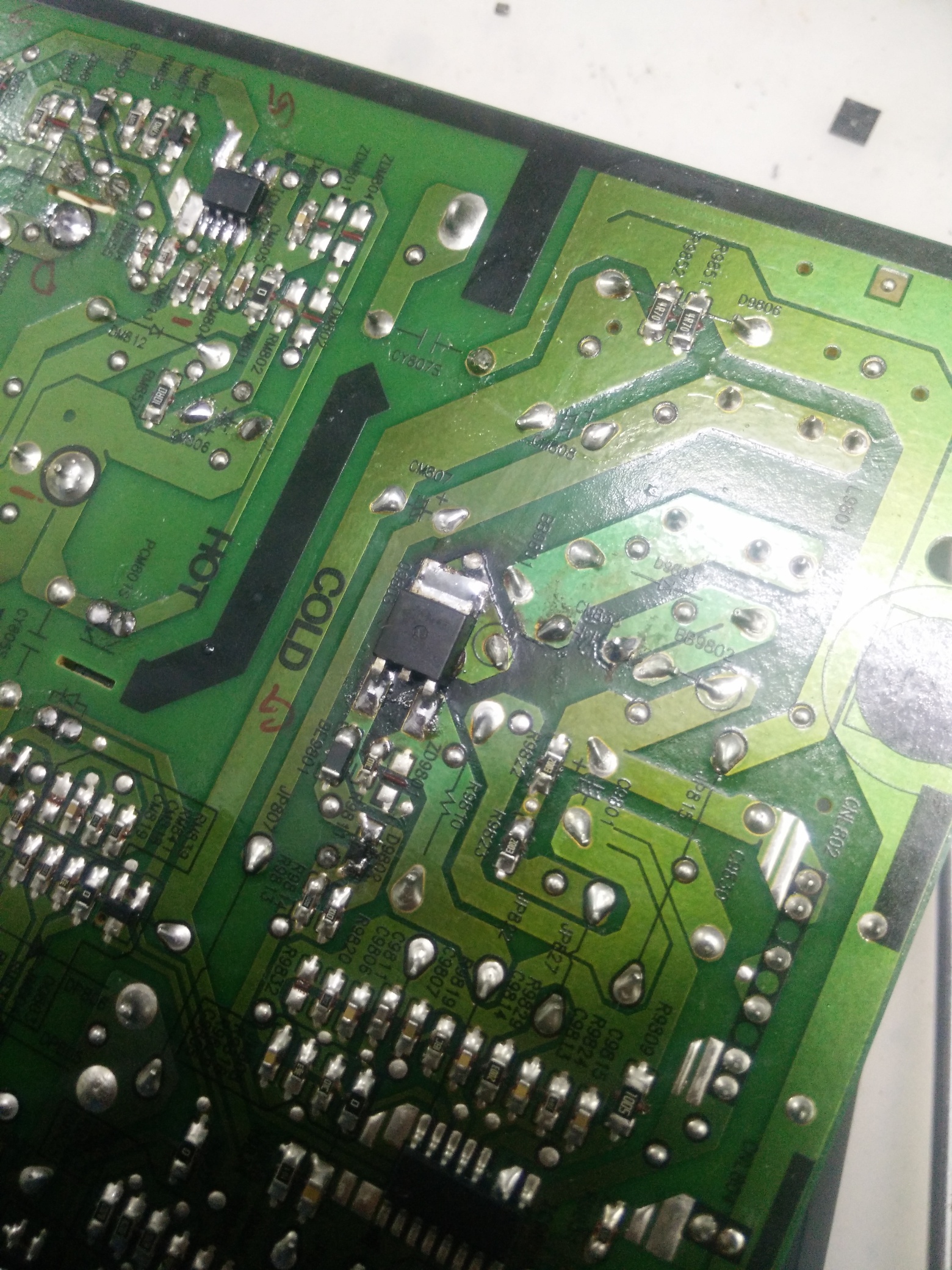

        So far, tested the cap there value sufficient, underneath have a mosfet FDD7N25LZ. I removed and tested not shorted. Here I snap to photo at different angle, the bottom side. The topside burnt is exactly underneath this mosfet.
          You need to clean the solder balls from between the legs of the mosfet tidy up the solder joint of diode D9808 close by the mosfet
          Schematic attached may be similar to your power supply.
            Yes, it's an inductor if you referring to the vertical part. Measure 0.4ohm 0.0uH test frequency 200kHz, so not open. But 0.0uH? Anyway at this writing moment, I just test onboard, didn't remove it. And looking at the circuit, I assume this section is for LED strip power.
            Can clarify, the powering sequence of a tv powerboard?
            I am not very sure the cold side sequence. Is there a standardized sequence as in laptops?
            Sorry for the many questions asked, but trying to grasp the whole idea of a tv powerboard.
              Normally there is one DC supply always available at the output which is the standby supply. This powers the mainboard and when the set is taken out of standby sends a signal to the power supply to switch on all the other DC supplies.
              If you disconnect the mainboard from the power supply what dc voltages do you have at the connector of the power supply?
                Noted, thanks.
                  Mainboard cable not connected to powerboard
                  Only have at CM801:
                  A5V - 2.2V
                  Power on/off - 0.729v

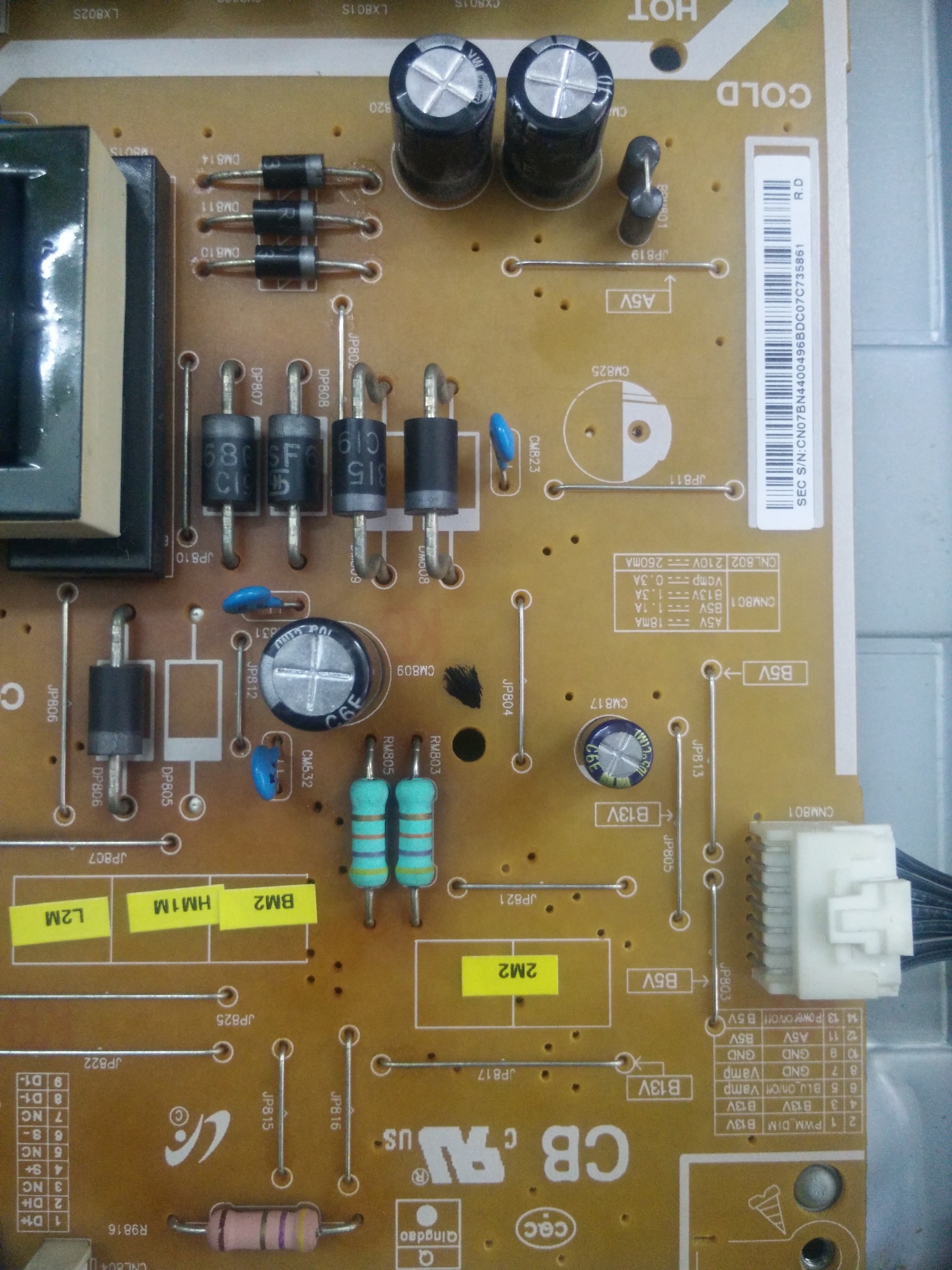

                    Have you lifted one end of each of the 4 diodes that rectify the 5V dc feeding the A5 output. I think they are probably the 4 larger diodes alongside each other. One of them may be leaky. Also test the capacitors connected to them on the A5 line.
                      After studying the schematic, I want to share this 2S110
                      Leg 2 - 1.28v seems normal
                      Leg 4 - 268v seems undervolt (schema shows 308v)
                      Leg 8 - 9.8V seems undervolt again as per schema 15v
                        Thanks, will test those should be the 3 smaller diodes.
                          Check the resistors have not gone out of tolerance RM807, RM808 & RM809.
                          What DC voltage do you have between the two legs of capacitor CM8045
                            What DCV do you right between the two legs of each the main filter caps?
                              Main filter cap 315-317vdc. AC in now is 228v

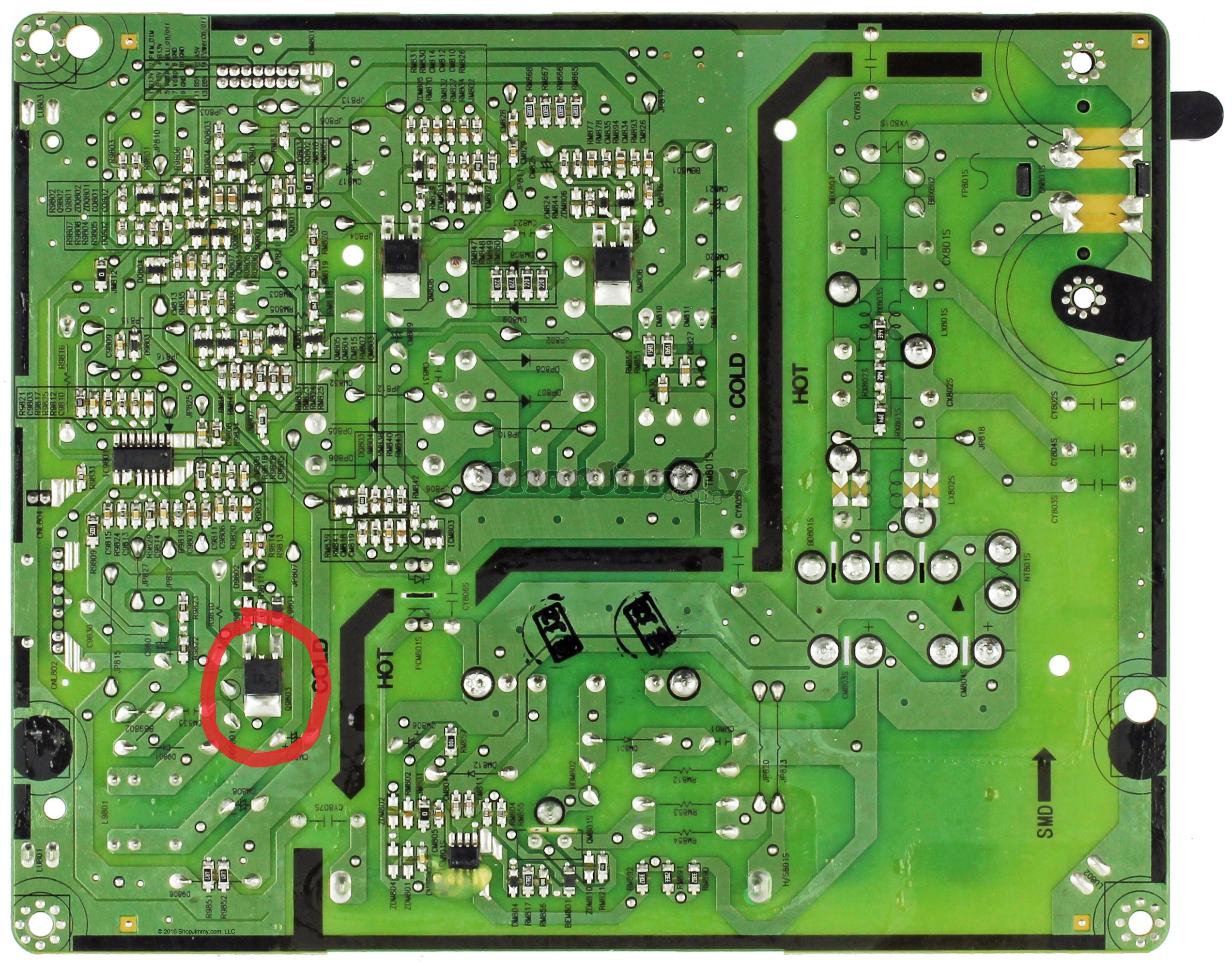

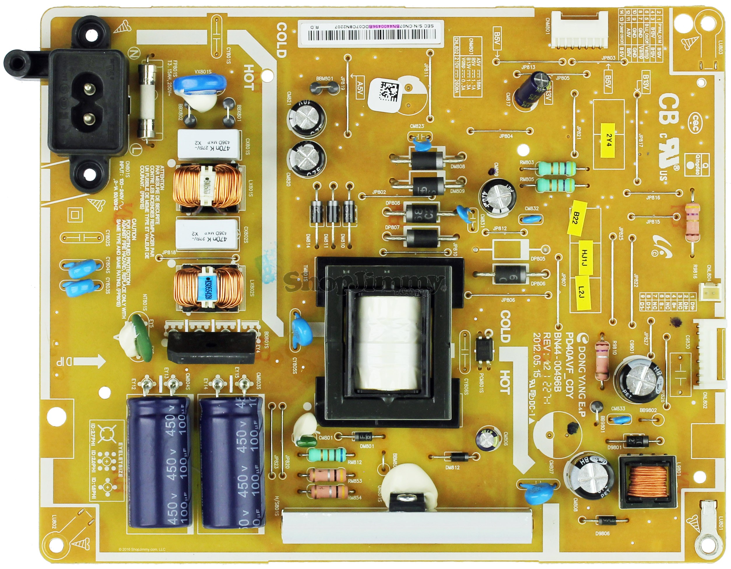

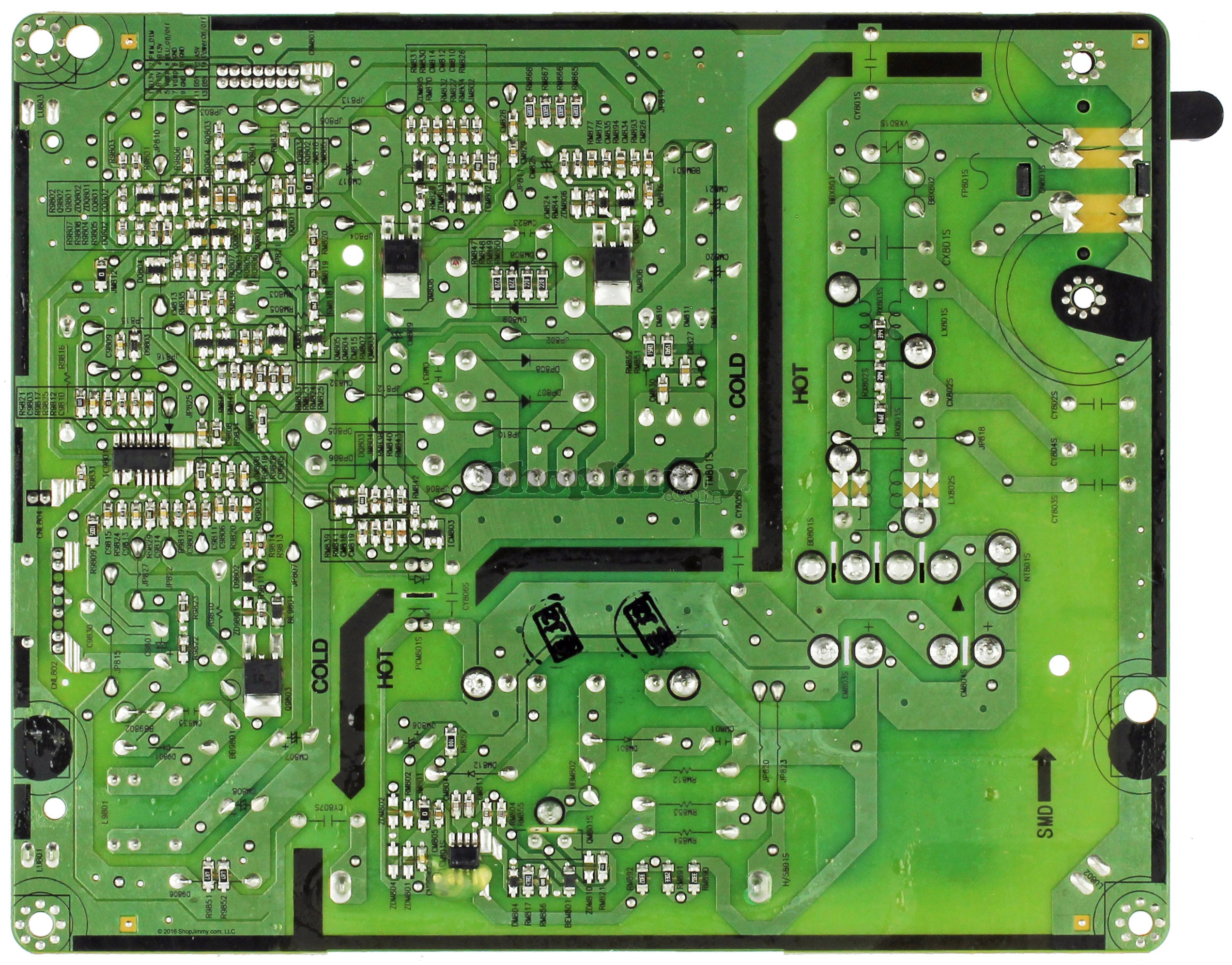

                                Can I get hi-res clear straight shot of the bottom side of the board?
                                BTW, the A5V is only rated at 18mA as printed on the board so it will not take much to load that power supply down, but doubt that is is has that low of the current rating due to fact that the B5V is rated at 1.1A.
                                https://www.badcaps.net/forum/attach...2&d=1497851233
                                Never mind, I found good pictures at shojimmy.
                                http://www.shopjimmy.com/samsung-bn4...pply-unit.htm#
                                Pictures provided by shopjimmy.
                                  It could be a resistance only , and after seeing the mosfet underneath , it is the mosfet causing heat anyway ..
                                    What DCV do you have on the filter cap CM858 for the 13V power supply section?
                                    Also remove L9101 to see if the 5V will come up, if too hard then remove Q9101 instead.
                                    You did check Q9101 Source and Drain resistance to see if has low resistance, right?
                                      I check those 3 smd resistor, 330k, as per printing on chip 3302. Should be fine.
                                      BTW the part code printing doesn't match as per the schematic provided. However the circuit I think should be almost identical, except some values of the ICs could be slightly different.
                                        On this board, this L shoud be L9801. Removed. Still 2.2V at A5V
                                        The filter cap for 13V register 0v. Circuit checked, not grounded.
                                        Q9101, should be the big N-Chan mosfet FDD7N25LZ, measured with DCA meter, seems working. Source and drain, one way register 11.2Mohm, the other way 0 (if continuity mode, no beeping).
