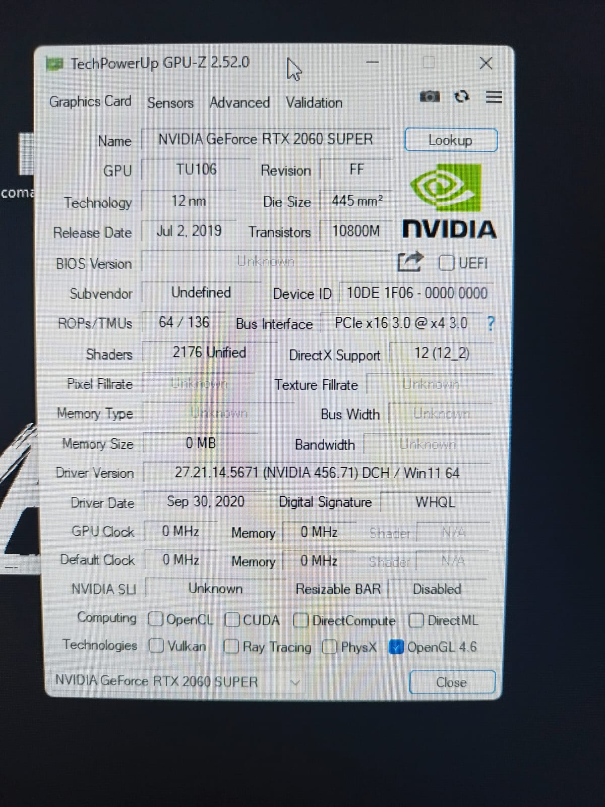

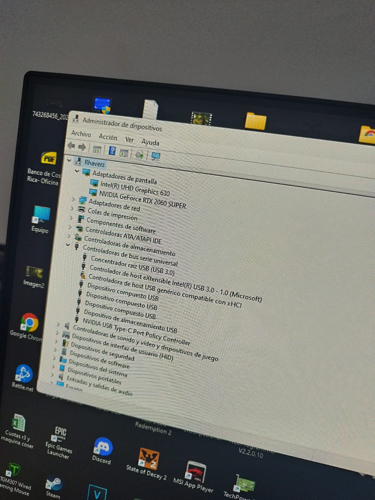

    Good afternoon friends, I have the same problem, the equipment turns on, when I connect it to the equipment and without connecting it to the HDMI or Display port with the integrated graphics of my equipment, the graphics can be displayed in the device manager with an error 43 but even if I try to update it "manually" it manages to remove the notice but it still doesn't work.

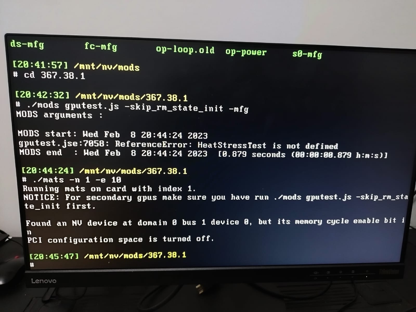

      I have a problem with Mats, when I try to run it it shows me the following error and it doesn't run automatically and if I try to run it manually it shows me another error:

            I used the command that you gave me and it does not perform the test, it shows me the following:
            Found an NV device at domain 0 bus 1 device 0, but its memory cycle enable bit in PCI configuration space is turned off.
            Attached image.
              Re: Asus rog strix rtx 2060s a8g graphics card turns on and does not give video
              Needs newer MODS version.

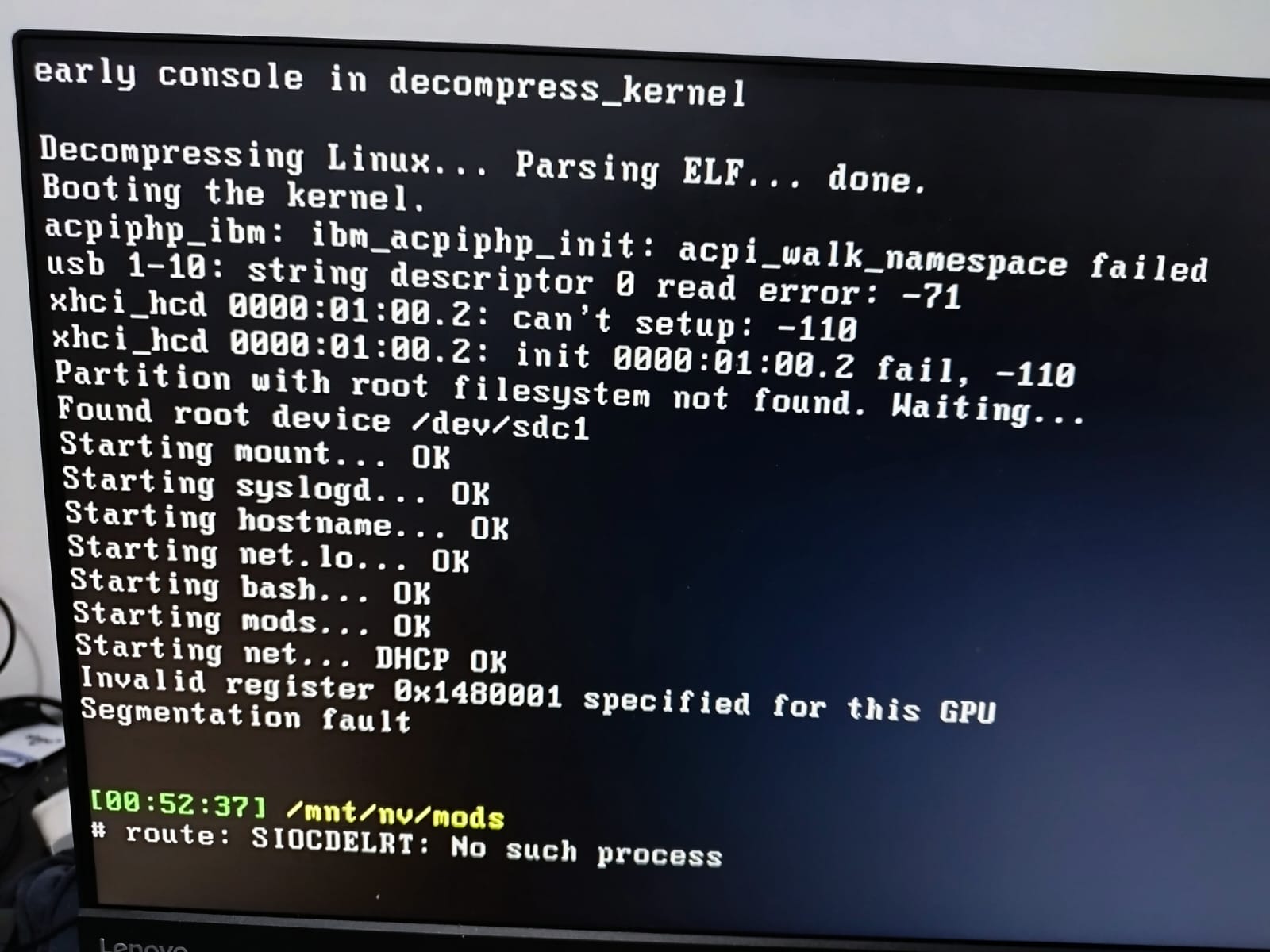

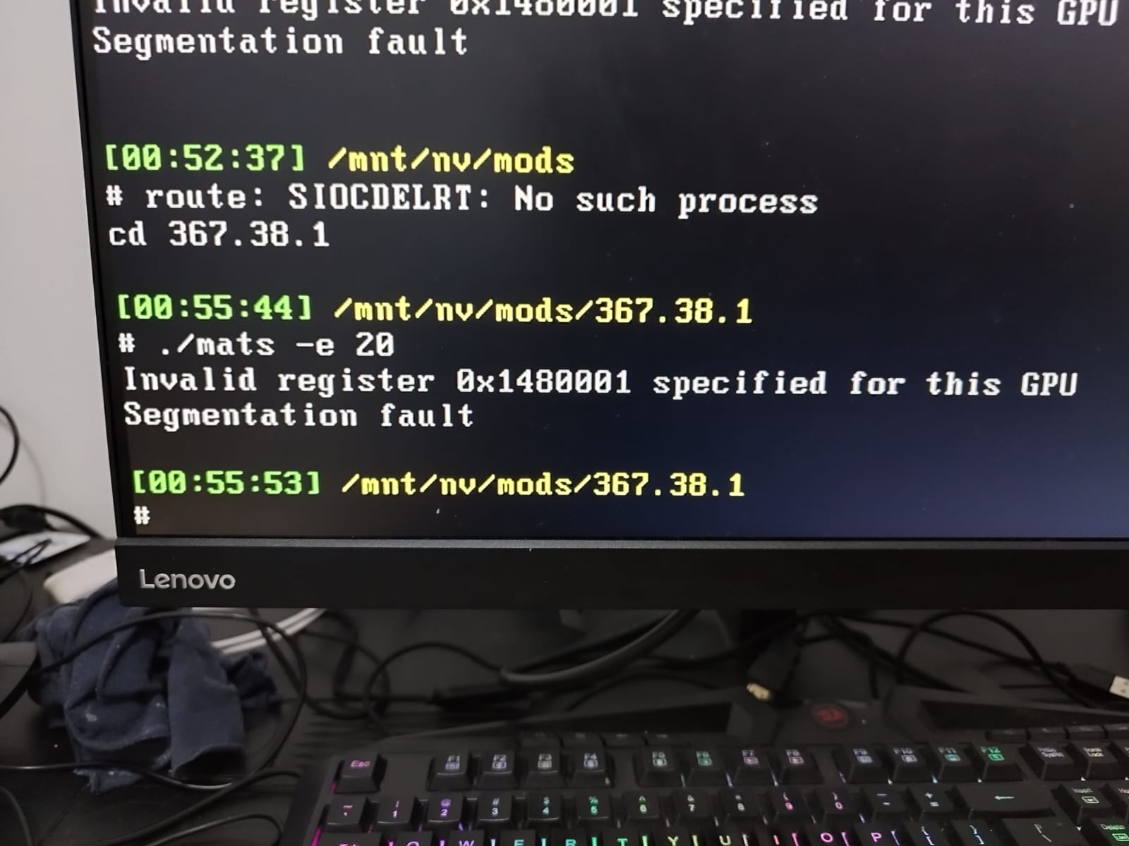

                I am using Mats mods nvidia 400.184, the 400.184 files were replaced, so they are in the 367.38.1 folder
                  https://www.youtube.com/watch?v=esOR...&index=29&t=5s
                  or
                  https://www.badcaps.net/forum/showthread.php?t=84308
                  you need newer kernel

                      I was not successful, I still have the same problem, it does not perform the analysis
