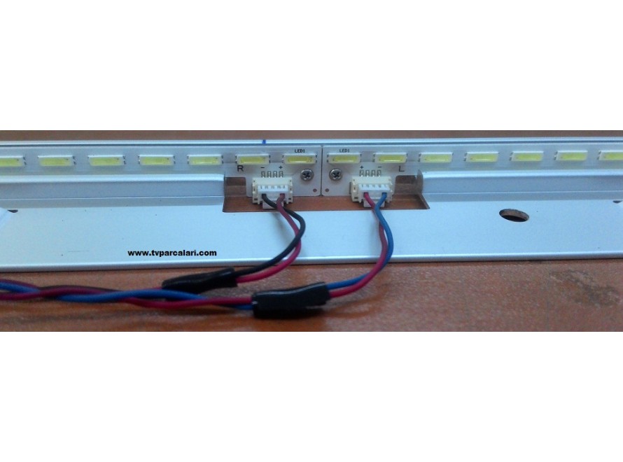

                                  After disassembling the panel, here is what I found:
                                  - There are two LED strips at the bottom of the TV- One for the right half, one for the left half.
                                  - When the TV is powered on, they both turn on. Then the left one turns off (the whole strip). This repeats twice more, then the TV turns off.

                                    So what are you saying? There is only a single line of leds at the bottom illuminating the panel?
                                    Maybe double check all LEDs are lighting, I know when I did a 50" at first glance it looked like they were but it multiple strips and I think 2 leds were out and that was enough to shut that TV down. I did not pick them at first the light was so bright.
                                    sorry if I lead you astray

                                      i normally film it as they light and then go out, then play it back frame by frame to identify bad led's.

                                        Yes- There are two LED strips running along bottom.
                                        Additional photo attached:
                                        https://get.google.com/albumarchive/...OjemaHg_fzArQE
                                        I took video, slowed it down, and although it is difficult to be 100% sure (due to brightness), I do not see any LEDs out.
                                        At this point, I am about 85% sure this TV is going to the trash
