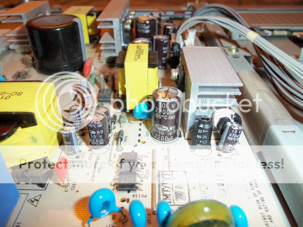

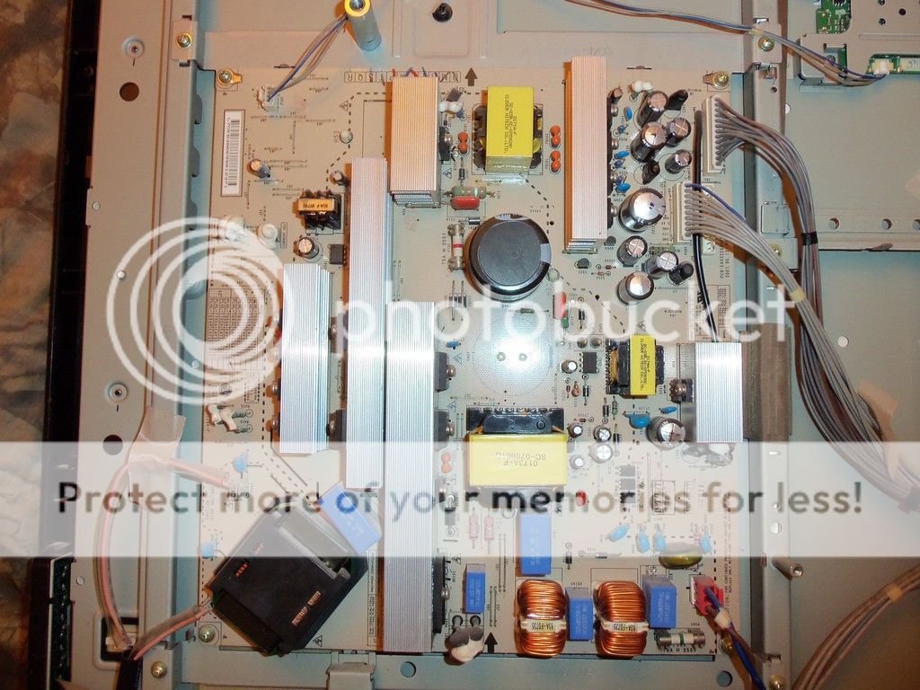

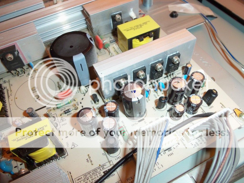

    Apologies if this isnt the correct place for this. This is my first real post here.
    Found myself an LG 37" at the curb today. Did some testing and found it didnt like to turn on all the time.
    Pulled it apart and found 4 or 5 bad Capacitors and im assuming thats the only issue.
    When it doesn't turn on, the green power light flashes 2 or 3 times then flashes red once and repeats. My main question is has anyone come across one of these sets with the same issue? and am i wrong in assuming capacitors are Polarized?
    Heres a few pictures of the Power board. The Bulging/Bad caps as far as i can tell are located at C202,C206,C210 and C217

    I would replace all of the caps apart from the really big mains filter.
    The white side of the caps with the - indicates the negative side. As you can see they line up with a mark on the PCB.

        I plan on replacing them all eventually but id like to replace the individual ones first to Confirm that they are the whole issue..
        How Should i go about locating Individual Capacitors?
        is Ebay a safe place to buy them or do you all have a better source?
        C202,C206 and C217 are all the same parts. (10v 2200uf V0A PET)
        and C210 (35v 1500uf V4A PET)

          I suggest Digikey or Mouser as there are lots of fakes and junk caps on ebay. I use Panasonic FR FM and FC series. Low ESR and good quality.
          I've learnt to never assume, especially when it comes to electronics but considering the visual deformity of those caps and the fact there is power, it's a fair guess to say replacing them should get the TV powering on again.

            You need low esr for these power supplies. The first link was low esr caps the second was for general purpose and not suitable for smps

                    What to look for on power supply caps is low esr, 105c temp, equal or real close capacity uf rating and equal or higher voltage rating

                        I have repaired two of these models. One had C202, C206, C210 and C217 bulged and the other had C202, C217 and C221 replaced with wrong values (assuming they were bulged initially). I would recommend replacement of all the following capacitors.
                        C202, C206, C217, C218 - 2200uF/10V
                        C208 - 2200uF/25V
                        C210 - 1500uF/35V (one tv this value was 1000uF/35V and bulged)
                        C221 - 470uF/10V (can use 35V to simplify ordering)
                        C222 - 470uF/25V (can use 35V to simplify ordering)
                        C226 - 470uF/35V
                        If you order from Digikey, if you limit the search to Rubycon caps, in stock, bulk or cut tape, there will be less options.
