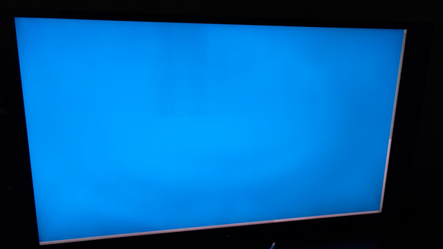

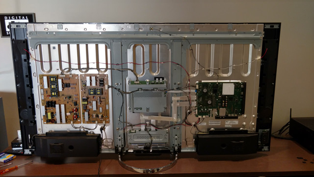

    The problem is that I have a square yellow stain in the uper left corner of the TV.
    That can be seen here:
    http://imgur.com/a/KZoe8
    (big picture with huge resolution taken from my phone, I believe it's better just leave the link to it to avoid polution in the forum)

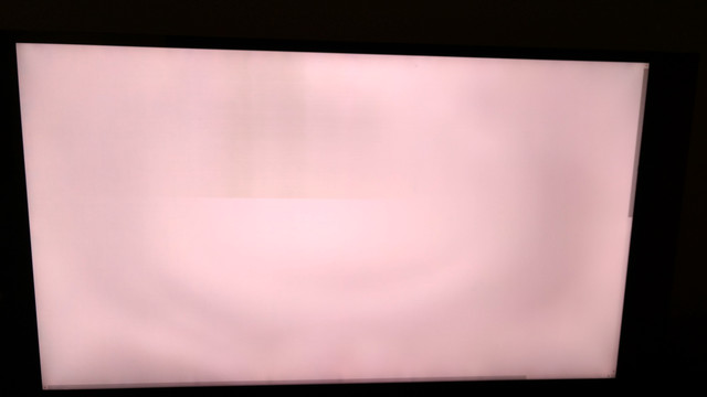

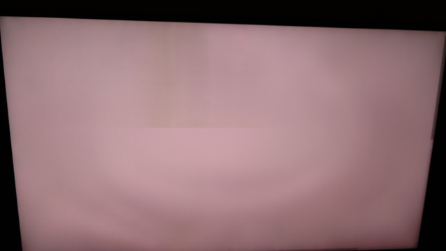

    When displaying a grey background I get a light grey in the entire upper part of the TV and the correct grey image on 2/3 of the image.
    All the problems are way more noticeable when displaying bright images.
    Could this be a bad led tube?
    I can find most of the spare parts of this TV from used sets except for the panel.
    So, unless it's a defective panel I still have hope for this set.

    From what I could see......I think you do have a bad panel.....Post some pictures of the TV with the rear cover removed and one with video signal applied so we could see what is really showing on YOUR screen. There may be a trick or two that we could try to remedy your symptom.

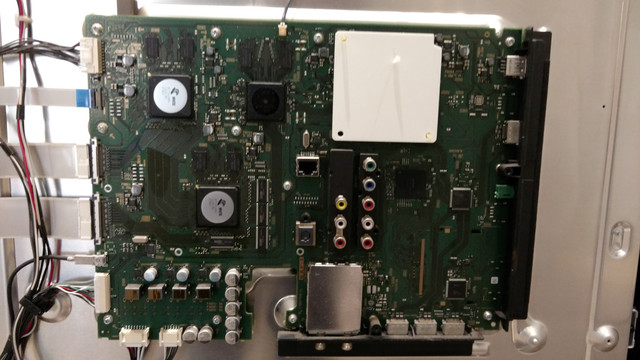

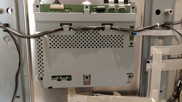

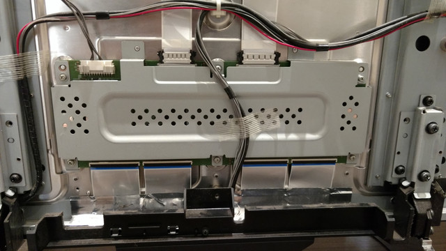

      I'm really sorry for the late reply. I've been to the hospital and fixing a tv was the last thing my health would allow.
      I finally took the pictures from inside the TV and some test patterns to show the problem.
      imageupload
      This tv is too big, too heavy to take somewhere and also here in a small city in Brazil it's almost impossible to find someone to work on it.

        At least do you think it's a panel defect or it could be something else?
        Is it worth still investigating?

          feed in some color bar patterns to help show how the screen responds (lots of known test patterns can be found on dvd special features and in computer file to generate of a computer). Odds are high it is a panel issue BUT depending on the makeup of the panel, some can be saved by removing the tab drivers on the troubled side of the set. Not sure about this sony. Look for tab bonded flex cables along each side.... don't try to do anything just yet other than look. Provide pictures of what you find.
