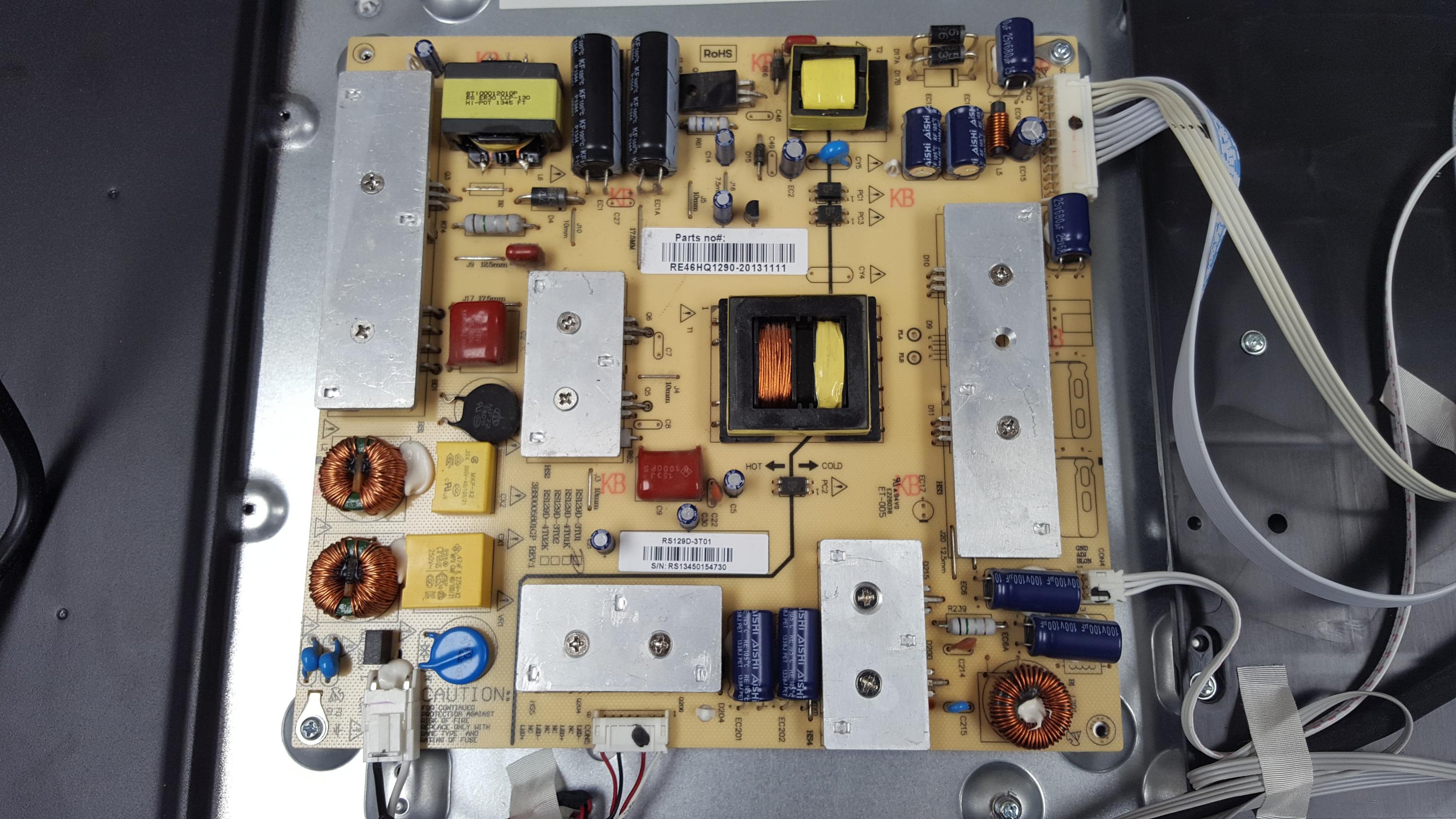

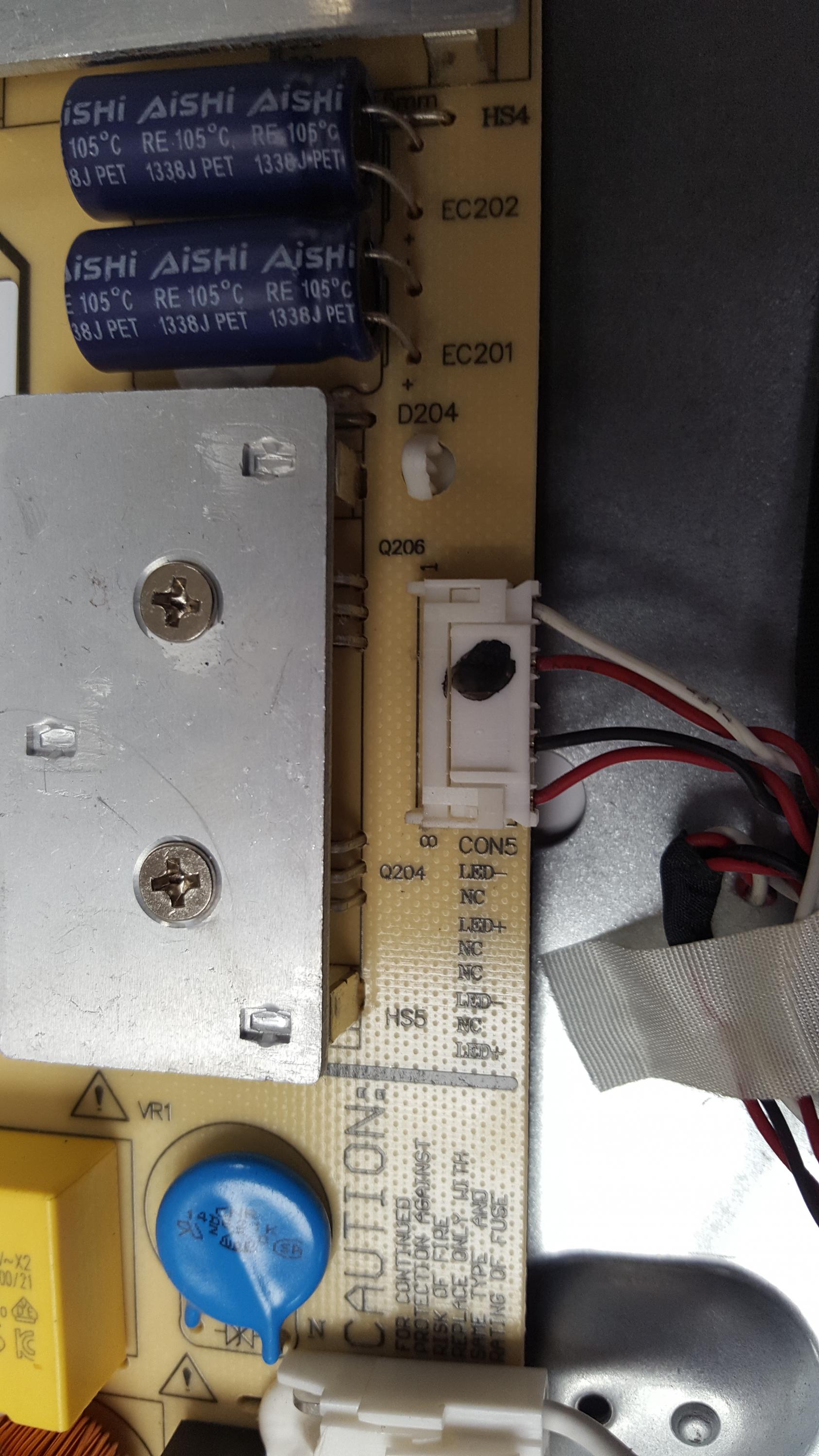

    Hello all,
    Put in a new power board (RS129D-3T01). I get the red standby light and then it goes out when I press the power button. No backlight. I have a backlight tester (GJ2C) so I unplugged CON5 and put the tester on the left hand set of red/black wires. I can see a bunch of LEDs light up.
    Then, I put the tester on the right hand set of red/white wires and I get nothing. Am I doing something wrong or is the other set of strips bad?
    Thanks!
    Re: RCA LED50B45RQ no power/LED question
    You have two sets of LED strings, so it sound like one of the strung has open circuit.
    • SLK001
      • May 2014
      • 264
      The strip with the RED/WHITE connections has bad LEDs. You'll have to pull the panel to get access to them.
      • joeblah
        • Apr 2016
        • 65
        Okay, awesome. Thanks guys!
