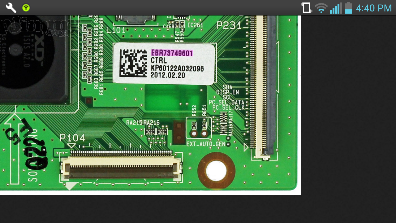

    Hey guys im working on a LG plasma and i tested the vs and va on both the Ysus and Zsus boards. I have correct voltages. But when i power on the tv the tv clicks like normal stand by light goes off and the panel lights up then darkens down a little bit. Did some research on line on a website and it stated to disconnect the Ysus board and see if the tv turns on. Which it does, but no power to the screen. They states if the tv still turns on still with no picture that would be the problem. Any suggestions?
    I can post pictures if needed.

    Go to the logic control board in the middle of the set. Flip up the brown latch on P231 and remove the flat ribbon. Put a paper clip in the 2 holes marked EXT_AUTO_GEN. Power on the tv and check if the test screens come on. If they do, the mainboard is bad.

      Re: LG 60PM6700 no picture no sound
      Do i put 2 different paper clips or do i loop it?
        Loop it.
          Perfect! Thank you. Just did it and the test pattern came on. Learn something new everyday. Does that trick only work with LG and this model or all plasma's?
            If you get a screen glow, test the tv this way. It works on all LG plasmas. It also works on Samsung plasmas, just have to short pins 3 & 4.
              Got it. And those are the pins thats on the main?
                  No. You are disconnecting the mainboard from sending info to the control board. This tests the logic/control board. Samsung plasmas have the 4 pins on the logic/control boards. You use a jumper from an old dvd rom or hardrive(master,slave selector) and put it on pins 3 and 4.
