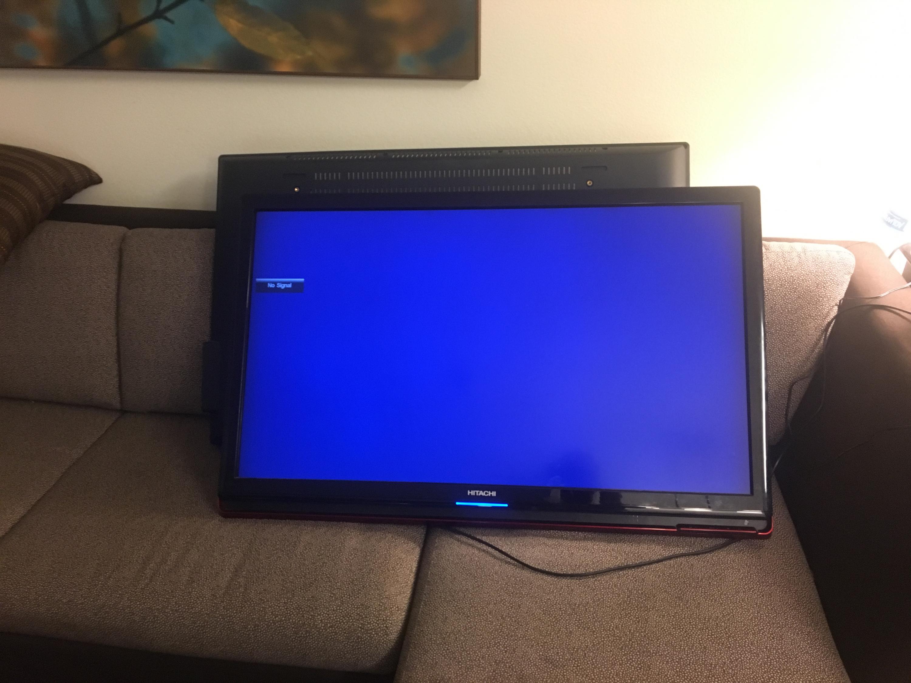

    Hey guys, been a while since I've been here but I have a Hitachi 42" tv here that I'm not getting standby voltage on. I found a chip on the board that that was cracked and I believe this may be my issue. From what I found on another post on here, this chip controls the standby voltage and PS_On voltage. The numbers on the chip are ICE380565
    TV Model: Hitachi L42N03A
    PS board : JSK4267-022C

                            Bud, Parts arrived and installed. My only question is, is it necessary to replace the rubbery silicone material over the leads? Will it arc if I don't? If necessary, what is this material?
                              Re: Need help finding IC PLEASE!!
                              Electronics grade RTV Silicone. You can run the test just to see if the problem is fixed first.
                              • rmoody
                                Learning Member
                                • Jul 2011
                                • 262
                                You the MAN, Bud! Thanks so much for sharing your knowledge.
