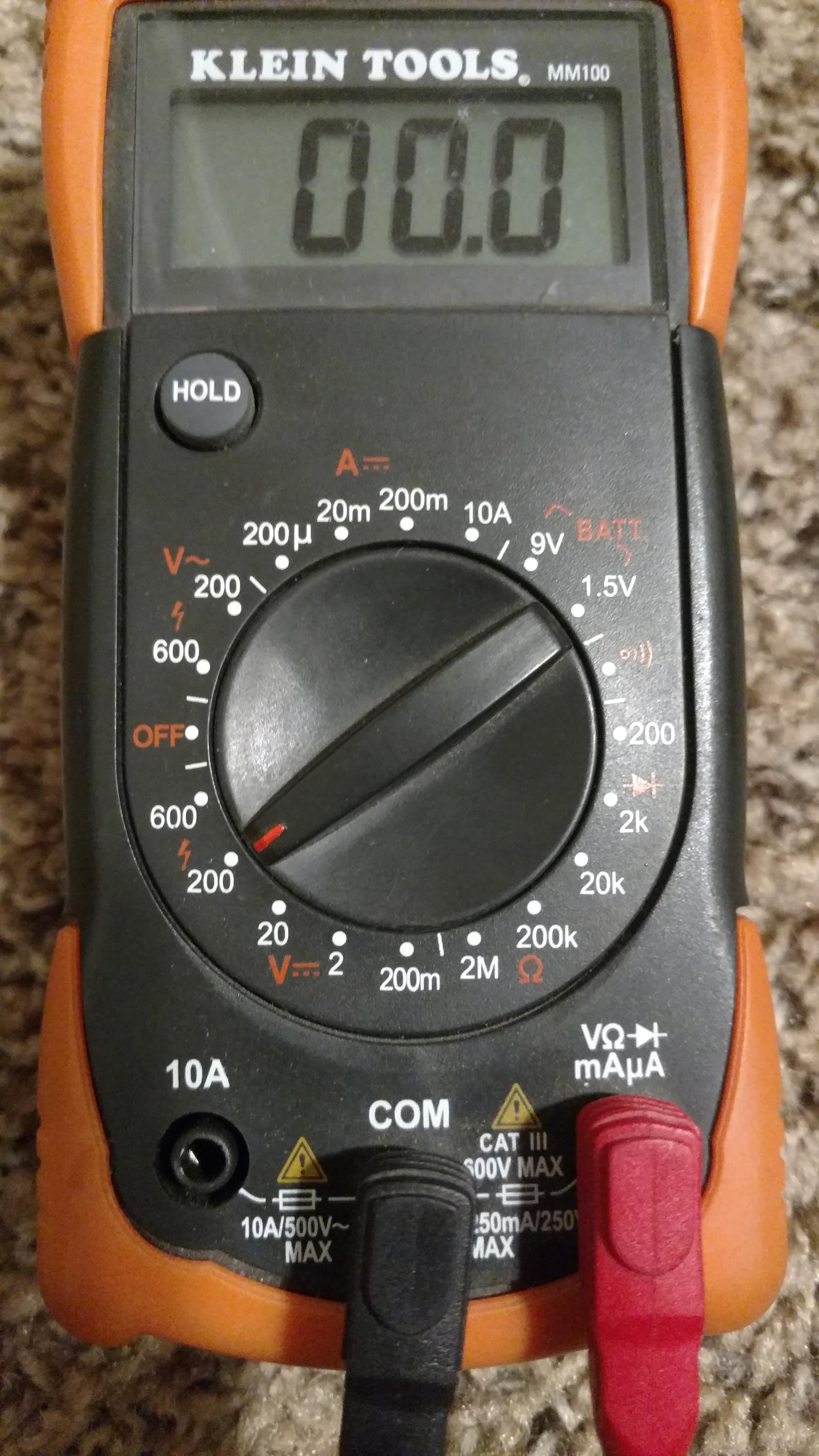

          Re: LG 60LB7100 screen goes black seconds after start up
          Are you sure that the multimeter is working and the DC voltage setting is selected?
          If your unsure, confirm by measuring the voltage of a 9V battery or similar.
          • tstew
            • May 2017
            • 21
            I tested the meter on my truck battery and got 12.2 so I believe I have the correct setting. The LED+ and all the VC 1-6 were at 78.6 on start up.

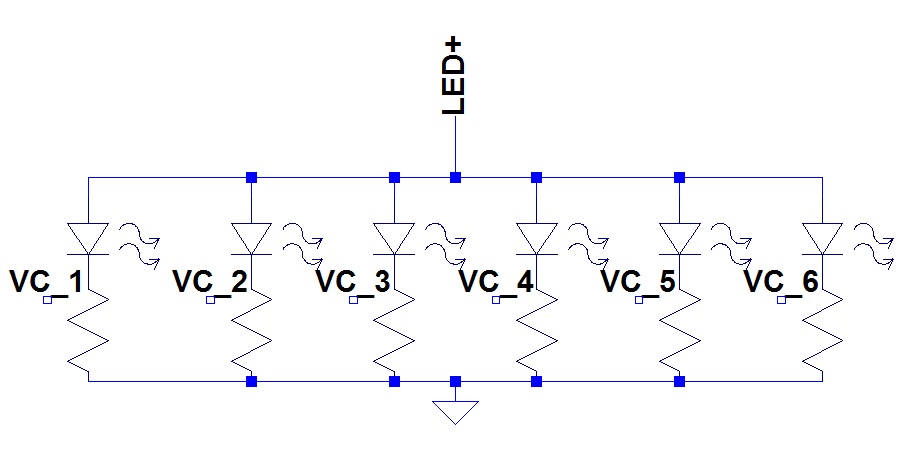

                I've attached a circuit based on budm's description (I might be wrong).
                Each LED represent 100 or so in series, so the voltage at VC_1 is LED+ minus the voltage drop over the first string of LEDs. So it must be less than LED+ unless something is horribly wrong...

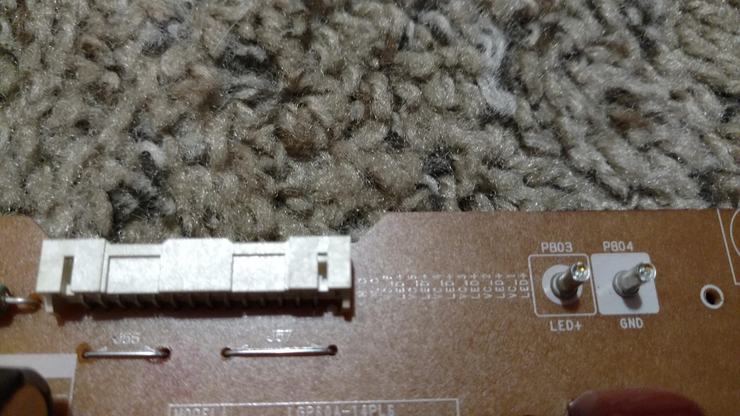

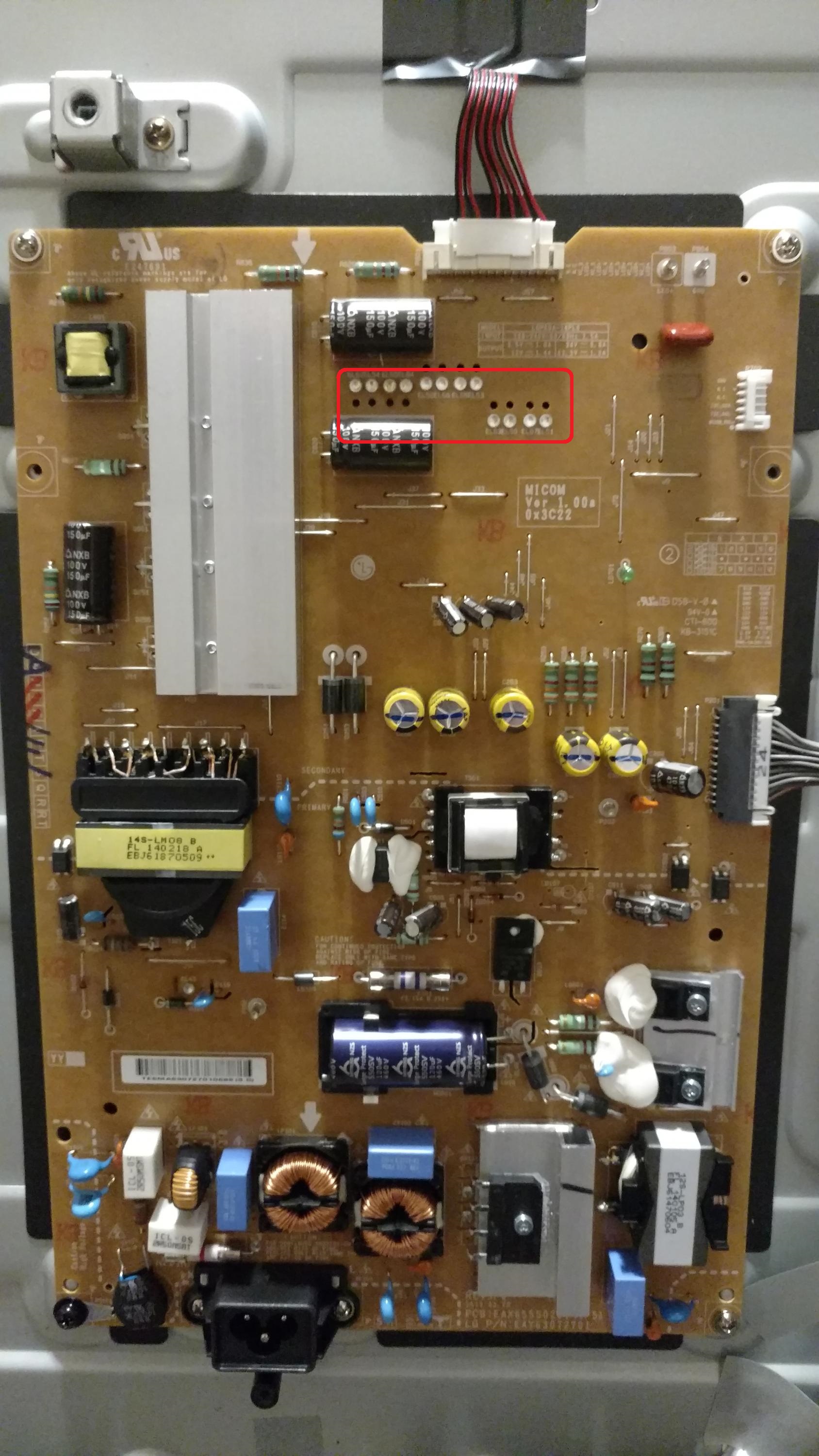

                  Here's a picture of the meter setting I'm using and the other picture is from the old board but shows where I tested the LED+ and the plug to the left I tested all 1-6 VC's positive. Results were LED+ 78.7v and 55.8v after the lights were off. All 1-6 VC were the same 78.6v down to 55.9v. Maybe I'm testing the wrong spots for VC?
                    #29
                    Where did you put the black probe of the meter?
                    • tstew
                      • May 2017
                      • 21
                      #30
                      I kept it in a screw hole right above the board. I'm assuming it's the chassis. The screw hole is in the big sheet metal backing of the screen that all boards attach to.
                              I might be missing something, but there is no VC+ and VC-, only VC, which is the cathode voltage of the LEDs. LED+ is the anode voltage. The pins of that 14pin connector alternate between LED+ and each of the six VC lines.
